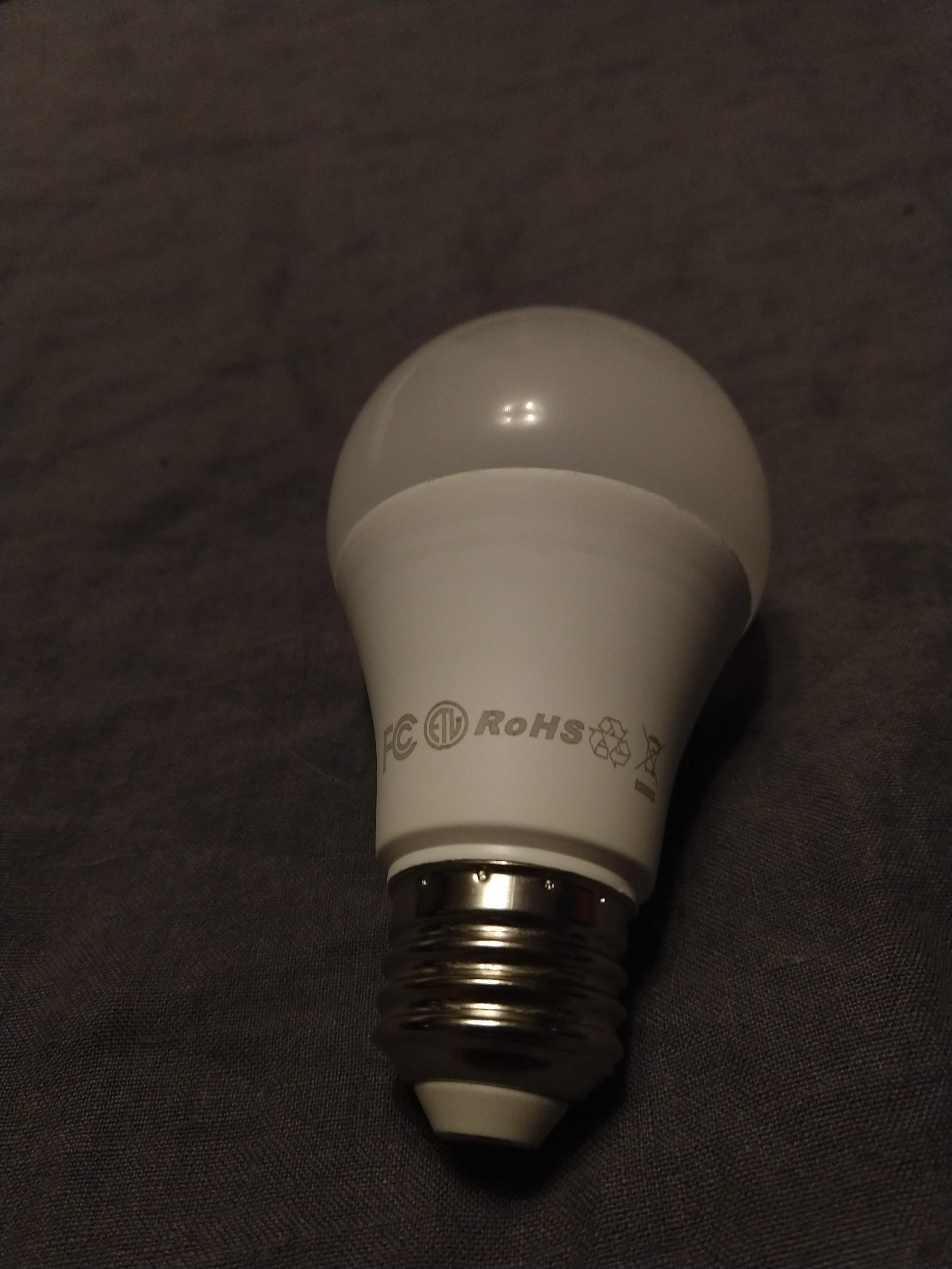

These bulbs are dirt cheap Tuya bulbs (I get them in a 12-pack off of Amazon for between $4 and $5 per bulb, a very reasonable price for bright RGBCW bulbs), and I discovered to my delight that they're OTA flashable using the tuya-cloudcutter exploit. I'll start with notes about the various configurations I used for tuya-cloudcutter and OpenBeken, and then move on to the hardware teardown.
In tuya-cloudcutter, the device profile "Tuya-Generic/E27-RGBCW-Smart-Life-WB2L_M1" works fantastically. The chipset is BK7231N; flash an OpenBeken firmware designed for that chipset. In OpenBeken, the necessary module setup is to make P7 BP5758D_CLK, and P8 BP5758D_DAT. Additionally the channels needed remapping, so I added in the startup command "BP5758D_Map 2 1 0 4 5". This information is enough to get these bulbs nicely out of the Tuya dungeon and working great on open-source local-control firmware without having to do any hardware surgery.
Over on an OpenBeken issue I opened, they recommended I post a teardown of this hitherto unknown device, and I had one bricked bulb (onto which I had carelessly flashed a BK7231T firmware) and another I had taken the dome off of and expected to sacrifice. First, some pictures of completely unaltered bulbs:
They don't really have any model name or number beyond the extensive descriptive text on the bulbs. The translucent dome is glued on and comes off with a bit of heavy-duty twisting and squeezing. Once removed, the light PCB and the tip of the MCU PCB are visible, as is usually the case:
