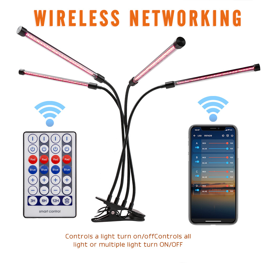

This is a short teardown of the LVJING WIFI LED Plant Grow Light which is based on BL602
Brand: LVJING
Model: LVJING WIFI LED Plant Grow Light
Chip: BL602
Vendor: https://www.aliexpress.com/item/1005004319893210.html
Application: Magic Home
