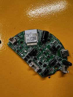

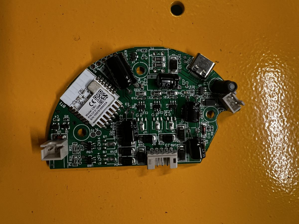

  • Hello!
    This is my first time posting something like this so apologies in advance if I have incorrectly formatted something.
    [BK7231N - CBU] BlissLights Sky Light Evolve Galaxy LED Laser Projector

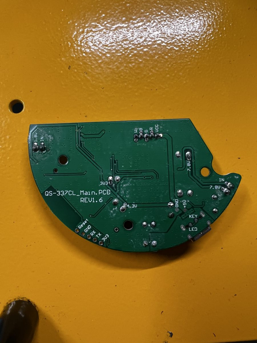

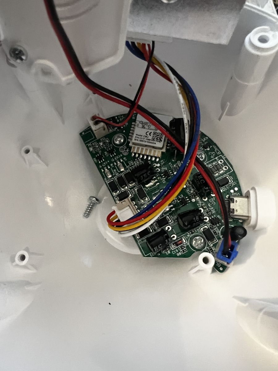

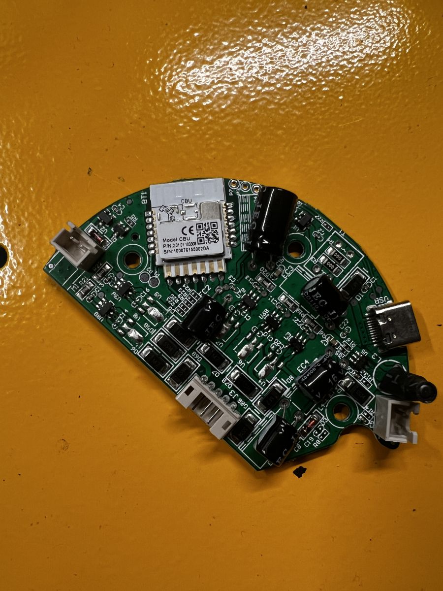

    I noticed that the Smart Life app can be used alongside the Blisslights app to control the projector and sure enough, it uses a Tuya chip.
    BK7231N - CBU
    The pins located to the right of the chip on the board allowed for easy flashing. I tried and failed to use a multimeter to figure out the pins so I just started turning off and on pins. It took a lot of guessing but I got as close as I could to something functional by pulling all I could from the Genio Galaxy Lamp setup. The LED works, though I am unsure how to set it up for RGBW. I set the channels as 0,1,2,4 though that may have messed up how the Genio config renders the controls. Laser works properly and brightness works. Motor can be controlled as well. Button on the USB cable works to turn everything off and on, though the LED on the remote no longer works. Only things missing are the individual motor control and toggles not working when restarted due to the speed and brightness setting defaulting to zero. Was not able to figure out Home Assistant integration.
    [BK7231N - CBU] BlissLights Sky Light Evolve Galaxy LED Laser Projector [BK7231N - CBU] BlissLights Sky Light Evolve Galaxy LED Laser Projector [BK7231N - CBU] BlissLights Sky Light Evolve Galaxy LED Laser Projector [BK7231N - CBU] BlissLights Sky Light Evolve Galaxy LED Laser Projector

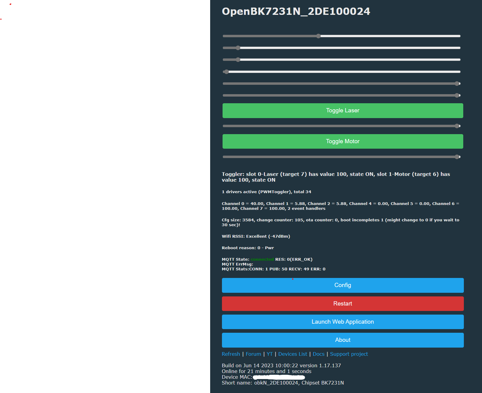

    Here is the pinout I managed to work out with my limited experience but I'm sure there are things I am missing.
      "vendor": "Tuya",
      "bDetailed": "0",
      "chip": "BK7231N",
      "board": "TODO",
      "flags": "2757771",
      "keywords": [
        "TODO",
        "TODO",
        "TODO"
      "pins": {
        "6": "PWM;0",
        "7": "PWM;6",
        "8": "PWM;7",
        "9": "PWM;4",
        "14": "Btn;5",
        "24": "PWM;2",
        "26": "PWM;1"
      "command": "",
    I also added this to the autoexec.bat:
    startDriver PWMToggler
    toggler_channel0 7
    toggler_name0 Laser
    toggler_channel1 6
    toggler_name1 Motor
    // this will make disabling LED also disable both togglers (laser and motor)
    addEventHandler LEDState 0 backlog toggler_enable0 0; toggler_enable1 0;
    // this will make enabling LED also enable both togglers (laser and motor)
    // Comment out if you don't want it!
    addEventHandler LEDState 1 backlog toggler_enable0 1; toggler_enable1 1;
    I have the original firmware backed up in case it is needed. Hope this helps!

    Thank you for posting this review! I am always happy to see new custom devices and so far we've only had one "laser projector" lamp on Elektroda:
    https://www.elektroda.com/rtvforum/topic3939064.html
    When you are trying to figure out pins and want to check them one by one, you should use our GPIODoctor: https://www.elektroda.com/rtvforum/topic3976371.html
    We can also try to extract GPIO from original firmware, can you attach dump file?
    Home Assistant integration for custom devices most likely will have to be done by hand, by writing YAML code for configuration.yaml.
    So you want to set some kind of default start value for speed and motor controls after reboot? Maybe we can figure that out by putting some kind of command in short startup command field, hmm...

    Thank you for taking a look. I did see and try to use the GPIO tool you showed, though it seems I only scratched the surface of it. I will put the firmware dump I created before flashing here. Perhaps it could save some effort.

    It seems there is no GPIO data in this binary. This device must be using a custom firmware build, which makes sense, considering all those non-standard features. So it's just not possible to extract GPIO data for this device in that way. The only thing I've found is their AP name: SL-BLISS.

    Apologies for the late reply. Those 2 values worked to start the motor and led with a decent value! I picked this back up to see if I could get the home assistant integration working. The biggest issue seems to be the fact that the channels are all represented differently as pwm.
    How would one go about setting up the mqtt topics to be RGBW vs single controllable channels? Beyond HA it would be nice to have a color picker in the web page itself if there is a setting for that.
    using that dump here's some bits extracted bits for the public record
    Tuya API response
    bin data
    the same GPIOs are in use on this similar device https://www.elektroda.com/rtvforum/topic4021966.html
    Added after 8 [minutes]:
    template add https://github.com/OpenBekenIOT/webapp/commit/6e8ab382203a3cbe449f829a518a8ab31ac0e7af

  1. Open the projector and locate the pins beside the BK7231N CBU module.
  2. Press or connect a cheap USB flasher to the exposed pins.
  3. Flash OpenBeken or ESPHome once, then configure the GPIO mapping.
The thread reports that the pins are exposed and can be pushed against for connection. [#21204590]
What is the correct GPIO pinout for the BlissLights Sky Lite Evolve Galaxy projector using the BK7231N CBU chip?
Use GPIO6, GPIO26, GPIO24, GPIO9, GPIO8, GPIO7, and GPIO14 for the main functions. The reported ESPHome mapping sets red on GPIO6, green on GPIO26, blue on GPIO24, white on GPIO9, laser PWM on GPIO8, motor PWM on GPIO7, and the USB button on GPIO14. OpenBeken used pins 6, 7, 8, 9, 14, 24, and 26 with PWM and button roles. [#21062703]
How can I configure RGBW LEDs, the blue laser, the motor, and the USB button on the BlissLights Sky Lite Evolve in ESPHome?

How do I add PWMToggler controls for the laser and motor in OpenBeken on the BlissLights Sky Lite Evolve?
Start PWMToggler, assign channel 7 to Laser, and assign channel 6 to Motor. The posted autoexec.bat uses startDriver PWMToggler, toggler_channel0 7, toggler_name0 Laser, toggler_channel1 6, and toggler_name1 Motor. Event handlers then disable or enable both togglers when LEDState changes between 0 and 1. [#20619875]
