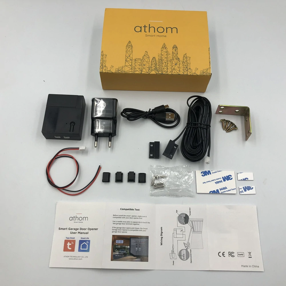

Set contains:
1 x Smart WiFi Garage Door Opener Controller
1 x USB Charging Adapter
1 x USB cable
1 x Manual
1 x Mounting accessories
Photo of the set (according to the seller):
assembly diagram:
Promotional graphics:
Actual Kit Contents:

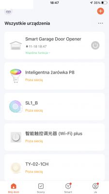

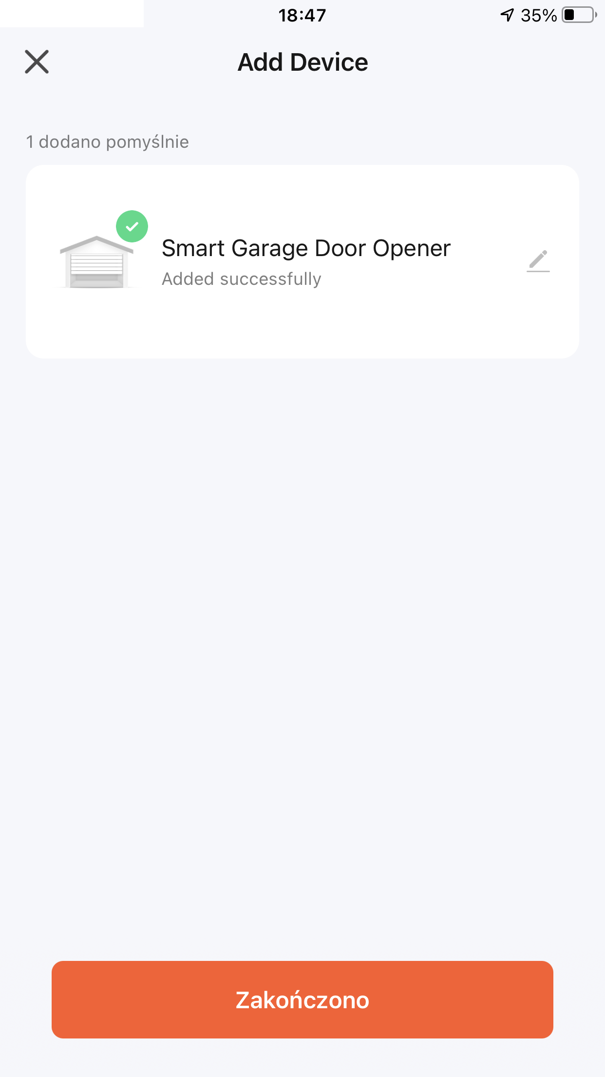

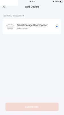

A short test with the Tuya application
As a test, I paired the device with the manufacturer's application. I did the reset by pressing the button from the housing for more than 5 seconds.
The video shows how it works:
Basically, pressing the button on the housing (or controlling from the app) simply shorts the relay for a short while, simulating pressing the button of the proper gate controller. In addition, an animation appears in the application that the gate is opening, etc. The closing/opening sensor is also supported and is used to show the current state of the gate.

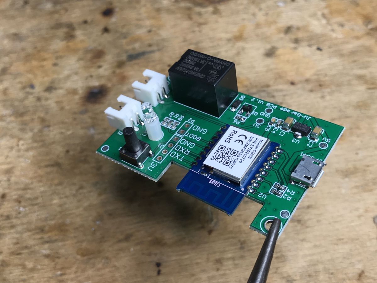

The inside of the gate controller
The plastic housing is held on by hooks. They hold quite solidly, you need to use some force when prying:
Inside there is a CB3S module, i.e. BK7231N and programming signals.
So you can upload OpenBeken .

I only use TXD1 and RXD1 for programming. But first we will see the rest of the PCB:
Basically on the PCB we have:
- LDO AMS1117 (gives us 3.3V for WiFi module with 5V)
- small button and LED
- connector for the button from the garage (with a relay, this relay shorts them and simulates pressing)
- connector for gate opening/closing sensor
The role of BK7231 pins:
- P7 - relay (the one that turns on the right gate)
- P8 - gate opening/closing sensor input
- P24 - LED from the board
- P26 - button from the board
programming procedure
Programming this particular BK7231 will be very simple.

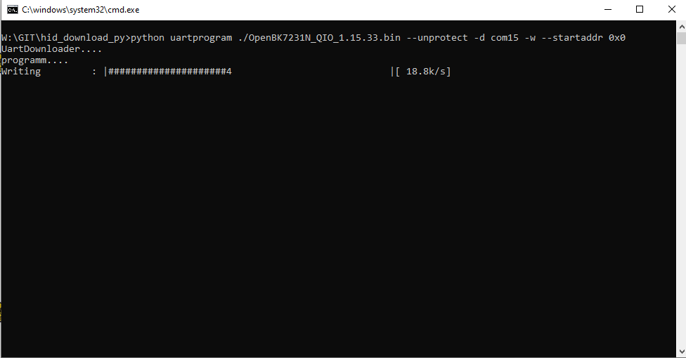

All you need is a USB to UART converter with 3.3V voltage levels. Solder three wires - ground, RX and TX.
Then we run the program on the computer (bkWriter 1.60, or better, hid_download_py) and when you need to RESET the system, simply disconnect the USB cable from the connector on the board. We just reboot.
Thanks to this, you do not need to solder this "BOOT" signal or an additional 3.3V LDO, because it is already on board.
https://github.com/OpenBekenIOT/hid_download_py
This is BK7231N, so we upload the QIO binary to offset 0. If it was BK7231T, we would upload UA to the default offset. As in OpenBK Readme.

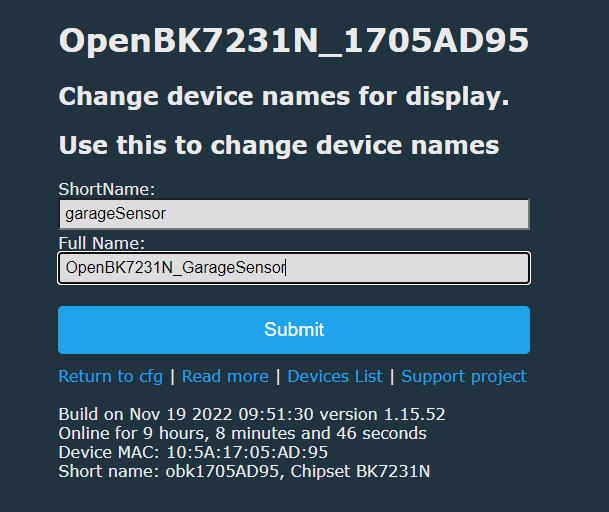

It's also worth changing the name to something more meaningful:

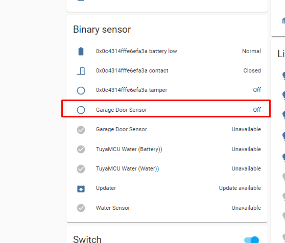

Home Assistant setup - step 1
The first stage of configuration requires adding separately the relay control (as a switch) and the sensor reading (as a binary_sensor) to Home Assistant. We will use YAML code for this purpose. We have to remember what channels we assigned to given roles - here we receive them by the MQTT subject from get and set them by the MQTT subject from set. as below:
Code: YAML
The above Yaml defines a garage opening sensor. We only have "state_topic" from get here, which means we receive what OBK publishes.

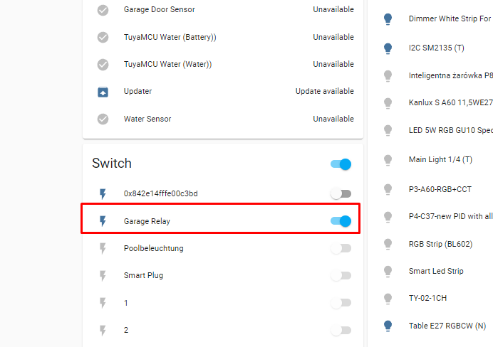

Now handling the relay:
Code: YAML
As above, only "command_topic" is added, i.e. a topic that allows us to send a new state of the relay to OpenBeken.
The above Yaml should give us:
The above sensor on the HA interface should react to a change in the state of the sensor on the device, as it should be possible to control the relay from the HA level!
