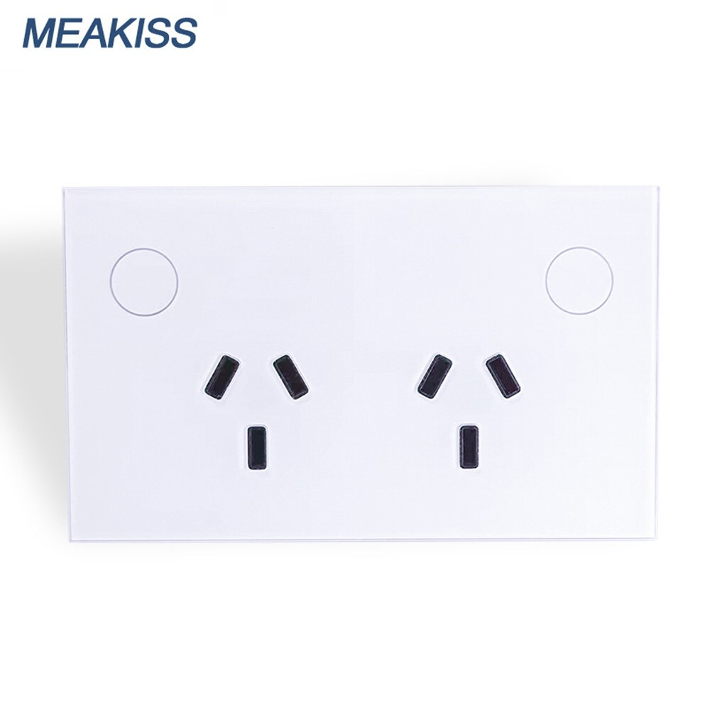

Teardown of this smart dual GPO from AliExpress.
Product seems to be branded MEAKISS, but I can't see that written anywhere on the device, and this OEM probably sells to many brands.
No product name/model number is written anywhere on the device.
Product has 2 GPO's with 2 touch buttons. The product was advertised with energy metering, but this device does NOT have an energy meter.
