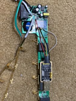

  • Flashing required soldering leads directly to the Wi‑Fi module because the board exposed no pads, and power cycling started the download without special procedures.

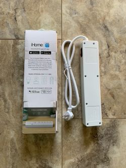

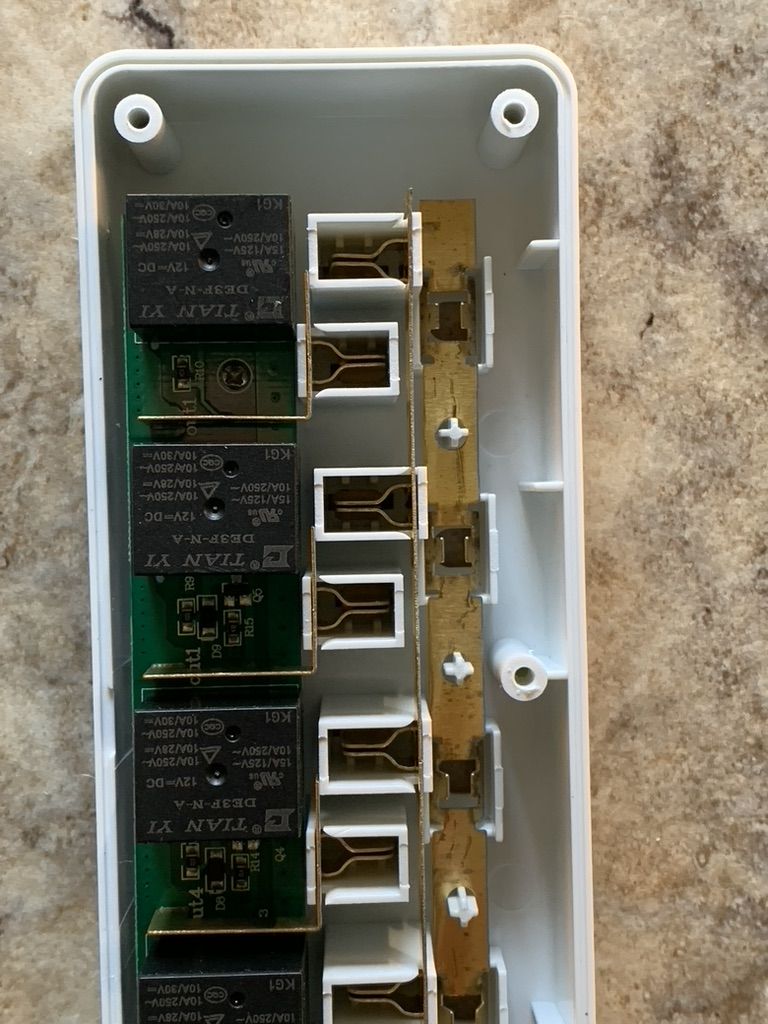

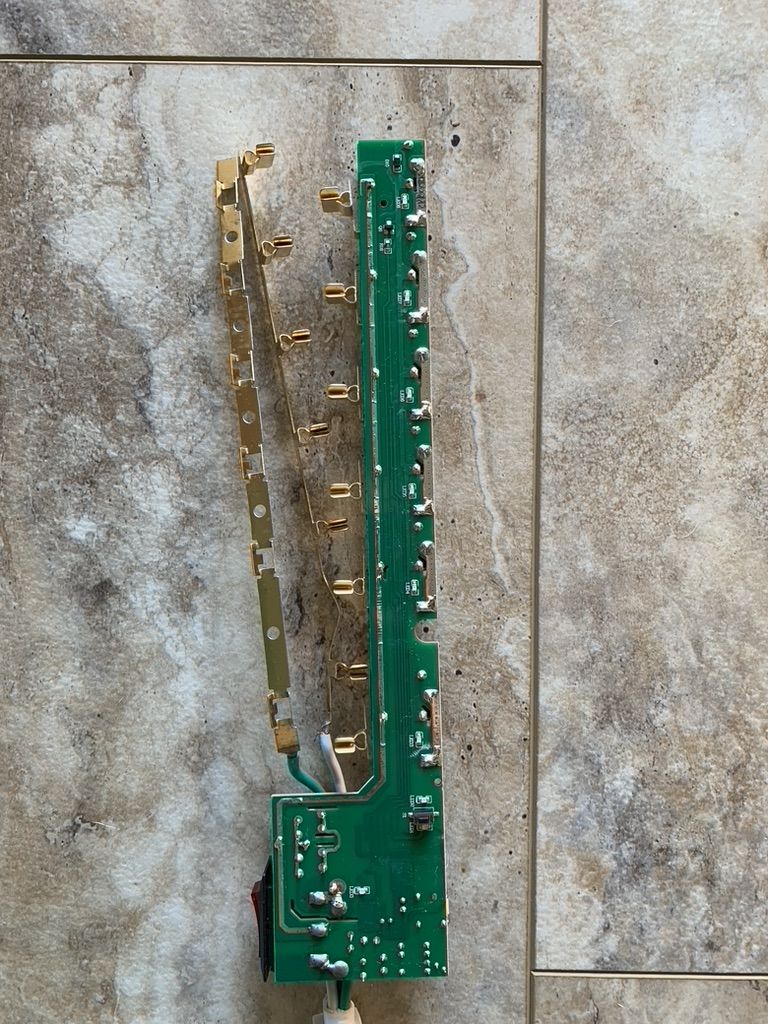

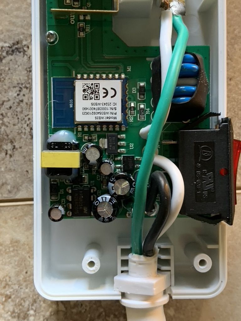

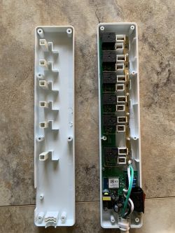

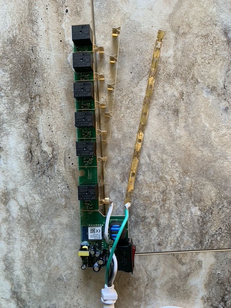

  • Hello,
    I would like to submit the below teardown. The device uses a Tuya WB3S module and I was able to flash it with OBK. There did not appear to be any pads on the board to attach the flashing leads so they were soldered directly to the Wifi module. The power needed to be cycled to initiate the download. No special download procedures were required. All outlets can be controlled separately and the Wifi light works. The Wifi light has button but it does not do anything with OBK. I did map it to channel 7 and it will produce a "1" when pushed.

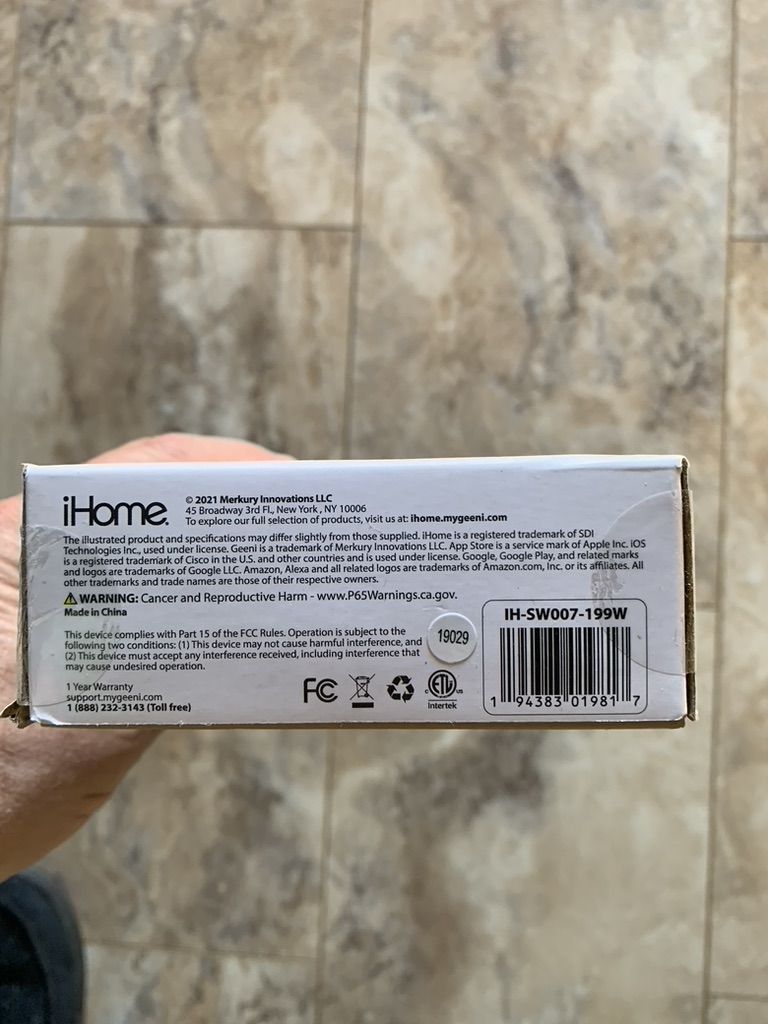

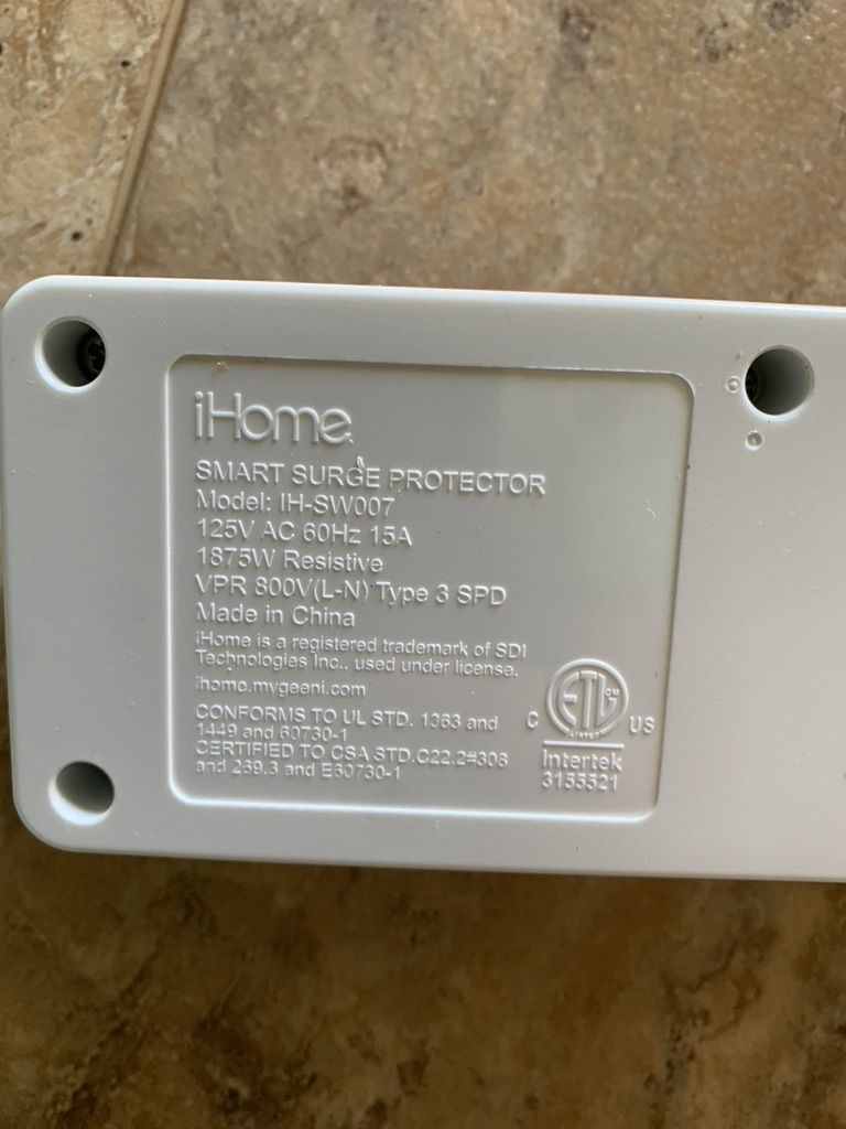

    Manufacturer: Geeni
    Model Name: iHome Smart Surge Protector
    Model #: IH-SW007

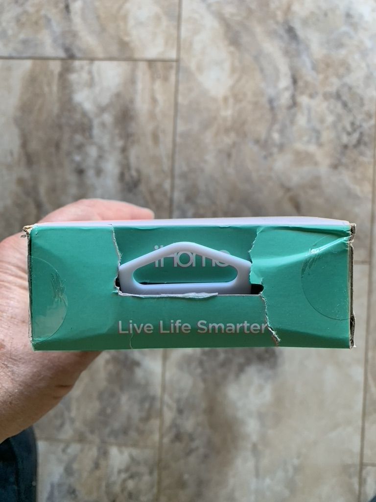

    Photos of package:
    BK7231T / WB3S Teardown Geeni iHome 6 outlet powerstrip BK7231T / WB3S Teardown Geeni iHome 6 outlet powerstrip BK7231T / WB3S Teardown Geeni iHome 6 outlet powerstrip BK7231T / WB3S Teardown Geeni iHome 6 outlet powerstrip BK7231T / WB3S Teardown Geeni iHome 6 outlet powerstrip BK7231T / WB3S Teardown Geeni iHome 6 outlet powerstrip

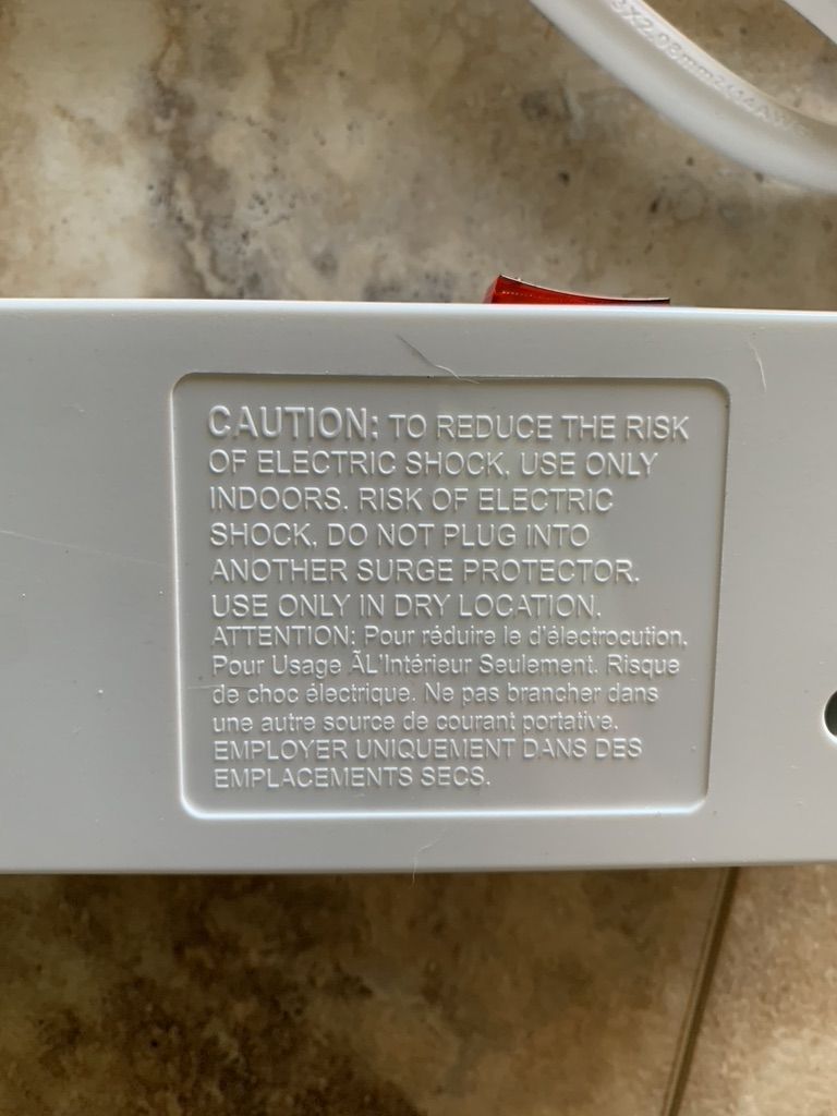

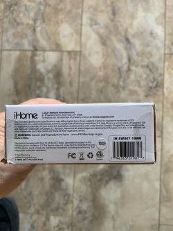

    Close-up of back labels:

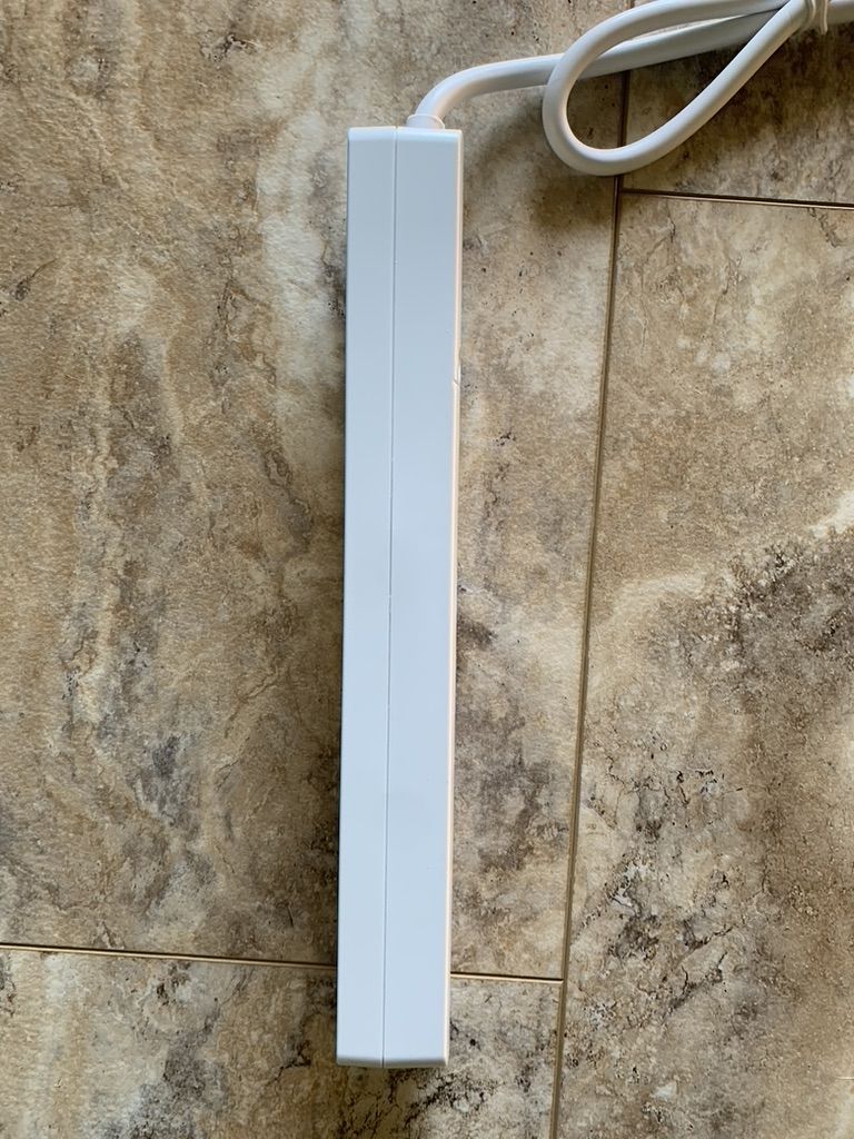

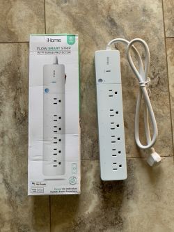

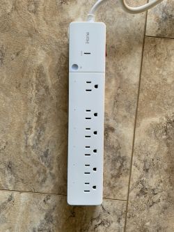

    Close-ups of device exterior:

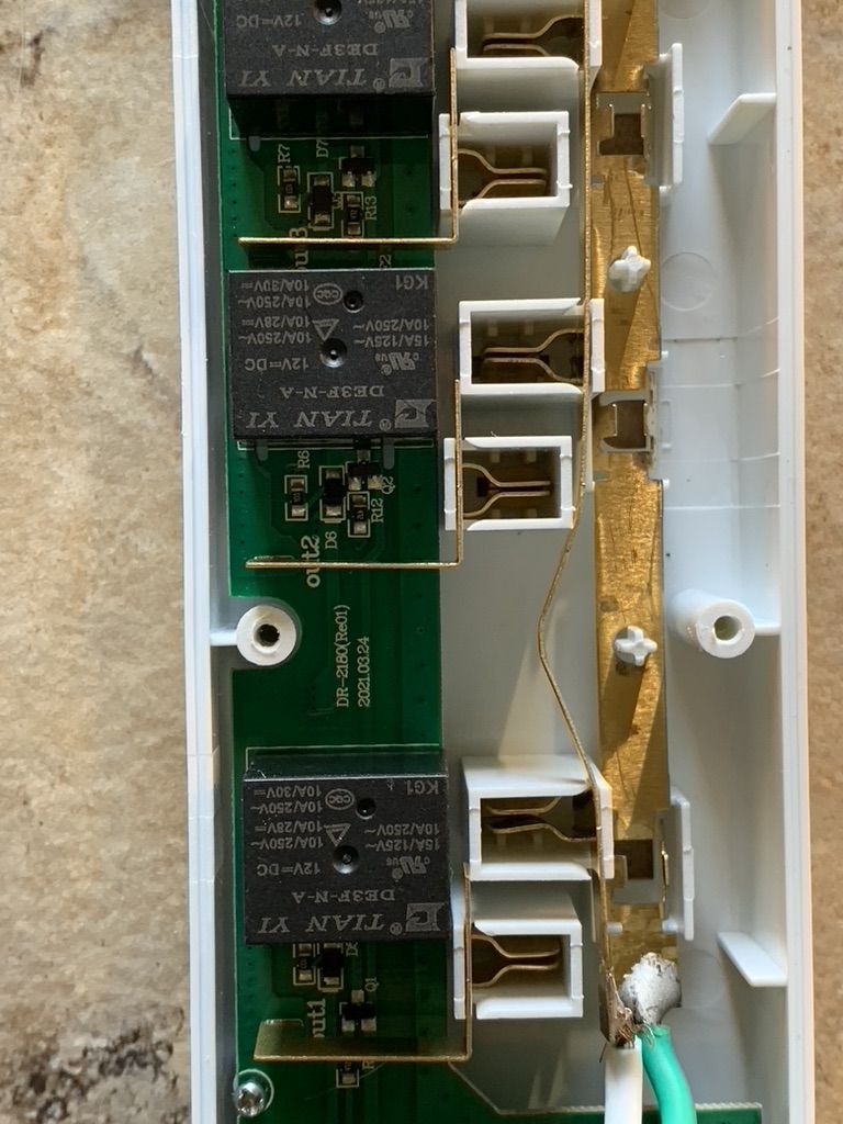

    Device interior and circuit board:
    Flashing setup:

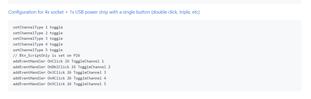

    Hello, the button can be much better utilized. For example, you can script it to toggle first relay on single click, second relay on double, etc... please see our autoexec.bat examples:
  • Extended example to support a sixth outlet

    I can see where using the wifi button might be useful since each outlet doe not have an individual button to turn it on or off. Though one would need to be careful when trying to turn say outlet 6 on or off. With so many clicks one could turn off or on the wrong outlet.
    The example does work. I extended the example to account for the sixth outlet. I did switch off the wrong outlet once. Suggest putting any "critical" loads on the higher number outlet to avoid turning them off by accident.

    New device added to database. Button script tested and working.
