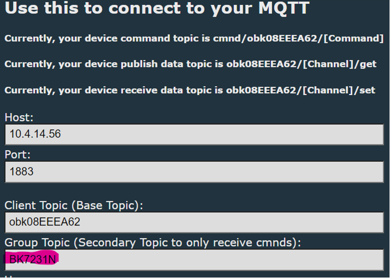

I flashed all 34 Smart Plugs in two evenings. So now my real problems have begun. How to configure all these babies in bulk. I wasn’t planning on logging on to each device setting the required settings. So I started playing around with the same commands I used for bulk configuring my Tasmota devices. Unfortunately, not all the commands I needed were implemented at that time. Thanks to the developers, quite some features were added. But things really got up to speed once the MQTT Group Topic was introduced. This made it possible for me to update all 34 plugs in one go. As well as fine-tuning. This is a breeze as I have the same plugs and the same underlying hardware.
Let me show how I’ve done this;
Flash your device and add it to your WiFi network. No pin settings are needed; we will configure all settings from HomeAssistant.
First, I recommend choosing an MQTT Group Topic based on your hardware chip. This will make updating relatively easy and at least somehow prevent you from pushing N setting to T chips and vice versa. Setting up the MQTT Group Topic is done under “Configure MQTT.” Please make sure you set up your username and password correctly so HomeAssistant can “take control.”
To follow up on this, your Beken Device must report its status (regularly) to HomeAssistant. I recommend setting it up with a special Startup command. This is done in the Change Startup command text.
You should add “scheduleHADiscovery 10”
Now reboot your OpenBeken device and check if it shows up in HomeAssistant
We are now ready to configure the device.

cmnd/BK7321N/ota_http
• cmnd instructs sending a command.
• BK7321N is the MQTT (group) Topic. If you want an individual update, use the MQTT Client/device name
• ota_http is the command your want to send. You can use the commands from https://github.com/openshwprojects/OpenBK7231T_App/blob/main/docs/commands.md and from https://github.com/openshwprojects/OpenBK7231T_App/blob/main/docs/commands-extended.md
I can tell, it is fun to watch 35 devices updating and rebooting. The aforementioned “scheduleHADiscovery” warrants that your HomeAssistant information is updated. When a new IP address is given or the firmware version changes, this is correctly displayed in HomeAssistant. So you can keep track of the firmware versions and see which devices are not up to date.

This shows the power of the MQTT Group Topic and the way the OpenBeken developers have come making provisioning a breeze. I am quite sure any future command or setting will be addressable via a MQTT cmnd command.

nielspiersma 07 Jan 2023 06:49

nielspiersma 13 Jan 2023 18:09
Correct, After setting up mqtt group topic you need to restart the device. Niels Added after 4 [minutes]: I am not sure, but I only tested with port 80 not with port 7000. I'll setup a server... [Read more]
