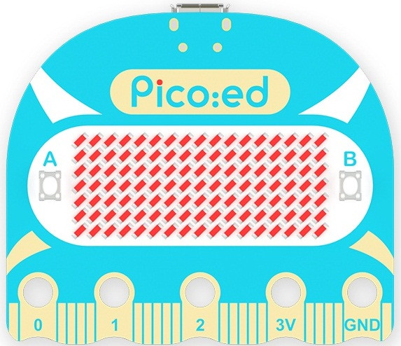

Many educational platforms have been created, from very simple to very advanced. Depending on the user's requirements, one of such platforms for the youngest is the BBC micro:bit (in various versions) based on the Nordic nRF51822 microcontroller with the ARM Cortex-M0 core. For this board, many additional base modules have been created to connect external circuits/peripherals. Elecfreaks has designed and launched a similar educational module called Pico:ed V2 based on the RP2040 controller from Rapsberry. Pico:ed has been equipped with a Wavy connector identical to the micro:bit, which gives compatibility with most micro:bit base modules. It is true that Pico:ed has a little less peripherals on board, but it makes up for these shortcomings with a more powerful and dual-core RP2040 controller.
So let's take a look at what we have on board Pico ed v2;
As you can see, this is a slightly more complex board than the module I described earlier Rapsberry Pi Pico RP2040 . What has been put at our disposal?
• RP2040
• 2MB Flash memory (25Q16JWUXIQ)
• USB connector (power/programming)
• Battery/battery connector
• Two programmable user buttons
• Buzzer (GP3)
• LED (GP25)
• IS31FL3731 LED matrix driver controlling 119 LEDs
• 25-pin Wavy edge connector for compatibility with most micro:bit accessories
• Power supply, USB port or two AAA batteries ("fingers")
An interesting chip used by Elecfreaks is the LED matrix driver, it allows you to control 144 LEDs via the I²C bus;
Interestingly, it also allows you to adjust the brightness independently for each of the LEDs. In addition, it has been equipped with an analog audio input.
The use of the Wavy connector makes it a bit more complicated to start playing with the module, but a USB connector is enough to start. Since the heart of the module is the RP2040, we basically have the same possibilities in terms of programming. We can do it in the Arduino or Python environment and even MicroBlocks. For more advanced projects, however, it is worth getting a prototype module with a Wavy connector, e.g.;
Or, for example, as in the picture below, this one after soldering the pin connector will allow you to use a typical breadboard;
