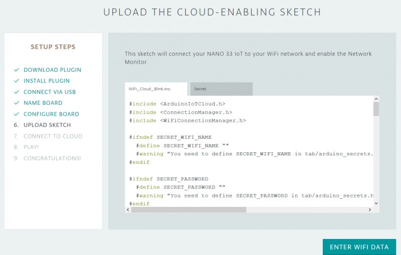

    We connect the board via USB, when it is detected we give it a name.
    We go to the board configuration, the first stage is the automatic configuration of the cryptographic system.
    We get the start code to upload to the board, and the ability to enter the password and the name of the 2.4GHz WiFi access point:
    Arduino NANO 33 IoT, review, launch, tests, how to
    The added device can be found here: https://create.arduino.cc/devices/

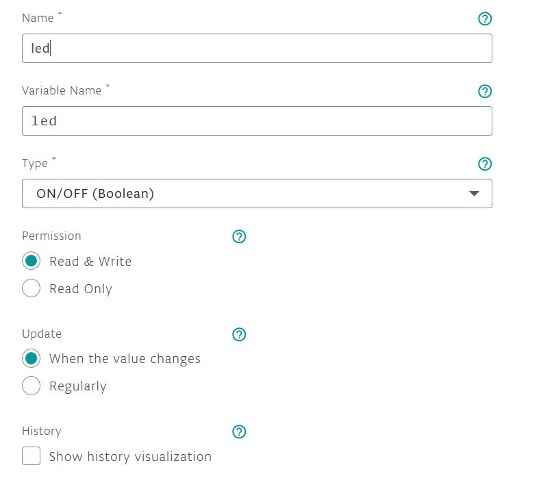

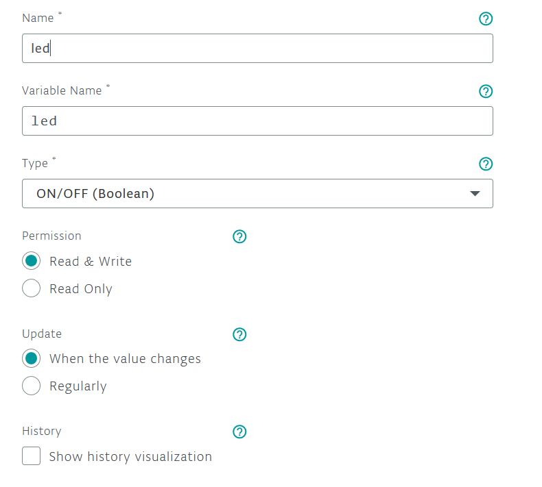

    We add the ability to control the LED on the board:
    https://create.arduino.cc/iot/things

    We can control the variable led, and then togle LED using the browser:
    The web interface of the editor and IoT cloud works quite slowly, and sometimes errors appear, but we can easily test the properties of IoT devices.
