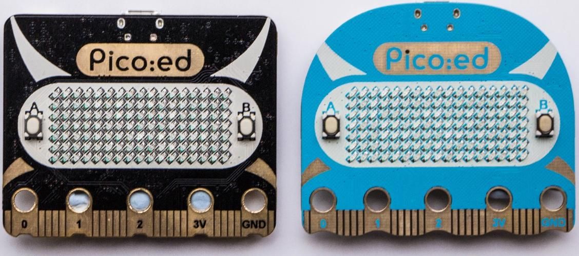

    So let's take a look at what we have on board Pico ed v2;
    Pico ed v2 is it the successor of the BBC v2 microbit? Review, test and first pr
    As you can see, this is a slightly more complex board than the module I described earlier Rapsberry Pi Pico RP2040 . What has been put at our disposal?
    • RP2040
    • 2MB Flash memory (25Q16JWUXIQ)
    • USB connector (power/programming)
    • Battery/battery connector
    • Two programmable user buttons
    • Buzzer (GP3)
    • LED (GP25)
    • IS31FL3731 LED matrix driver controlling 119 LEDs
    • 25-pin Wavy edge connector for compatibility with most micro:bit accessories
    • Power supply, USB port or two AAA batteries ("fingers")

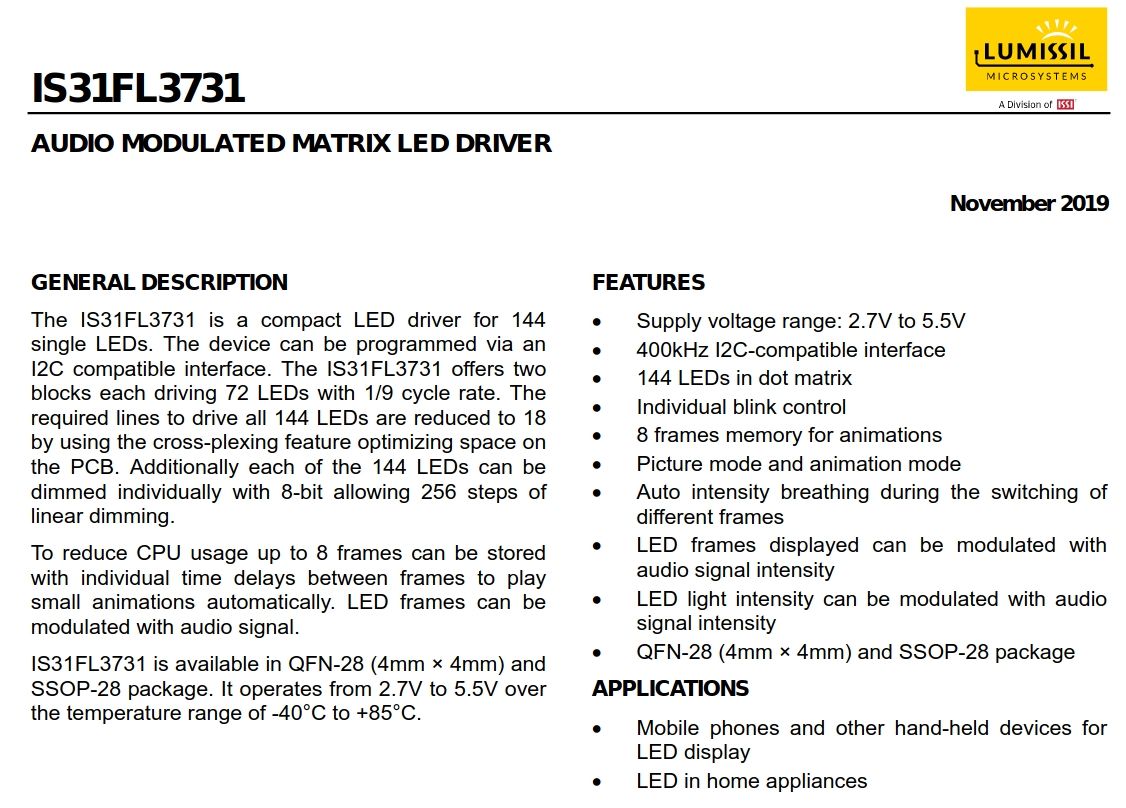

    An interesting chip used by Elecfreaks is the LED matrix driver, it allows you to control 144 LEDs via the I²C bus;

    Interestingly, it also allows you to adjust the brightness independently for each of the LEDs. In addition, it has been equipped with an analog audio input.
