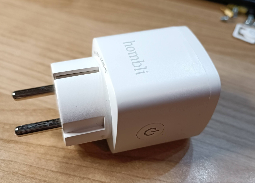

Let me share my adventure with the “Hombli Smart Socket”
Written on the plug is: HBSS-0209 Smart socket B2030248
From Tuya app: Software version = Main V 1.0.2
The chip is a WB2S = BK7231T (i only know this, because i have sacrificed 1 of my plug to look inside. :-) )
