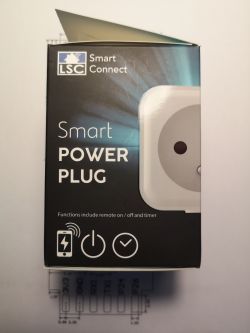

  • Last summer I bought a socket in the action store:
    [BK7231N CB2S] Smart socket LSC 0 - firmware change [BK7231N CB2S] Smart socket LSC 0 - firmware change
    Now is the time to disconnect from the cloud. It took a while, but I found descriptions of how to do it without disassembling the device and soldering the wires.
    I took advantage of https://github.com/tuya-cloudcutter/tuya-cloudcutter and https://github.com/openshwprojects/OpenBK7231T_App
    I used the existing configuration for the LSC Smart Connect Plug and the socket works without internet connection.
    Unfortunately, not everything was as in the original. I had only one blue LED for this, which should indicate the WiFi connection and indicated the activation of the relay.
    That's why I decided to look inside.
