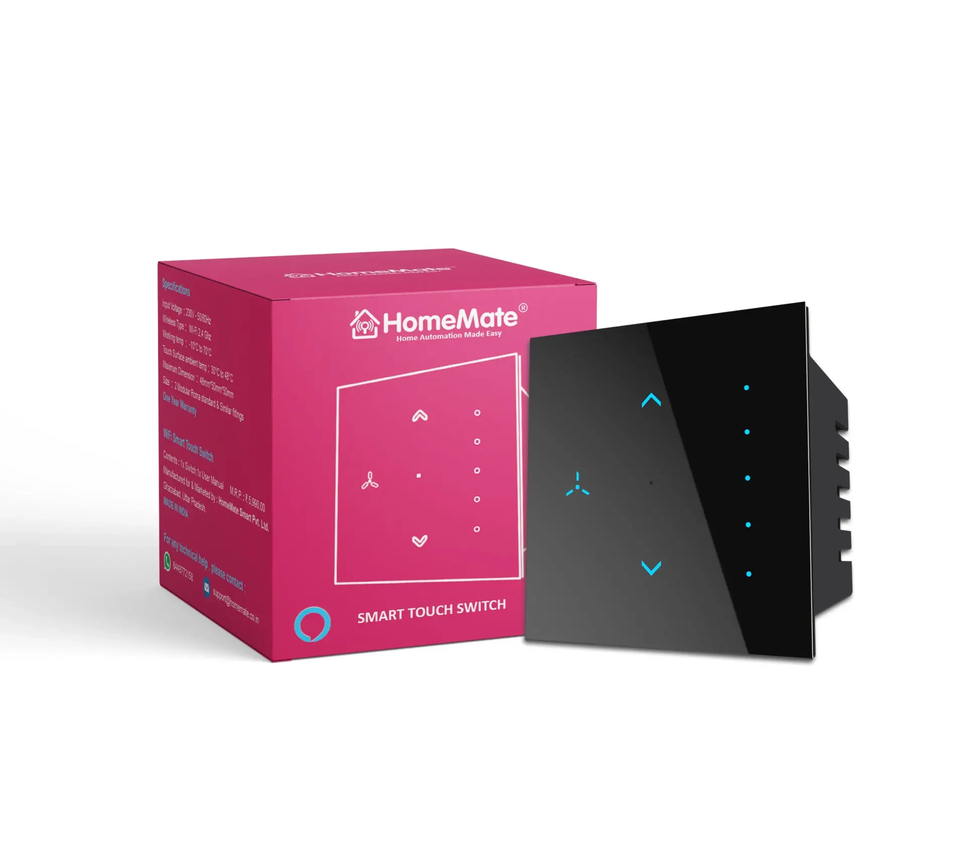

    4. Homemate WiFi Smart Regulator Switch
    OpenBeken templates and scripts for Homemate WiFi Smart Devices (TuyaMCU config and dpIDs)
    https://homemate.co.in/product/wi-fi-fan-touch-switch/
    Add these to autoexec.bat
    AutoExec
    // start MCU driver
    startDriver TuyaMCU
    // fan on/off channel
    setChannelType 1 toggle
    //fan speed channel
    setChannelType 3 OffLowestLowMidHighHighest
    // child Lock channel
    setChannelType 14 toggle
    // countdown channel
    setChannelType 22 TextField
    // remaining timer channel
    setChannelType 23 TextField
    // link output 1 to channel 1
    linkTuyaMCUOutputToChannel 1 1 1
    // link output 3 to channel 3
    linkTuyaMCUOutputToChannel 3 2 3
    // link output 14 to channel 14
    linkTuyaMCUOutputToChannel 14 1 14
    // link output 22 to channel 22
    linkTuyaMCUOutputToChannel 22 2 22
    // link output 23 to channel 23
    linkTuyaMCUOutputToChannel 23 2 23

  • #2 20850485
    shrikantpatnaik
    Hi,
    Thanks for these, both the switch and regulator templates worked perfectly. I am struggling a bit with the 16A plug, any idea which cloudcutter profile you used? My plugs are on FW 1.1.15 and that is not there on cloudcutter. I tried a few with similar numbers but to no success. Any help will be appreciated.
