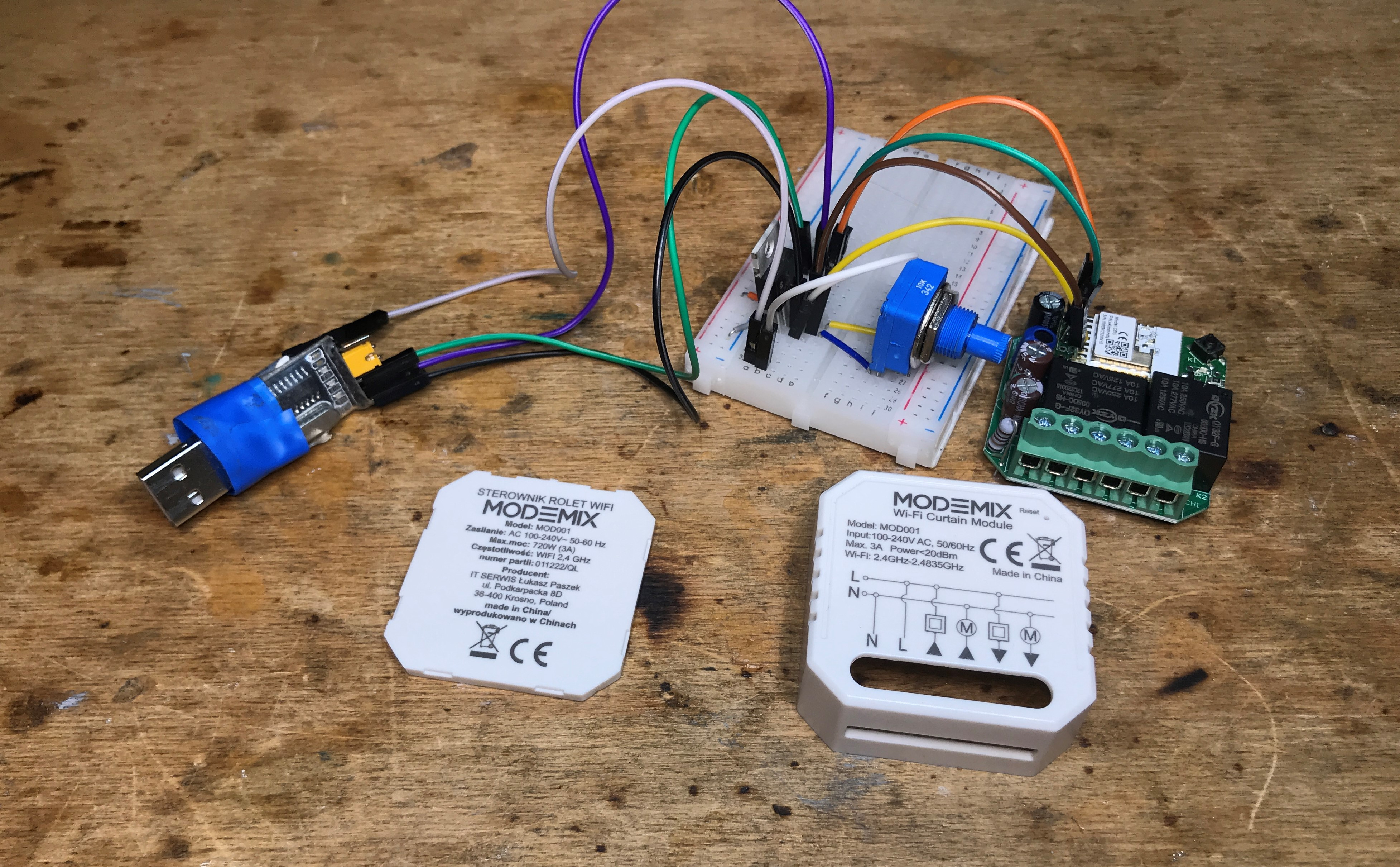

The interior of MOD001
We pry the cover and remove the hooks, then you can remove the PCB:
The PCB comes out pretty hard. The WiFi CBU module with BK7231N is on an additional board, on it there is also a diode indicating the WiFi status and a pairing button.
For the rest... it's a 1:1 module MOD003 , only with different firmware. PCB is the same.
If in doubt, please refer to the topic MOD003 .

MOD001 programming
Identically as in the case of MOD003, we only solder RX, TX, ground and 3.3V:
In practice it looks like this:
It's just that in the photo I used a yellow cable for ground, and a brown one for power.
Here is the whole system, with 3.3V power supply from the LDO:
We flash this:
The procedure is simple:
1. disconnect the power supply from the module
2. Connect the USB to UART converter to the PCB
3. start the backup and write process in BK7231GUIFlashTool, then waiting for the "getting bus" will start
4. connect this power supply to the module
5. then the module programming will start
