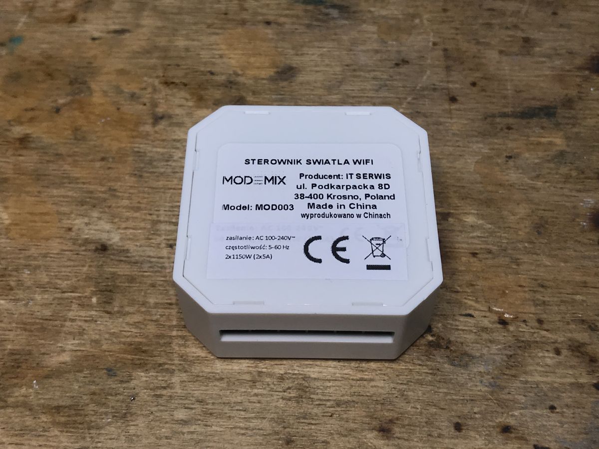

    It's time for a review and release from the cloud of another small module for the box, this time offering control of two relays via WiFi, additionally allowing you to connect two switches to them. The module described here was bought in our country this time, so there was no waiting for shipping, but it cost a bit more than the gadgets imported straight from China, although it was not as expensive as in the case of other products, including the recently described RR400W , which for PLN 70 offers only one relay and without the possibility of connecting an external button (unless we load OpenBeken, then you can configure the pins at will and you can connect an additional button / sensor that was not planned by the manufacturer).
    The topic will only cover the interior and the firmware change. As usual - I skip the Tuya application and immediately look inside.
    Buying a kit
    One of my readers gave me the set ( Thank you very much! ) so that I can change the firmware for it. As far as I know, such a driver can be purchased in several places on the Polish Internet, e.g. on a popular auction site. It is quite expensive, all PLN 70, but at least it can handle two lines - it has two relays inside.

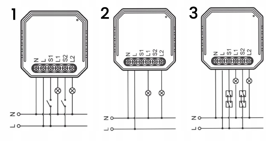

    [BK7231N/CBU] WiFi Modemix MOD003 Dual Light Controller
    assembly diagram:
    Dimensions: 46x46x18mm
    Before buying, check whether it fits our box and whether we will have a way to lead wires to it.

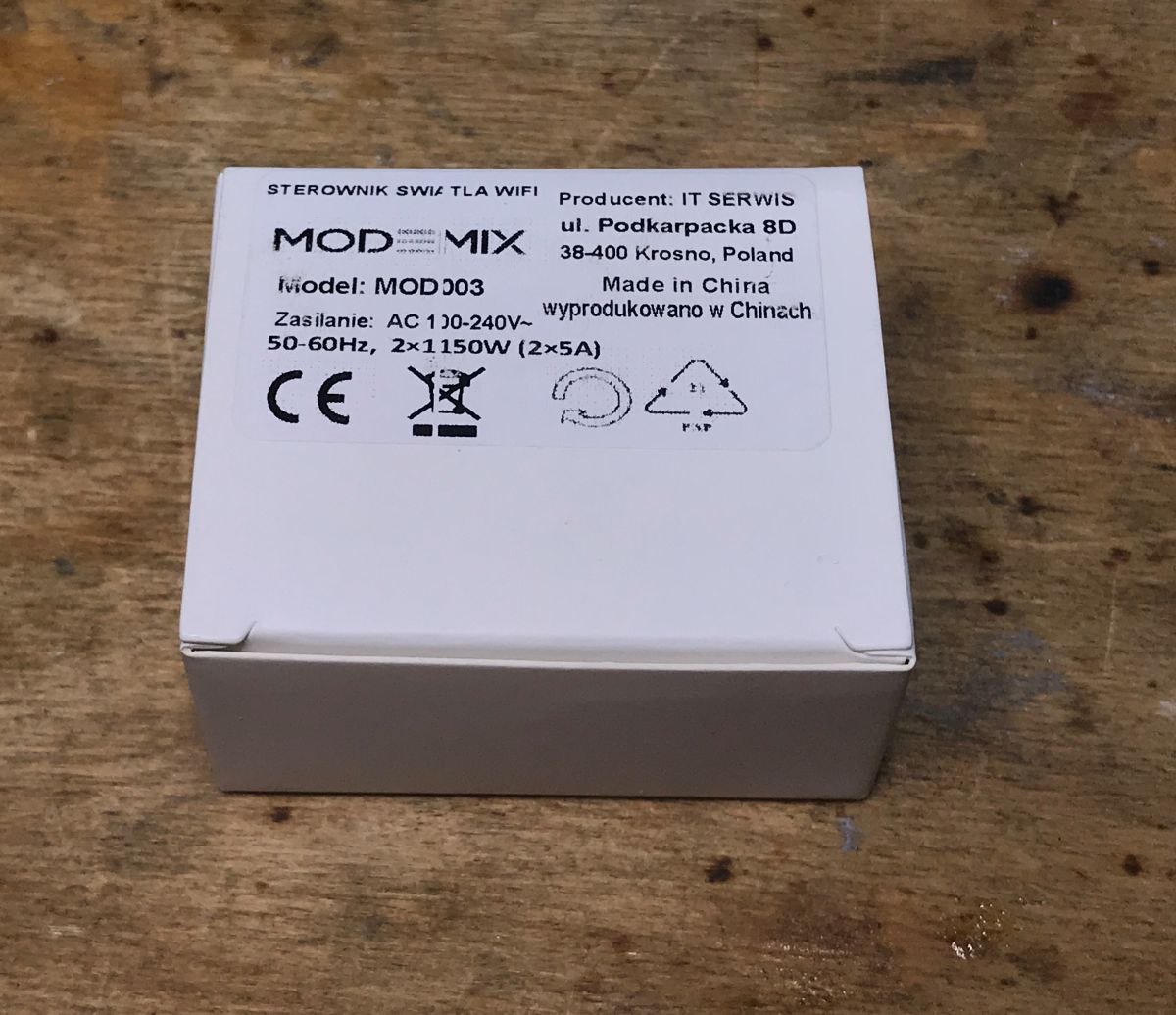

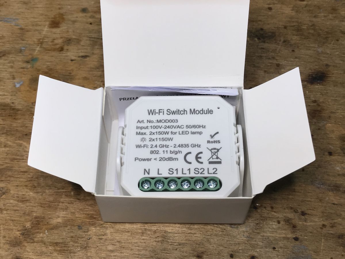

    Kit contents
    This time the set is quite poor. We don't even get screws or even a strip of double-sided tape for fixing. Pity.

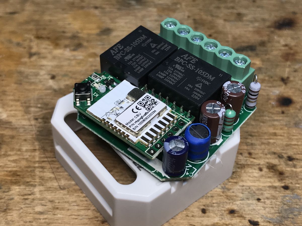

    Enough of the introduction, let's take a look inside.
    MOD003 interior

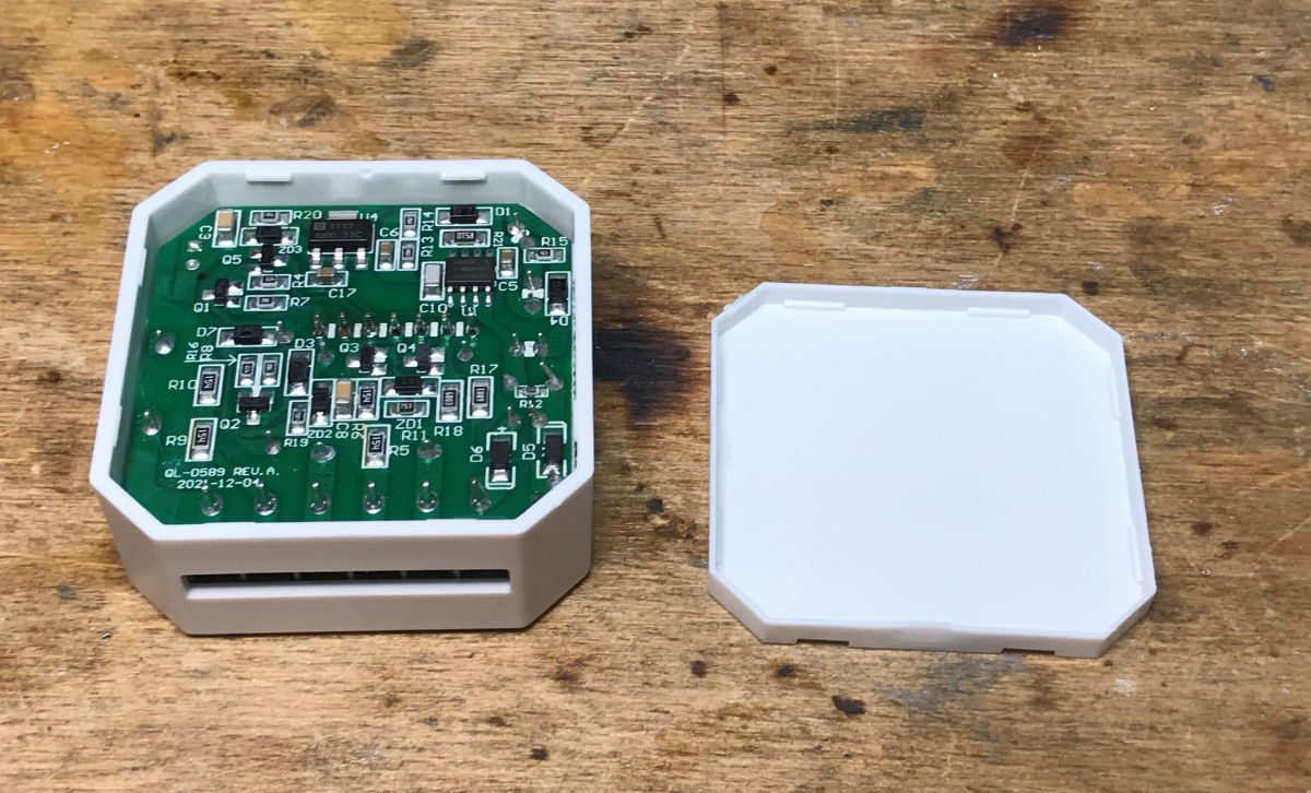

    As usual, it is enough to pry the casing. No screws.

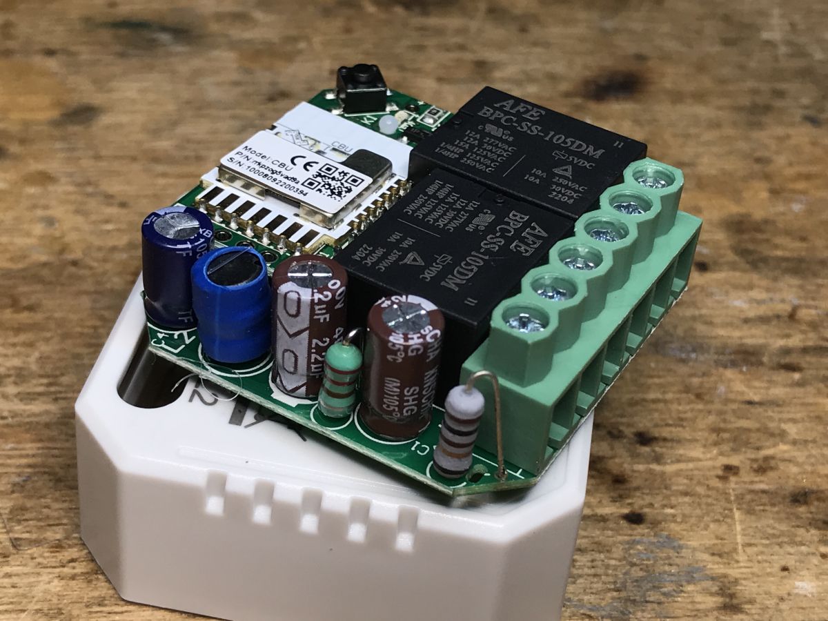

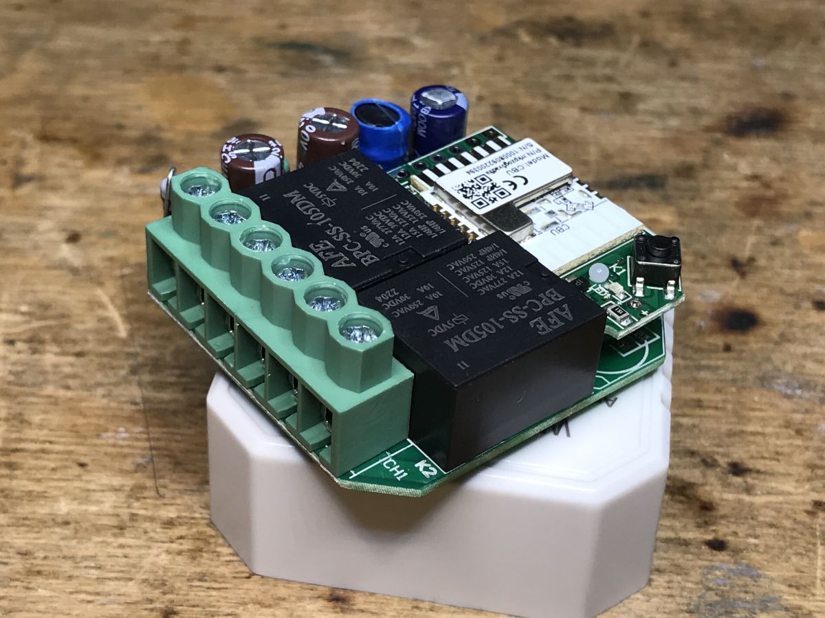

    [BK7231N/CBU] WiFi Modemix MOD003 Dual Light Controller [BK7231N/CBU] WiFi Modemix MOD003 Dual Light Controller

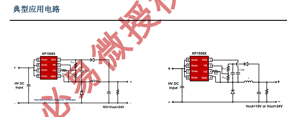

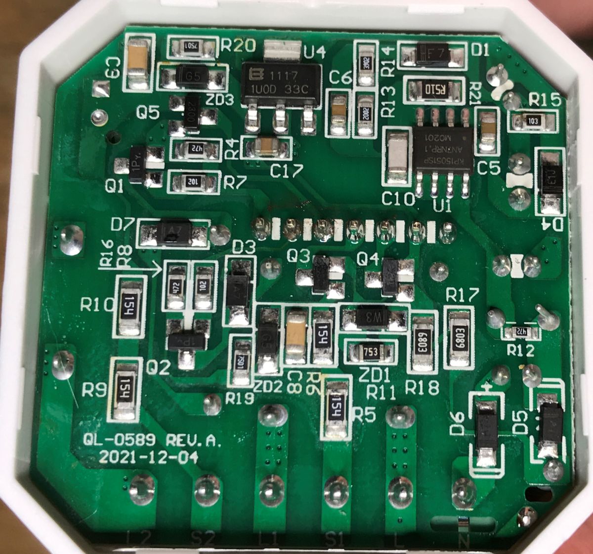

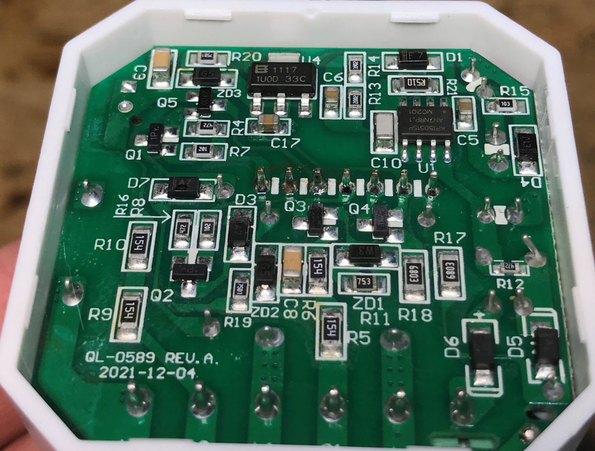

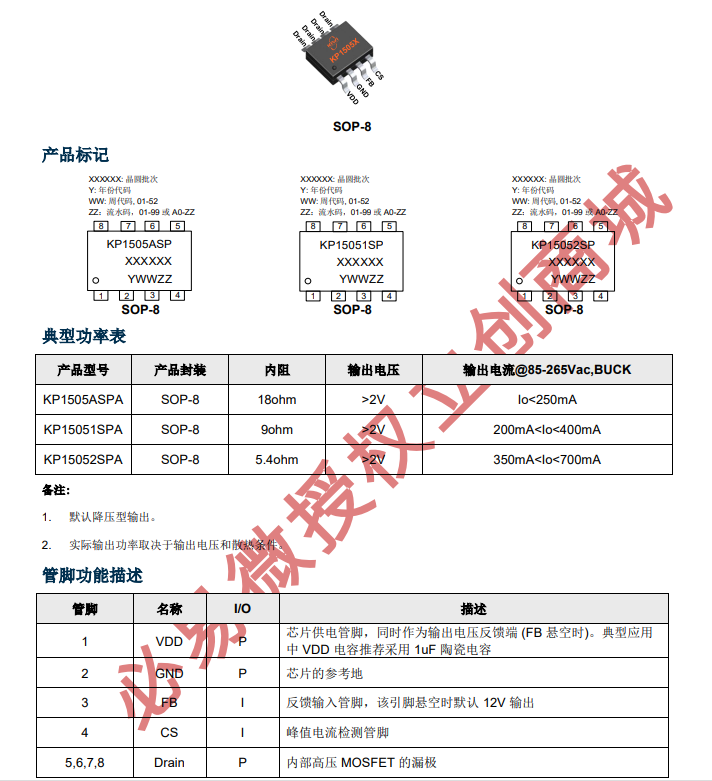

    Inside, you can see the LDO 1117 3.3V regulator and the KP15051SP transformerless converter controller.

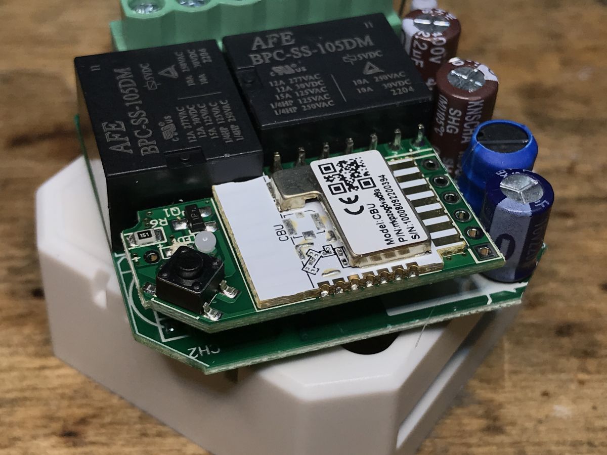

    Now you need to pull out the PCB. This time it comes out quite hard, it looks like there is a plate on the plate and something hooks.
    What is it that hooks?
    [BK7231N/CBU] WiFi Modemix MOD003 Dual Light Controller[BK7231N/CBU] WiFi Modemix MOD003 Dual Light Controller [BK7231N/CBU] WiFi Modemix MOD003 Dual Light Controller [BK7231N/CBU] WiFi Modemix MOD003 Dual Light Controller

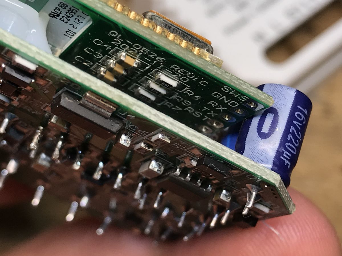

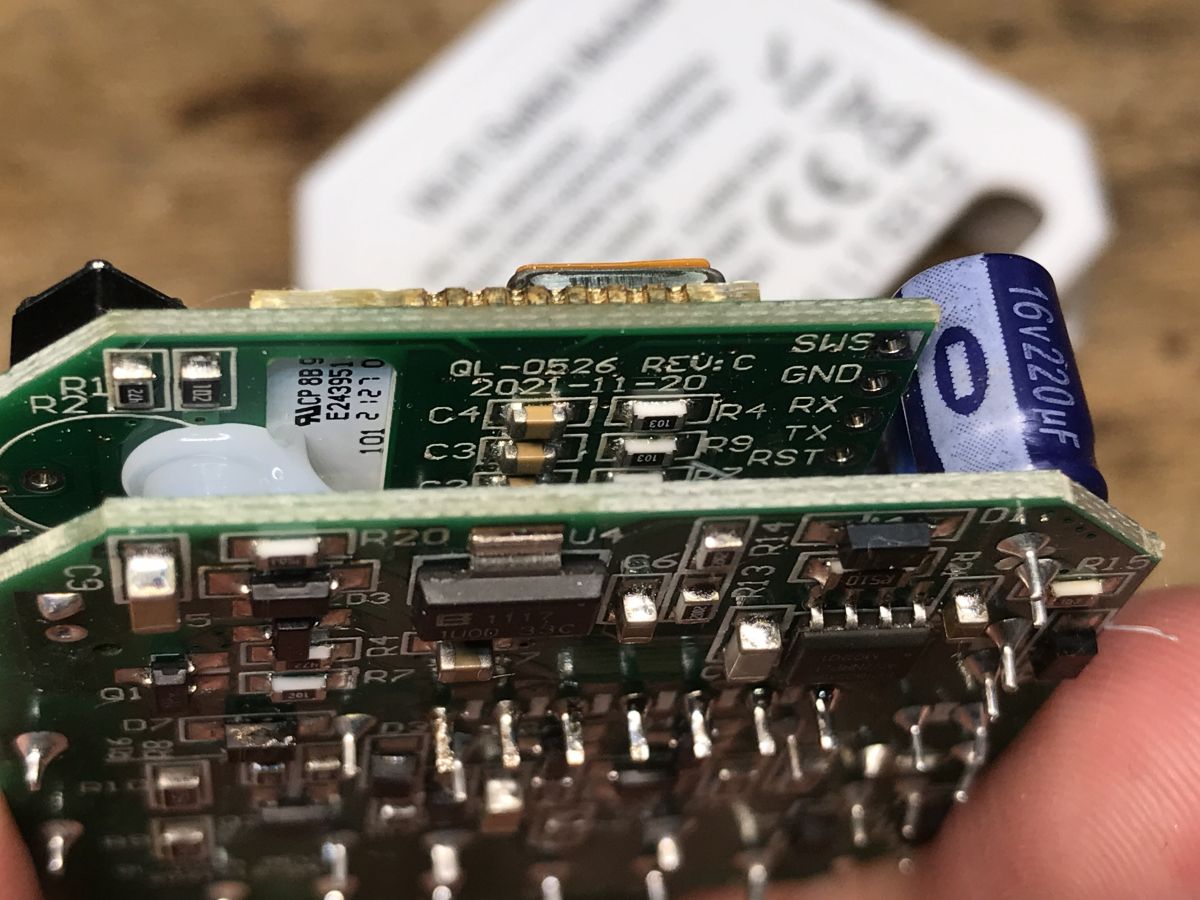

    The extra PCB with the CBU module hooked up. Interestingly, the pairing LED and the pairing button are on this additional board. Goldpins, ground, power supply and inputs for two buttons and outputs for two relays go from this board.
    Looking under this PCB, we can see the signal markings:
    The description of the CBU is also on the web...

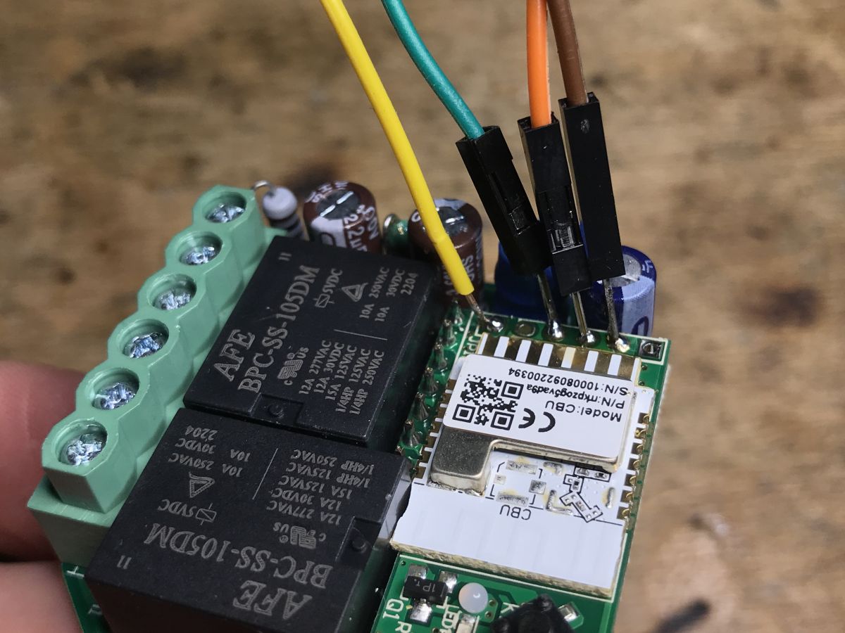

    Here are the soldered wires - RX, TX, GND and 3.3V:

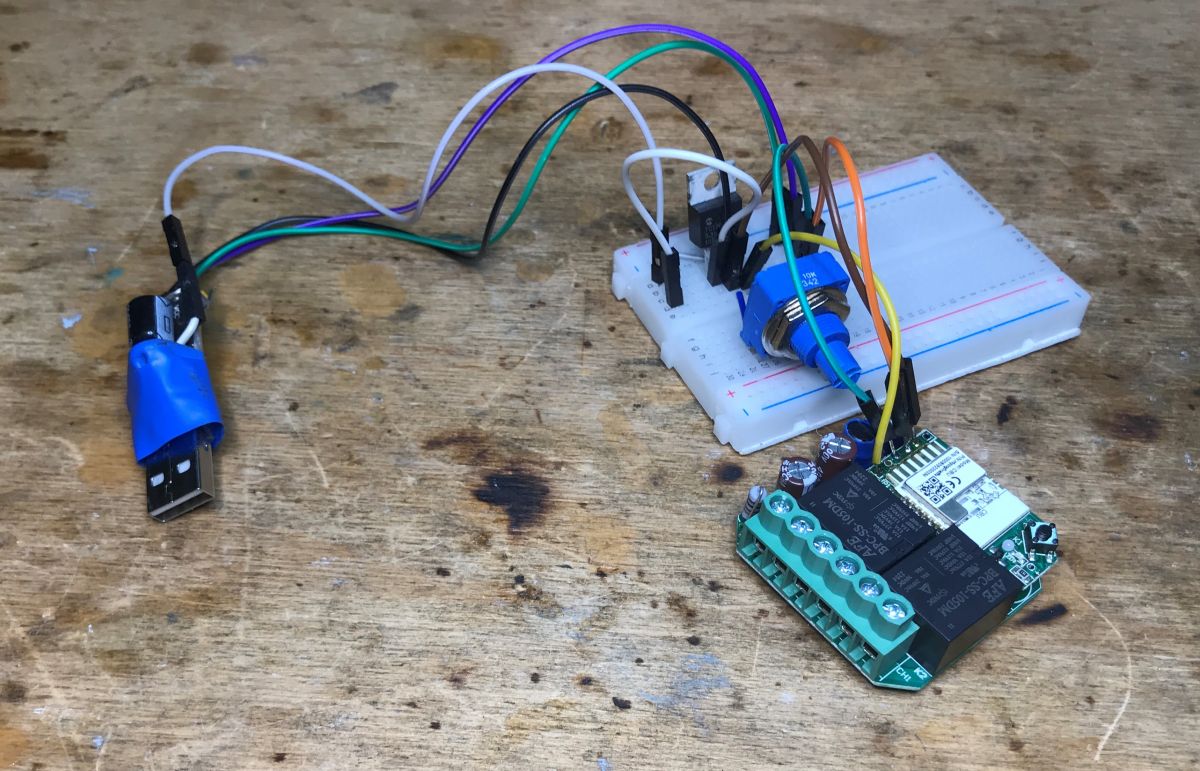

    Ready circuit with LDO 3.3V and USB to TTL converter:
    We program with this:
    It is important for this device to first disconnect 5V from the LDO, then connect the USB to TTL converter to the computer, then start the flashing procedure (Getting Bus), and then connect the power supply (then the Getting bus will be successful and the proper reading / uploading of the firmware will start) .
    In summary, the pins are:
    - P7 - WiFi LED
    - P9 - Relay 1
    - P17 - Relay 2
    - P8 - pairing button (from the housing)
    - P24 - Switch 1
    - P26 - Switch 2
