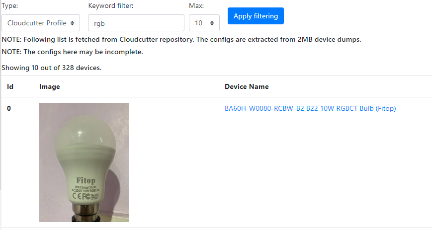

How to browse supported Tuya-cloudcutter profiles?
First please visit our IoT teardowns list:
Then, in search filters, select "Cloudcutter profile" and apply:
You can type anything into the filters and search for devices similar to yours.
