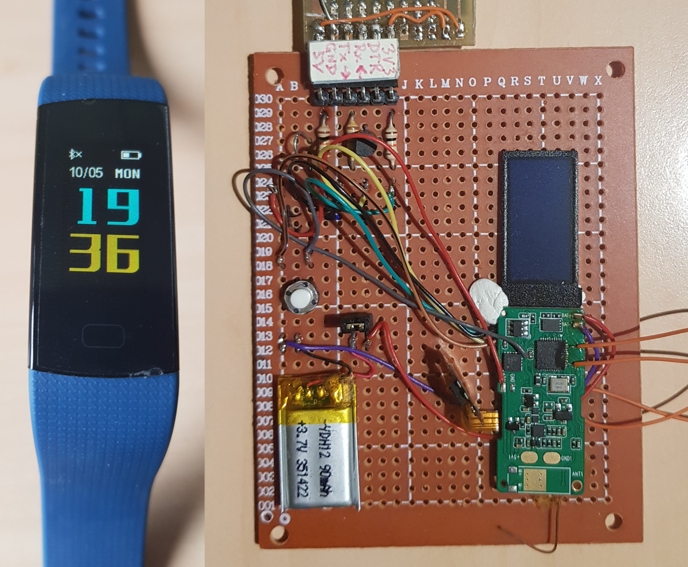

Recently, I presented the interior of a cheap smartband with a BT interface, a color display and several functions typical for this segment https://www.elektroda.pl/rtvforum/topic3975641.html. Now I will describe how to start programming this system.
The band is controlled by SoC DA14585 from Dialog (Renesas) with an ARM Cortex-M0 core. It has 96 kB of RAM and 64 kB of one-time programmable (OTP) memory. As it turned out, the system can be programmed, because it has an external FLASH memory connected via SPI. In addition, there are mini fields on the board for connecting the UART interface.
The discovery of the UART interface enabled me to establish communication and upload my own software using the programming tools provided by Renesas. The good news is that Renesas has released versions of these tools for Windows and Linux.

Preparation for programming
The board, after being removed from the headband housing, is quite bulky, the connections are made of thin wires and tapes, so it was necessary to place it on a larger "development" board.
I used a universal board for this, on which I placed some electronics and made connections with the board removed from the band.
It became useful during programming to lead the RESET signal outside.
Since the USB-RS232 converter works with TTL levels, it became necessary to use a level converter in the form of a resistor divider on the Tx line and a transistor shifting the levels from 3.3 to 5V on the Rx line of the converter.
For now, there is a wire shop, maybe I will make another more solid platform with the DA14585 board.

gulson 25 May 2023 14:46
Thanks for the article, lots of positives! Finally, something useful can be done with these wristbands. I guess everyone can't wait for the second part! If you would like to keep the gift, write... [Read more]
Mateusz_konstruktor 25 May 2023 23:27
Meanwhile, on the manufacturer's website ftdichip.com/products/ft232rl/ we read The point is that this integrated circuit has built-in pins that only require proper connection and we have support... [Read more]
Mlody_Zdolny 26 May 2023 23:12
The chip has this option, unfortunately my converter does not, because the Vccio terminal is permanently connected to +5 V. [Read more]
