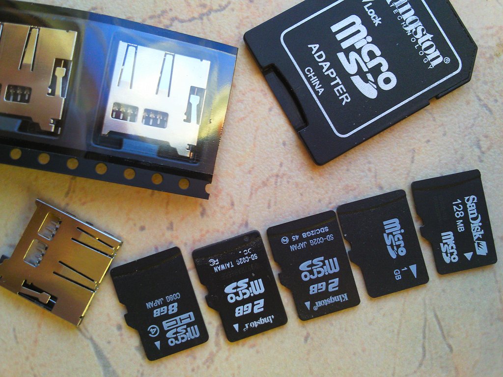

    The programmer supports cards MMC and SD . The cards I have tested are: 128MB, 512MB, 1GB, 2x2GB. The file names are optional, but on the display they will appear in DOS 8.3 format (8 characters + extension). Longer files will be separated by a tilde ( ' ), and if their names in the first 8 characters differ, the files will be marked with a sequence number. Diacritical marks and other inventions will also not be displayed - so I advise you to name the files legibly so that there is no problem with identifying them later.
    Planned: SDHC card support.

    LCD probably from Nokia 3310. How did you solder the memory card slot to the HA station? You did not think about your own production and sale of such a programmer before sharing the files. Make another housing.

    Very low, I only bought a card slot for PLN 3, Atmega328P-20AU for probably PLN 14, and I made 5 prototype boards for PLN 69 (i.e. one 13.8). The rest of the parts are small items that everyone probably has. The display and the eraser to connect it come from the phone. So as you can see, it comes out about PLN 30 :)
    No, a soldering iron with a very thin tip. I insert the SD card from the side, and through the holes you can clearly see what is happening. Only then I noticed that this plate from the socket can be easily removed (latches) and the next ones were soldered, disassembled and then the plate clicked into place. You just have to be careful not to lose the mechanism that ejects the card.
    maniak0790 wrote:
    You didn't think about your own production and sale of such a programmer before sharing the files.
    Of course I thought. But I give it completely for free ;)

    stepawel wrote:
    I think that the programmer could still communicate via USB with the computer.
    Well, I was already offered it, but I still don't understand why? The card itself provides great convenience. Hm?
    stepawel wrote:
    Of course, I'm giving it a nice one, although it's definitely too low a grade
    Thank you, thank you.
