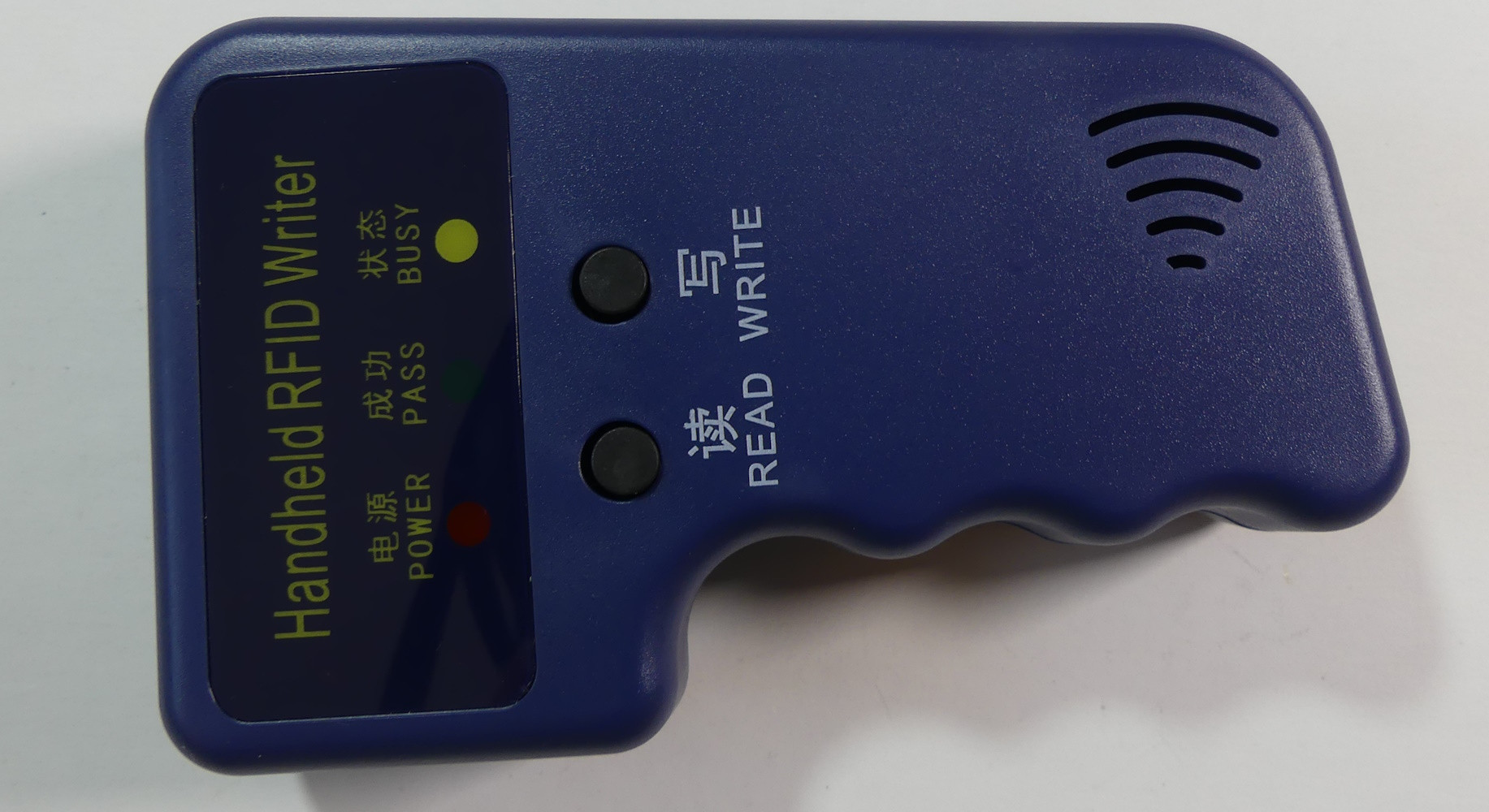

  • The teardown examines a UNIQUE 125 kHz key copier used to duplicate access tags after a move.
  • Inside are two AAA batteries, a UNIQUE communication coil/antenna, a small PCB, and a main control unit marked F300.
  • The copier reads a constant 64-bit string from a tag and writes 8 bytes to T5577 or EM4305 key fobs.
  • U1 generates the read control signal, Q1 drives the buzzer, and Q2/Q3 control coil current; detection takes 10 ms.
  • The author flags security concerns about multi-system copiers claiming 125 kHz to 1000 kHz support and bundled software that may hide extra features.
In the material you will see the inside of the UNIQUE tag copier, which made it easier to use the space after the company moved. Part of the building is separated by doors equipped with electric strikes and keyfob/card readers. The problem is that only three of the transferred tags work, each entrance has a different type of reader, one of which even has a buffer power supply, the rest is powered by plug-in power supplies connected near the passages, the company that serviced it has no contact.
Of course, we will replace this "system" with connected MIFARE readers, but everything in order. To make it easier for yourself, you need to "multiply" your UNIQUE tags. A copier was used for this, reading a constant string of 64 bits from the applied tag to memory and writing a string of 8 bytes to the T5577 or EM4305 key chains. In this way, for "PLN 100" we have the freedom to move around, without excessive investment in a makeshift, which is intended for disassembly.
Below is the inside of the copier, which is mostly empty space :) a basket of two AAA batteries, a UNIQUE communication coil/antenna and a small printed circuit board. The main control unit is designated F300.
Transistor Q1 controls the buzzer without a generator, transistors Q2 and Q3 control the coil current. U1 during the reading generates a control signal that goes through R8 to the transistors.
The signal on the coil looks like this:
Detection takes 10ms.
There are no SMD components on the other side of the PCB.
The device did its job well and we will not waste funds on checking how to change the settings of existing readers, especially since each of them is of a different type and some of the cards did not work. This is a good solution to reduce the urgency of replacing the access control system.

prosiak_wej 03 Jun 2023 21:13
I found such a copier for PLN 10 with a bag of keyrings. As it turned out, it is not compatible (keyrings too) with the KD system that we have in the company. On the other hand, for copying Mifare, I use... [Read more]
szymon122 03 Jun 2023 21:24
What is the general process of "programming" a TAG? It receives some command, then 8 bytes and then sends these 8 bytes each time? Is such a tag writeable only once? [Read more]
TechEkspert 03 Jun 2023 22:09
The keychains are programmable many times and cost about PLN 3. Originally, UNIQUE key chains and cards had a factory-assigned number just like "Dallas pills" DS1990A. I wonder why the programmed keyrings... [Read more]
prosiak_wej 03 Jun 2023 22:43
My tags (cards and keyrings) are rewritable, you can delete, assign your own numbers. [Read more]
nukedclxx 04 Jun 2023 06:09
I have a similar device somewhere and you can select several different frequencies, but the cards that I use at work do not respond, practically no other reader except those at the company, even a pinball... [Read more]
TechEkspert 04 Jun 2023 10:08
I changed the title to 125 kHz, out of curiosity you can check your KD, whose tags cannot be read. Using an oscilloscope and a coil close to the reader, you can determine what frequency your system is... [Read more]
