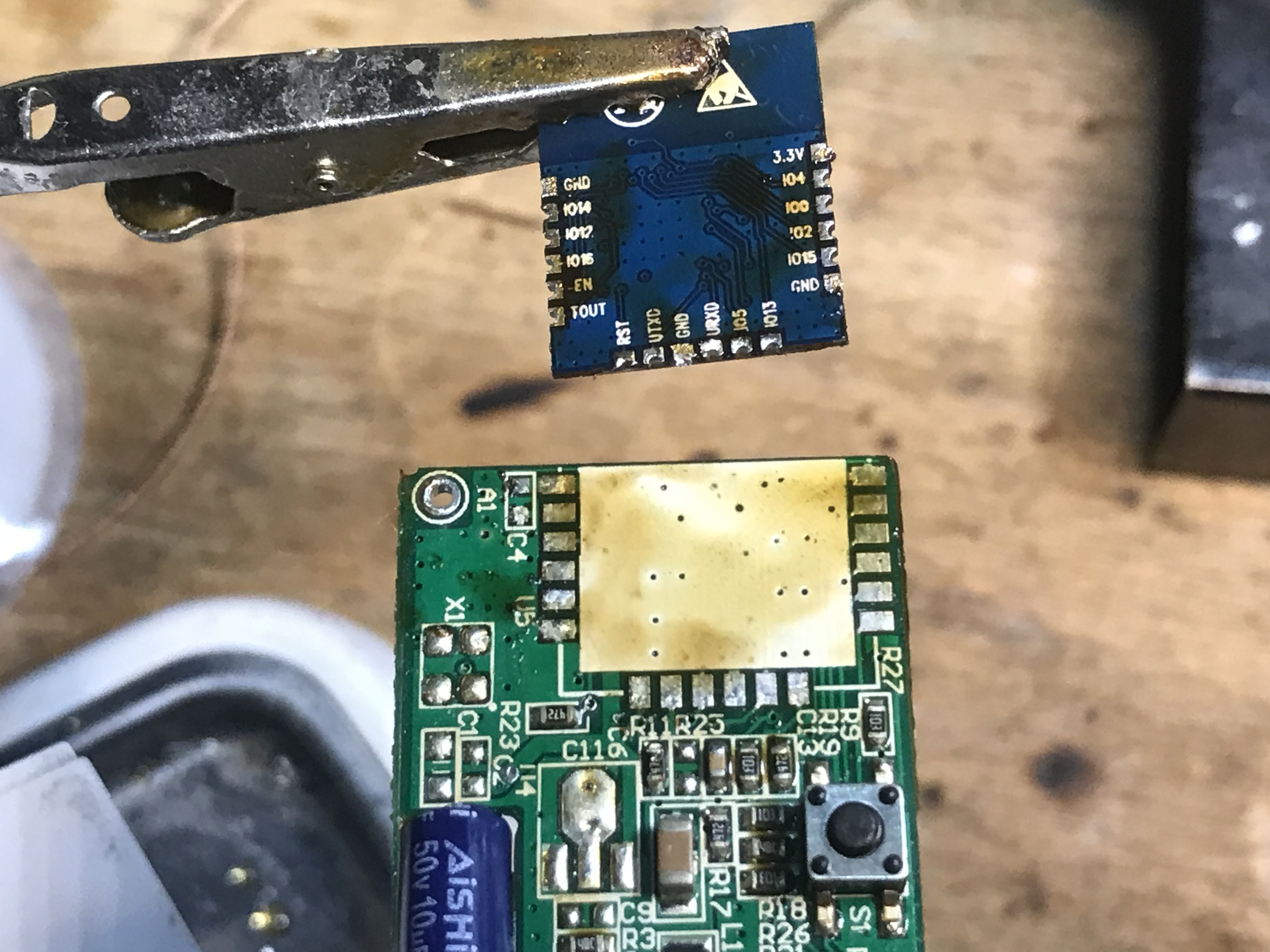

Tasmota I managed to upload it, but the issue of the template remained... I decided to desolder the WiFi module to learn its markings. I applied additional flux and a bit of lead binder to the February:
Hot air moves and after a while we have a desoldered module:
We can also see its outputs, they are signed on the descriptive layer:
This allowed us to identify the module - after all, it is LM1, its pins are documented on the network:
WiFi Module LM1 and Pinout Diagram
I also did a short analysis - where the path leads.
As you can see, this analysis will also be useful for the RGBCW version. I described all five transistors:

Additionally, I also mapped the button, but it seems to me that it is not marked correctly in the photo. If I find a moment, I will check the configuration of the bar and update the topic, and if not, you can try to trace the paths.
Finally, a nice photo taken before soldering the WiFi module into place (pads cleaned):
