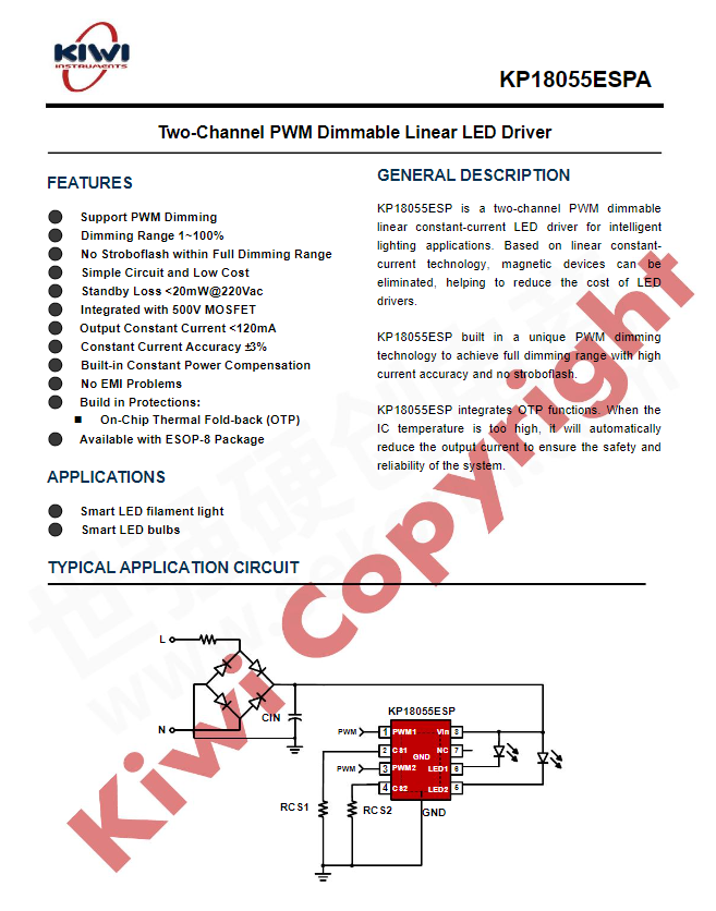

    You can see the LED driver: KP18055ESP AM87RG.1
    This is a dual channel controller, just right for CW:

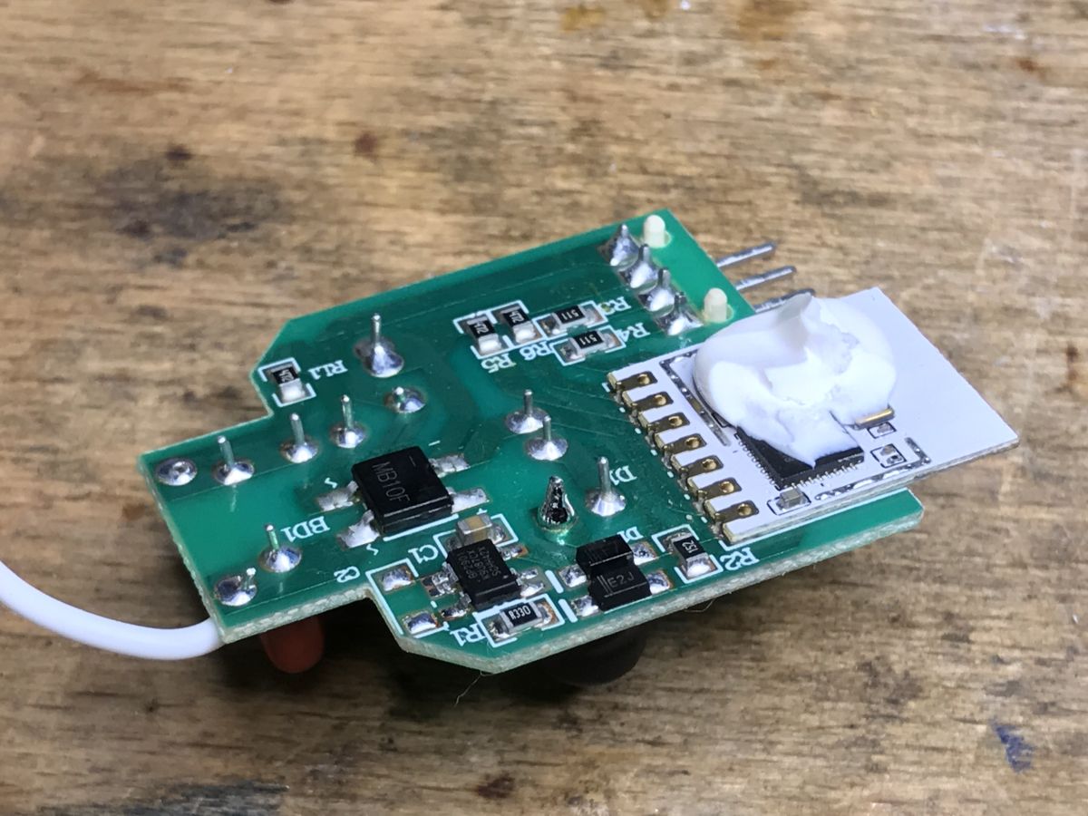

    Then you can take out the PCB:
    [BK7231T/WB2L] LSC Action CW 3000272 970715 v1.1 LED E27 version WB2L
    The fuse resistor is there, but outside the PCB. Varistor, filters missing?
    Electronics:
    [BK7231T/WB2L] LSC Action CW 3000272 970715 v1.1 LED E27 version WB2L [BK7231T/WB2L] LSC Action CW 3000272 970715 v1.1 LED E27 version WB2L
    MB10F rectifier bridge, BP2901 controller.

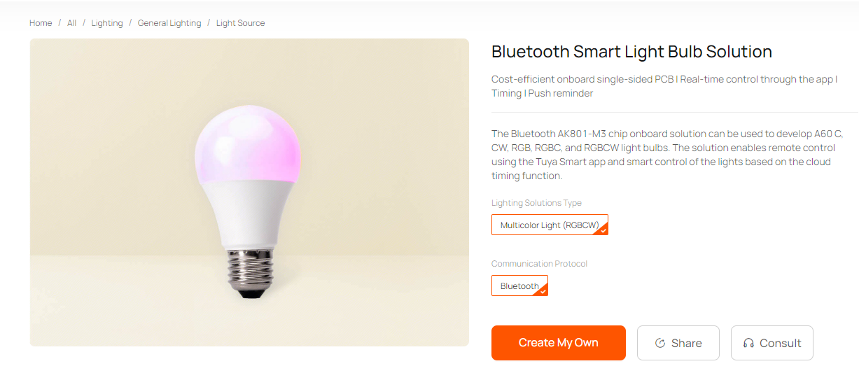

    I did not find the BP2901 catalog note, but looking for information about the LED driver, I found the Tuya website, this product is probably their "template" LED lamp:
    https://solution.tuya.com/projects/CMax4riki12xpt
    Although the BT module does not match:
    There is a diagram on this page:
