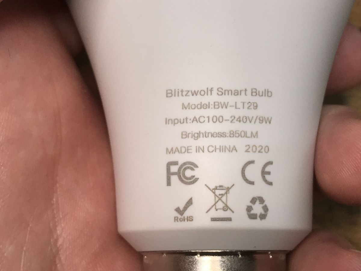

    Blitzwolf BW-LT29 is a WiFi-controlled LED lamp with an E27 socket, offering control of brightness and white temperature (range 2700-6500K). This lamp deserves special attention because, like other Blitzwolf products, it allows you to easily change its charge to such a cloud-independent one, what's more, I have not yet encountered a situation where someone found a Blitzwolf product on a different WiFi module than one based on ESP8266 or ESP8285, so you can easily flash Tasmota.
    Here I will show its interior, programming procedure and provide a proven Tasmota template.

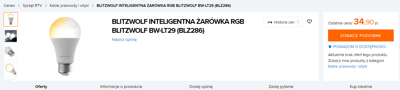

    Purchase of the LT-29
    I got the lamp to upload the firmware to a friend, unfortunately the lamp was bought some time ago, so we do not know where it was ordered from. A short search on the web shows that it is quite cheap, you could even get it for PLN 40 back in the day.

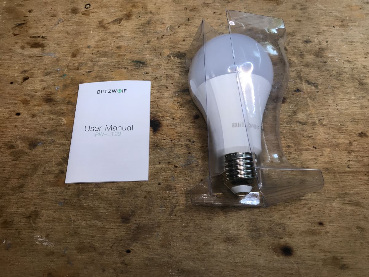

    Let's take a look at its packaging:
    [ESP8266] Blitzwolf smart LED LT-29 850Lm WiFi CCT (white temperature control) [ESP8266] Blitzwolf smart LED LT-29 850Lm WiFi CCT (white temperature control) [ESP8266] Blitzwolf smart LED LT-29 850Lm WiFi CCT (white temperature control) [ESP8266] Blitzwolf smart LED LT-29 850Lm WiFi CCT (white temperature control)

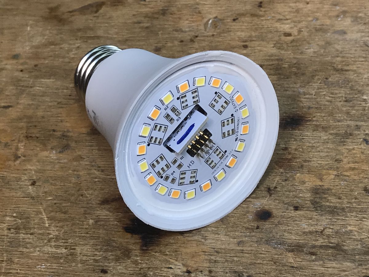

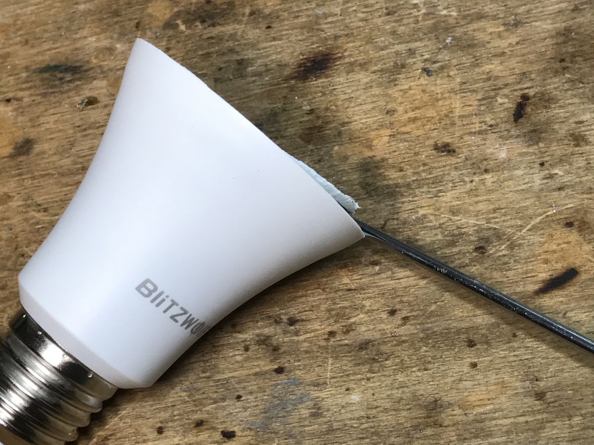

    We start quite typically, we undermine the glued dome and reveal the LEDs:
    Then we pry the plate with LEDs, do not pull the connector because we will tear it off, we pry the whole plate:

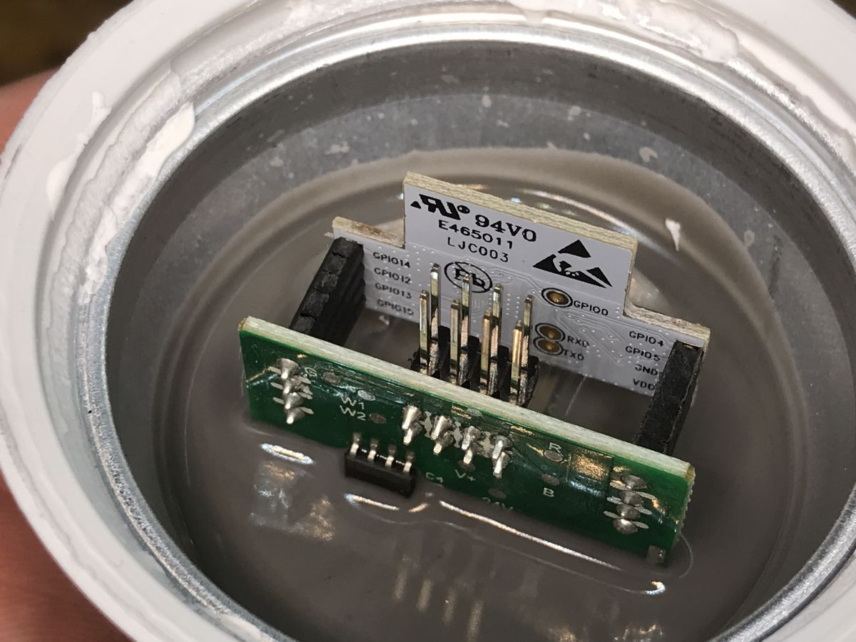

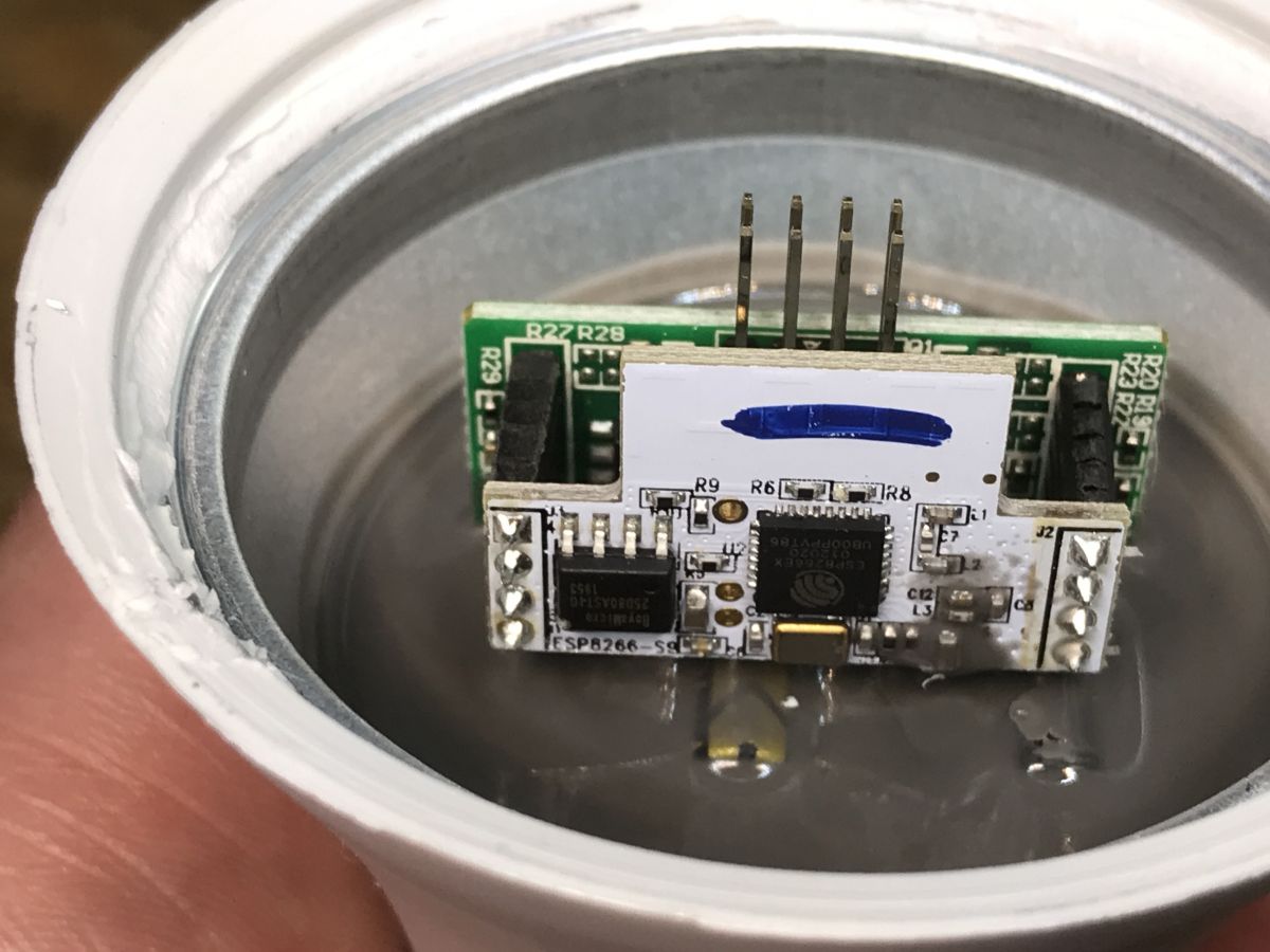

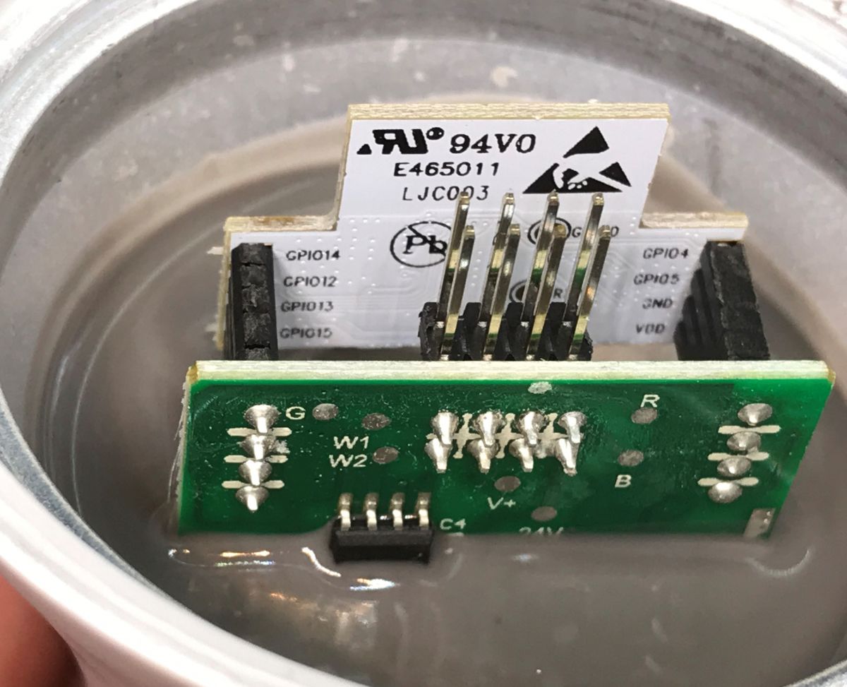

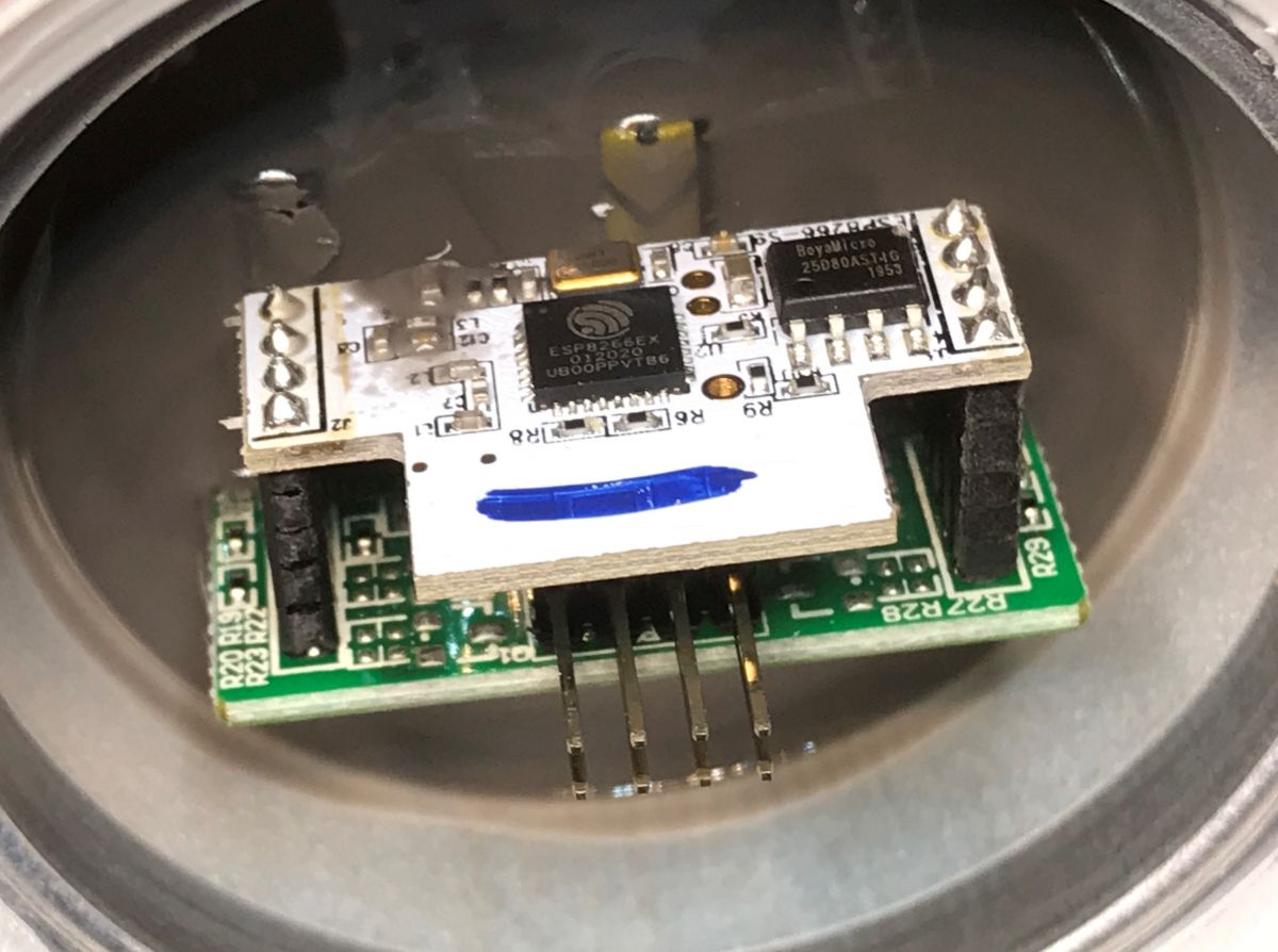

    And then we have a surprise - the PCB is flooded with silicone or a similar material:
    Indeed, there is the ESP8266EX, you can also see its Flash memory chip next to it, you can see its resonator, there is even an IO0 pad that we need to enter the programming state (IO0 must be low) ... you just need to get there.

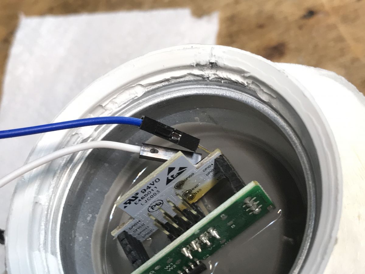

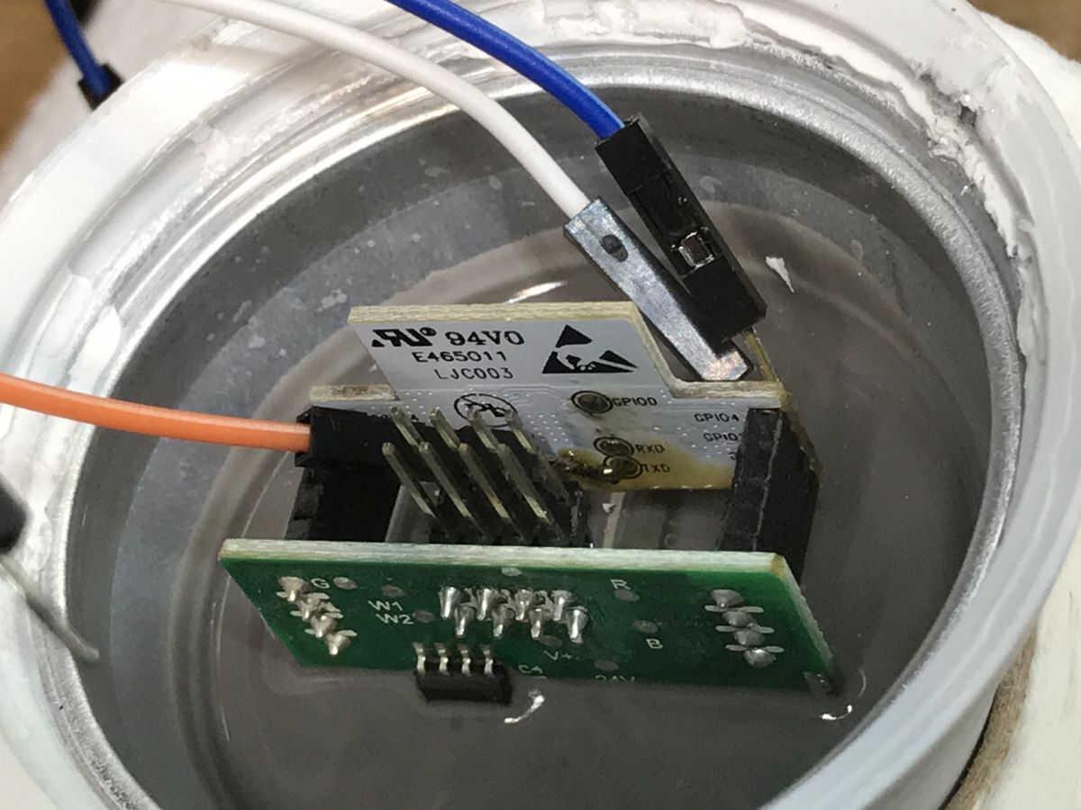

    Change of LT-29 firmware

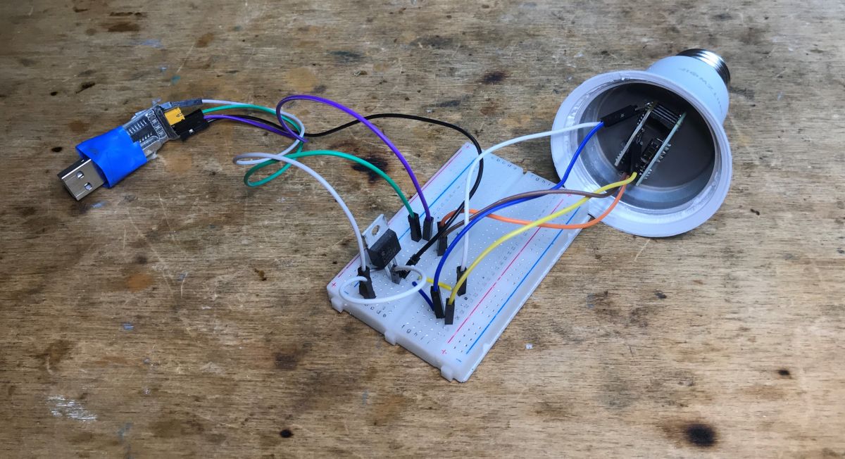

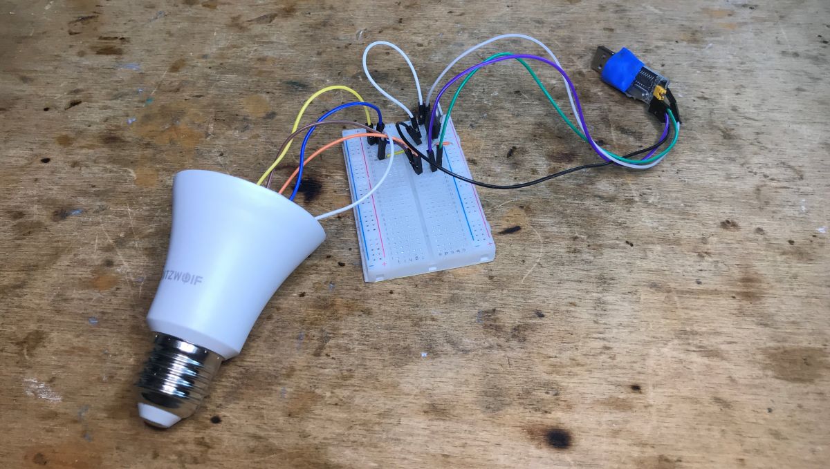

    There is no way out - we apply flux, whiten the pads, wires and try to solder. We need 3.3V, GND, RX, TX and IO0:
    I power the whole thing from the LDO TC1264 regulator (I just had one), 3.3V must have high current efficiency, I also use a USB to UART converter in 3.3V mode:
    I do not connect RESET, I just cut off the power and reconnect it when I want, for example, after the read operation (batch read - backup) to write (upload Tasmota).
    I upload the batch via esptool.py, of course I upload Tasmota.

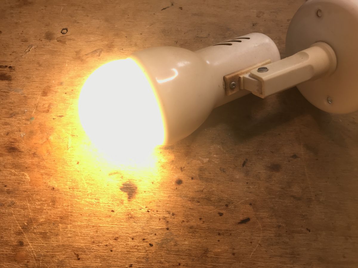

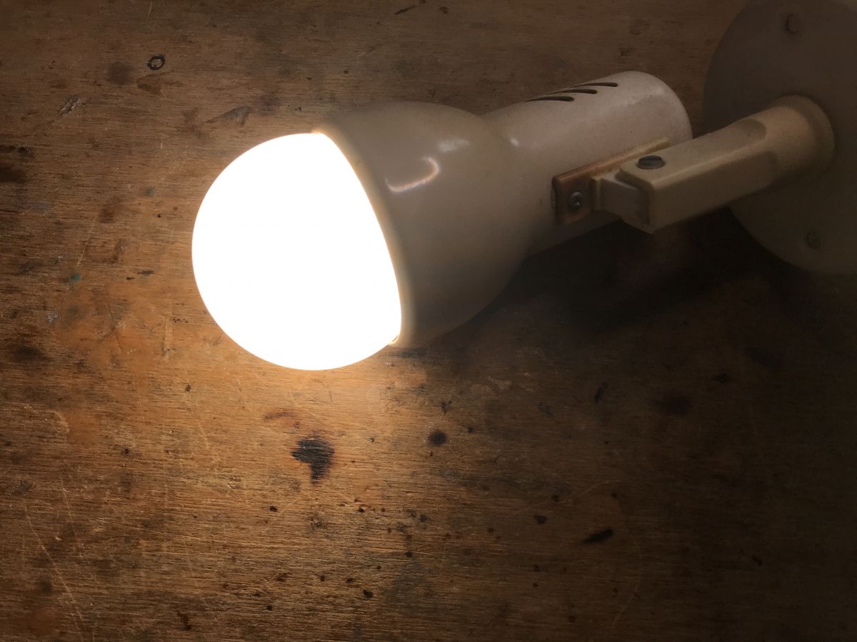

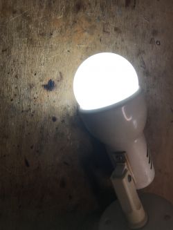

    After that, we can enjoy a fully local LED lamp without the manufacturer's cloud:
