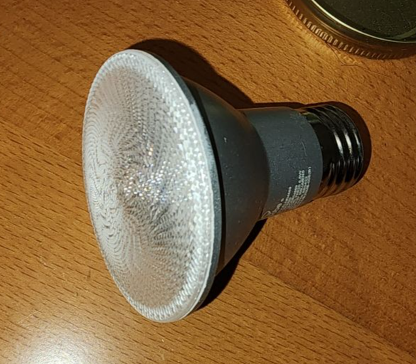

To preface this, I will probably go into more detail than is needed but, it is good for people who dont have much experiance in this realm. I will take you from disassembley all the way to final config with pictures!
This bulb has an FCC ID and photos from the FCC but, the revision 1 bulb used the 7321T chip (tuya cordcutter exploitable) while my version of the bulbs is version 3 which uses the 7321n chip. If you have firmware 1.31.21 you can use tuya cloudcutter (so dont upgrade in the smartlife app). If you have 1.5.21+ then the tuya cloudcutter exploit is unavailable.
The way I found out these were v3 was using tinytuya and getting the local key for the devices. In the tuya dump JSON files it has a string of "34869 V3". Also of note is, "sn", which holds a string which corresponds to the QR Code sticker that is on top of the 7321n chip when disassembled.
Excerpt of tinytuya devices.json:
Let's begin the disassembly:
First a photo of an undisturbed bulb:
An unassembled LED bulb lying on a wooden table.
Take the Live input cap off of the bulb socket, you can use a fingernail to get under the lip to pop it up:
Non-disassemblable bulb on a table with a metal socket.

Congrats! you now have an OBK device that is local only! Enjoy!
