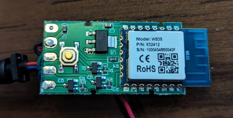

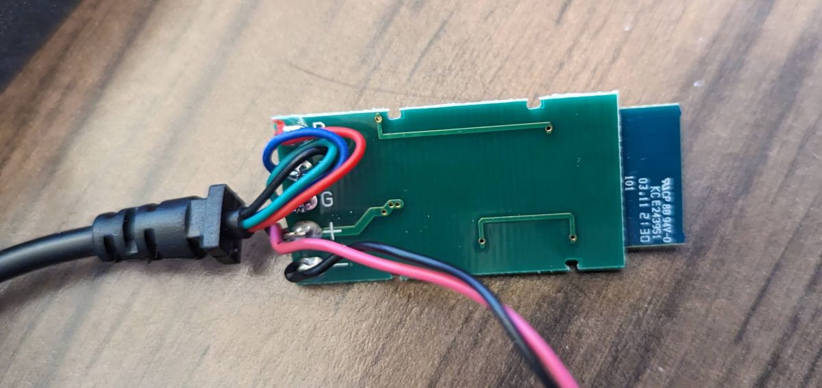

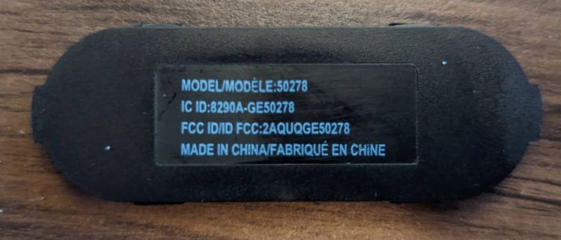

  • Globe Electronics WiFi RGB Smart Strip Light 50278 is a 3m USB-powered RGB LED strip sold at Menards for $8.99 USD.
  • Flashing had to be done via serial because CloudCutter did not work, likely because the firmware was too new.
  • The pin config maps 6 to dInput;0 and 9, 24, 26 to PWM;1, PWM;2, PWM;3.
    Purchased at Menards (US) for $8.99 USD
    3m of RGB LED lights, powered by USB
    Flashing had to be done via serial - cloudcutter didn't work as the firmware may be too new.
    Pin Config
    "6": "dInput;0",
    "9": "PWM;1",
    "24": "PWM;2",
    "26": "PWM;3"

    Thanks, I can also see your pull request:
    https://github.com/OpenBekenIOT/webapp/pull/69/files
    I will accept it but next time please also fill "module" field
