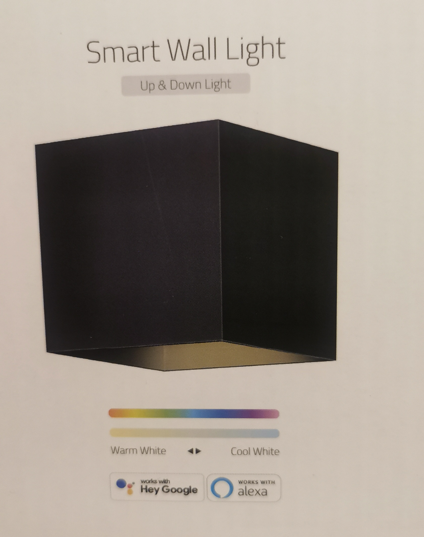

I have a "Smart Wall Light" with
* Wifi
* 5CH RGB+CCT
Modern wall light in a cuboid shape with WiFi support and RGB+CCT control.
Technical specifications of a smart wall light with WiFi function on a yellow background.
Advertisement for an LED lamp with smartphone and voice assistant control features, showcasing colorful home lighting.
https://www.amazon.de/gp/aw/d/B09N77KL7M
Tuya_App Informatik:
Main&MCU v1.1.8
After flashing with OpenBeken, no function.
Profile: Tuya Generic - Smart Wall Light v1. 1.8
