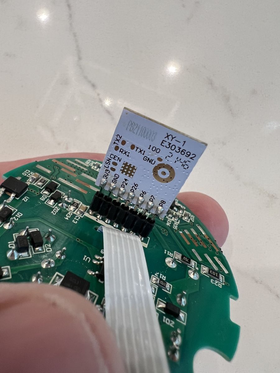

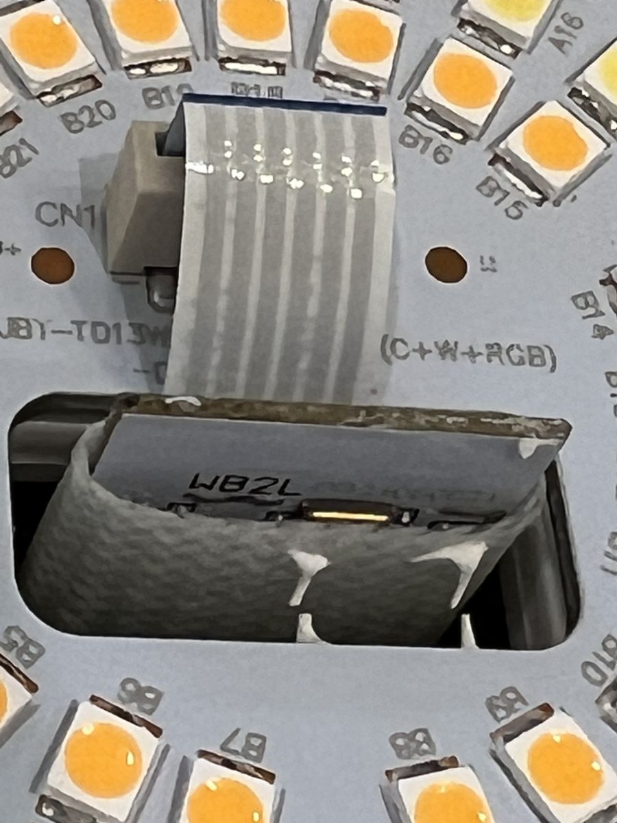

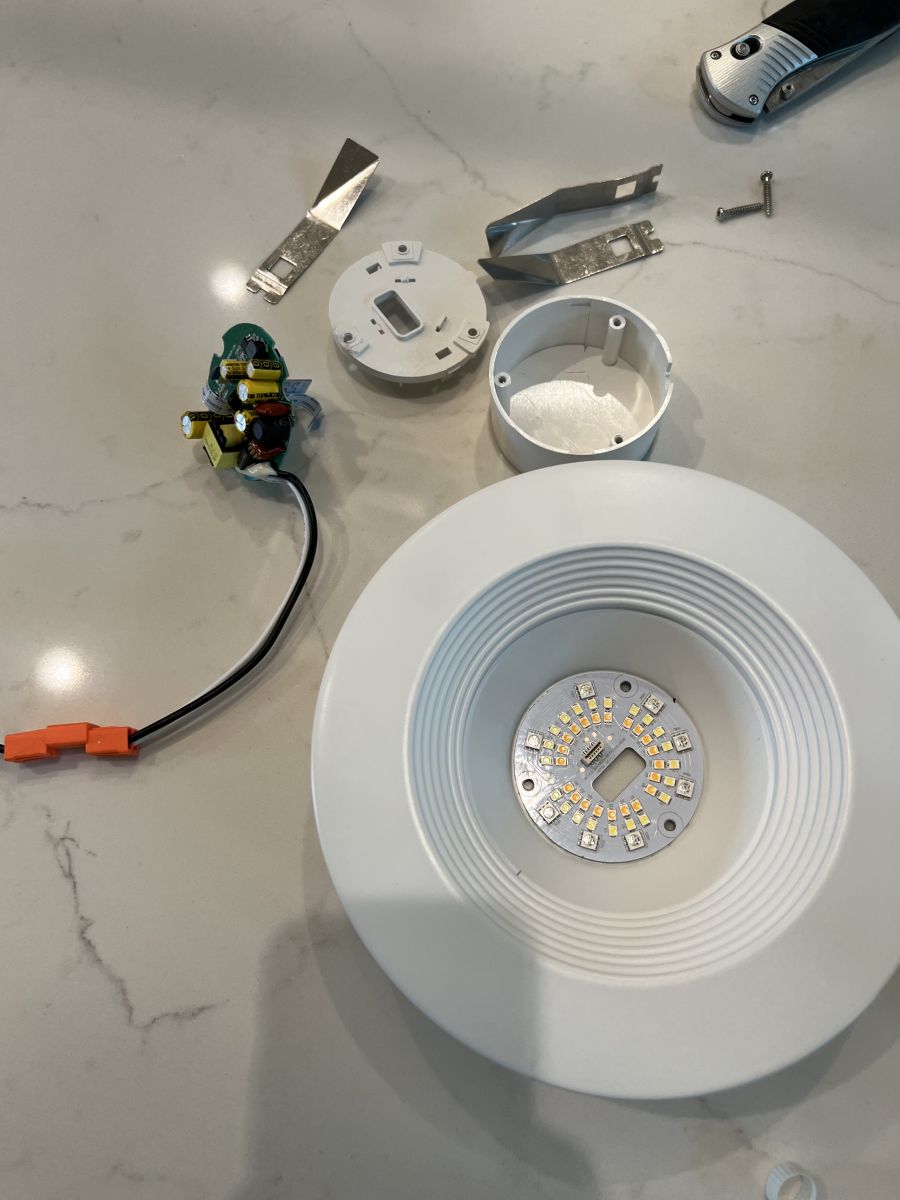

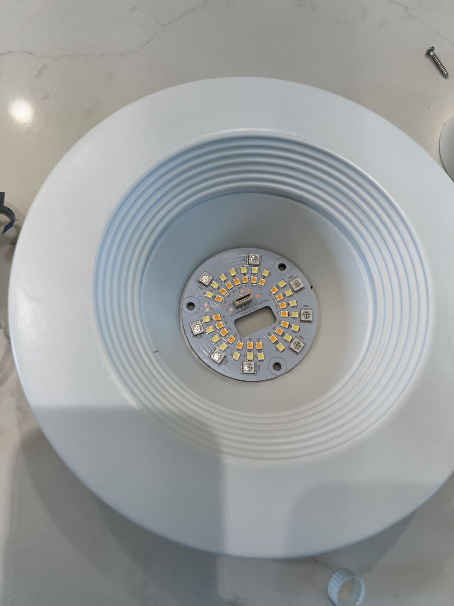

  • Lumary 5/6 Inch Downlight uses a BK7231N/CB2L module and a KP18058esp LED controller for an OpenBeken driver setup.
  • Accessing the internals requires removing the diffusing filter, undoing 3 screws, unplugging the ribbon cable, and gently prying off the back cover.
  • The CB2L module is soldered to the power board, and the plastic housing is very soft and brittle.
  • Remove diffusing filter.
    Undo 3 screws.
    Unplug ribbon cable from LED board.

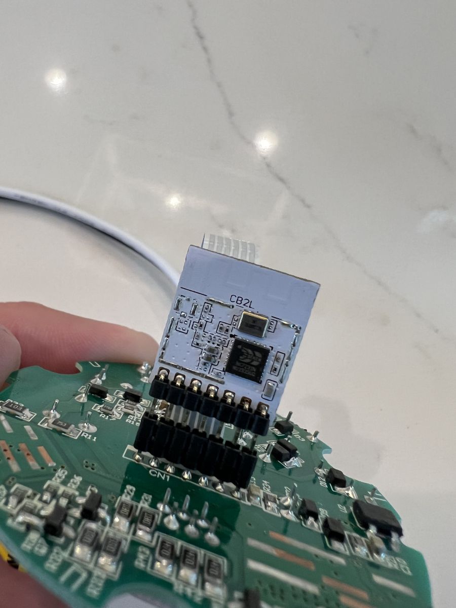

    Gently pry off back cover with small flat tool. Plastic is very soft/brittle.
    CB2L module is soldered to power board.

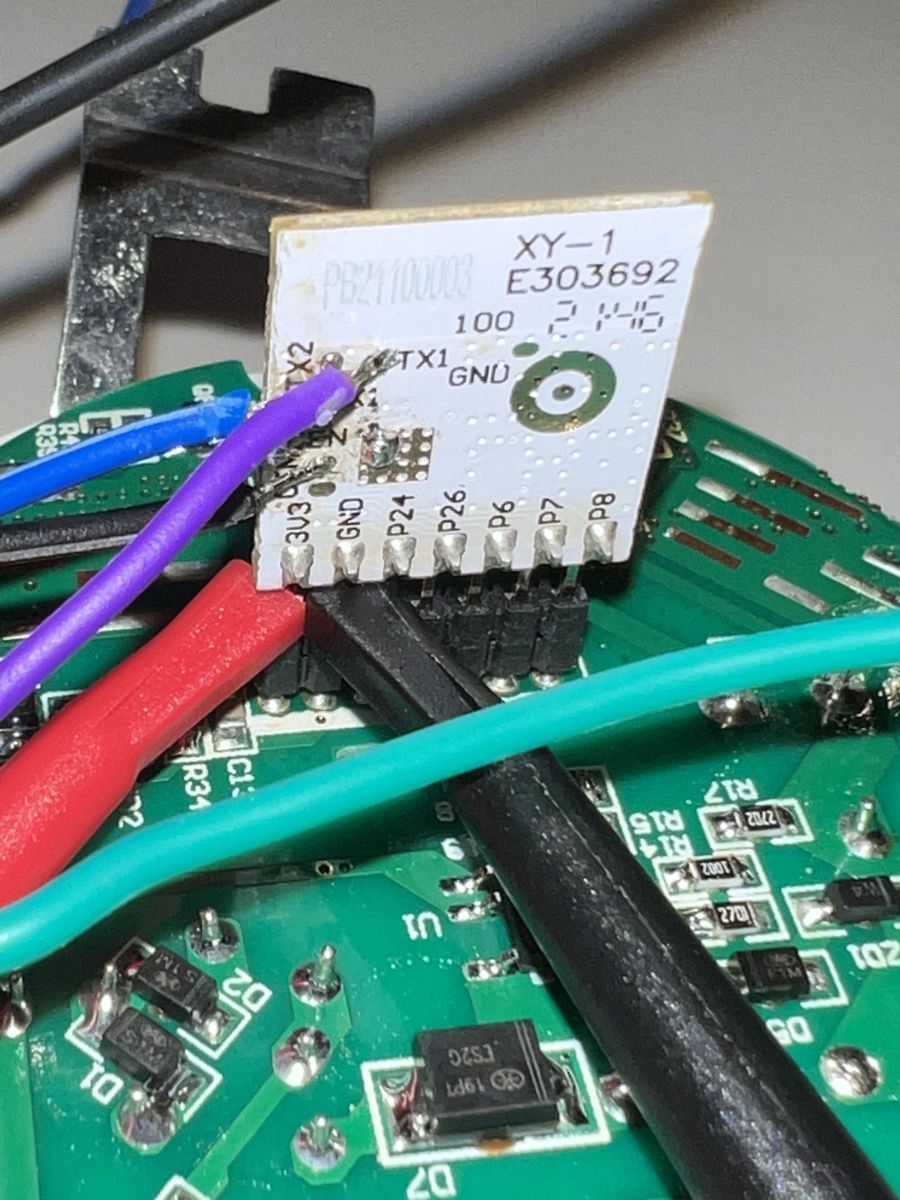

    Python does work - someone posted earlier - https://www.elektroda.com/rtvforum/topic3984791.html
    Issue was with forms.
    System.Windows.Forms.dll
    "The Carbon driver has not been ported to 64bits, and very few parts of Windows.Forms will work properly, or at all"
    Was able to get the app working in VM.

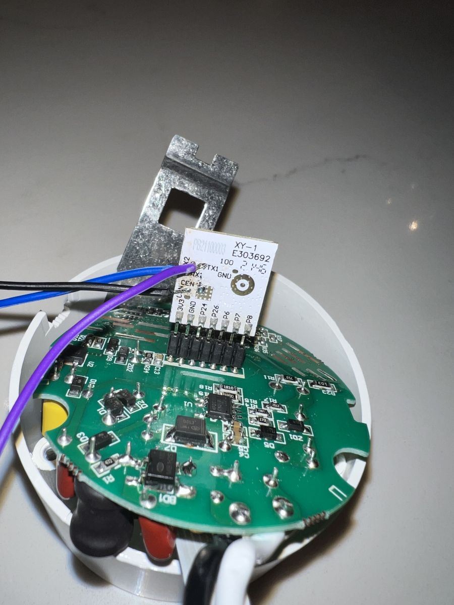

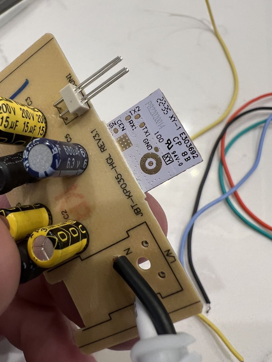

    Continuing breakdown and UART flashing -
    Wire up power to extension pins and grab TX, RX, and CEN off the back of the board.
    [BK7231N/CB2L] Lumary 5/6 Inch Downlight - OpenBeken driver for KP18058esp LED controller
    CEN can be grounded to the large ground pad on the board.
    Below is the dump information:
    - LED Green (Channel 2) on P24
    - LED Cool (Channel 4) on P8
    - LED Blue (Channel 3) on P6
    - LED Warm (Channel 5) on P7
    - LED Red (Channel 1) on P26
    Device seems to be using CB2L module, which is using BK7231N.

    Just got a single pack of one of these and it uses a different module. There isn't consistency. Configuration values are the same. Module firmware from Lumary before flashing was 2.3.x in the Tuya app.
    Selected by firmware and it flashed OTA like normal.

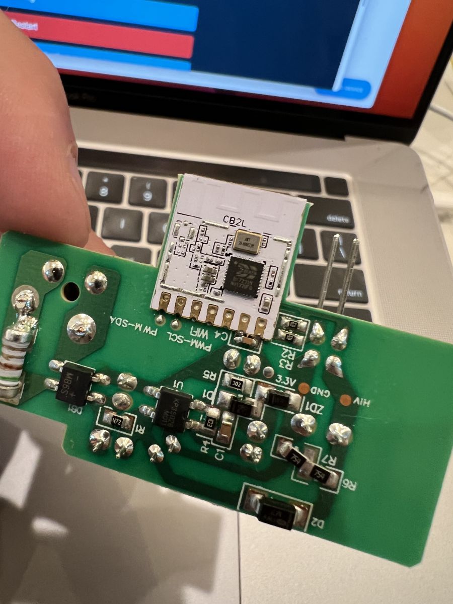

    Added after 1 [hours] 29 [minutes]:
    Plot thickens. Manf date 2022, Aug. Completely new revision of the board. Could not configure the pins the same. Light wouldn't work. Opened it to see what was going on.
    Module CB2L
    Had to cut the board to expose the back of the module for the pins.
    [BK7231N/CB2L] Lumary 5/6 Inch Downlight - OpenBeken driver for KP18058esp LED controller [BK7231N/CB2L] Lumary 5/6 Inch Downlight - OpenBeken driver for KP18058esp LED controller
    And cannot find tuya config
    Backup 2MB created, now will attempt to extract Tuya config.
    Failed to extract Tuya keys - magic constant header not found in binary
    Sorry, failed to find Tuya Config in backup binary.
    Bin attached
    • readResult_BK7231N_QIO_n_2023-28-6--20-29-59.bin (2 MB) You must be logged in to download this attachment.

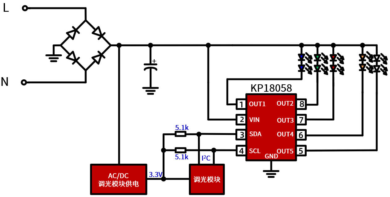

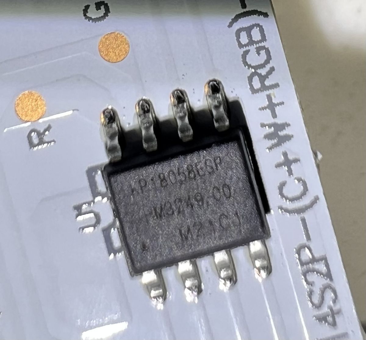

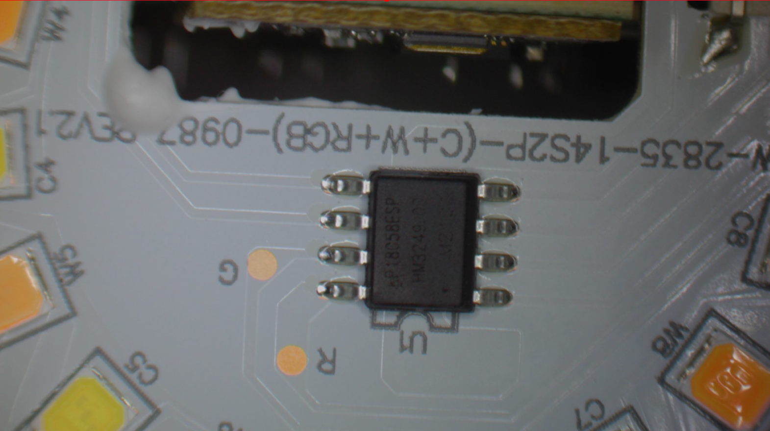

    There are PWM-SDA and PWM-SCL markings on the board. This indicates a "I2C-like" LED driver such as BP5758, SM2135, etc. Please see where are the SDA/SCL signals going. What is the name of the chip? It should be in SOIC8 case or similiar.
  • #10 20635449
    swpharis
    Posts: 18
    Rate: 8

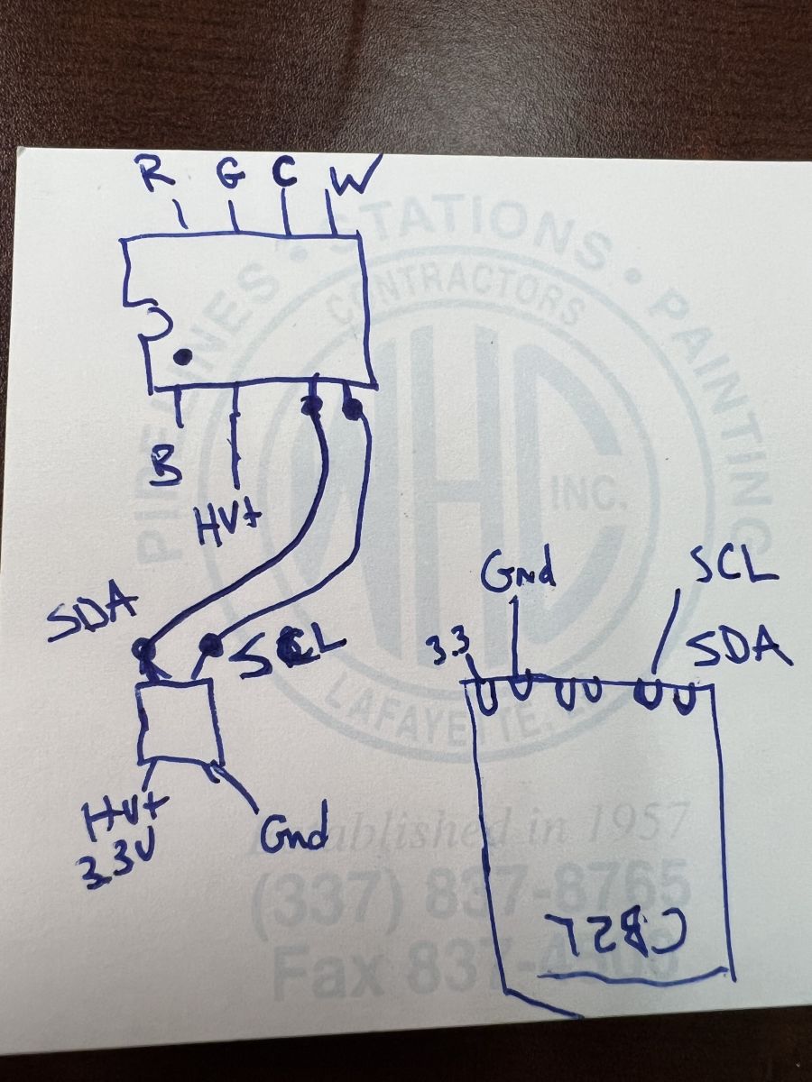

    It’s a KP18058esp.
    Added after 1 [hours] 45 [minutes]:
    Pinned it out.

    Can you check if any of existing LED IC drivers works with that chip?

  • Try SM2135 or BP5758 driver compatibility
    #13 20635653
    Posts: 14793
    Rate: 12941
    KP18058 looks like one of those "I2C-like" LED driver chips, where only two digital lines (SDA and SCL) are used to control 5 channels of LEDs. The problem is, KP18058 doesn't seem to be well known. There are only few google results for that. It seems it has a product page here:
    http://www.kiwiinst.com/productinfo/1248723.html
    It seems that only full datasheet is available per request:
    That basically means we don't have KP18058 support in OpenBeken and currently don't know how to add it.
    But, maybe, it has the same protocol as SM2135, or BP5758, SM2235, or BP1658CJ:
    https://github.com/openshwprojects/OpenBK7231T_App/blob/main/docs/drivers.md
    So I've been thinking maybe you can try to check if any of those drivers are working for your chip. For SM2135, set the two pin roles in config module, then reboot your device, and check if RGB control works. Do the same for other LED drivers.
    If KP18058 is indeed a separate chip with yet another protocol ,then we need to either get the datasheet or two wire communication capture sample for analysis, so I can write a driver for that.
    Can you provide more information where was your device bought?

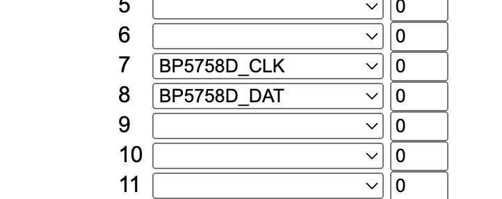

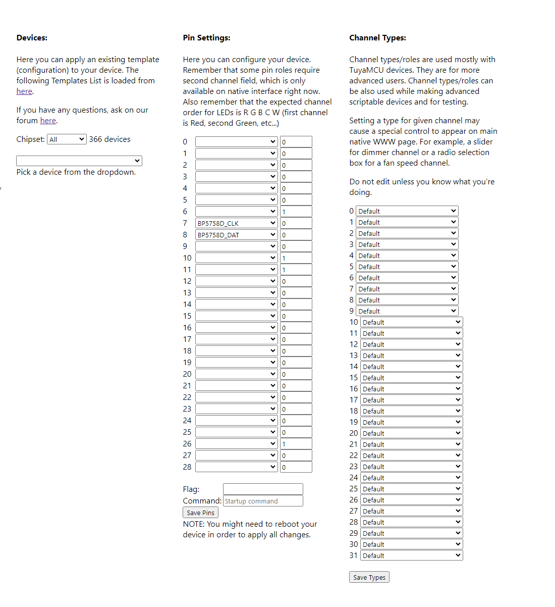

  • BP5758 driver and pin setup suggestion
    #25 20659312
    DeDaMrAz
    Posts: 621
    Help: 34
    Rate: 130
    @swpharis Have you tried with BP5758 driver maybe?
    Open your webapp and go to config and set up those pins as in the picture and report back please.
    EDIT: ignore the channels setup, they all may be set to 0

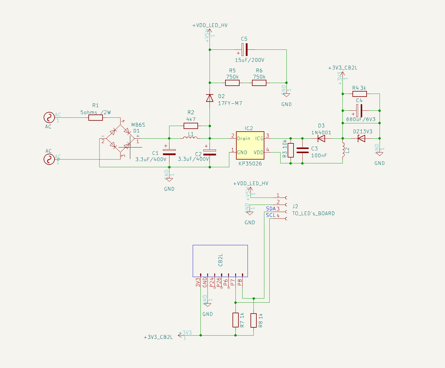

    Added after 2 [hours] 27 [minutes]:
    This is the power board schematics.
    CAUTION!!! - no regulation on input side for LED's whatsoever!!! SHOCK HAZARD!!!
  • C5 rated 200V while C1 and C2 are 400V
    #26 20659429
    Posts: 14793
    Rate: 12941
    Very good job with drawing the schematic, @DeDaMrAz . It looks like a classic Tuya IoT device circuit, though.
    A fusible resistor at the input, sadly (as often) without a varistor, not much interference filters except their classic "inductor between two 400V caps" filter, then a step down (non isolated) converter (again, usual, I have never seen Tuya product with capacitive dropper, it seems those droppers are less and less used), and finally, CB2S with I2C lines (with pull up resistors) connected to the "I2C" LED controller.
    Hmm C5 is for 200V while C2 and C1 are for 400V?
  • #27 20659432
    DeDaMrAz
    Posts: 621
    Help: 34
    Rate: 130
    My best guess is because this is a 110-120V ONLY device that is why 200V but bad design overall, regardless of it being a "classic" and low cost I don't like it at all.

    Were you able to get it to work with the BP5758 driver? I am not able to get it to function. Maybe I am doing something wrong? [BK7231N/CB2L] Lumary 5/6 Inch Downlight - OpenBeken driver for KP18058esp LED controller
  • #29 20661196
    DeDaMrAz
    Posts: 621
    Help: 34
    Rate: 130
    It was just a thought, because they looked very, very similar. Thanks for trying but unfortunately you will have to wait for the protocol to be decoded - we will try probably this weekend.

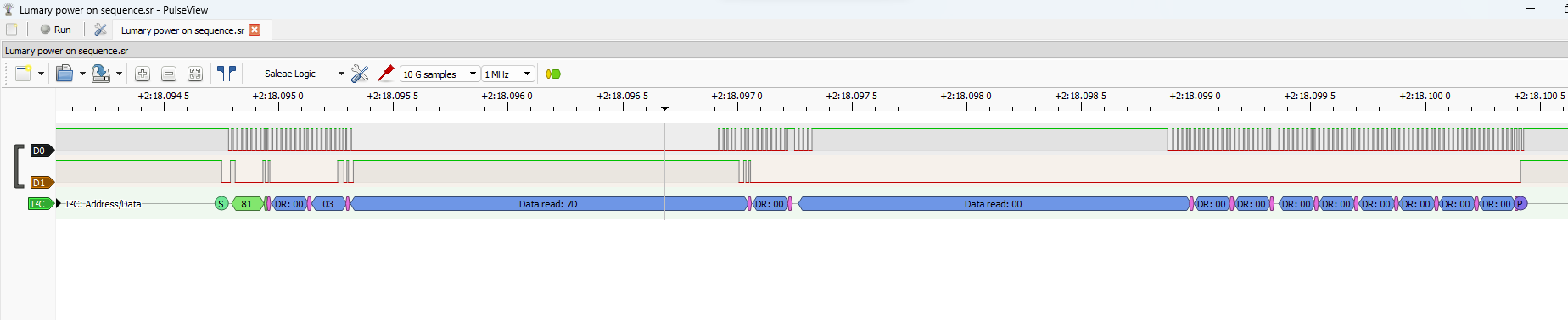

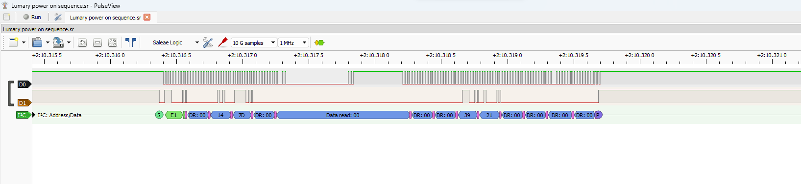

    We are on it, figuring out the commands and comparing it to known ones will be a process but we are on it now :)
    Power on via Tuya smart APP:
    Power off via the app:

How do I disassemble a Lumary 5/6 inch downlight to access the CB2L module and LED driver board?
Remove the diffuser, undo 3 screws, unplug the ribbon cable, then pry off the back cover carefully.
  1. Remove the diffusing filter.
  2. Undo the 3 screws and disconnect the LED-board ribbon cable.
  3. Use a small flat tool on the back cover, because the plastic is soft and brittle. The CB2L module sits soldered to the power board. [#20625124]
What is the CB2L module in a Lumary downlight, and how is it related to the BK7231N chip?
CB2L is the soldered Wi-Fi module used on several Lumary downlight revisions. "CB2L is a Tuya-style wireless module that provides Wi-Fi control for the light, using the BK7231N chip as its main microcontroller." The extracted device configuration explicitly reported CB2L and BK7231N together. [#20630634]

What UART pins and flashing speeds worked for reading and writing the Lumary CB2L downlight firmware?
Power the extension pins, then connect TX, RX, and CEN on the board back. Ground CEN to the large ground pad when needed. The successful setup read firmware at 115200 baud and wrote firmware at 921600 baud. Other baud rates failed on the third KP18058 board revision. [#20635729]
Which OpenBeken pin roles should I use for the Lumary 5/6 inch downlight with KP18058ESP on BK7231N?
Use KP18058_CLK on GPIO7 and KP18058_DAT on GPIO8 for the documented Lumary US-DL6A-4 template. The template identifies the device as Lumary 5/6 Inch Downlight, model US-DL6A-4, chip BK7231N, and board CB2L. It also tags the device as KP18058ESP and 110V. [#20680104]
How should I configure KP18058_DAT and KP18058_CLK in OpenBeken for the Lumary US-DL6A-4 downlight?
Assign GPIO8 to KP18058_DAT and GPIO7 to KP18058_CLK in the OpenBeken pin configuration. Earlier testing hardcoded P8 as SDA and P7 as SCL, then later builds added selectable KP18058 pin roles. The published template uses exactly those two roles for US-DL6A-4. [#20680104]
