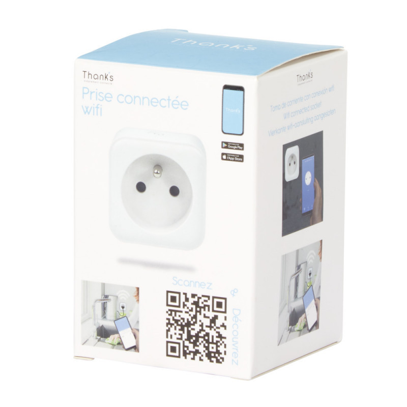

I've recently found this smart plug at a France store (La Foir'Fouille) for really cheap (less than 5 dollars on sale).
Packaging of That's smart WiFi plug with QR code on a white background.
