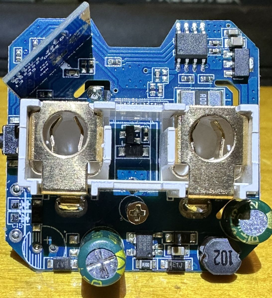

    Hi there,
    I'm an absolute enthusiast for smart plugs. I've decked out my home with several of them and, thanks to some savvy programming, I've already cut down our electricity consumption by 15%.

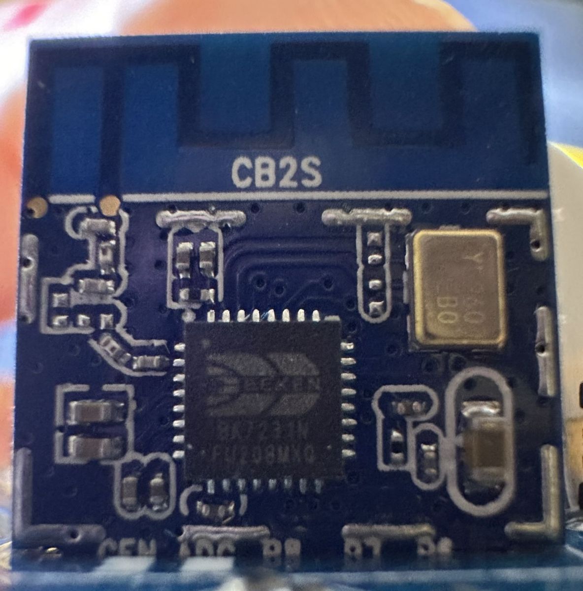

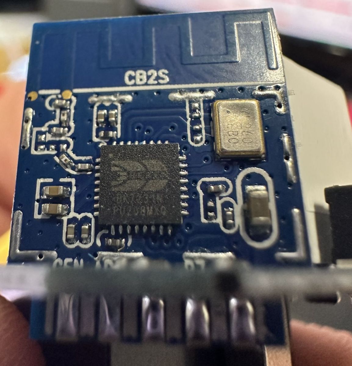

    Eager for more experiments, I went ahead and ordered as like @P0intLess (Link) a batch of 8 smart plugs for just 4€ each from AliExpresss, after reading about their ability to be flashed with OpenBeken despite having a Tuya chip. However, it seems I've received a version with a different layout than expected.
    I'm not new to flashing; I've worked with ESP8266 and ESP32, using Tasmota and WLED around the house. But, to be honest, I'm a bit puzzled about what I need to do for OpenBeken. There are tons of videos out there (though many in Russian), and I'm trying to sift through them.
    I'm pretty handy with a soldering iron, but I have some questions:
    Is there an OTA method, or do I need a serial flasher?
    Where do I need to connect things? I couldn't find any references to this BK7231N in the forums.
    What exactly is Cloudcutter, and is it an option I should consider?
    Could you guys help me out? Thanks a bunch 🤷‍♀️

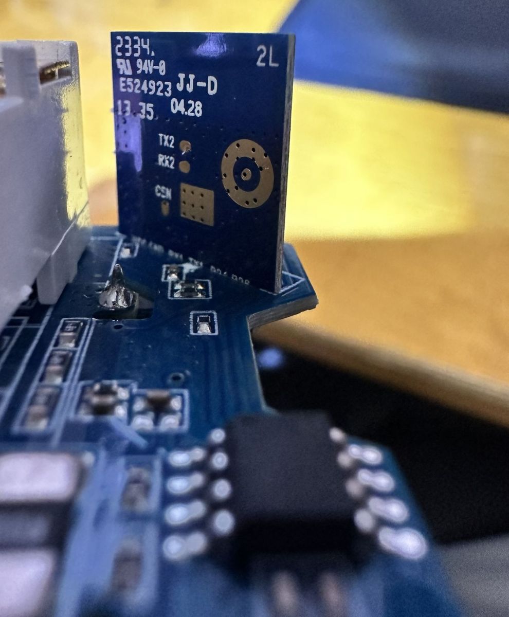

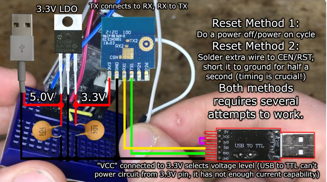

    Welcome to forum, OTA method is not reliable because it's per-build of firmware and Tuya updates often.
    For CB2S, use the following methods. First video is the newer approach:
    Everything is in the videos, but here is a screenshot of the connections:
    Close-up of a manually configured setup with a 3.3V LDO, a Wi-Fi module, and a USB to TTL converter with clearly labeled connections.
    For initial GPIO config, use this method:
    PS: Here is link to our newest flashed (used in the first video): https://github.com/openshwprojects/BK7231GUIFlashTool

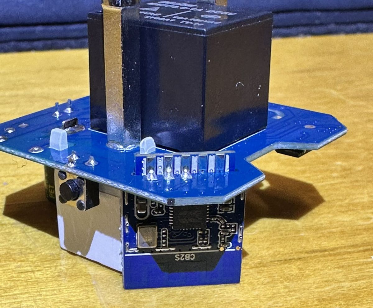

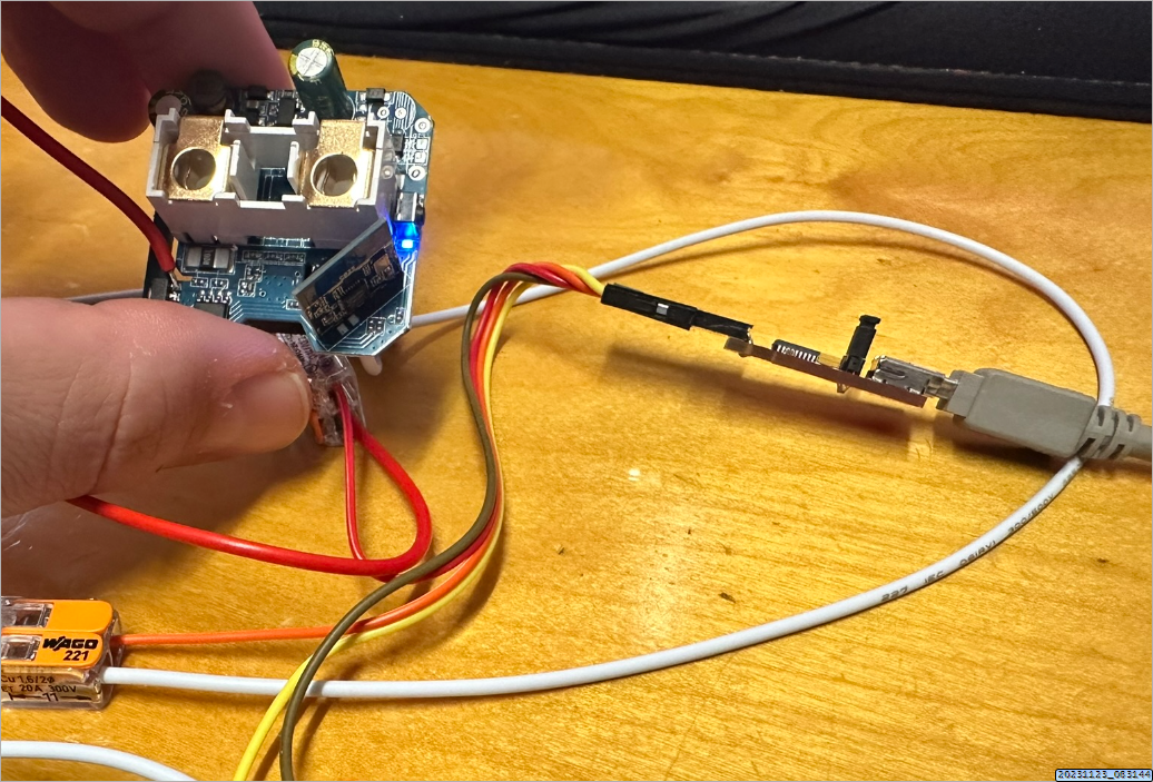

    Will try them right now soon. Do I have to disassemble the CB2S PCB?
    I don't have a voltage regulator, but gonna use my adjustable power supply.
    Going to try now... :)

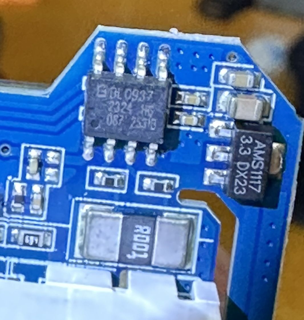

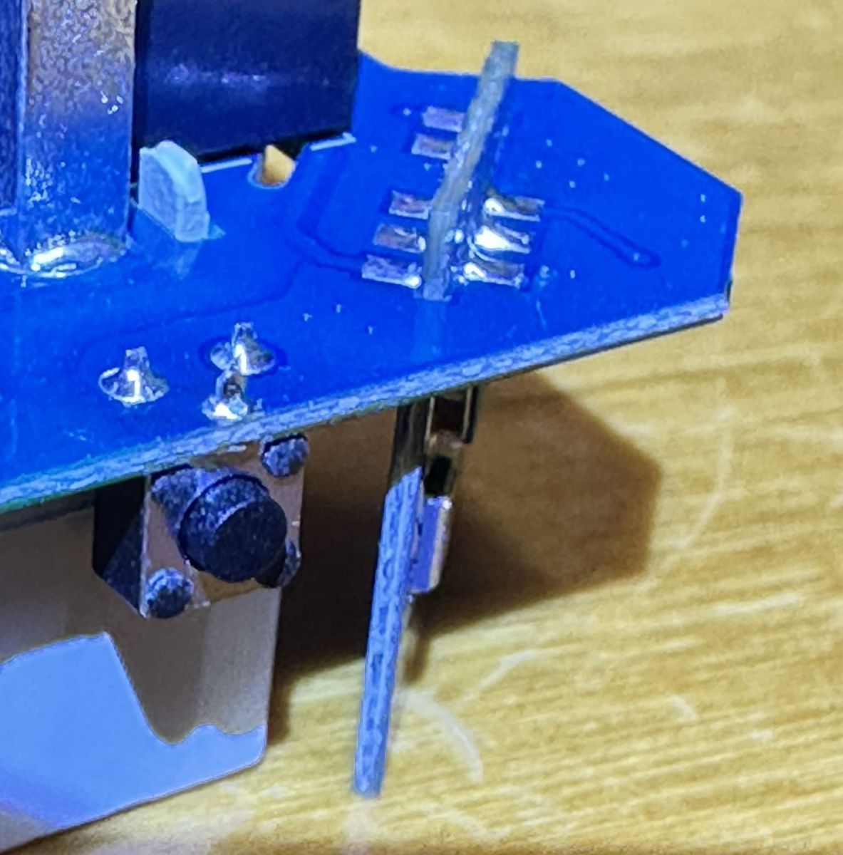

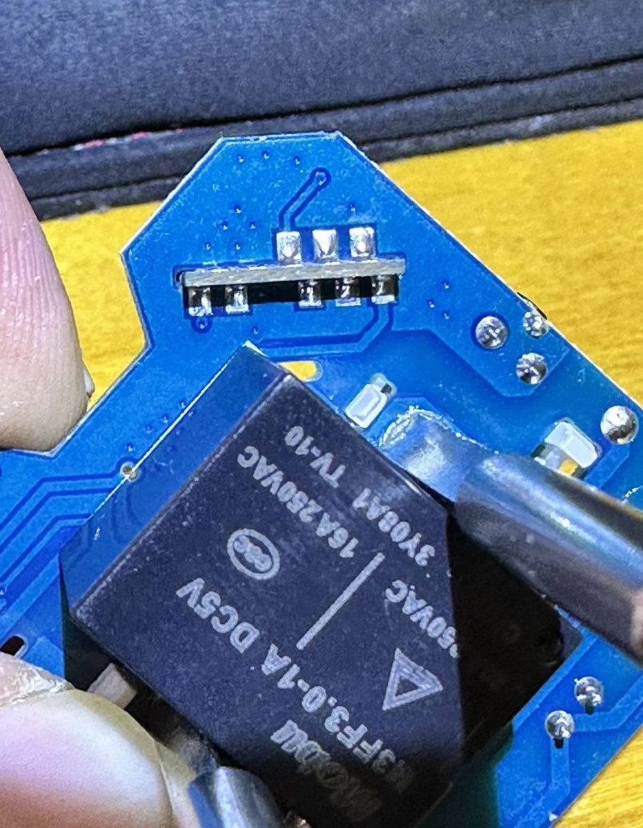

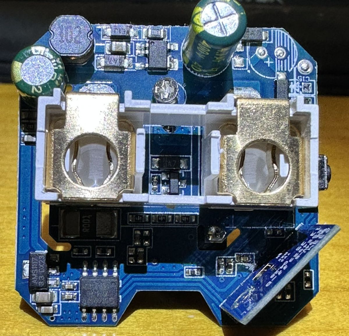

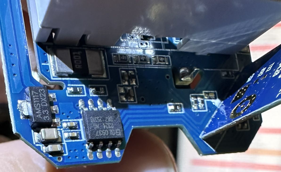

    I can clearly see that AMS1117-3.3V is on the board on your device, so you could theoretically just solder 5V wire to the input of that AMS1117-3.3V and it could work, but it depends on one major factor.
    Some Tuya devices come with RX1/TX1 of BK7231 used for some other purpose on their boards, for example for a button, or power metering circuit communication. In those cases, flashing may fail in circuit and you have to desolder CB2S out of the board. This is what I usually do.
    Your device seems to have BL0937 power metering circuit, but I am not sure if would interfere with flashing.
    If you want, you can:
    - first try to flash in-circuit, just solder RX, TX, GND and 5V to the input of AMS1117-3.3V, try to flash in-circuit, do power off/on cycle by disconnecting 5V
    - if it fails, you will most likely have to desolder CB2S, like I did on my video

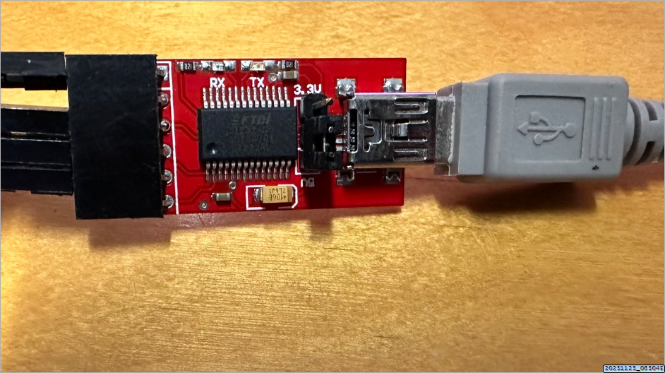

    #5 20828956
    tefod
    Thx mate. Trying since yesterday and spent more than 10 hours in all variants (even desoldered) and was wondering, why the app does not make even a tick - till i figured out, that I am using a damn FTDI adapter instead of a plain UART 🤦‍♀️ I guess, this is the issue. No failures, no learn 😁
    Just ordered the right UART adapter with a ch340 chip and some desoldering stuff. Will give u feedback soon. Thx again!
