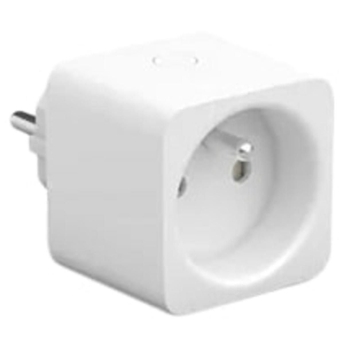

    White smart electrical plug.

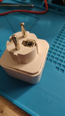

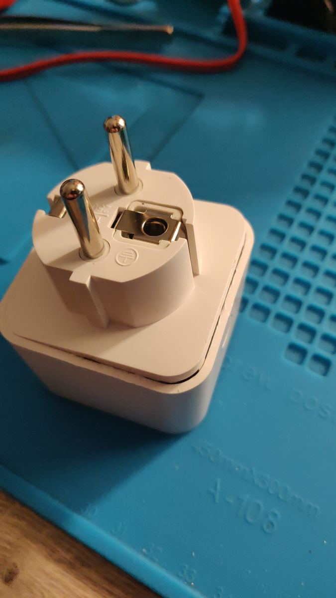

    So I teardown the device (using a flat screwdriver and some brute force), and found the chip is a WB2S with a BK7231T. Great news!
