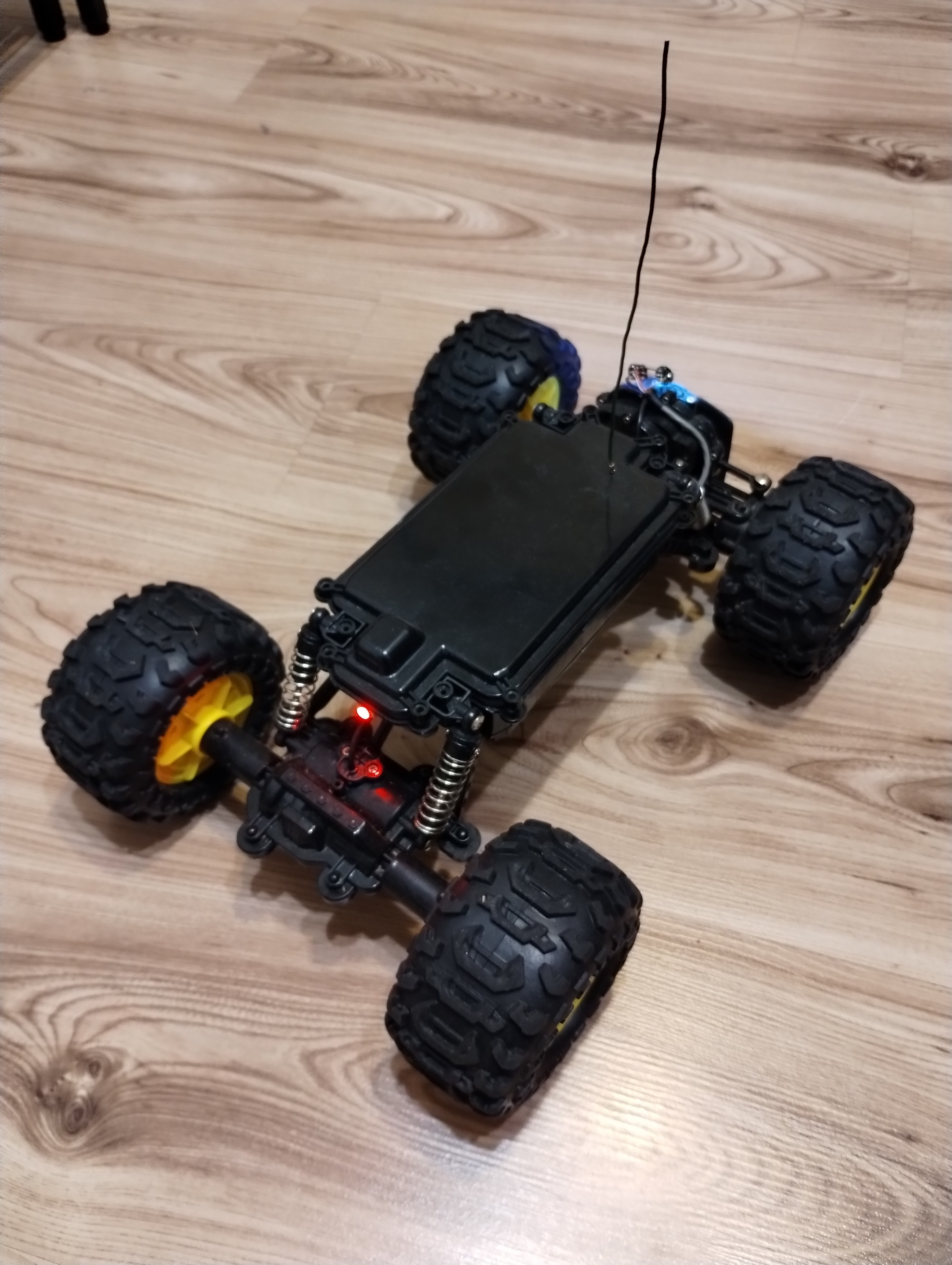

I would like to present and share a universal platform for operating remotely controlled models.
I haven`t posted anything on the forum for many years - it doesn`t mean that nothing was happening, but it wasn`t always worth showing. ;)
It all started with the fact that I wanted to do something that would give me fun and be an inspiration to "fiddle" with cables and Arduino. So I ordered a tank chassis from a Chinese online store (sinoning.com) and that`s how the adventure began... after the tank, a mini-car appeared (also from the same store), and then, bought for 1/3 of the value of new vehicles, a full-fledged car with 4x4 drive and a remote-controlled fast boat, bought on Allegro as "damaged". The damage to the car consisted of water getting inside and seizing the engine (the car is theoretically waterproof and has positive buoyancy and can also "move" on water), which was revived (by force and then turning by hand), while the boat was theoretically damaged. control, but I didn`t check what happened because from the very beginning I wanted to install my own...
A few words about the control itself:
Remote consists of 2 joysticks (Arduino modules), Arduino Nano, Li-Ion battery, BMS system, 5V step-up converter and radio (HC-12 module). No rocket science. I had a huge problem diagnosing the problem that the BMS did not want to charge the battery - the diode was blinking very quickly, as if there was no contact somewhere, or the module was being energized. In desperation, I soldered it directly to the battery (previously through the switch) and this solved the problem. I don`t know why the switch caused such problems - perhaps the contacts provided some electrical resistance and the module was excited, e.g. by the radio or the converter. The remote control has two modes (the mode is changed by long pressing the left joystick): car/boat mode (default - left joystick forward/back, right joystick right/left) and tank mode (both front/rear joysticks for differential control). Holding the left joystick for a shorter time changes the lamp mode (bright/medium/off) in the big car.
Receivers they also consist of Arduino Nano, HC-12, as well as (cars, tank) BMS and an H-bridge for controlling the engines (in a boat, the engine is operated by a servo). The smallest car is powered by one LI-ION cell and a STEP-UP converter, hence the large capacitor so that voltage drops do not reset the Arduino. The remaining models run on two 18650s (the large car also has a capacitor on the power supply, but it is not needed).
Additional information
The large car has lights based on WS2812B (two white at the front, one red at the rear).
Boat steeringis more complicated because the "ordinary PWM code" cannot be used to operate the servo, as it is done in a different way. All receivers have an identical code; At startup, Arduino checks whether there is appropriate voltage on one of the pins (supplied from the 3.3V output) and if so, it activates the "boat mode". Other models do not have this pin bridged - this way the program is universal and there is no need to add another "mode" in the remote control.
The boat has protection against low battery voltage - it is measured by a voltage divider and has two activation thresholds. When the first one is reached, an acoustic signal is emitted for a few seconds (5V buzzer controlled by the BS170 transistor). When the second one is reached, the acoustic signal turns on permanently and the engine power is reduced (PWM max 50%). The BMS used in the factory cells does not cut off the power supply even in the event of deep discharge, which makes sense because it is better to kill the batteries than to get the boat stuck 10 meters from the shore...
The servo is controlled using a software library. This is because the default servo library had a conflict with the library responsible for controlling the WS2812 (probably a conflict due to the use of the same timer).
The program also has commented sections related to testing the battery in the boat - before I discovered that the BMS did not cut it off, I wrote a script that saved the lowest measured supply voltage in EEPROM and after connecting the Arduino to the computer, sent it via Serial. I wanted to know to what level the cells could be discharged to properly set the protection thresholds, but it turned out to be unnecessary.
The remote control and the large toy car have connectors for charging the batteries; there are chargers for a small car and a boat.
Generally, I discovered that the "spiral" antenna in the transmitter works poorly, but a regular wire of appropriate length works well. The antennas in the remote control and cars are mounted in goldpin sockets so that they can be easily removed for transport. The boat has a default spiral antenna. HC-12 radios are very cool, the theoretical range (at low bitrate, direct visibility) is up to one kilometer. I am attaching two documents that will be useful for their operation - they contain a description of the functions and configuration.
Calibration is needed to adapt the code to a given joystick (neutral point) and servo (also). The values are described in the comments.
I don`t have any diagrams, but I think you can easily figure out what and how based on the descriptions and photos. I know that (especially in the remote control) there is a spider`s web of cables, but I don`t waste my time designing boards, I enjoy electronics and writing programs.
The code is heavily commented (in English), so understanding the programs should not be a problem. The range in the selected configuration (radio bitrate, antenna) is at least 200m (maybe more, I haven`t checked, at such a distance it is difficult to control the model).
If anyone is interested, it is worth following this topic, if there is an update of the program(s), I will add it.

gulson 30 Nov 2023 17:42
Thank you very much for your presentations. There haven`t been any projects related to RC models for a long time. Write to me parcel locker and I will send you a small gift! [Read more]
Karol966 30 Nov 2023 18:54
One of the stores wrote: "Transmission range: from 1 m to 1000 m (less than 1 meter, it may not work properly)", seriously, as much as 1000 meters can be achieved with this? [Read more]
Frog_Qmak 30 Nov 2023 19:03
I haven t try any further) with the "spiral" antenna on the receiver, partially hidden in a plastic boat and additionally covered by me (I was walking with my back to the transmitter, carrying it in my... [Read more]
Jawi_P 01 Dec 2023 10:35
I haven ll try it someday. It`s nice that the RC project has appeared. [Read more]
ArturAVS 01 Dec 2023 11:42
@frogqmak Żabko_croaking :D , have you considered using LoRa modules? Or e.g. nRF24L01? I had some stuff accumulated and I would build something. [Read more]
Frog_Qmak 01 Dec 2023 18:03
I found a tutorial for this radio on the Internet :) I tried NRF once, but I couldn t tried LoRa and I don`t know how expensive they are :) [Read more]
bb84 01 Dec 2023 23:26
Something like this would be useful to control a submarine at a depth of 2-3 m. [Read more]
Krzysztof Kamienski 02 Dec 2023 04:45
@frogqmak, maybe it`s not stupid, but with the editing style you ruined my appetite for breakfast. Sorry. [Read more]
Frog_Qmak 02 Dec 2023 10:55
@krzysztofkamienski, I know it`s not great inside, ;) but excessive pampering does not give me satisfaction, I prefer to develop the program or new models and have fun with it, rather than force myself... [Read more]
OPservator 02 Dec 2023 16:29
What is the maximum speed? [Read more]
Frog_Qmak 03 Dec 2023 07:38
A boat (Feilun FT009) supposedly 30 km/h, a large car (Revell Aqua Crawler) supposedly 20 km/h :) I will only test the boat outdoors, but it has a specific engine with water cooling, it consumes 8-12 ... [Read more]
mpier 07 Dec 2023 17:34
Hello I don t looked into the code too much, but the sending method used in the program may have (has?) a significant drawback - the high overhead of the si4463 protocol. In addition, there is the delay... [Read more]
Frog_Qmak 07 Dec 2023 18:03
Hello, thank you for your valuable attention. In the case of a large model (which could, for example, be a threat due to its weight) or other applications where reliability is important, this would need... [Read more]
