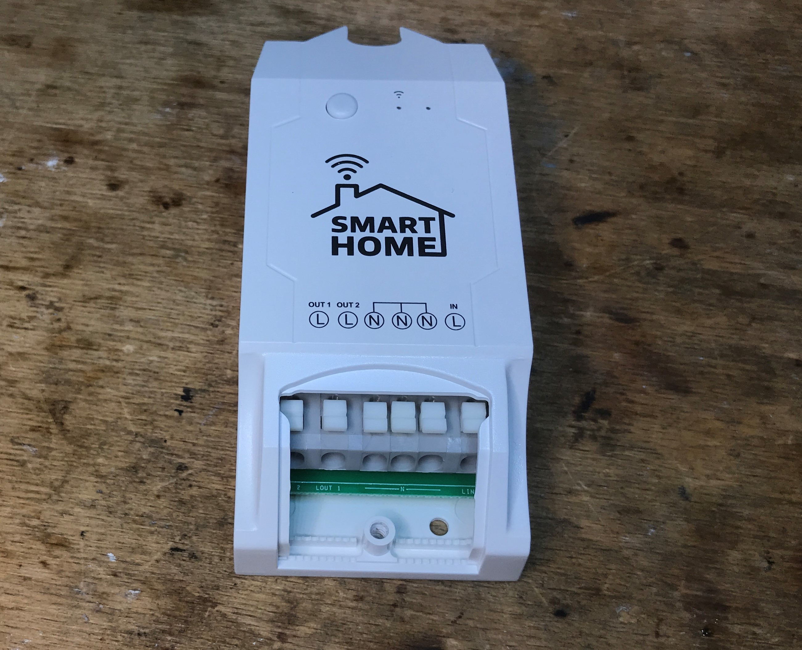

Today we are uploading Tasmota to a device that is essentially a repainted Sonoff Dual R2, a relay module commercially available under the name WS-05H1. The equipment was given to me by a reader so that I could change the firmware and take a few photos. As usual, first a presentation of the interior, then programming and finally a template. Here we go!

And the driver itself:
WS-05H1 WiFi controller with technical label on a wooden table. WS-05H1 smart home device on a wooden table.
