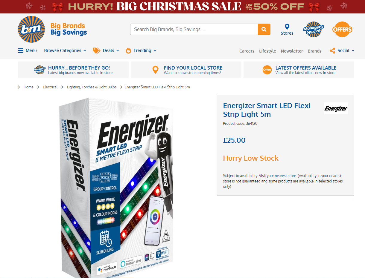

Bought this from B&M Bargains in the UK. The unit was in a discounted, PLN25 down to PLN15 (who would pay PLN25?!) area and labelled as having a missing remote. I noticed it was also missing a power supply so asked for a further discount and got it for PLN7.50. I later realised this version doesn't come with a remote, so only the PSU was missing :o
