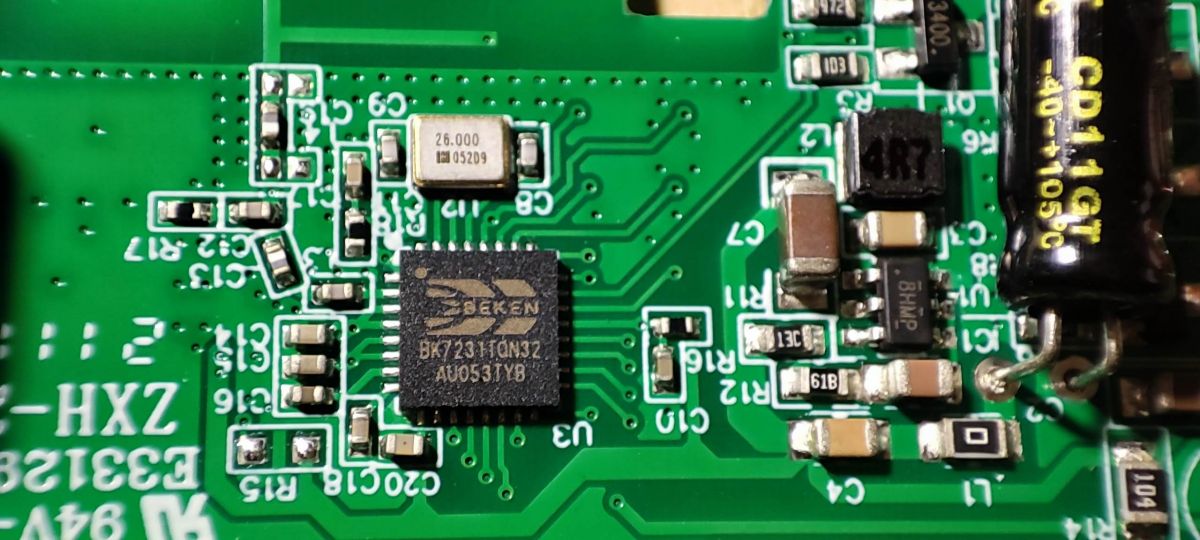

  • The Energizer Smart LED 5 Metre Flexi RGB strip hides a BK7231N controller on a WB3S board.
  • The PCB exposes labelled RX1, TX1, RX2, TX2, GND, CEN, and VCC pads, making UART dumping and flashing unusually straightforward.

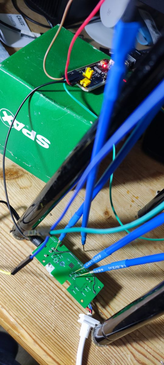

  • Bought this from B&M Bargains in the UK. The unit was in a discounted, PLN25 down to PLN15 (who would pay PLN25?!) area and labelled as having a missing remote. I noticed it was also missing a power supply so asked for a further discount and got it for PLN7.50. I later realised this version doesn't come with a remote, so only the PSU was missing :o
    B&M Bargains website displaying Energizer LED strip light offer.

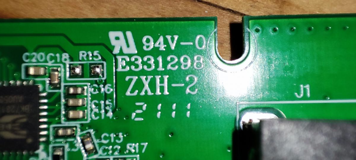

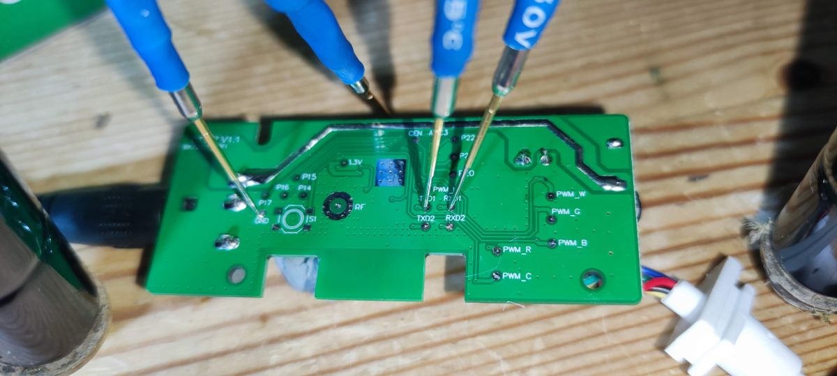

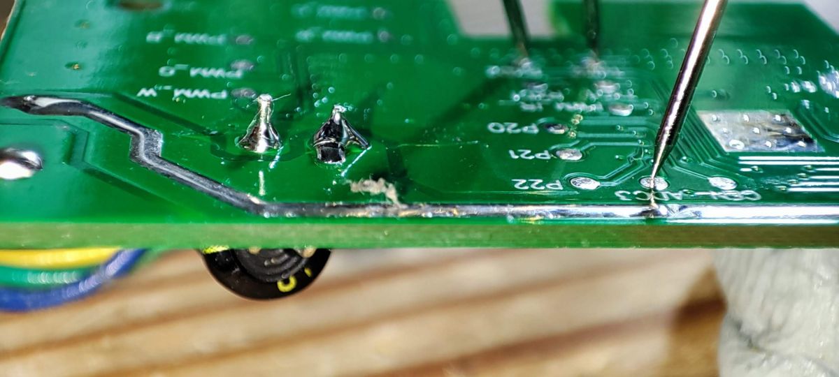

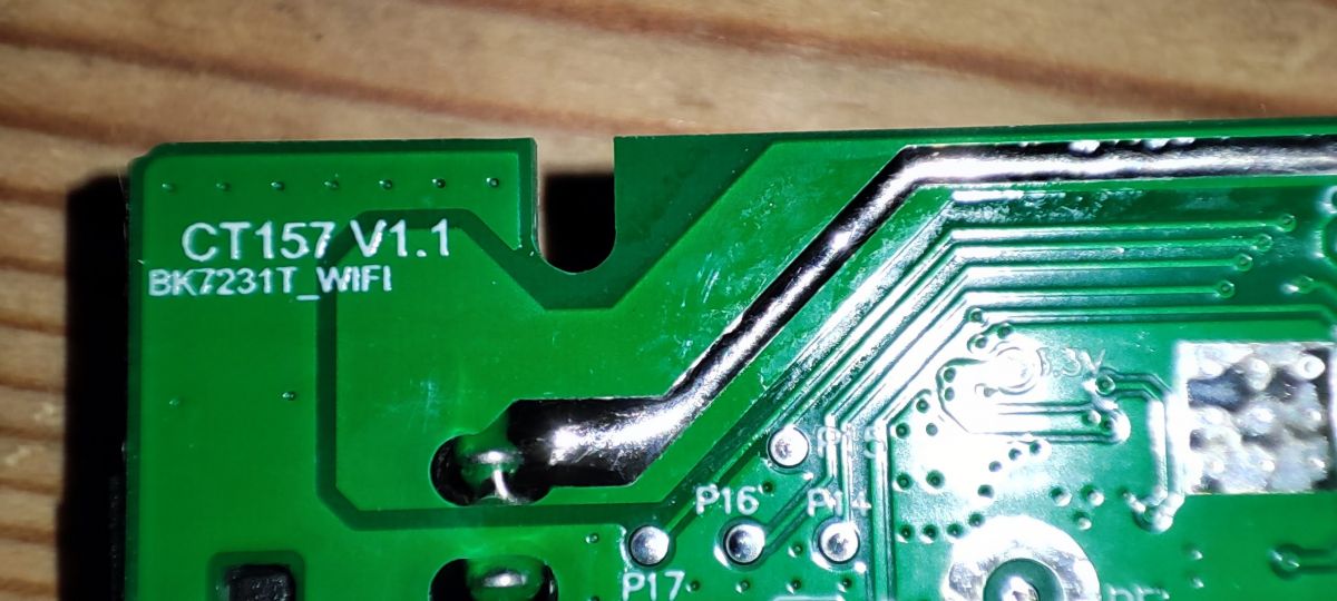

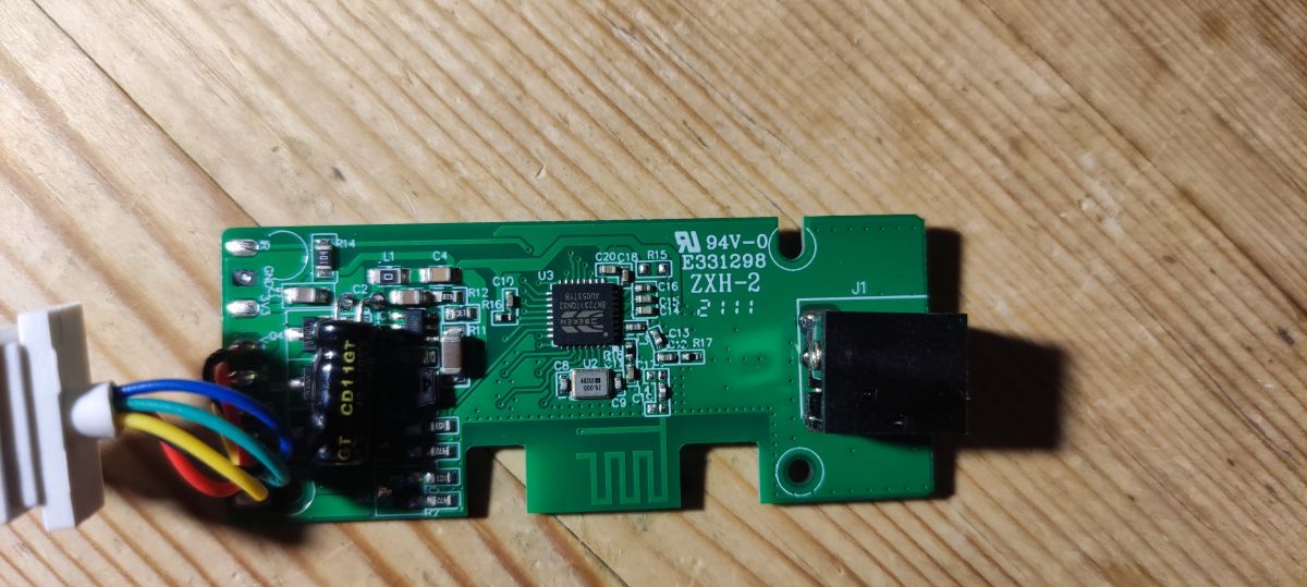

    Anyway, inside it's a BK7231N. The RX1, TX1, RX2, TX2, GND, CEN, VCC are all labelled nicely on the back of the PCB. This is probably the easiest dump/flash I've performed so far. I found a 12v adaptor with a fitting barrel connector so used this as my power source rather than using the VCC from USB-TTL adaptor. Only GND, TX1, RX1 and CEN used when flashing.
    It's clear from the unsoldered 3.3/GND/IR that I could add an infrared sensor, perhaps like https://www.youtube.com/watch?v=KU0tDwtjfjw
    In researching the PCB I found this EKF-branded product with the same board. The packaging and content look very similar but this one has IR and a remote.
    https://megamarket.ru/catalog/details/umnaya-...lenta-ekf-connect-rgbw-3m-600003974609_18788/
    UART2 boot log has this as a oem_bk7231s_strip_ty

    And here is OBK template:
    And text description of GPIOs:
    Device seems to be using WB3S module, which is BK7231T chip.
    - LED Red (Channel 1) on P7
    - LED Green (Channel 2) on P8
    - LED Blue (Channel 3) on P6
    - LED Cool (Channel 4) on P24
    You can also easily add a button to that kind of device:

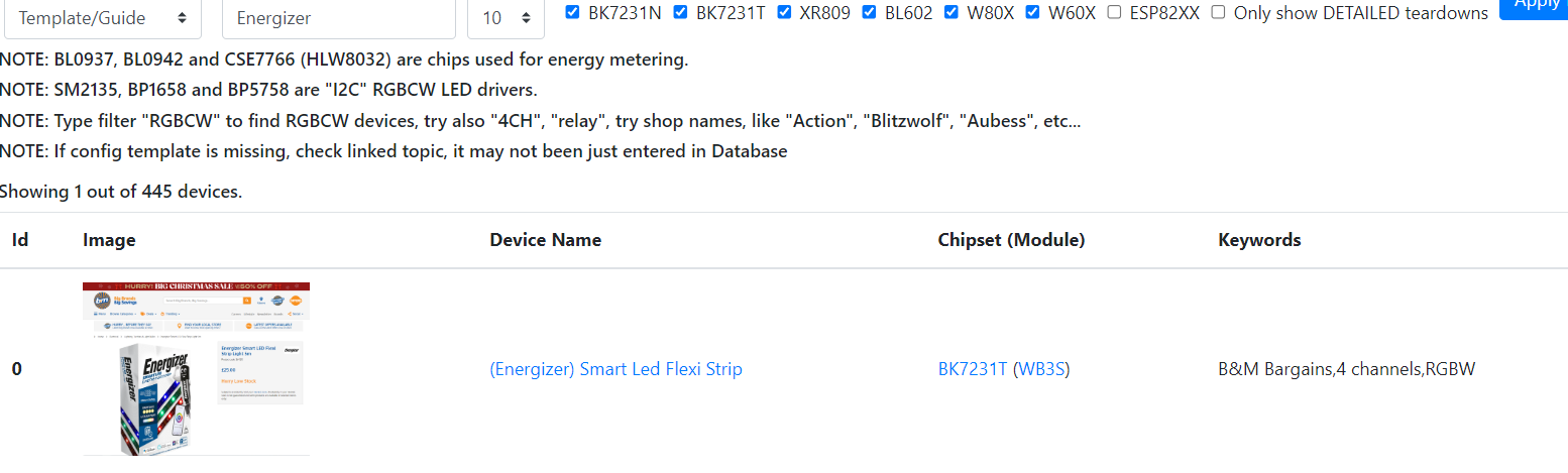

    Thank you, the device should be now live on our teardowns list:
    Device list with a row showing Energizer LED strips.
    See more at: https://openbekeniot.github.io/webapp/devicesList.html

    Does the posting of the OBK template in a thread get picked up automatically as new device? I hadn't realised this was the case, if so.
  • #6 20869258
    Posts: 14743
    Rate: 12839
    Unfortunatelly not, they are added by hand by me. Sometimes users also add them themselves by making a pull request to our devices.json database:
    https://github.com/OpenBekenIOT/webapp/blob/gh-pages/devices.json
    I can't import them automatically because users often leave a lot of fields blank and each template usually is first improved by me before I add it to the DB
