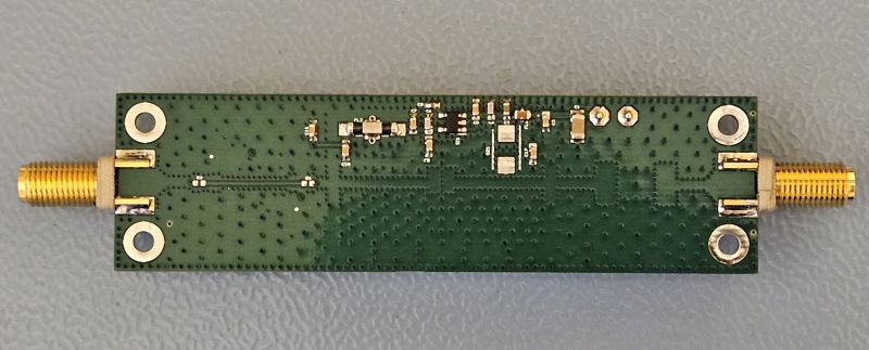

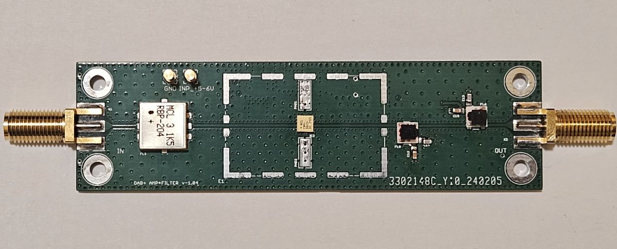

As I have been receiving DAB+ Digital Radio for a long time, I am also struggling with reception efficiency, even though the assumptions of the DAB radio specification (DAB+) were to ensure not only digital quality, but also ensure effective reception even in difficult conditions.
Unfortunately, the assumptions were "slightly" different from reality, as I often travel by car and I have a DAB+ receiver in the car, which means that I know "how it is".
And while the reception of regular VHF radio is not difficult even in mountainous or foothill areas (around Krakow), unfortunately for the reception of DAB+ radio, the first large hill that covers the transmitter quickly causes the signal to disappear. Unfortunately, the operating frequency range (174-230 MHz) means that the range is basically optical and while close (~ 20 km from the transmitter) in built-up areas is rather (but not always) problem-free, the further away the worse.
Another issue is the weak input circuits of DAB receivers, they are as simplified as possible, and the receivers are most often single-chip with zero input filters, which also limits the receiving capacity of the receivers.

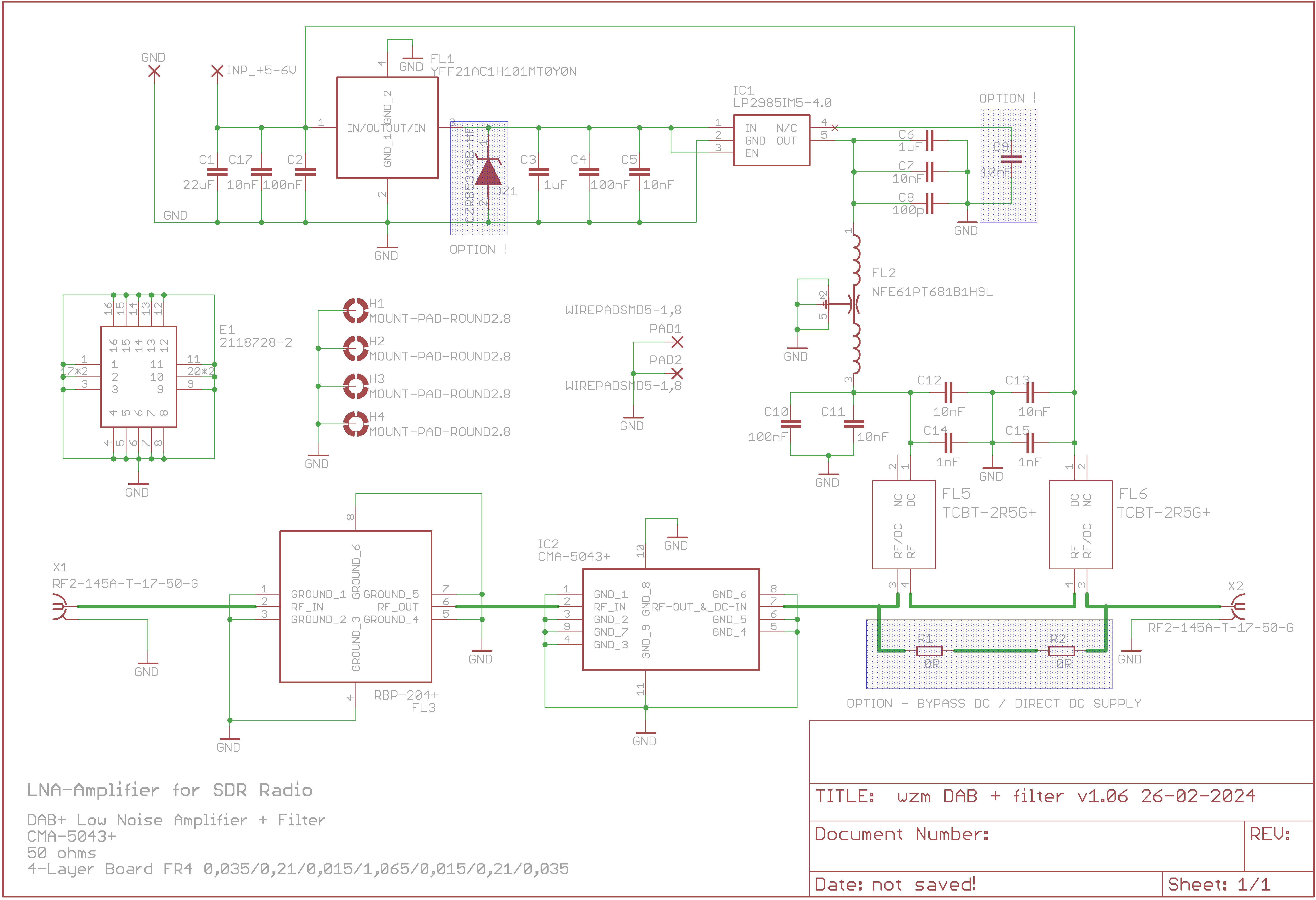

So I assumed the construction of an amplifier for a DAB receiver with an input filter system, the minimum gain of such a system in the entire band is ~20 dB with filtering outside the min. 30 dB.
I didn`t make any compromises here - the elements I used were Mini-Circuits circuits and filters.
The system used is CMA-5043, and the filter is RBP-204, the system is powered from the output and can be supplied from 5 V to 12 V, and the LP2985 4 V stabilizer system is used, additionally two blocks are used Bias Tee - TCBT-2R5G elements for receiving DC voltage and then applying a stable voltage to the amplifier system.
The system can be directly powered from the antenna output (voltage range 4-5 V) (OPTION 1),
OPTION 2 is an additional capacitor that reduces the self-noise of the LP2985 stabilizer, OPTION 3 is an additional Zener diode that can be used to protect against too high voltage (when using another stabilizer).

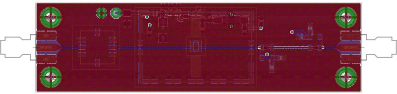

The board was designed as 4-layer (wave impedance).
Diagram:
Schematic of a low noise amplifier with a filter for DAB+ radio.

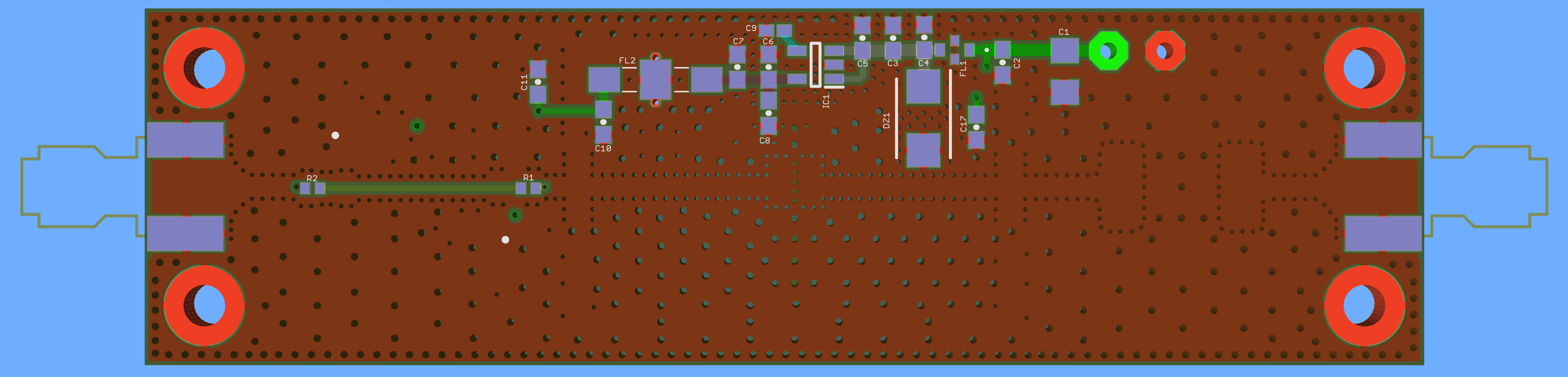

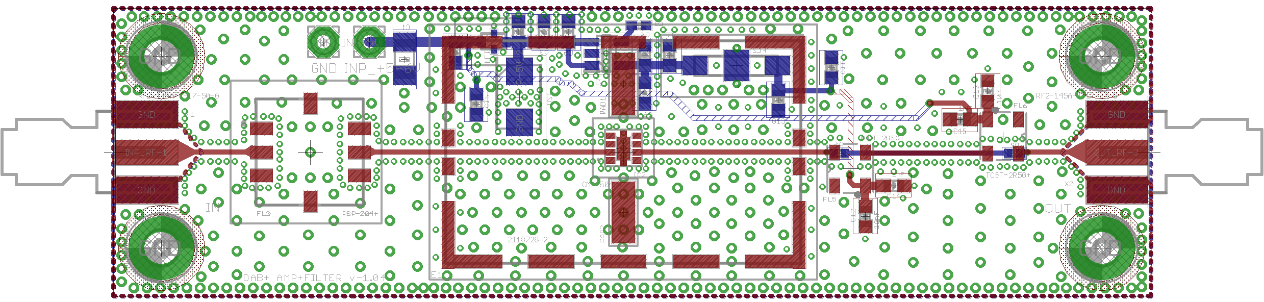

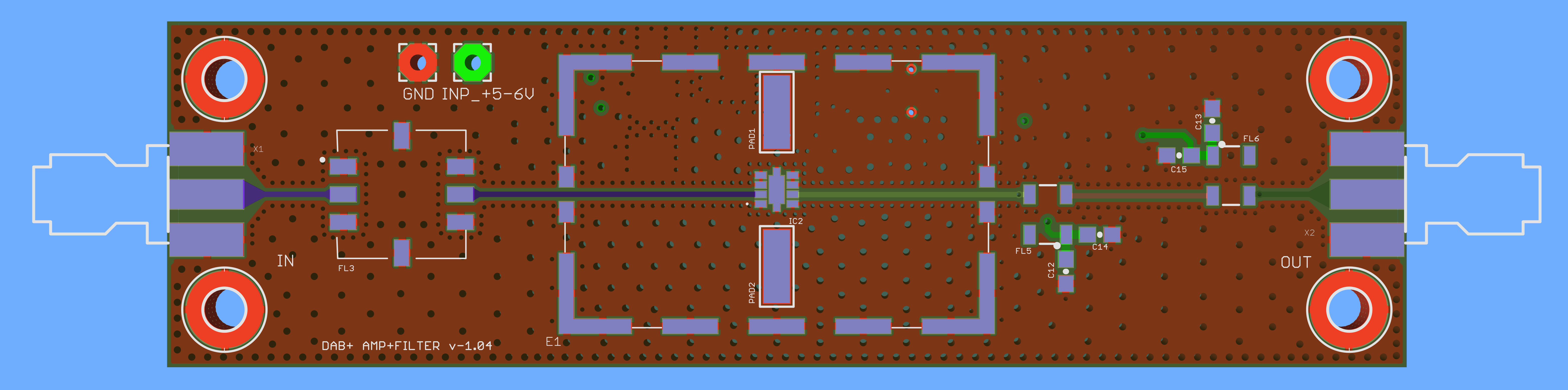

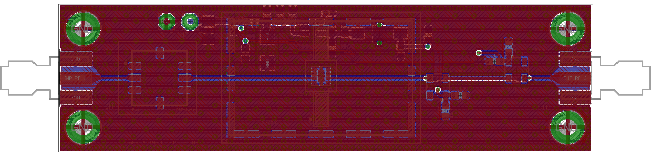

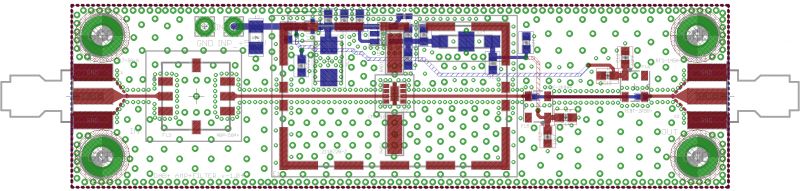

Printed circuit board in 2 views:
View of the designed DAB+ amplifier on a PCB in schematic form.
View of the printed circuit board of a DAB receiver amplifier with Mini-Circuits components.
Render view:
PCB of DAB amplifier with mounted components in a sealed enclosure.
DAB+ amplifier circuit with components mounted on a printed circuit board.

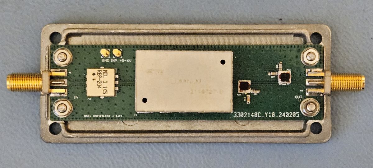

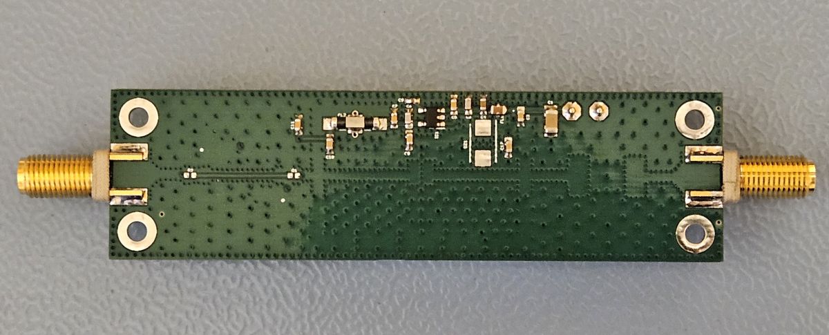

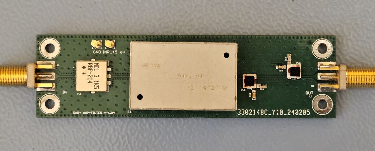

Views of the completed board with installed elements:
Printed circuit board of a DAB amplifier with mounted components.
Green PCB of a DAB+ amplifier with mounted components and connectors.
DAB receiver amplifier PCB with mounted components.
DAB+ amplifier mounted on a green circuit board in a metal case.
DAB+ amplifier with filter in a housing labeled with input and output signs.

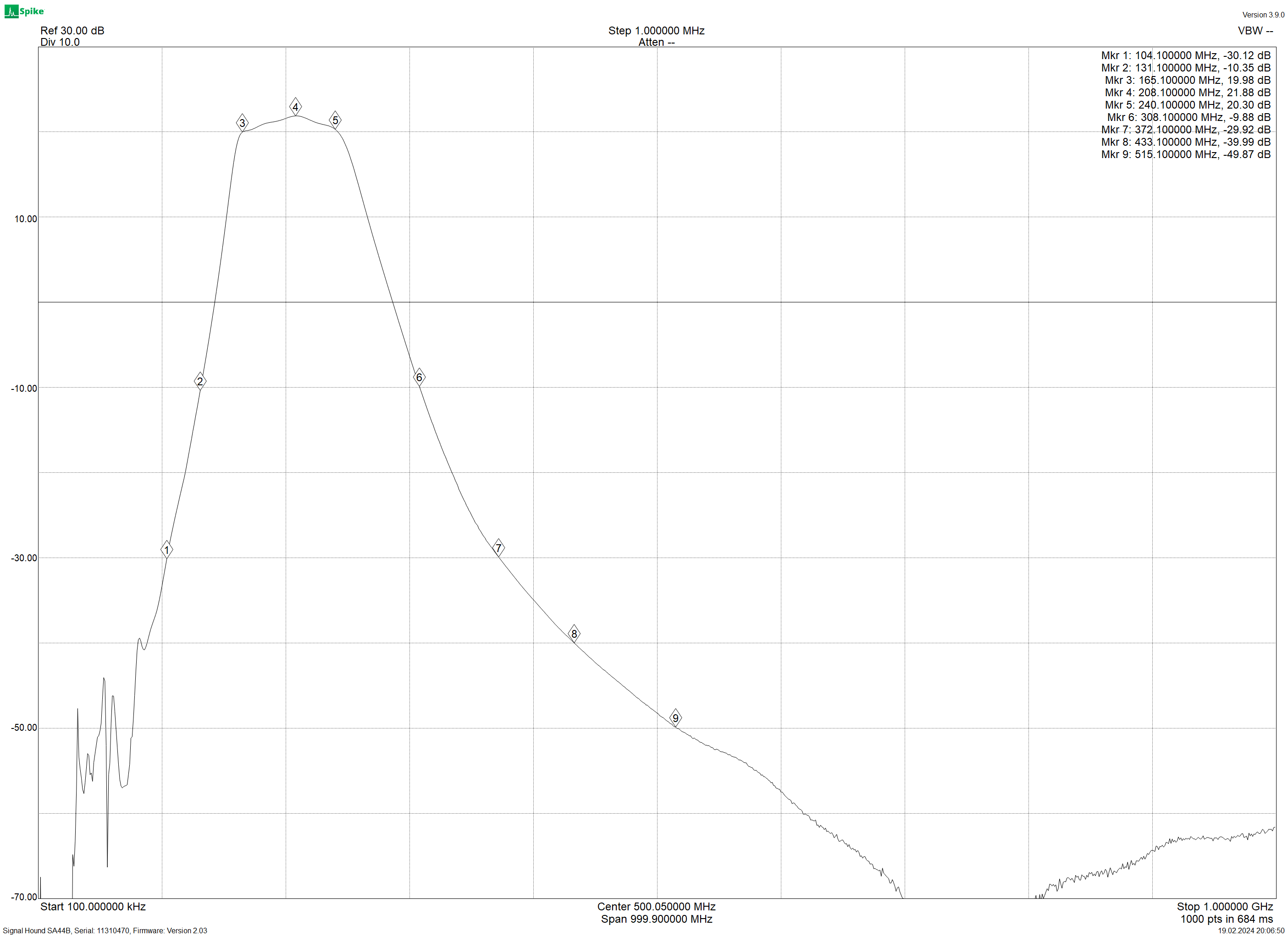

Measurement results of the completed system:
In the range up to 1 GHz:
DAB amplifier frequency response graph.

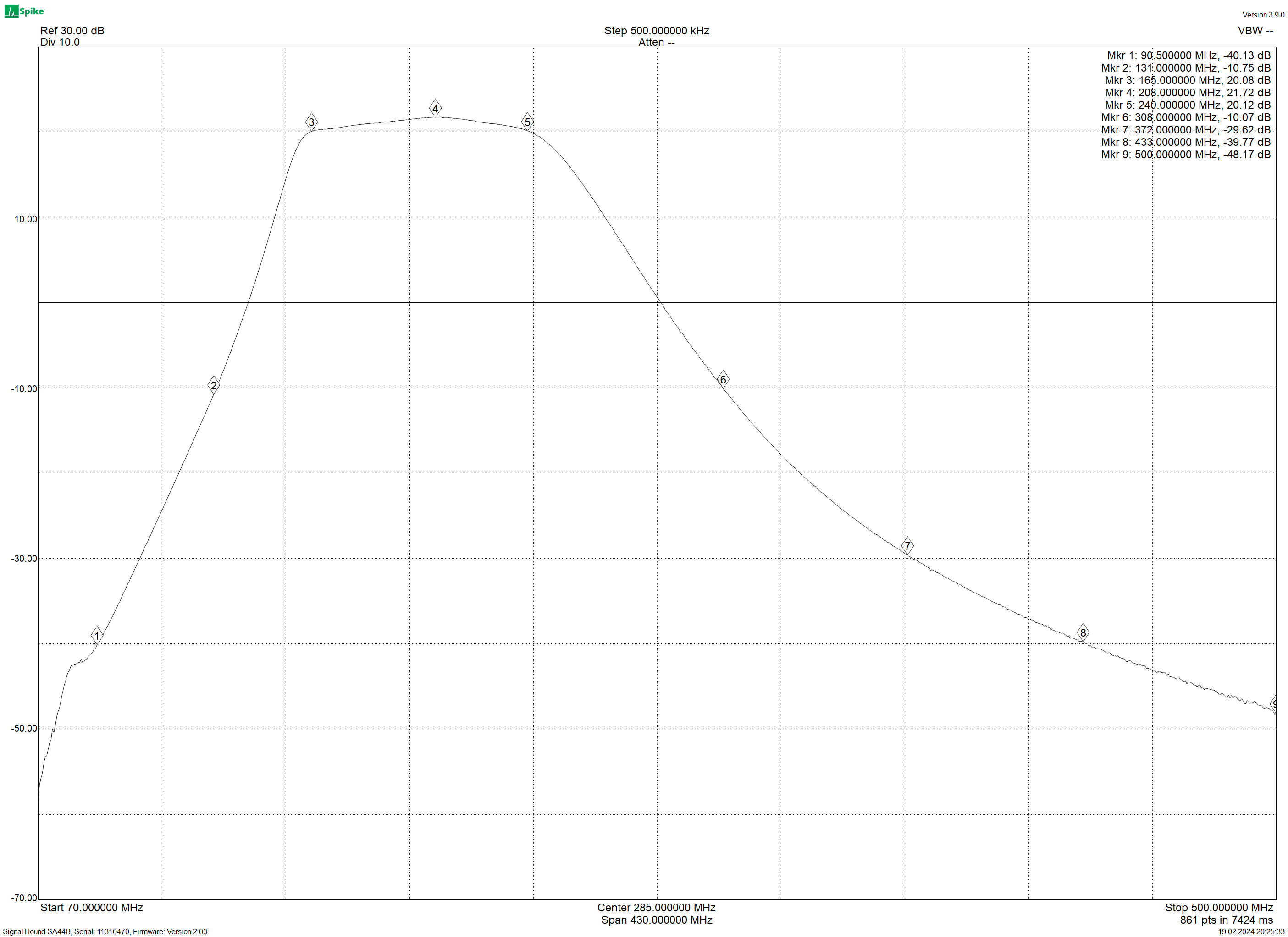

In the range up to 500 MHz:
Graph showing the characteristic of an amplifier for DAB+ radio reception.

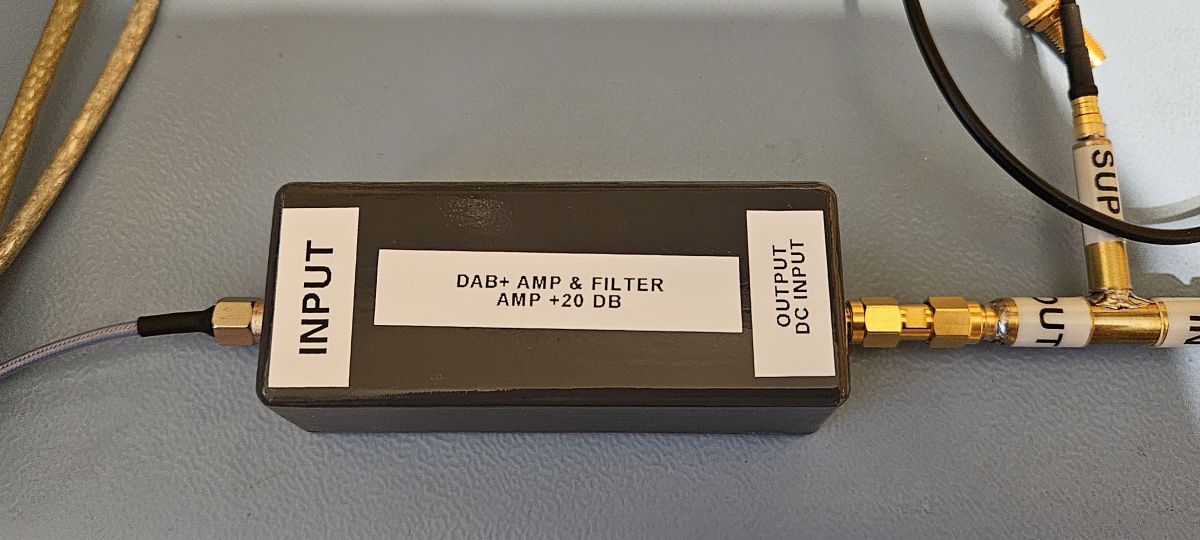

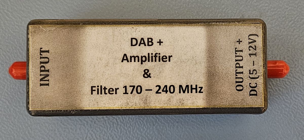

Finally, the amplifier looks like this (the housing was encapsulated by protecting it with varnish):
DAB+ amplifier with 170-240 MHz filter in casing.
