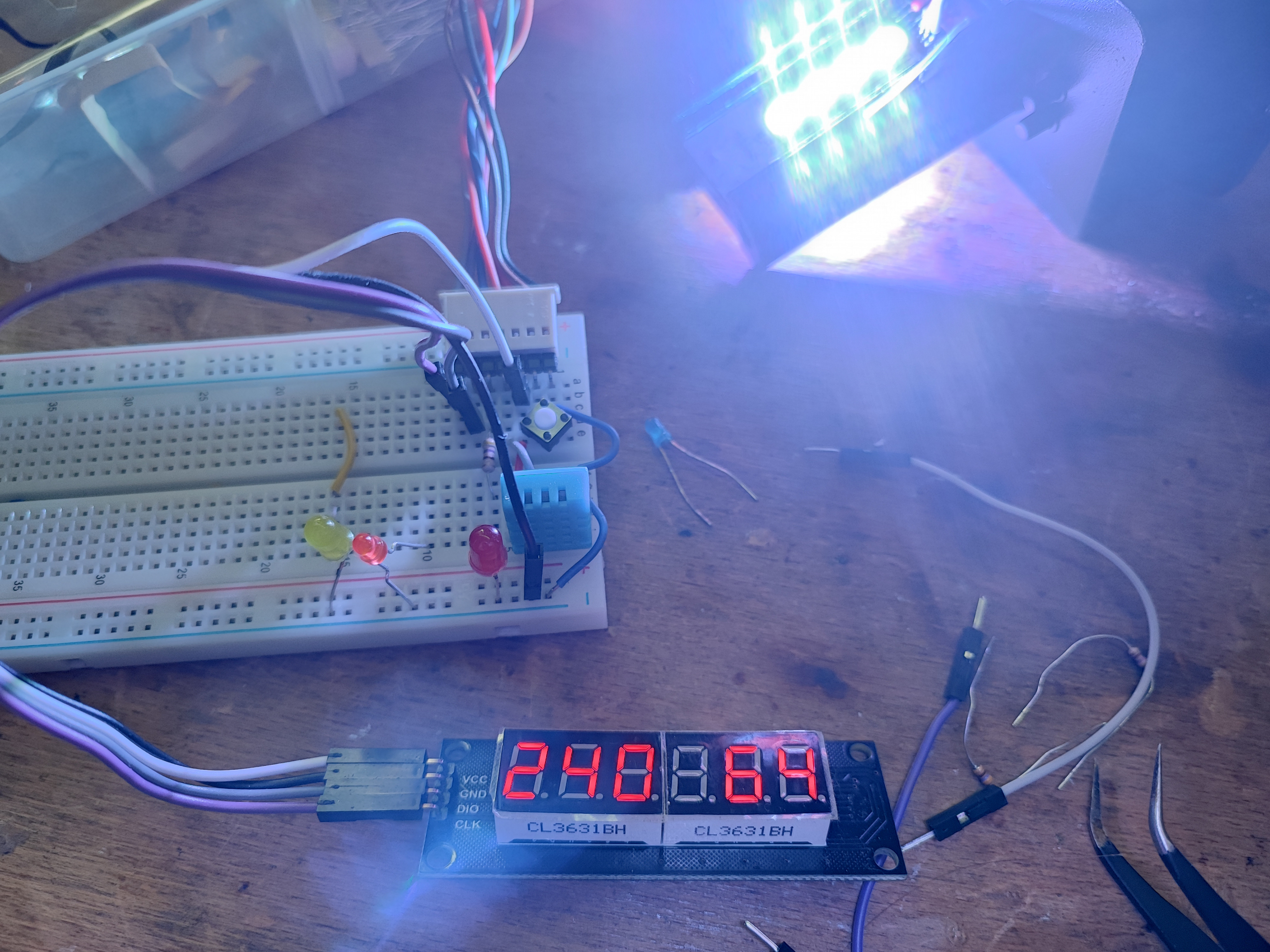

I had a TM1637 on hand, time to get it working. I selected the pins:
- P24 - CLK
- P8 - DIO

Fire up and display:
OpenBeken interface screen with TM1637 driver started .
Online interface screen for entering commands for IoT devices with the command TMGN_Print. .
Result:
Prototype with a breadboard, LEDs, and a display on a wooden table. .
However, that is not all. The firmware also has the seed of a scriptable system allowing, for example, commands to display measurements from the DHT11. Here is an example:
backlog TMGN_Clear; TMGN_Print 0 0 $CH1; TMGN_Print 4 0 $CH2
Result:
Prototype electronic circuit on a breadboard with LEDs and a display. .
