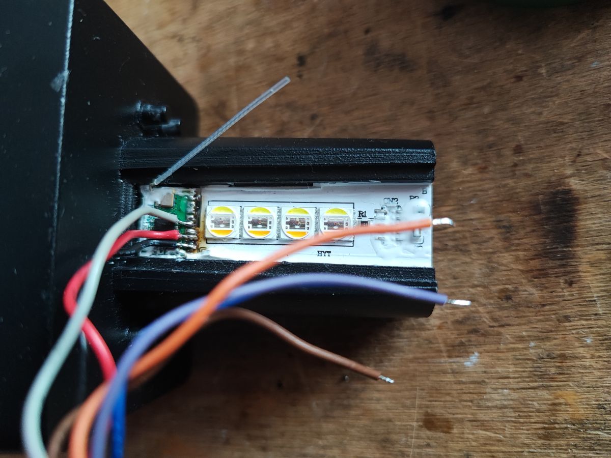

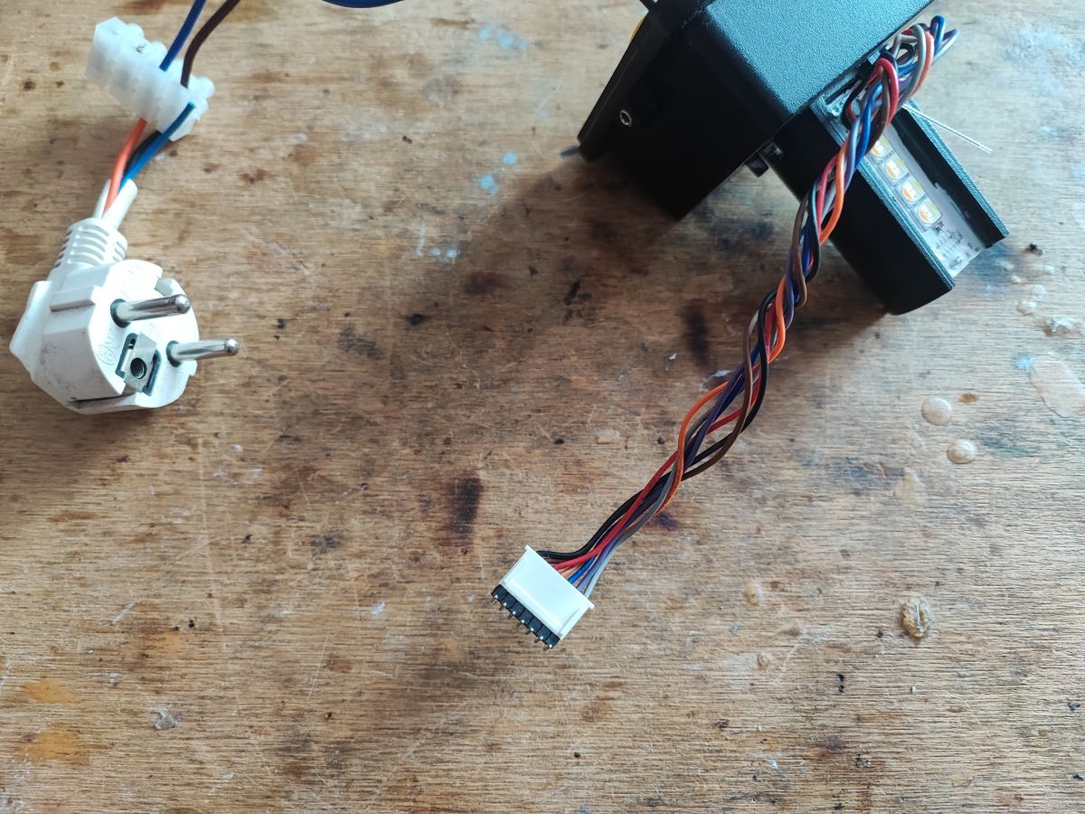

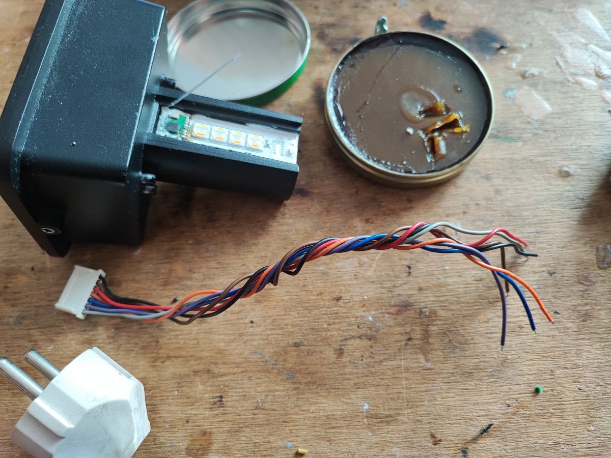

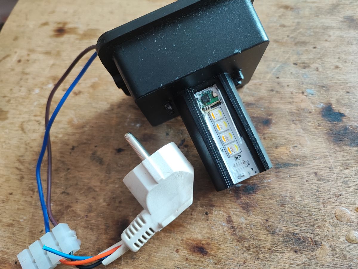

    In the previous topic about this lamp, I desoldered its WiFi module in order to, among other things, read the markings of its pads. I now know where which signal is routed out. The lamp itself only uses one pin (from P16, that's the SPI hardware data output) to control a WS2812B style LED controller. The rest of the pads are free and can be used....
    That being said, I'm reaching for the scrap cables, time to whittle and solder them:
    Opened electronic device with visible LED lights and wires on a wooden surface. View of LED lamp interior with exposed wires. .
    Done, I also checked everything for short circuits, there are none:
    Dismantled electronic device with cables and a plug on a wooden table. .
    This way we get ground, 3.3V power supply and 5 scriptable GPIOs.

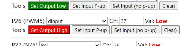

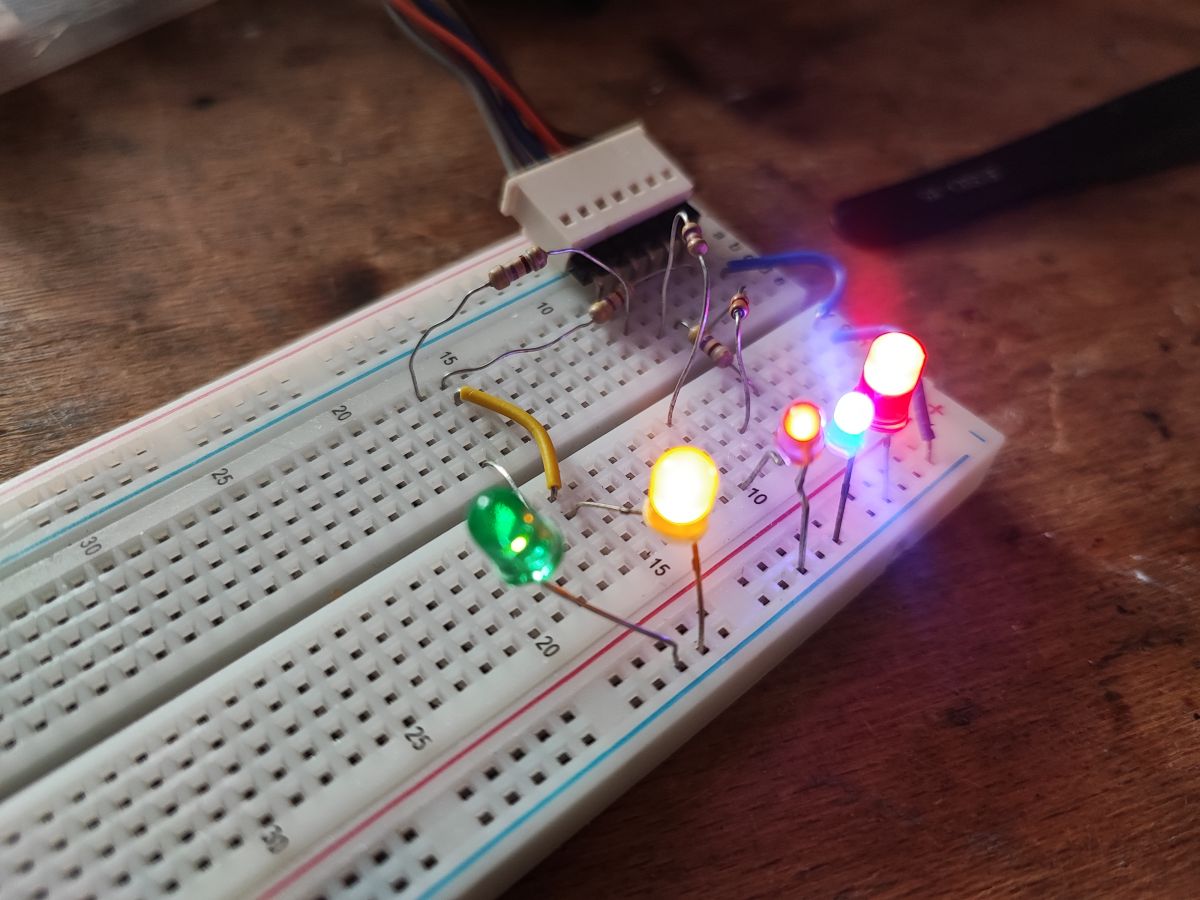

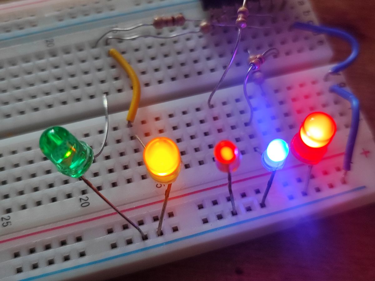

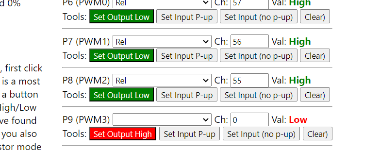

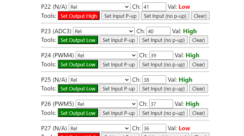

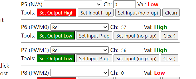

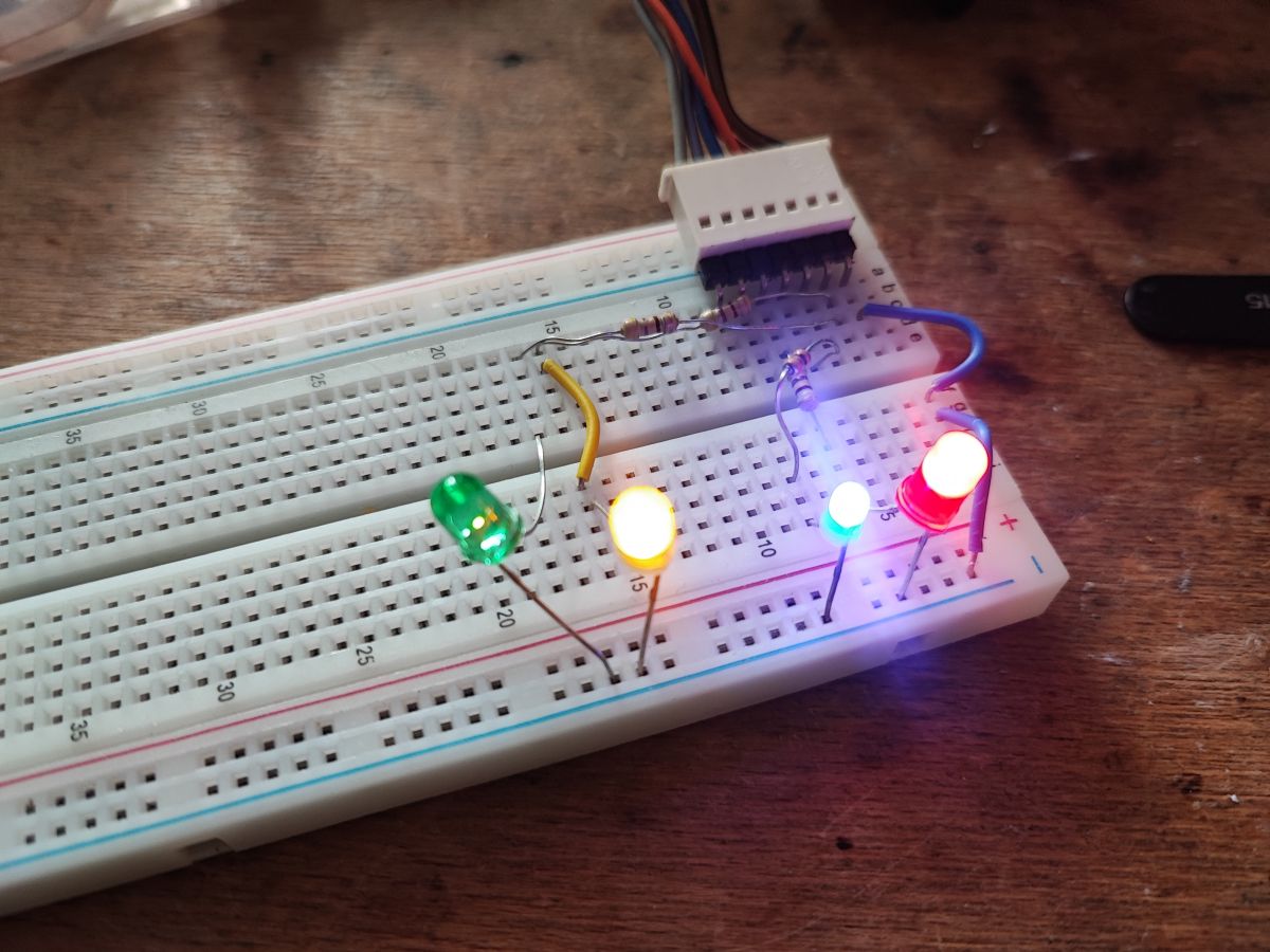

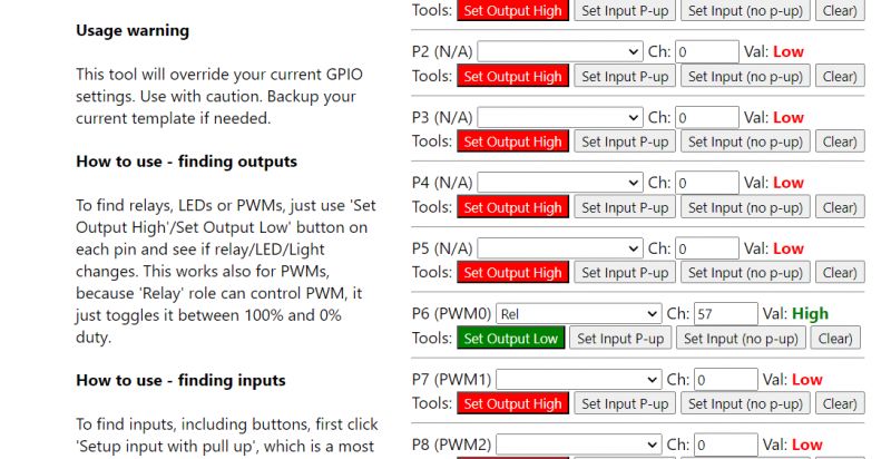

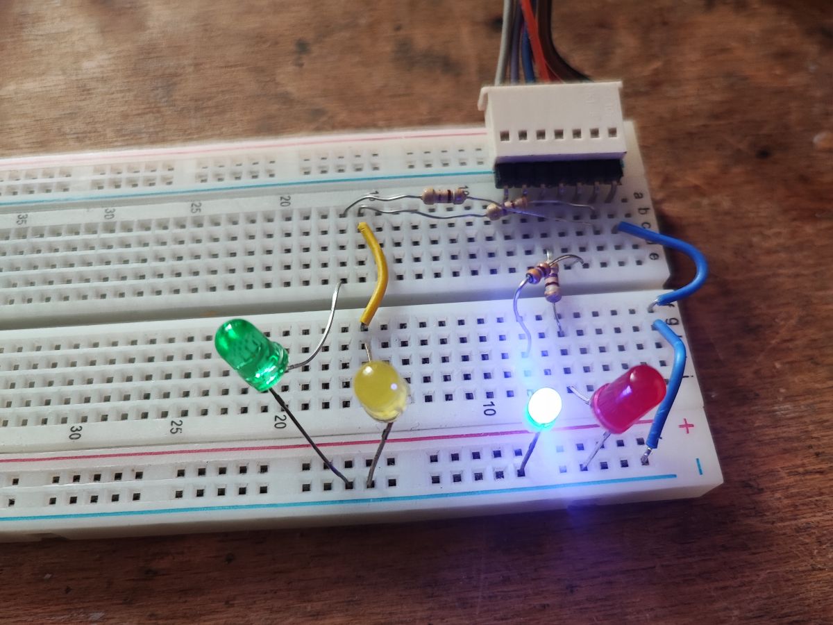

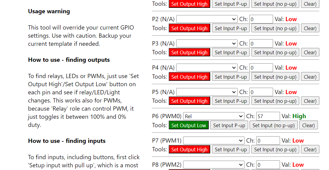

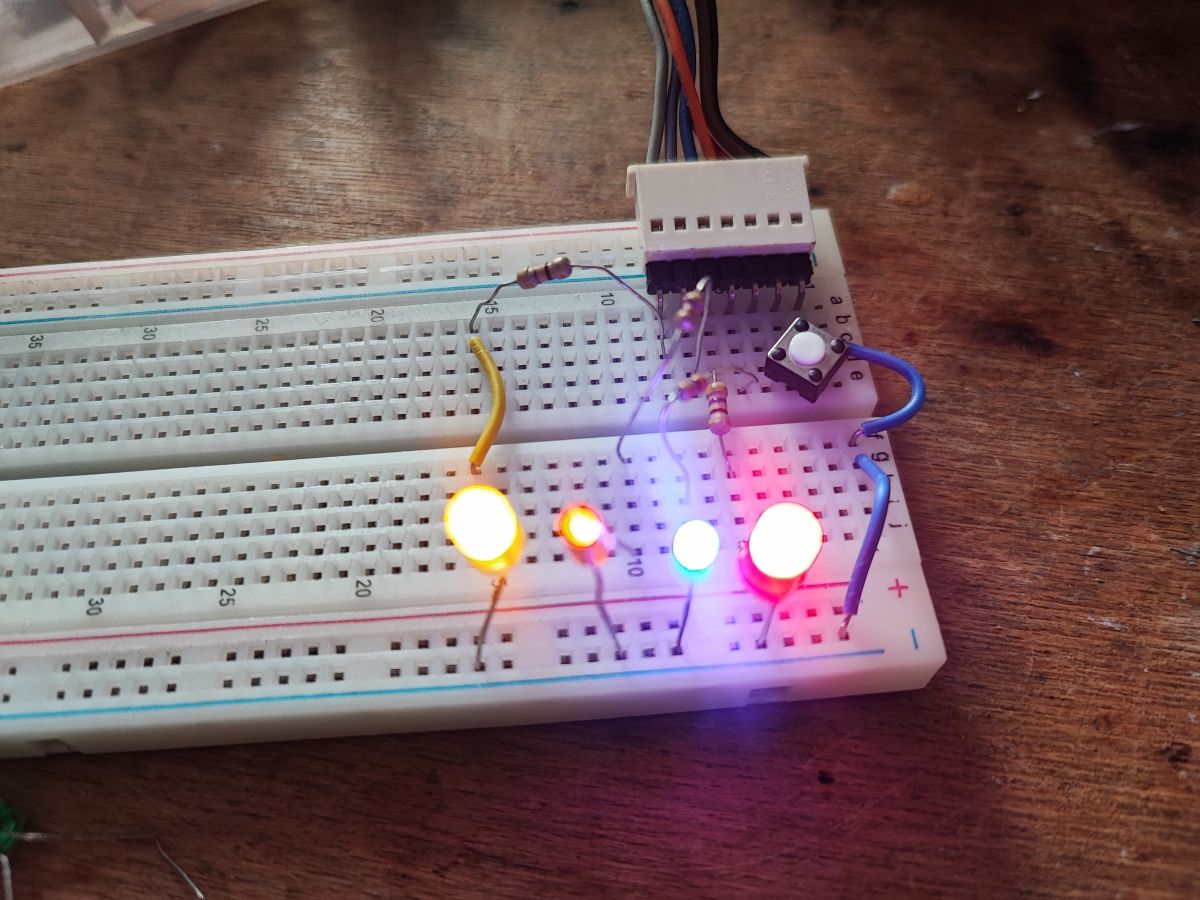

    To start with something simple - LEDs. I connected these five LEDs, each with a suitable resistor, I had 0.47k on hand. I will test their operation using the GPIODoctor tool from OpenBeken. This tool allows you to quickly test all available GPIOs as inputs or outputs.
    P6 is the blue LED:
    Screenshot of the OpenBeken GPIO configuration tool. .
    Close-up of a breadboard with colored LEDs and resistors. .

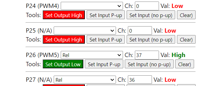

    P26 yellow:
    Screenshot of a tool for setting GPIO states. .
    Prototype board with multicolored LEDs .
    P7 red:
    Screenshot of GPIO settings interface in OpenBeken.
    P8 orange:
    Screenshot of GPIO configuration in OpenBeken application..
    Colorful LEDs on a breadboard .
    P24 green (yes, I had it wired wrong):
    Screenshot of the GPIO control panel in OpenBeken. .
    Breadboard with connected LEDs in various colors. .
    Equipped with this knowledge, we can assign them one of the many ready-made GPIO roles supported by OBK:

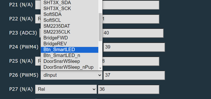

    Add a button .
    OpenBeken offers many predefined GPIO roles that work as soon as they are configured, and this lamp did not normally have a button, making it useless without a phone. We can change this.
    We connect the button to the selected GPIO. No resistor is needed as the BK7231 has internal configurable pull-up resistors:
    View of a breadboard with connected LEDs of various colors and a button. .

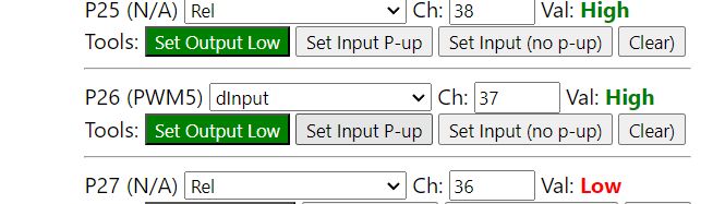

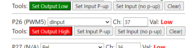

    Then you can start by testing in GPIO Doctor if everything works:
    User interface showing GPIO settings for an IoT device. .
    User interface for configuring GPIO on an IoT device. .

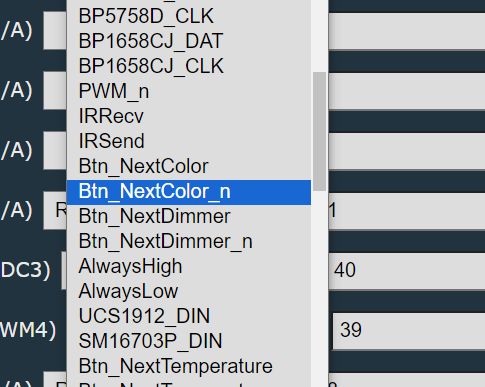

    After that, you can normally in the GPIO roles assign for the selected GPIO one of the predefined roles for LED lamps, preferably Btn_SmartLED:
    GPIO settings interface for LED lamp with OpenBeken firmware. .
    Test (click):
    We test (press):
    We test (double-click):
    I think I need to improve the response times (there is a command for this), because I press too fast....
    Of course, typing everything under one button might not be convenient - that way we also have separate roles, e.g. Btn_NextColor , but then you need more buttons.
    Screenshot of GPIO function selection menu with Btn_NextColor_n option highlighted. .

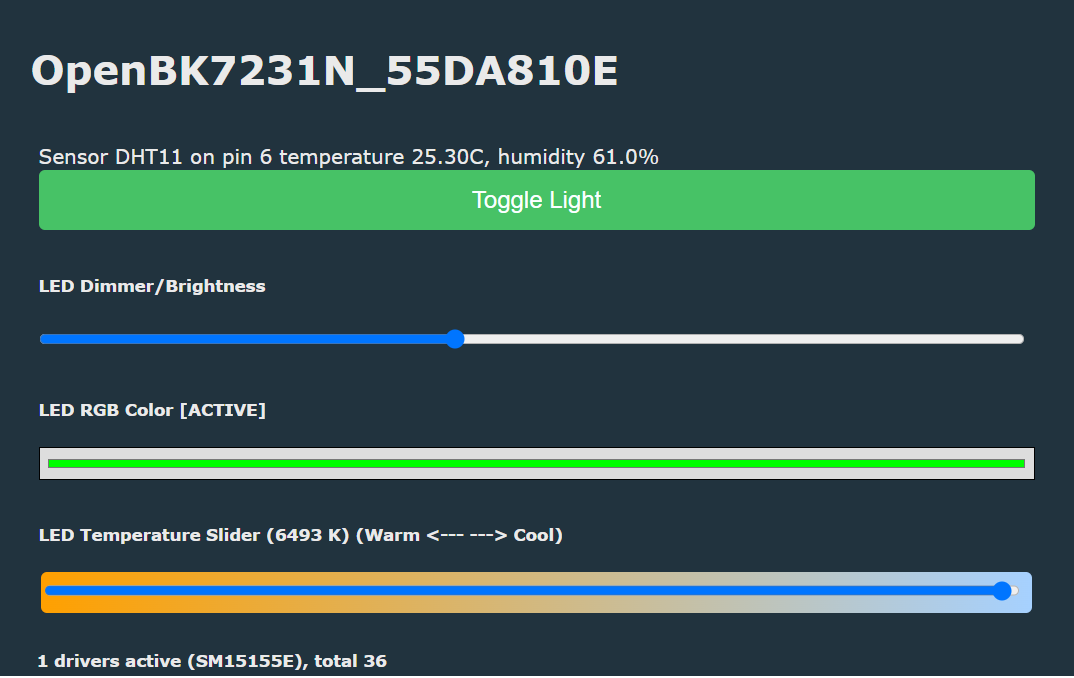

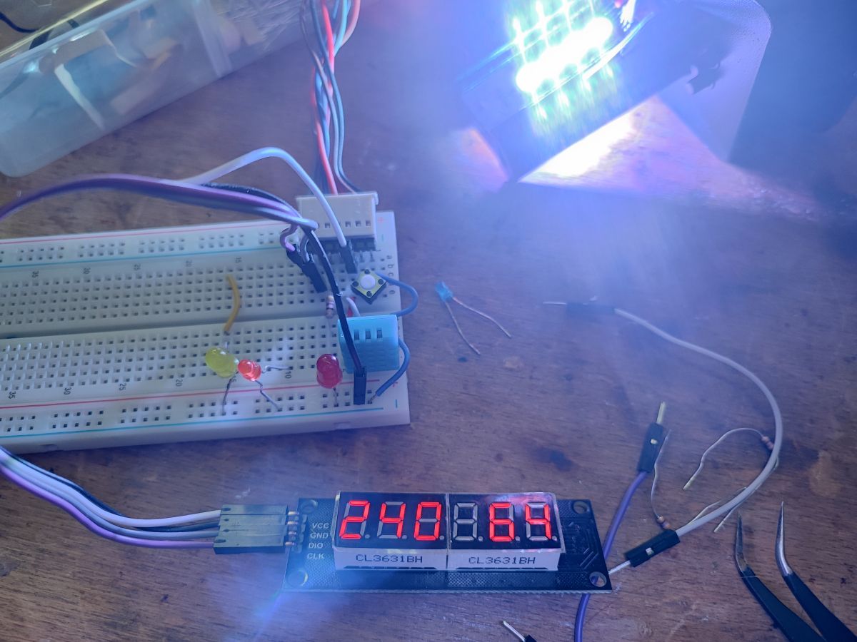

    DHT11 sensor .

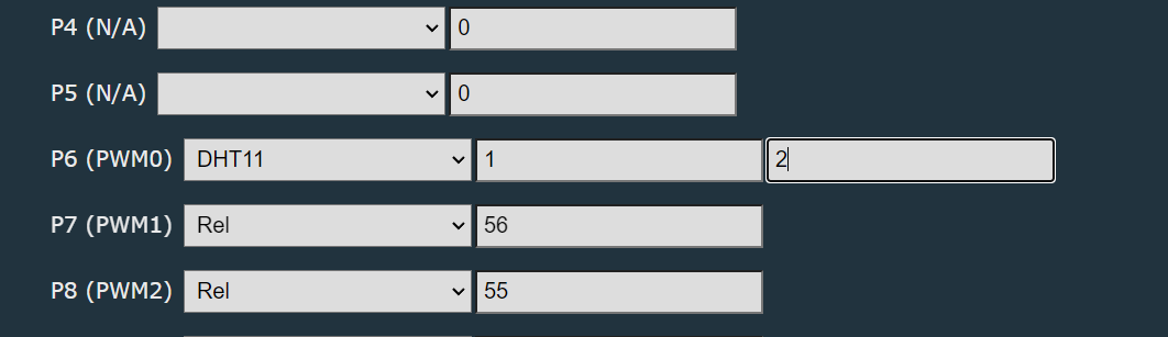

    It's time for something more ambitious. Now we'll connect the DHT11 temperature and humidity sensor. Let's pick a pin, say P6:
    Screenshot of GPIO configuration with assigned roles such as DHT11 and relays. .
    In addition to the pin, you need to enter the channels in which the results will be stored. If we have a relay on a channel, for example, we skip that index and enter the next one.
    And that's it, everything works:
    OpenBeken interface for a lamp with firmware on BK7231N with DHT11 sensor .
    After performing Home Assistant Discovery, these results will also be in HA.

    <spanclass="notranslate"> Display .
    The presented firmware also supports a large number of different LED displays (or more precisely their drivers), including TM1637, TM1638, HT16K33, HD2015, etc, full list here:
    https://github.com/openshwprojects/OpenBK7231T_App/blob/main/docs/drivers.md

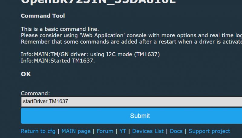

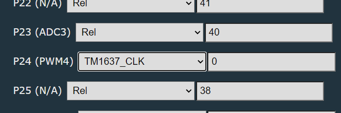

    I had a TM1637 on hand, time to get it working. I selected the pins:
    - P24 - CLK
    - P8 - DIO
    GPIO configuration interface in the OpenBeken application. .

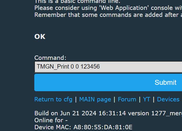

    Now all you need are a few commands, the documentation is here:
    Some drivers may not be included in the public binary files, but this was explained in the topic:
    System online builds OpenBeken - firmware compilation for all platforms on Github .

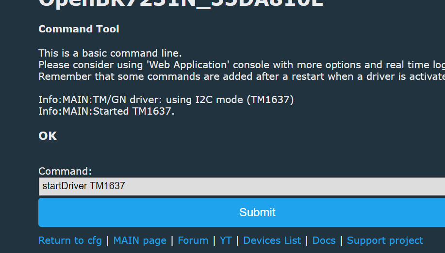

    Fire up and display:
    OpenBeken interface screen with TM1637 driver started .
    Online interface screen for entering commands for IoT devices with the command TMGN_Print. .
    Result:

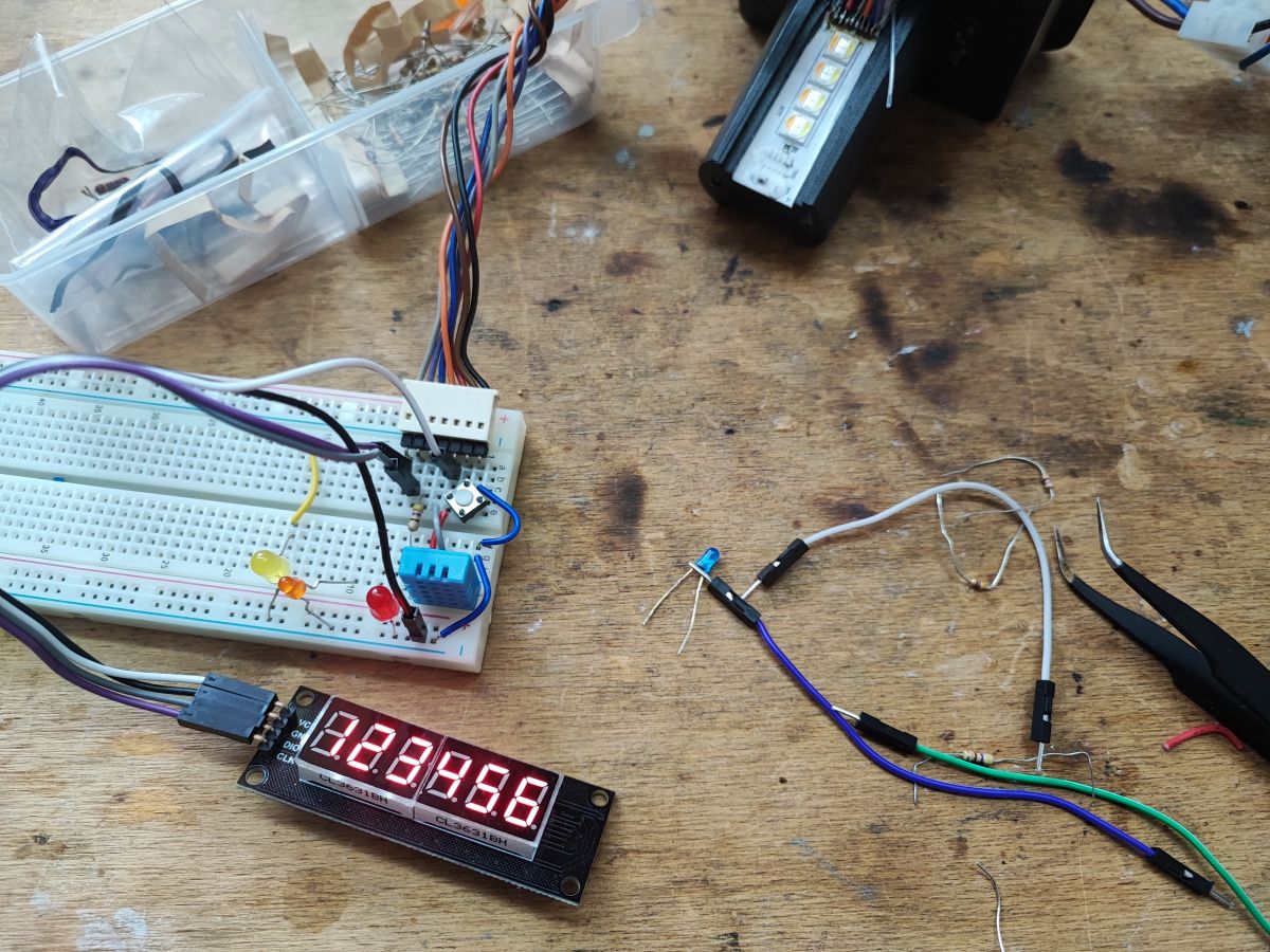

    Prototype with a breadboard, LEDs, and a display on a wooden table. .
    However, that is not all. The firmware also has the seed of a scriptable system allowing, for example, commands to display measurements from the DHT11. Here is an example:
    backlog TMGN_Clear; TMGN_Print 0 0 $CH1; TMGN_Print 4 0 $CH2
    Result:
    Prototype electronic circuit on a breadboard with LEDs and a display. .
