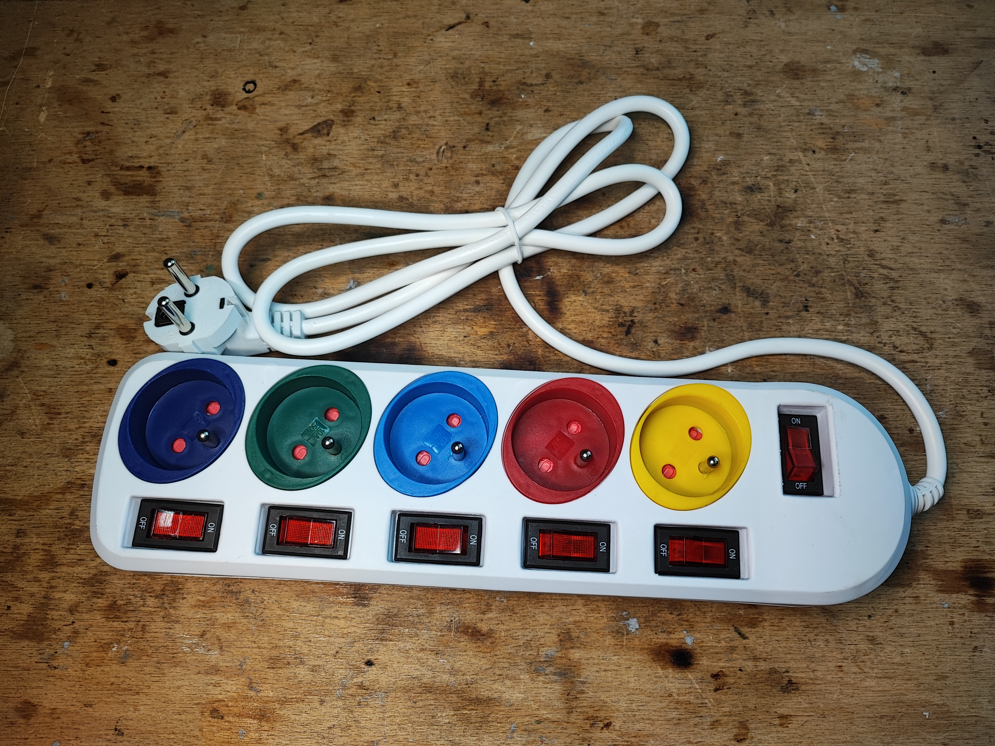

  • The Interlook BA-3505-WHITE power strip has five coloured sockets, separate switches for each outlet, a main switch, and advertised anti-surge and USB-device protection.
  • Opening it reveals a simple internal build: the grounding is connected, but the socket switches appear to cut only one conductor.
  • The supposed protection circuitry is just a single 14D471K varistor soldered loosely at the strip switch.
  • The solder joints look poor and some seem close to failure, so the strip hardly inspires confidence for a 10A rating.
Power strip Interlook BA-3505-WHITE with colorful sockets and switches. .
Today we are checking out another extension strip, this time with five coloured sockets with separate switches. In addition, the strip has one main collective switch. The strip is advertised as having an "anti-surge system" and a "protection system for USB-charged devices" so it's bound to be interesting.

Inside of the strip in practice... .
An ordinary Phillips screwdriver is required to get inside:
Interlook BA-3505-WHITE power strip with cable on a wooden surface. .
Manufacturer label on Interlook BA-3505-WHITE power strip.
Interior - well, at least the ground is connected:
Interior of a power strip with colorful sockets and visible wiring. .
It looks like the switches are cutting off one conductor - in theory they are supposed to cut off the phase....
Interior of a power strip with colorful sockets and switches. Interior of a power strip with colorful sockets and green wires.
Soldering joints are looking a bit bad.
And here we have our "anti-surge system":
Interior of a power strip with wires and a varistor. .
Let's take a look at it:
Interior of a power strip with colorful sockets, visible green wire and blue varistor. .
This is a 14D471K varistor:
Table with technical data of metal-oxide varistor 14D471K. .
By the way, the solder joint here is especially bad:
Poor soldering of a wire in a power strip.
Summary
The mysterious two systems ("surge protection system" and "USB charged device protection system") turned out to be a single 14D471K varistor soldered loose at the strip switch. Apart from that, the solder joints are conspicuous, one looks like it is about to let go. They do not look like they are rated for 10A. Overall, I can hardly recommend this product.
By the way, I once bought a strip of this type for testing and it turned out that... after a year of use, the earthing pin fell off. Maybe I'll show its condition at some point.
And then there's the short-circuiting of the phase output to zero when the socket in question is switched off.... I hope no one accidentally plugs in the plug the other way round, because then it won't work, and there are also such sockets.
In conclusion - I am not convinced, what do you think?

acctr 08 Jul 2024 15:48
They short circuit to the other? You mean they make a short circuit? Sounds ridiculous, it's more of a backlighting of the switch :) [Read more]
p.kaczmarek2 08 Jul 2024 15:58
You are probably right, thanks for the correction. [Read more]
Mateusz_konstruktor 08 Jul 2024 16:10
Can a colleague carry out a small practical test? This involves measuring the voltage at one of the sockets: A. Without any consumer connected. B. With a load connected that is close to the declared... [Read more]
acctr 08 Jul 2024 16:18
. You can guess that there will be quite a difference between the voltage on the first and last sockets, looking from the main switch. [Read more]
p.kaczmarek2 08 Jul 2024 16:41
@mateuszkonstruktor This is something I did quickly on a "brother" strip, because I have just this one at hand (separately I have two other corners to work) Without kettles 237V not much, with one 232V... [Read more]
