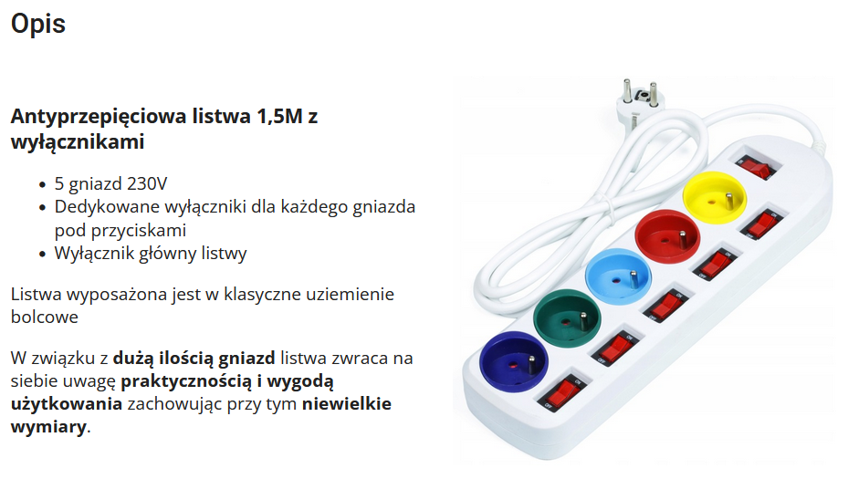

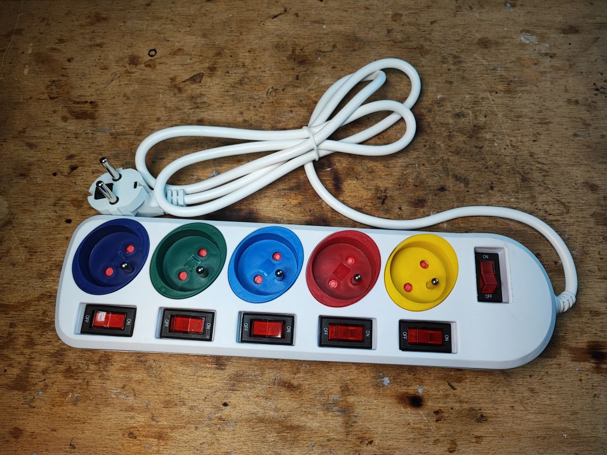

    Today we are checking out another extension strip, this time with five coloured sockets with separate switches. In addition, the strip has one main collective switch. The strip is advertised as having an "anti-surge system" and a "protection system for USB-charged devices" so it's bound to be interesting.
    I showed a similar strip (but with a USB charger) 2 years ago in a topic:
    Power strip with separate switches for sockets and USB charger - interior, quality... .

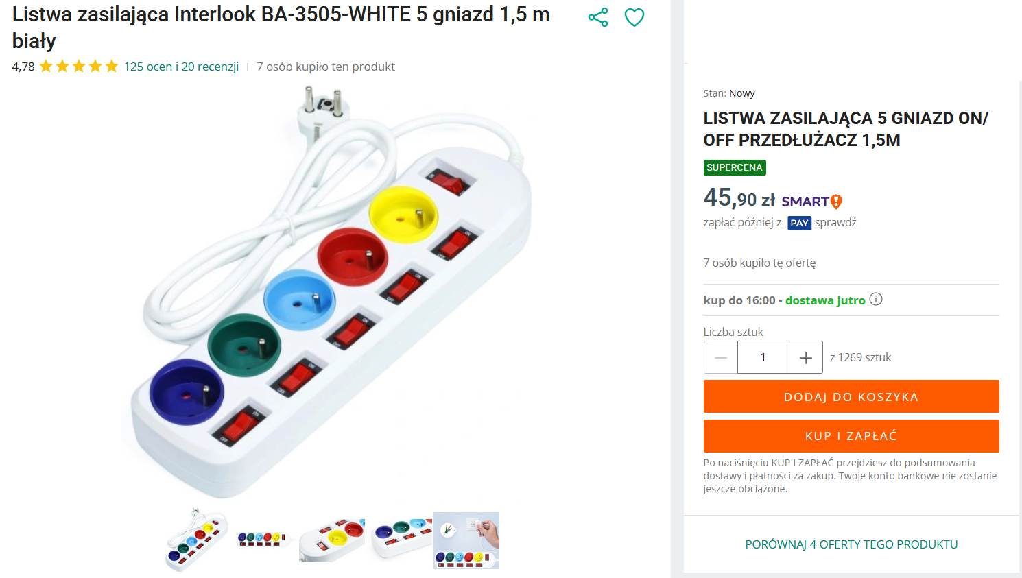

    Let's start with a screenshot of the offering:
    Interlook BA-3505-WHITE power strip with five colorful sockets. .
    The model of the strip is the Interlook BA-3505-WHITE.

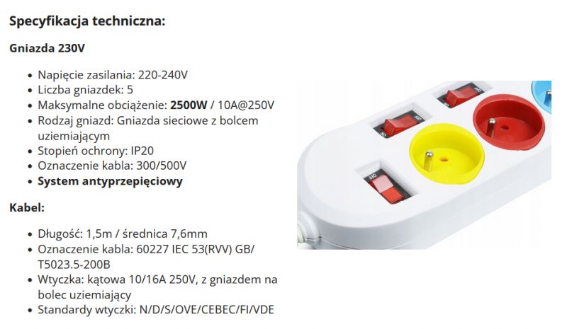

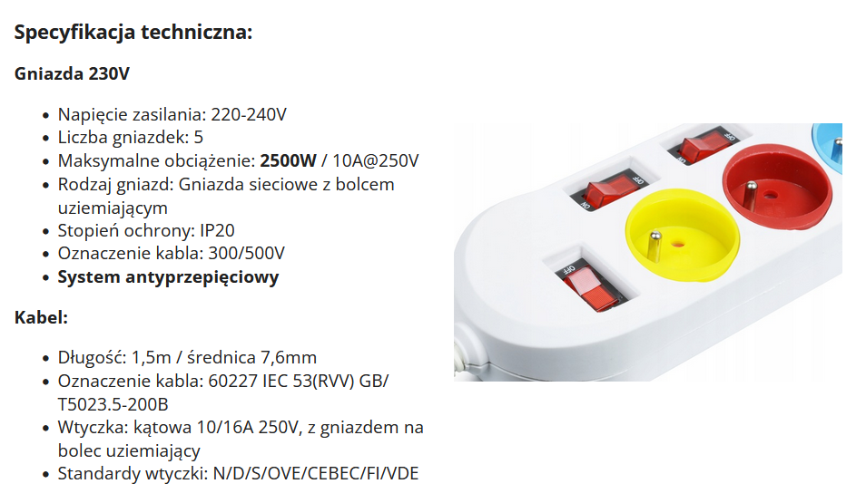

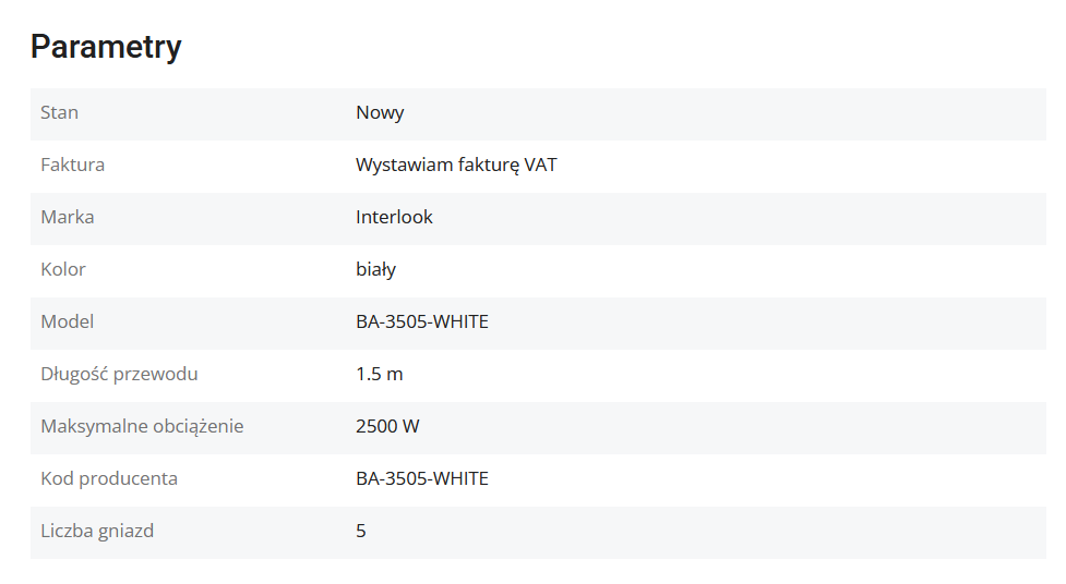

    Parameters:
    Screenshot of specifications for Interlook BA-3505-WHITE power strip. .

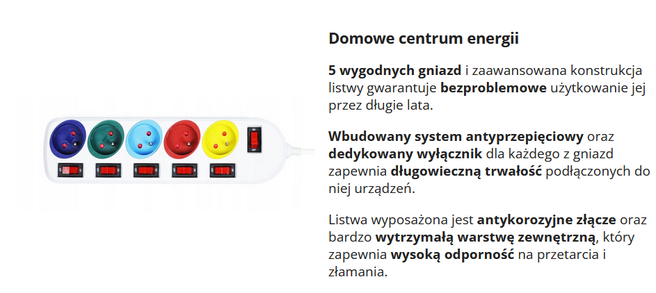

    Description - surge protection strip:
    Surge protector power strip with five colorful sockets and switches. .
    System anti-surge and anti-corrosion connector:
    Power strip with five colorful sockets and switches. .

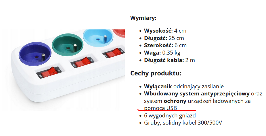

    Once again - anti-surge system:
    Power strip with five colorful sockets and technical specifications .
    And the icing on the cake - another system - this time to protect USB-charged devices (what USB?):
    Interlook BA-3505-WHITE power strip with colorful sockets and switches. .

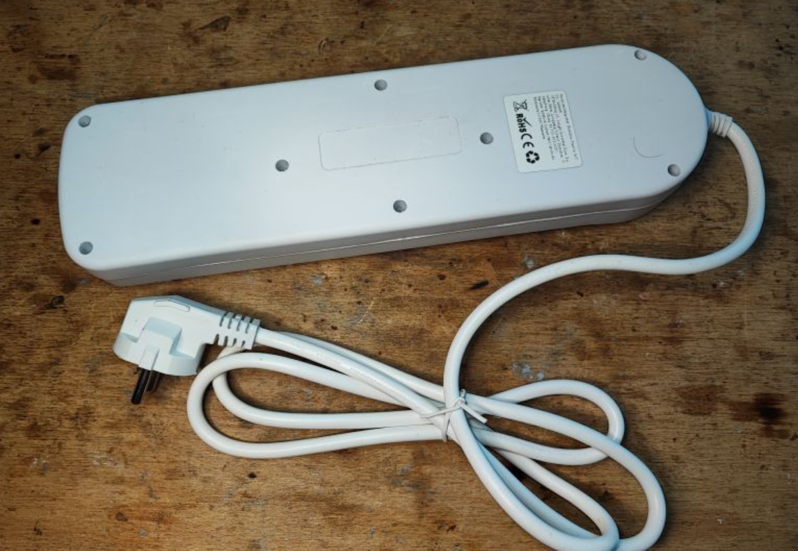

    Inside of the strip in practice... .

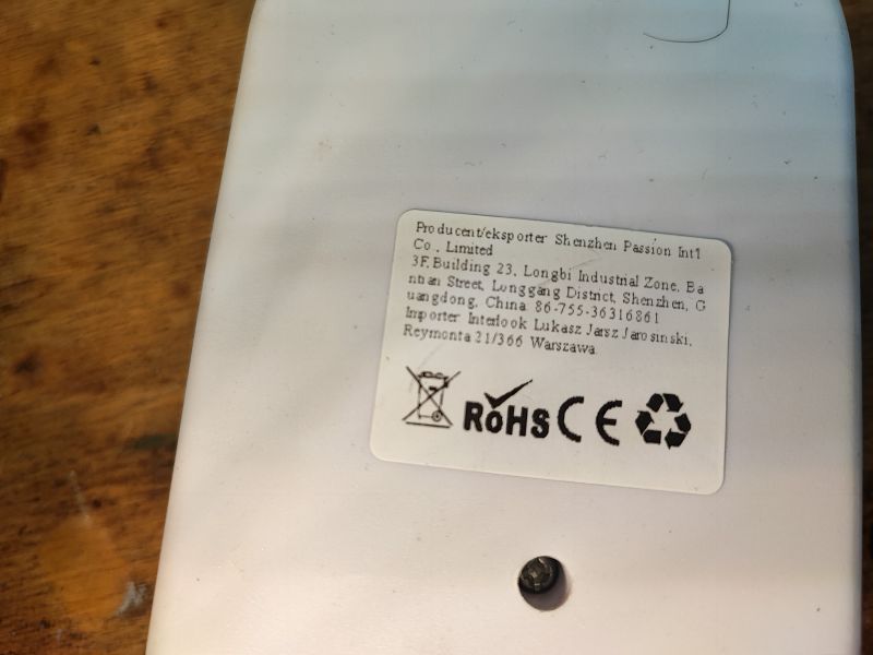

    An ordinary Phillips screwdriver is required to get inside:
    Interlook BA-3505-WHITE power strip with cable on a wooden surface. .
    Manufacturer label on Interlook BA-3505-WHITE power strip.

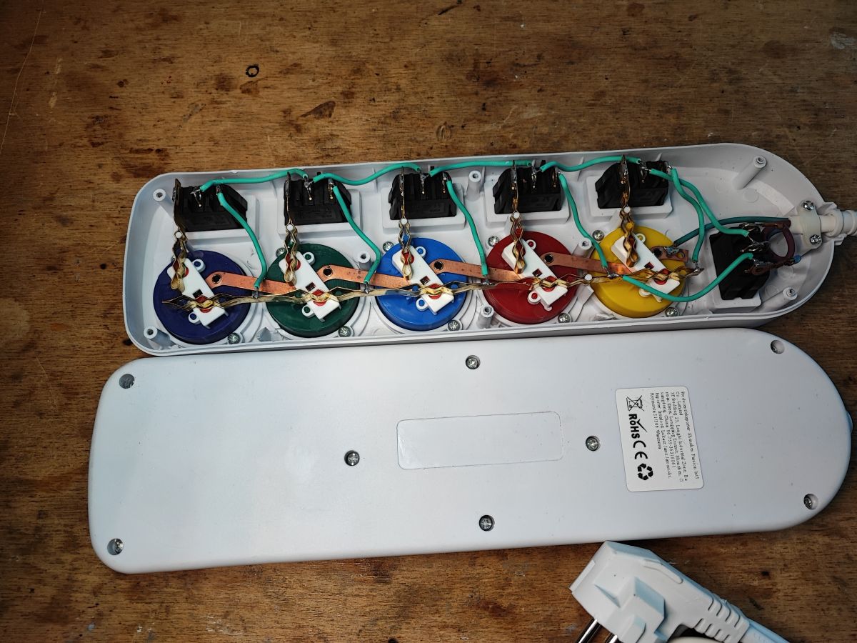

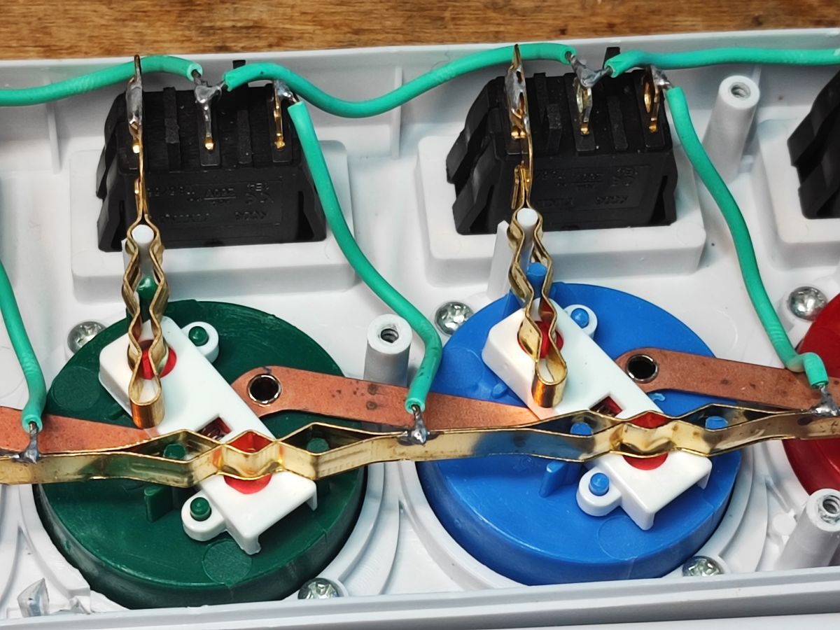

    Interior - well, at least the ground is connected:
    Interior of a power strip with colorful sockets and visible wiring. .

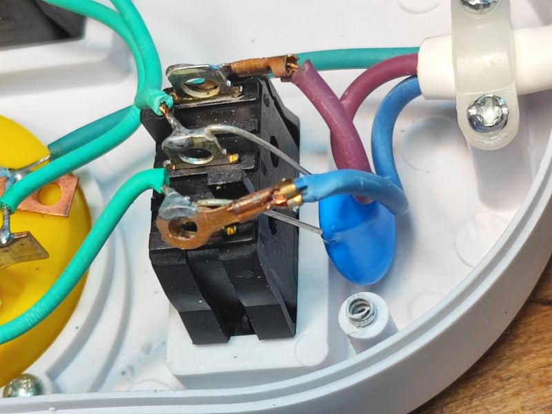

    It looks like the switches are cutting off one conductor - in theory they are supposed to cut off the phase....
    Interior of a power strip with colorful sockets and switches. Interior of a power strip with colorful sockets and green wires.

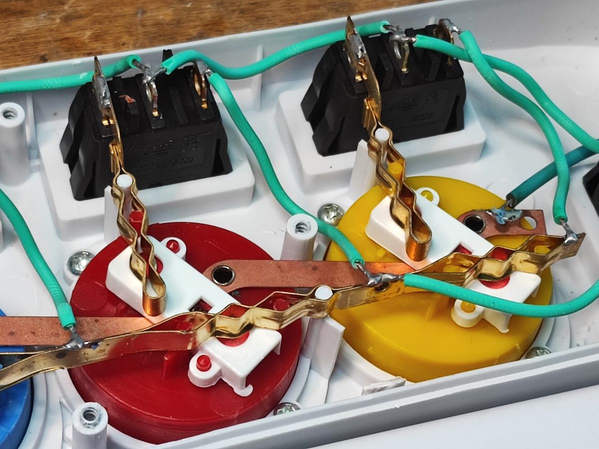

    Soldering joints are looking a bit bad.

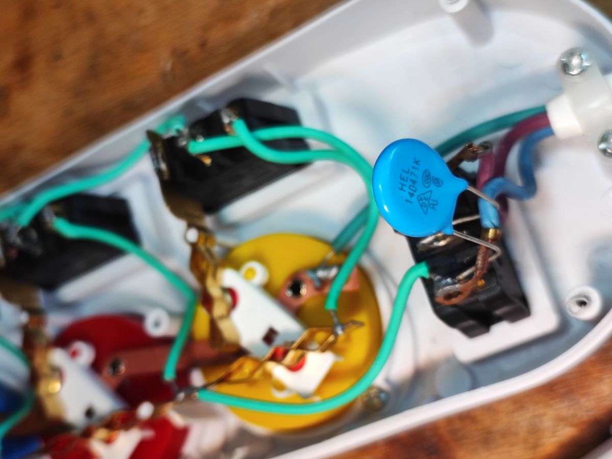

    And here we have our "anti-surge system":
    Interior of a power strip with wires and a varistor. .
    Let's take a look at it:
    Interior of a power strip with colorful sockets, visible green wire and blue varistor. .

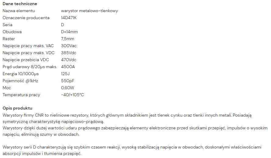

    This is a 14D471K varistor:
    Table with technical data of metal-oxide varistor 14D471K. .

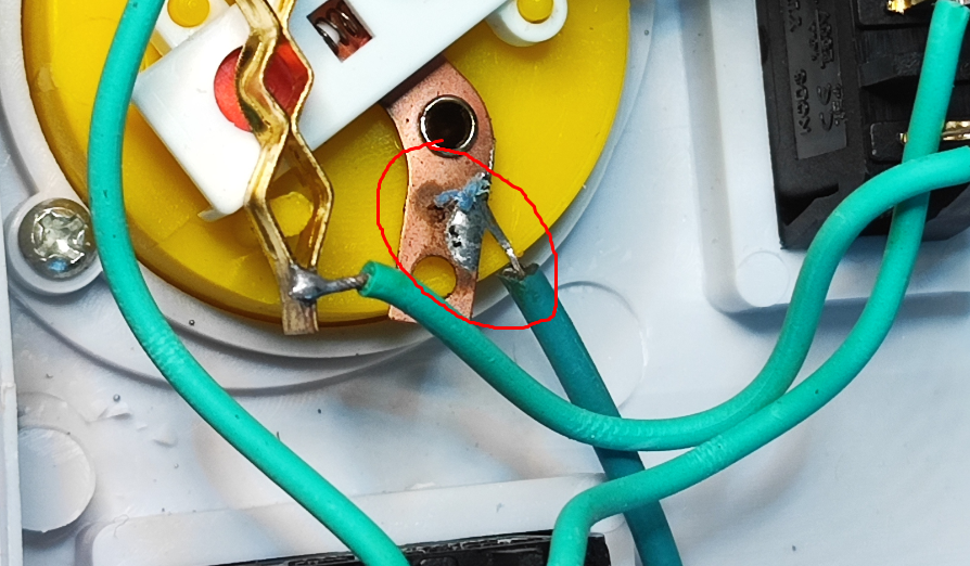

    By the way, the solder joint here is especially bad:
    Poor soldering of a wire in a power strip.
    Summary
    The mysterious two systems ("surge protection system" and "USB charged device protection system") turned out to be a single 14D471K varistor soldered loose at the strip switch. Apart from that, the solder joints are conspicuous, one looks like it is about to let go. They do not look like they are rated for 10A. Overall, I can hardly recommend this product.
    By the way, I once bought a strip of this type for testing and it turned out that... after a year of use, the earthing pin fell off. Maybe I'll show its condition at some point.
    And then there's the short-circuiting of the phase output to zero when the socket in question is switched off.... I hope no one accidentally plugs in the plug the other way round, because then it won't work, and there are also such sockets.
    In conclusion - I am not convinced, what do you think?

    It appears that the switches cut off one wire and in addition short-circuit it to the other, in theory they are supposed to cut off a phase...
    They short circuit to the other? You mean they make a short circuit? Sounds ridiculous, it's more of a backlighting of the switch :)
  • #3 21147379
    Posts: 14761
    Rate: 12891
    You are probably right, thanks for the correction.
