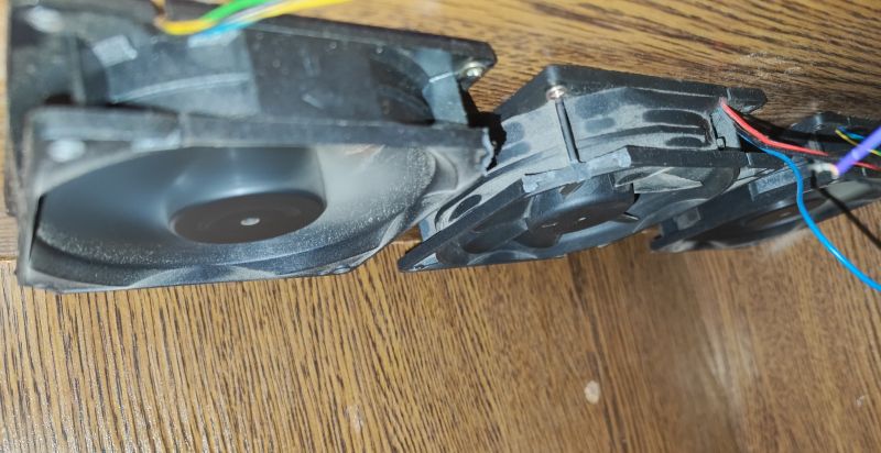

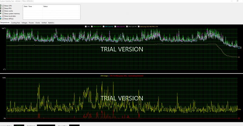

Today I'm testing whether a custom cooling pad for a laptop can lower its temperatures. Actually it will be a table conversion, so more of a "cooling table". Measurements will be taken on the CPU and on the SSD. I will show the whole thing on the graphs - I will contrast the operation without the pad and with the pad in two modes (quiet and strongest).

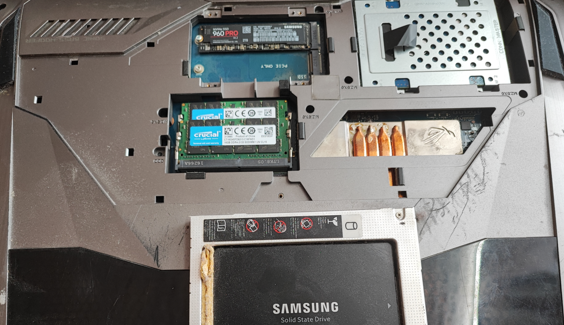

I made the cradle by placing three computer fans in holes made in an old table. Initially, I also wanted to make the laptop a 'seat' to lift it slightly, but in the end I decided to do things differently - I took the liberty of removing the bottom cover of the laptop so that the drives, RAM and part of the heatsink were exposed:
Open laptop underside with visible internal components, including a Samsung SSD and Crucial RAM. .

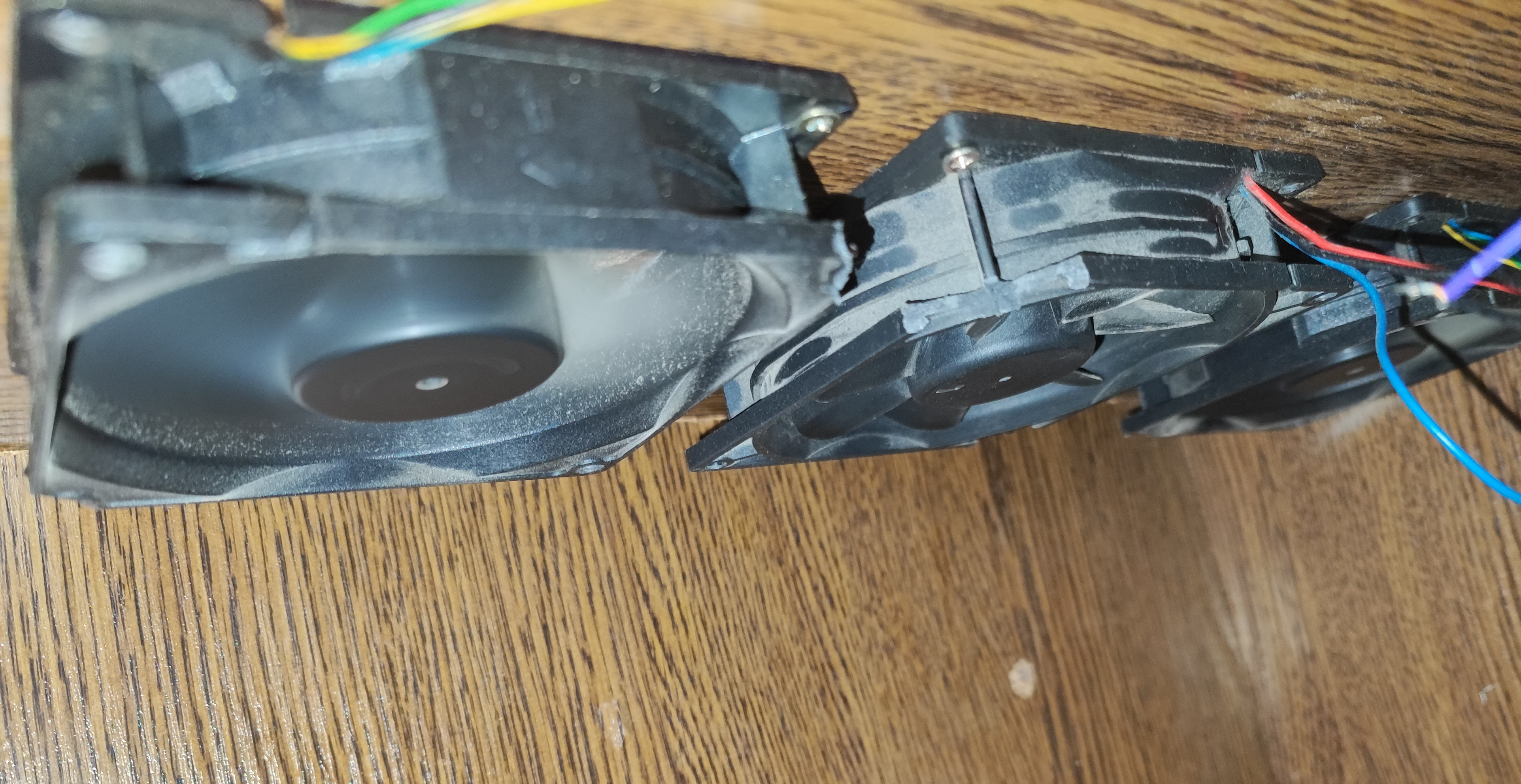

As for the details of the build of the stand, there's nothing to brag about as I've simply mounted the fans under the table - I'll provide one photo:
View of three mounted computer fans under a wooden table. .
This is during testing, normally 3 fans are running.

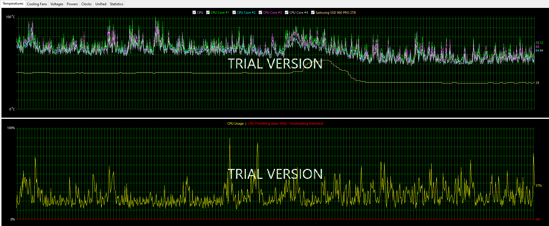

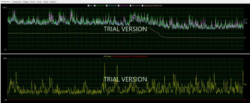

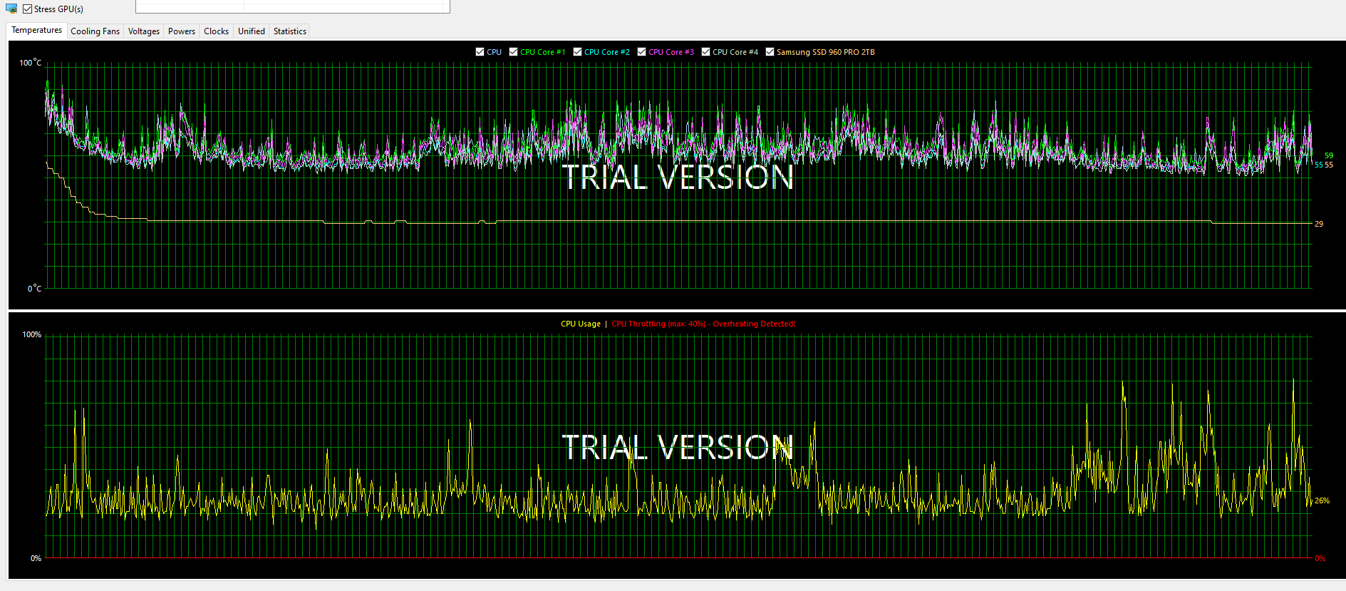

So let's have a look - sorry for the wrong order - the graph below is the transition from 50% blowing to 100% :
Graphs of CPU temperatures and load during laptop cooling tests .
Pardon the moment with the blowing turned off.
That is, at 50% blowing the SSD was about 40 degrees, and at 100% it dropped to 30. The CPU cores at 100% blowing oscillate around 62-72 degrees, and at 50% it was about 10 degrees more (72-82).

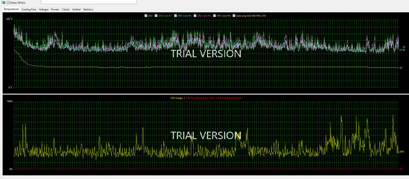

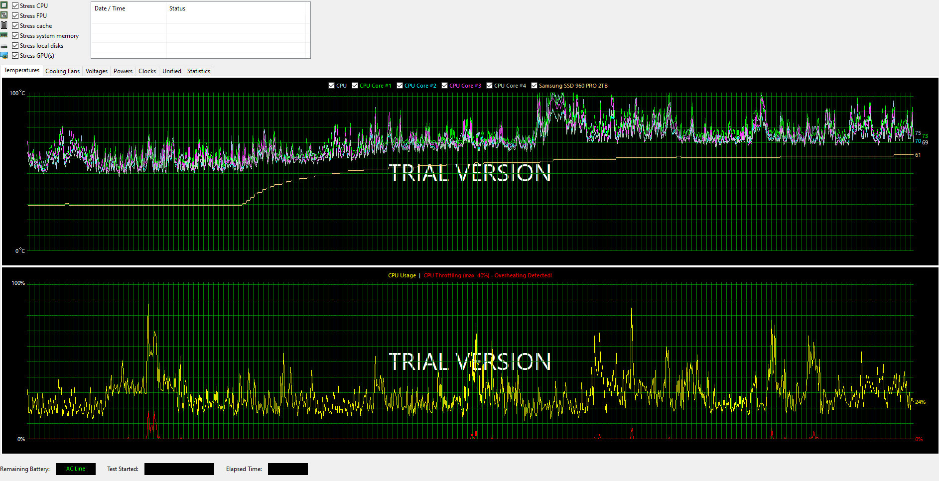

Below the second graph - going from 100% blowing to 0% :
CPU and SSD temperature graph during cooling test. .
Above, you can see that without my stand, the SSD heats up to 61 degrees and the CPU oscillates around 70-80 degrees, reaching higher temperatures over time.

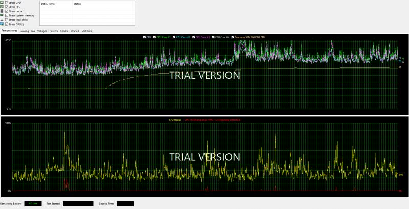

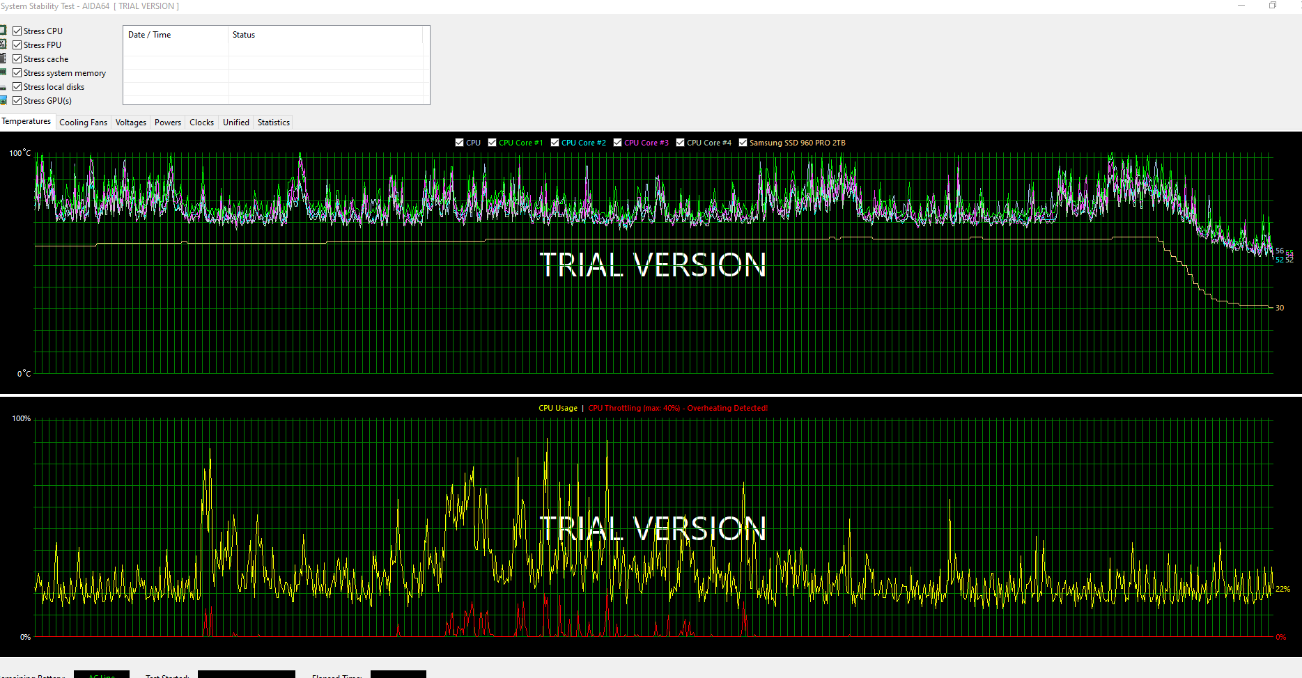

Below the same graph after some time:
System stability test graphs in AIDA64 showing temperatures and CPU usage. .
Above you can see that the temperature is still rising, with the cores reaching 80-92 degrees.

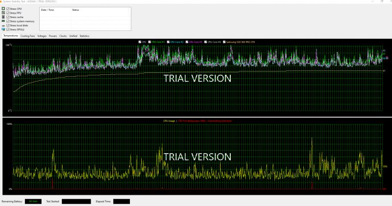

Ok, I turn it back on to full cooling, see below: .
Temperature and CPU usage graphs in AIDA64 Temperature and CPU usage charts from a laptop cooling test. .
SSD is down to 30 degrees, cores are at about 50-60. not bad!

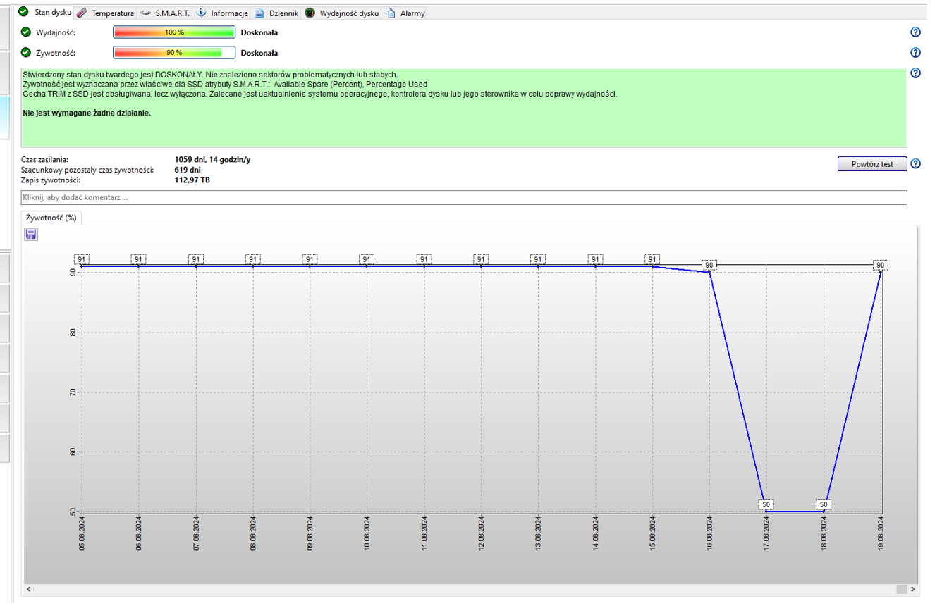

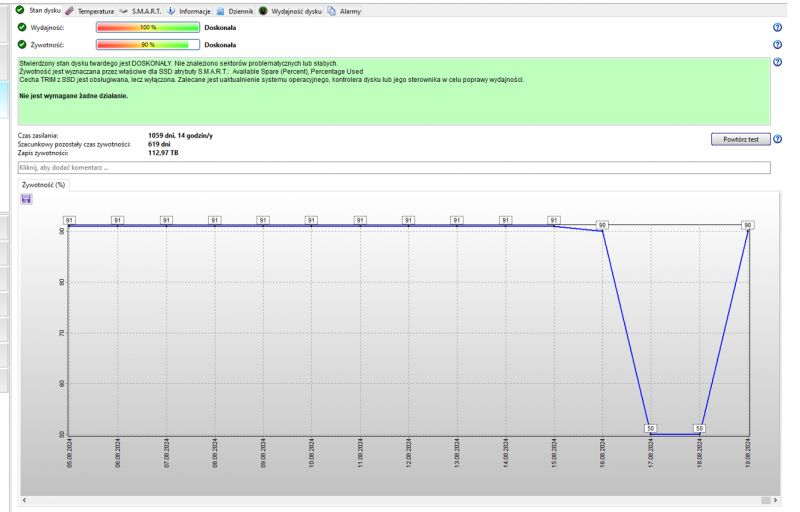

Interesting fact 1 .
While working hard under load, one of my SSDs, a Samsung 960 PRO 2TB suddenly started showing a health of 50% instead of 90%. At first I didn't know where it was coming from, but then it went back to 90%. After some more experimentation I realised that it shows 50% when it overheats - i.e. its temperature changes the health reading....
Screenshot of a utility software displaying SSD health monitoring. The graph shows variability in SSD health over several days.

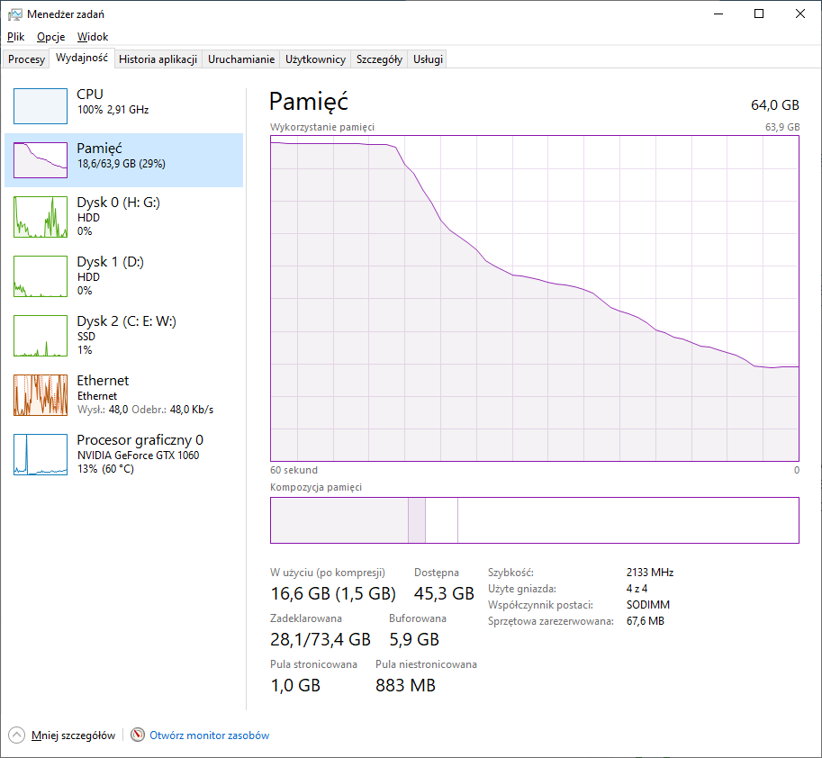

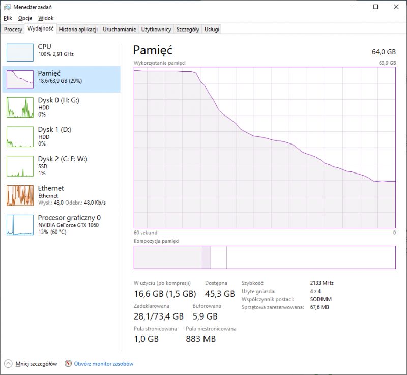

I used AIDA to monitor the temperatures, and this program gave me one surprise - after 5 hours of testing I suddenly started running out of RAM, and the task manager showed that AIDA was taking up over 40GB.... I momentarily aborted its process, and took this snapshot as a reminder:
Screenshot of Windows Task Manager displaying RAM usage. .
