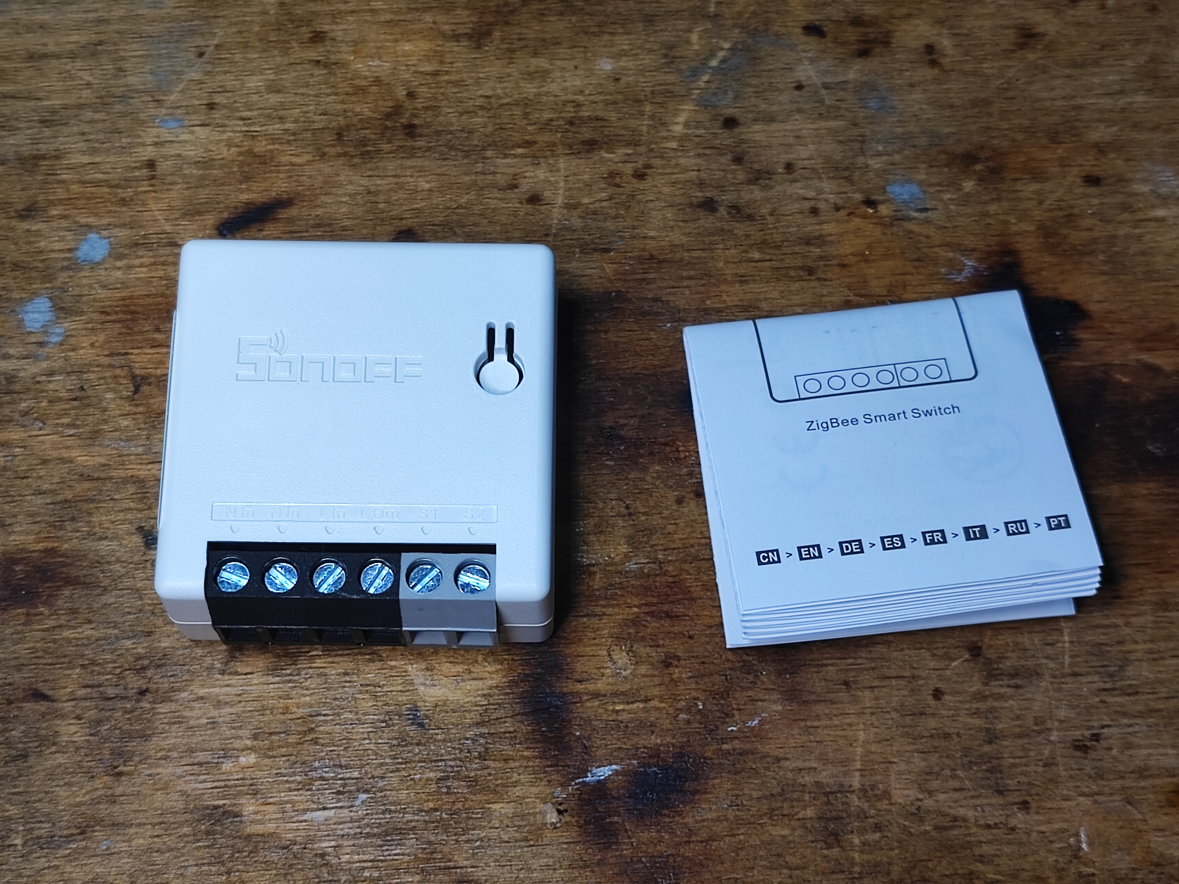

Sonoff ZBMini relay and user manual on a wooden surface. .
The Sonoff ZBMini is a tiny, in-box relay controlled via the Zigbee protocol. These models are characterised by their small dimensions of 42.6*42.6*20 mm and their ability to work with a light switch from an existing installation (bistable). As usually, I will present here connecting it to the Home Assistant via Zigbee2mqtt, I will not even test the manufacturer's gateway.

Small Sonoff ZBMini relay next to a user manual on a wooden surface. Sonoff ZBMini relay with manual on a wooden table Photo of the Sonoff ZBMini device with visible technical markings on the casing. View of Sonoff ZBMini with manufacturer information Shenzhen Sonoff Technologies Co., Ltd. View of Sonoff ZBMini with manufacturer information Shenzhen Sonoff Technologies Co., Ltd. .
There is nothing else in this kit.

Sonoff ZBMini is a small, white Zigbee relay with wiring, placed on a wooden surface. Close-up of Sonoff ZBMini with an illuminated button. .
There is no problem with this, with me a new device is immediately detected: .
