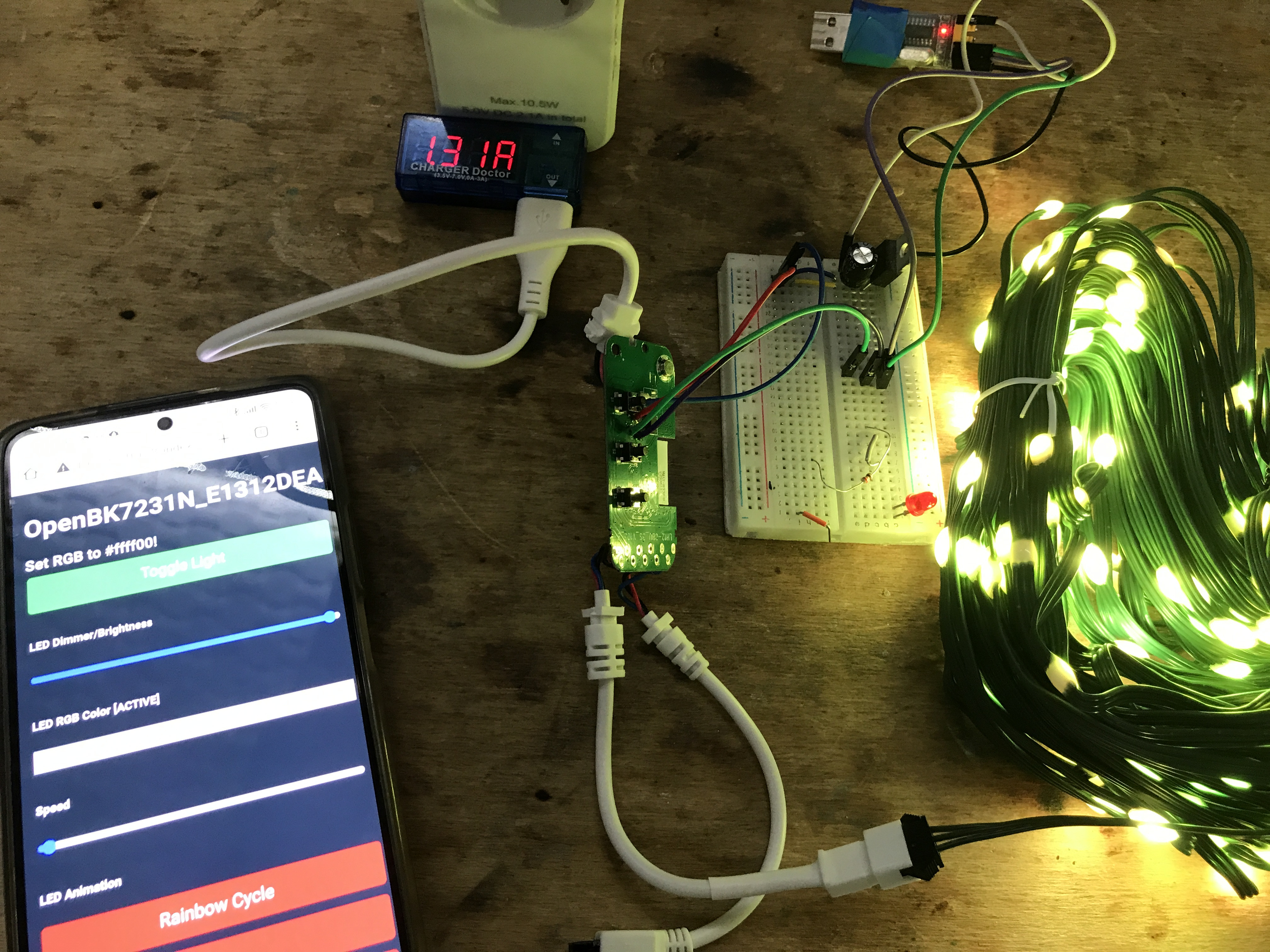

Flashing went smoothly, OpenBeken created its access point, where I entered my WiFi details .
Discovery of GPIO roles, buttons .
The WS2812 is definitely connected at P16 - this is the BK7231's hardware SPI output, which is used to control just these types of LEDs via DMA.
The microphone is on an ADC, or P23. This is the only ADC on the BK7231.
What remains is the location of the buttons. This is where GPIO Doctor can be used:
GPIODoctor in OpenBeken - a convenient way to learn about GPIO roles in an IoT device .
Results:
Screenshot of GPIO configuration in OpenBeken interface .
The question of the IR receiver remains. Here I used an ohmmeter. There was a resistance of 100 ohms from the IR to the corresponding pin.
Script WS2812 .
A separate tutorial should be used here:
Animations OpenBeken WS2812B - new HTTP panel integration, PixelAnim driver .
This will provide us with a basic colour and animation system, but for now without buttons or remote control....
Here I only had to specify the colour format - GRB. Used autoexec.bat:
startDriver SM16703P
SM16703P_Init 200 GRB
startDriver PixelAnim
A brief demonstration of the operation:

Current consumption at various effects .
It appears that a 1.5A power supply is sufficient for this product:
LED set with bright blue lights, smartphone, and a power meter Controlling WS2812 LEDs with OpenBeken app. WS2812 LED set connected to a controller with a display, next to a smartphone with a control app. WS2812 LED set with OpenBeken controller and smartphone. Connected WS2812 LED set with OpenBeken controller and visible smartphone app. Smartphone with control app and glowing red WS2812 LEDs on a table. LED controller setup with a smartphone and Christmas LED lights LED controller setup with a smartphone and Christmas LED lights
