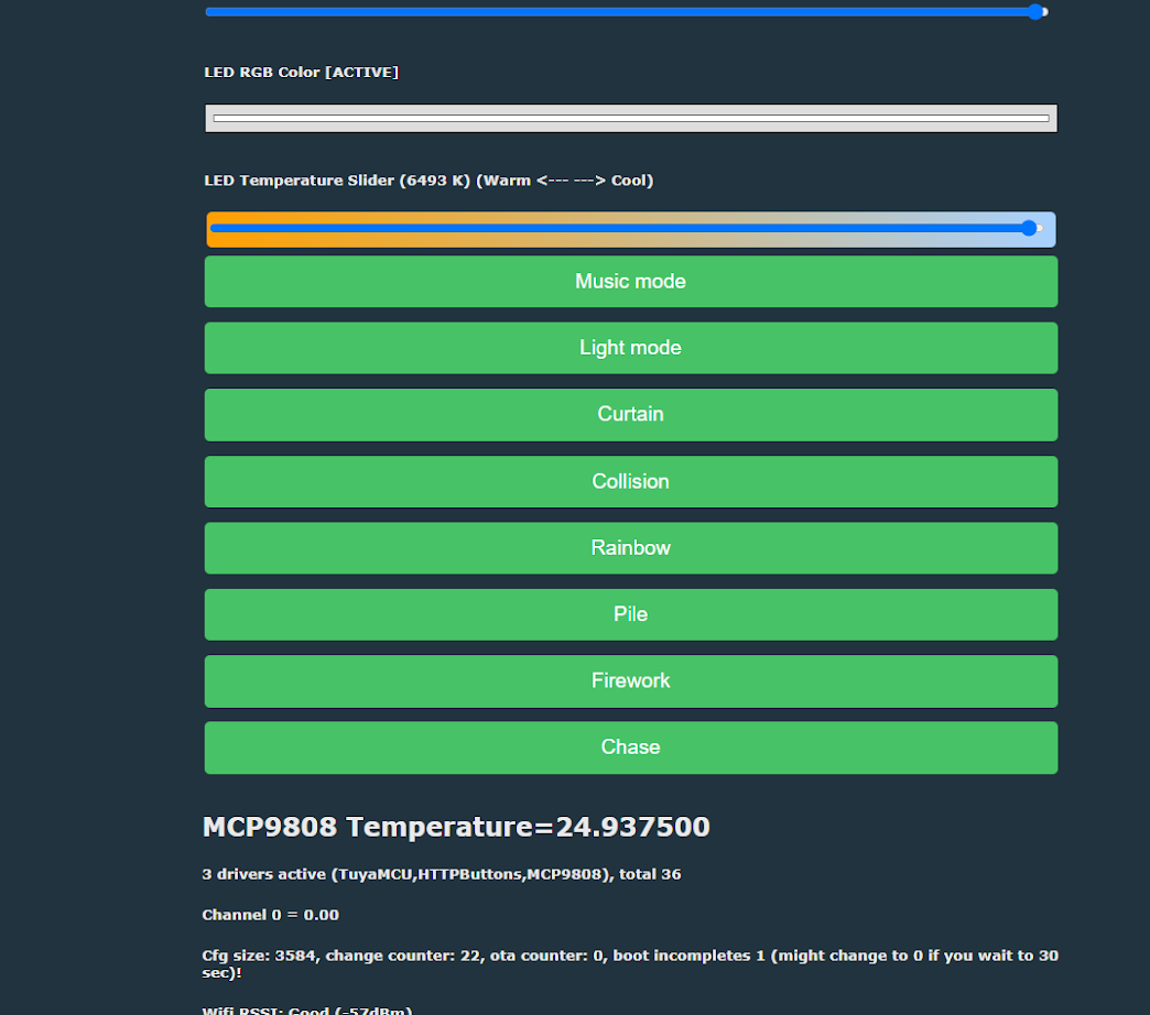

  • OpenBeken now reproduces color and animation effects locally, adds MQTT-driven effect buttons, and exposes a MCP9808 temperature sensor plus physical button controls.
  • Home Assistant integration works through discovery, but animation triggers still need manual YAML/MQTT commands.

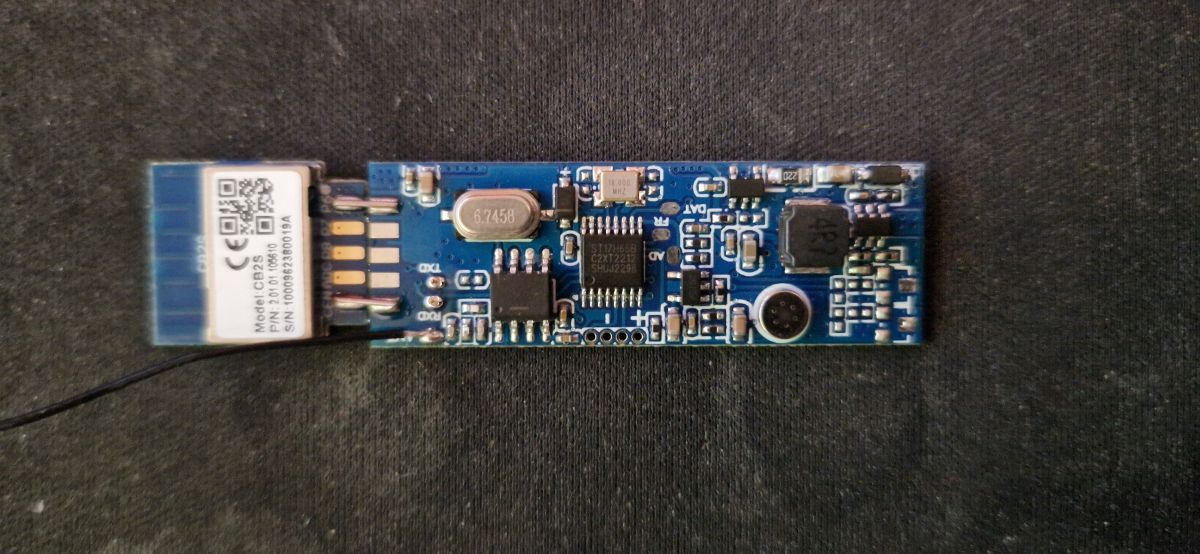

    First impression

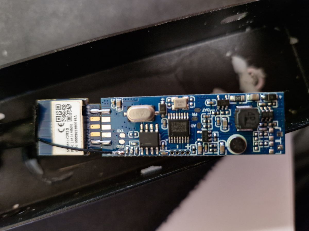

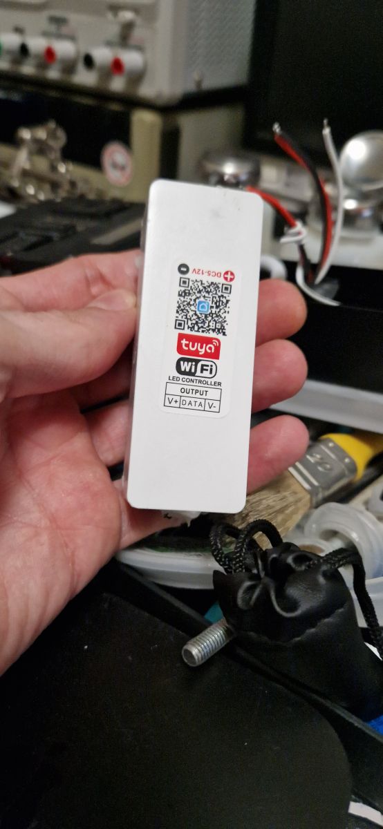

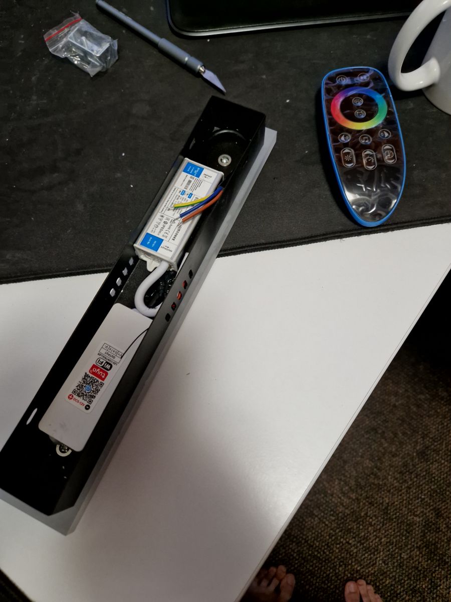

    The device consists of a front with LEDs, a power supply and a controller module:
    Tuya lamp module and remote control on a desk.
    Person holding a Tuya LED controller with WiFi label and QR code.

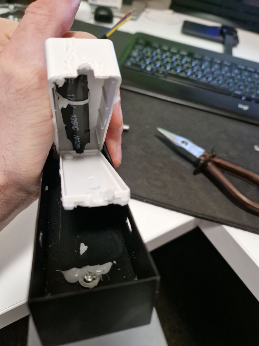

    You need to use a bit of force to get inside:
    Partially opened Tuya lamp casing with visible interior.

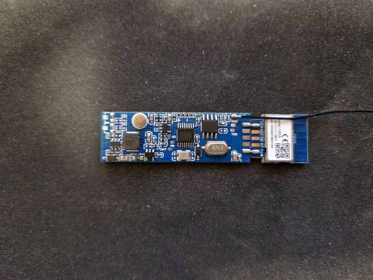

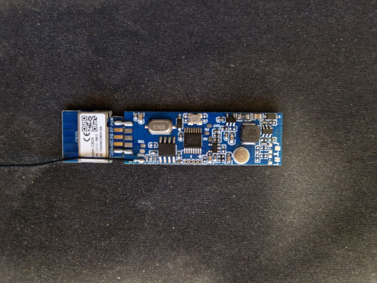

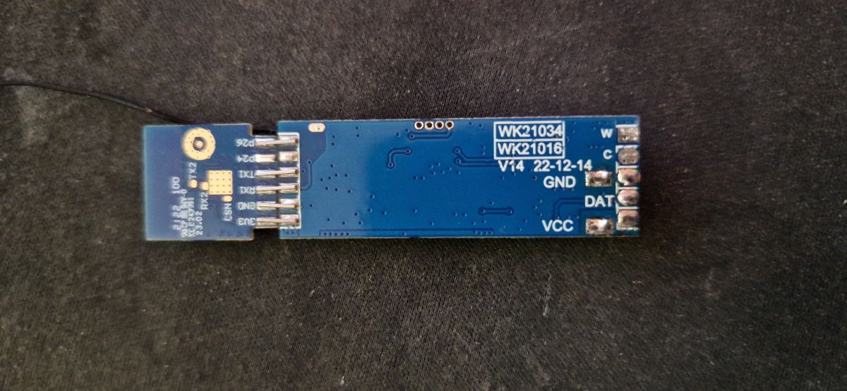

    The main PCB is hidden in the heat shrink sleeve:
    Tuya LED lamp controller board with visible electronic components. Electronic module on a black background with an antenna. Control module with components on a blue PCB, visible identifier and connecting traces. PCB module with electronic components on a black surface. WiFi module PCB WK21034 with pin labels.

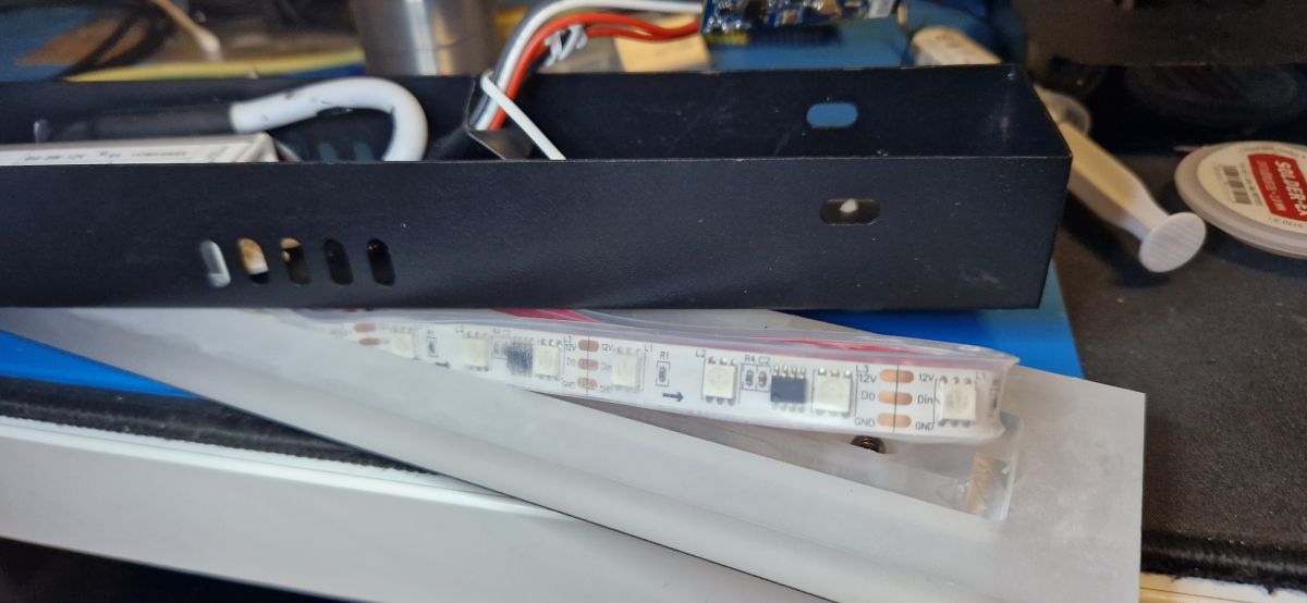

    The LEDs are 12V, not WS2812B, but SM16703:
    The image shows an open black LED lamp casing with visible LED strips and wiring.

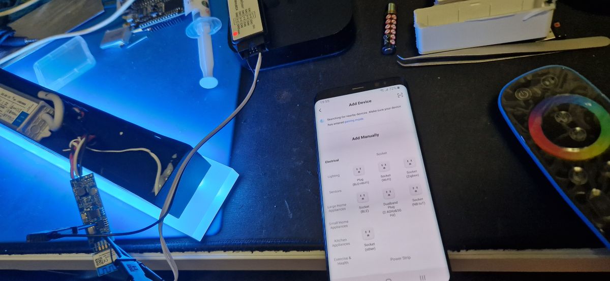

    After connecting, the device flashes in pairing mode:
    You can easily connect to the Tuya application:
    Tuya LED lamp undergoing reverse engineering process.
    NOTE: pairing is started by pressing the MUSIC button on the remote control.
    After connecting the device to Tuya, we captured UART packets and at the same time noted what operation was performed. So, for example, we turn on the capture, turn on the light, and save the results. Then we turn on capture, change the brightness, and save the results. And so with every operation.

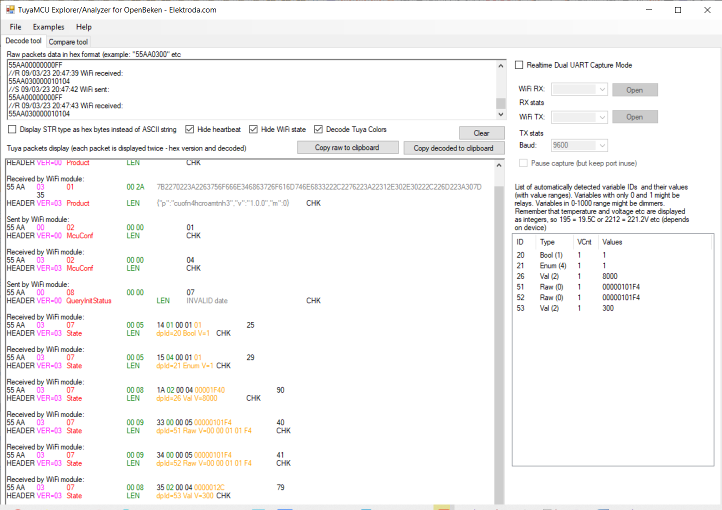

    Here are the collected packages, they can be easily analyzed in the mentioned analyzer:
    https://www.elektroda.pl/rtvforum/topic3970199.html
    https://github.com/openshwprojects/TuyaMCUAnalyzer

    Here we basically get to know the modules for the first time, report the device version, WiFi status, etc. Additionally, the initial values of the variables are also sent, but for now it's hard to guess what they mean, we'll deal with that in a moment:
    TuyaMCU packet analyzer with hex data.

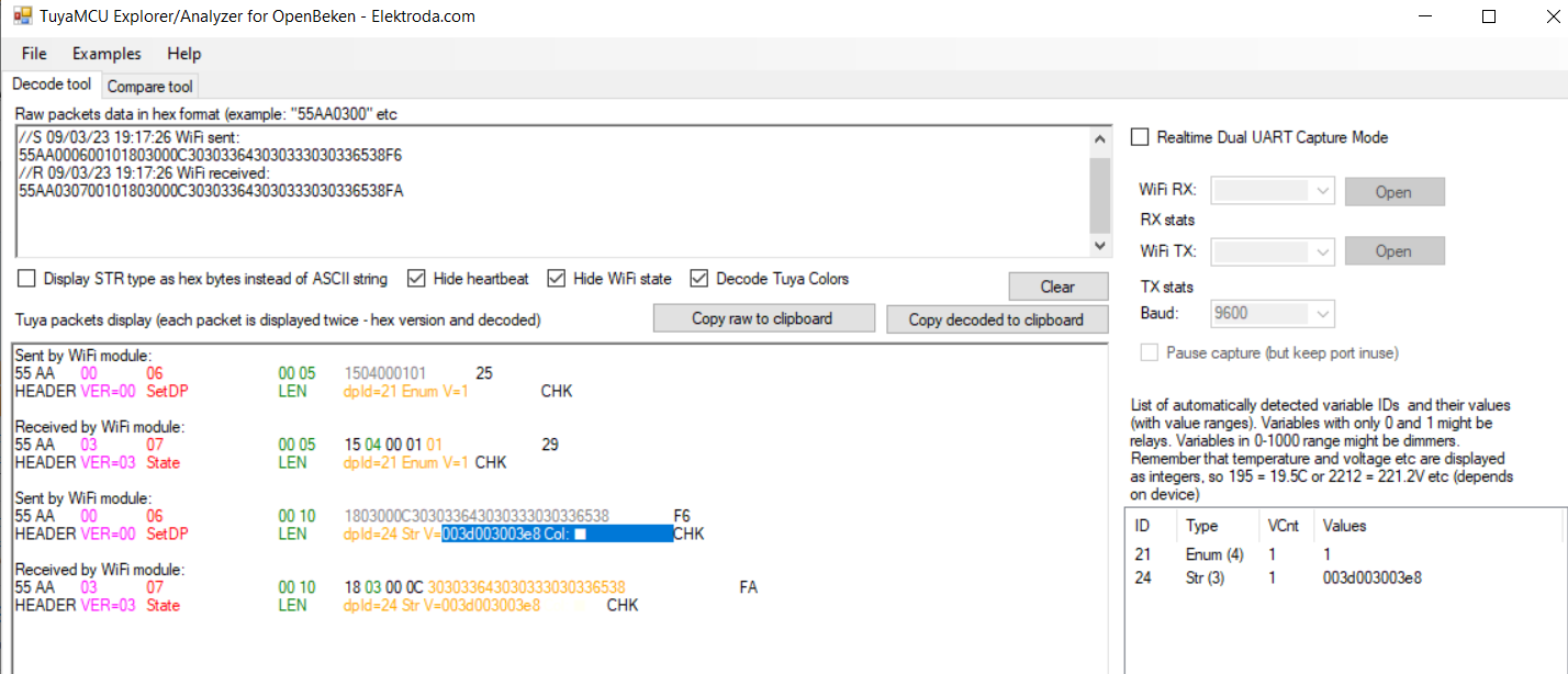

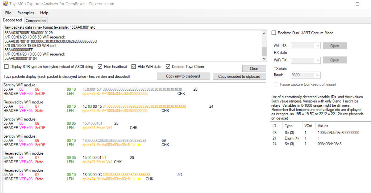

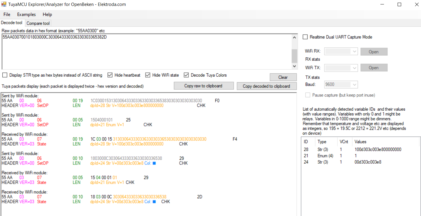

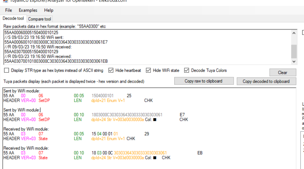

    Blue LED Color:
    //S 09/03/23 19:13:29 WiFi sent:
    55AA000600191C030015313030643330336330303365383030303030303030F0
    55AA00060005150400010125
    //R 09/03/23 19:13:29 WiFi received:
    55AA030700191C030015313030643330336330303365383030303030303030F4
    55AA000600101803000C30306433303363303033653829
    55AA03070005150400010129
    55AA030700101803000C3030643330336330303365382D
    The analyzer already shows that dpID 24 is responsible for the color, although it is a string type. Many Tuya devices have this color coded and also in dpID 24:
    Interface of TuyaMCU Explorer/Analyzer showing decoded data packets.
    Additionally, the analyzer reads the color correctly and shows it in the form of a colored square.

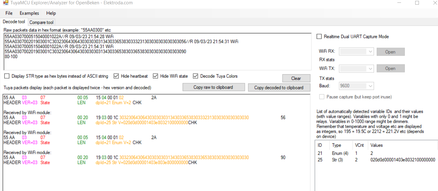

    Changing the brightness of the chase animation:
    //R 09/03/23 21:52:04 WiFi received:55AA0307000515040001022A//R 09/03/23 21:52:04 WiFi received:55AA030700201903001C3032306430643030303031343033653830336538303030303030303090//R 09/03/23 21:52:07 WiFi received:55AA030000010104//R 09/03/23 21:52:08 WiFi received:55AA0307000515040001022A//R 09/03/23 21:52:08 WiFi received:55AA030700201903001C3032306430643030303031343033653830303061303030303030303081
    100-0
    //R 09/03/23 21:52:33 WiFi received:55AA0307000515040001022A//R 09/03/23 21:52:34 WiFi received:55AA030700201903001C3032306430643030303031343033653830303061303030303030303081//R 09/03/23 21:52:37 WiFi received:55AA030000010104//R 09/03/23 21:52:38 WiFi received:55AA0307000515040001022A//R 09/03/23 21:52:39 WiFi received:55AA030700201903001C30323064306430303030313430336538303063633030303030303030B6
    0-20
    //R 09/03/23 21:53:15 WiFi received:55AA0307000515040001022A//R 09/03/23 21:53:15 WiFi received:55AA030700201903001C3032306430643030303031343033653830306333303030303030303086//R 09/03/23 21:53:19 WiFi received:55AA0307000515040001022A//R 09/03/23 21:53:19 WiFi received:55AA030700201903001C303230643064303030303134303365383031386630303030303030308F//R 09/03/23 21:53:22 WiFi received:55AA030000010104
    20-40
    //R 09/03/23 21:53:44 WiFi received:55AA0307000515040001022A//R 09/03/23 21:53:44 WiFi received:55AA030700201903001C303230643064303030303134303365383031386630303030303030308F//R 09/03/23 21:53:49 WiFi received:55AA0307000515040001022A//R 09/03/23 21:53:49 WiFi received:55AA030700201903001C303230643064303030303134303365383032356430303030303030308B//R 09/03/23 21:53:52 WiFi received:55AA030000010104
    40-60
    //R 09/03/23 21:54:06 WiFi received:55AA0307000515040001022A//R 09/03/23 21:54:06 WiFi received:55AA030700201903001C303230643064303030303134303365383032356430303030303030308B//R 09/03/23 21:54:07 WiFi received:55AA030000010104//R 09/03/23 21:54:10 WiFi received:55AA0307000515040001022A//R 09/03/23 21:54:10 WiFi received:55AA030700201903001C3032306430643030303031343033653830333231303030303030303056
    60-80
    //R 09/03/23 21:54:28 WiFi received:55AA0307000515040001022A//R 09/03/23 21:54:28 WiFi received:55AA030700201903001C3032306430643030303031343033653830333231303030303030303056//R 09/03/23 21:54:31 WiFi received:55AA0307000515040001022A//R 09/03/23 21:54:31 WiFi received:55AA030700201903001C3032306430643030303031343033653830336538303030303030303090
    80-100
    Here we see that, surprisingly, there is no separate dpID responsible for brightness, it is coded in color... this dpID 21 here is the operating mode.

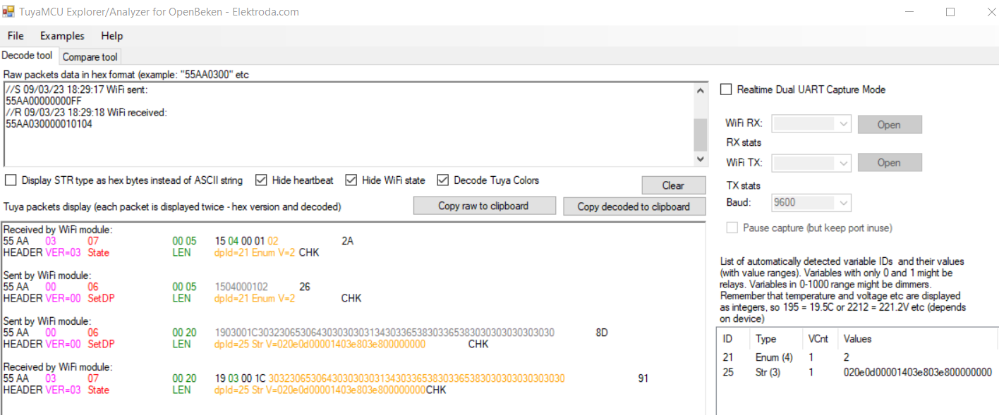

    So dpID 25 is an animation described as a string, its length may vary. We saw earlier that the regular color is dpID 24
    Chase animation:
    //R 09/03/23 18:29:16 WiFi received:
    //S 09/03/23 18:29:16 WiFi sent:
    55AA00060005150400010226
    55AA000600201903001C303230653064303030303134303365383033653830303030303030308D
    55AA030700201903001C3032306530643030303031343033653830336538303030303030303091
    //S 09/03/23 18:29:17 WiFi sent:
    55AA00000000FF
    //R 09/03/23 18:29:18 WiFi received:
    55AA030000010104
    Here again you can see that the operating mode is set (dpID 21) and the animation is sent in dpID 25:
    Screenshot of TuyaMCU Explorer/Analyzer tool with hex format data.

    Green color setting:
    //S 09/03/23 19:13:02 WiFi sent:
    55AA000600191C030015313030366430333932303365383030303030303030CB
    //R 09/03/23 19:13:02 WiFi received:
    55AA030700191C030015313030366430333932303365383030303030303030CF
    55AA000600101803000C30303664303339323033653804
    55AA030700101803000C30303664303339323033653808
    //S 09/03/23 19:13:03 WiFi sent:
    55AA00000000FF
    //R 09/03/23 19:13:03 WiFi received:
    55AA030000010104

    As I wrote earlier, brightness is encoded in color, dpID 21 is the operating mode (1 is pure color):
    Screenshot of TuyaMCU Explorer analyzer
    White color, brightness change from 100 to 0:
    //S 09/03/23 19:16:48 WiFi sent:
    55AA00000000FF
    //R 09/03/23 19:16:48 WiFi received:
    55AA030000010104
    //S 09/03/23 19:16:50 WiFi sent:
    55AA000600101803000C303033643030333030303061E7
    //R 09/03/23 19:16:50 WiFi received:
    55AA030700101803000C303033643030333030303061EB
    TuyaMCU packet analyzer with network data
    White color:
    //S 09/03/23 19:16:15 WiFi sent:
    55AA000600191C030015313030336430303330303365383030303030303030BD
    //R 09/03/23 19:16:15 WiFi received:
    55AA030700191C030015313030336430303330303365383030303030303030C1
    55AA000600101803000C303033643030333030336538F6
    //R 09/03/23 19:16:16 WiFi received:
    55AA030700101803000C303033643030333030336538FA
    //S 09/03/23 19:16:18 WiFi sent:
    55AA00000000FF
    //R 09/03/23 19:16:18 WiFi received:
    55AA030000010104
    Yellow:
    //S 09/03/23 19:05:59 WiFi sent:
    55AA000600191C03001531303033633033626230336538303030303030303020
    //R 09/03/23 19:05:59 WiFi received:
    55AA030700191C03001531303033633033626230336538303030303030303024
    55AA000600101803000C30303363303362623033653859
    55AA030700101803000C3030336330336262303365385D
    //S 09/03/23 19:06:03 WiFi sent:
    55AA00000000FF
    //R 09/03/23 19:06:03 WiFi received:
    55AA030000010104
    Probably no surprises:
    Screenshot of TuyaMCU Explorer tool with packet data.
    Packet analysis results
    After analyzing the collected data, we reached the following conclusions:
    - dpID 24 - color in the Tuya format, as a string, HSV, or more precisely in the 12-character format, where we have the value H, S and V, H in the range from 0 to 360, the rest from 0 to 1000, all as ASCII hex, i.e. generated as follows:
    Code: C / C++
    - dpID 25 - string of different length, somehow encoded animation or its ID (it's hard for us to say at the moment)
    - dpID 21 - operating mode, either clear color or animation, 1 is color, 2 is animation, as far as I know, the value 0 would be CW (white temperature)
    - dpID 20 - on or off, turning on or off the LEDs

    Ultimately, this is what the OBK panel of this device looks like:
    User interface for controlling the Tuya LED smart lamp.
    You can see the temperature reading from the MCP9808 and the scripted animation buttons mentioned above.
    And the physical buttons work as in the video:

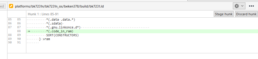

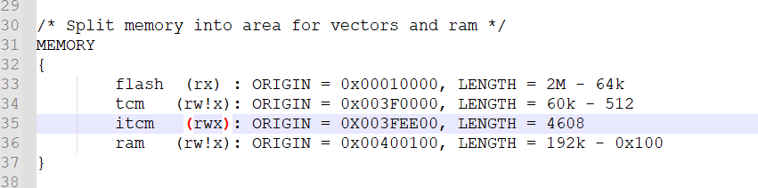

    I previously tried to make a simpler driver, based on plain bit-banging, like this:
    PIC18F45K50 as WS2812 LED strip driver (theory+library)
    but I encountered an interesting problem, namely the timings had unexpected errors, apparently due to some mechanism of reading/caching instructions from flash memory. From what I know, this problem would be solved by placing the pixel sending function in RAM, but only certain sections of RAM allow it and this creates further difficulties...
    Screenshot of project code from the ld file for BK7231.
    Image of a code snippet for configuring memory split into areas for vectors and RAM.
    To sum up, for now you can only use individually addressable LEDs with P16, and as for the rest of the pins, maybe soon....
