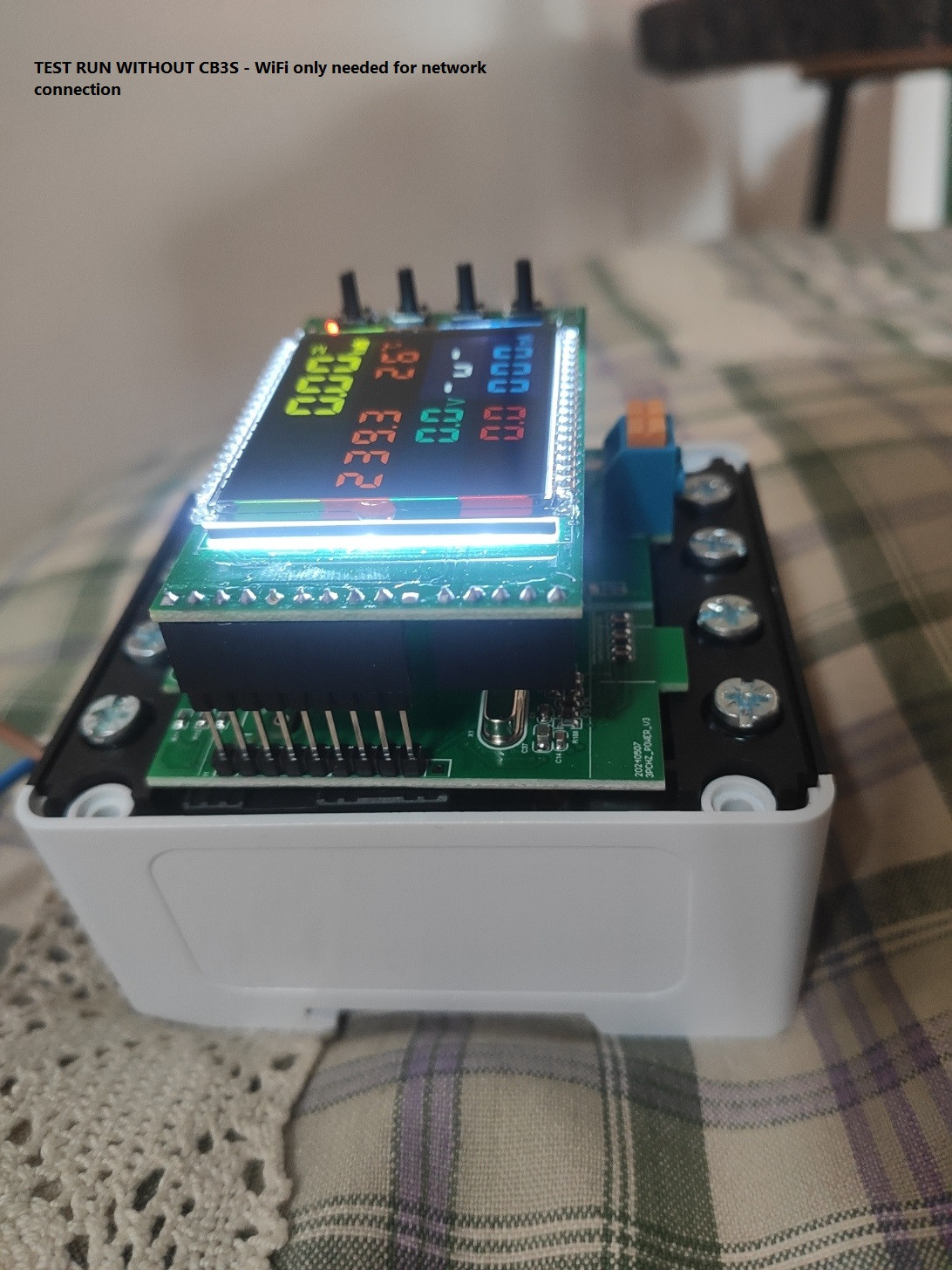

A short report on the disassembly of the EARU EAEMP3C-100-TY-W.
View of an electronic device without the front casing, with an LCD display featuring colorful backlighting. .
Fig. 1. Device without front casing commissioned without CB3S module
The individual modules of the device can be separated without the use of a soldering iron, they are seated on golpins.
The measuring system of the device is the RENERGY RN8302B, to which the measuring coils are connected, the whole is managed by the CMS32L051 chip, which contains an ARM® Cortex®-M0+ 32bit core, and for the display of the parameters there is an LCD display with colour backlighting/film under part of the screen - it looks quite nice.
There are 2 measurement screens to choose from in the device settings. The nominal unit works with TUYA and you configure it through their app. The whole thing is quite easy to configure and works 'out of the box', BUT A LOT OF SETTINGS ARE ONLY AVAILABLE FROM THE APP.
A measuring coil can be connected to the device to measure leakage. The dimensions of the coil are quite large about 76mm outer diameter, resistance about 90 Ohm, inductance about 76H (measurement of inductance uncertain because with some old meter with a weak battery), described as AC2000:1 on aliex.... .
The unit, when powered (it is powered ONLY from phase L1 and N), draws 1W, when WiFi is configured approx 1.3-1.5W with relays on.
The CB3S WiFi module is easily removable, the photo shows the pinout, except that if you want to flash the device you need to connect directly to the module with 3.3V power supply - the power supply from the goldpin is controlled by a transistor.
The device is quite interesting due to the possibility of protection against too high, too low voltage, lack of one of the phases, it also has the possibility of setting the minimum and maximum current and time operation, the time of triggering the protection can be set, also the time of return to work is configurable. The device is described as 3P+N 1-100A - which is probably correct 100/4=25A or 100/3=33A is rather the max what the relays can withstand;) . The unit is capable of bi-directional energy counting, basically it displays the sum of energy consumed and produced, by clicking the arrow buttons we can see the individual components of the sum.
This much could be ascertained before the device was 'broken', when using the BK7231GUIFlashTool-v5 software there was a problem connecting to rip the software, and during one attempt before the soft landed on the disk I managed to press the Write key instead of Read, and this of course went like this the first time. A strange program by the way, when trying to read it pops up several windows making a simple read difficult. It is not possible to read the memory into the buffer first and then write the file, while write simply fires without any question.
As the OpenBK7231N_QIO_1.18.23 software has been installed I don't have much left.... By trial and error I managed to find a few dpid, unfortunately only a part. Currently most of the dpID is captured and described. the recommended firmware is at least OpenBK723131N_1.18.30.
Below is the autoexec that I managed to put together, however it is definitely up for improvement (it would be nice if someone corrected it), the readout of phase parameters measuring power consumption, power factor, and leakage current, temperatures and a few configuration parameters works.
The code provided, however, manages to crash and not give any other measurement except the last/start measurement. The dpid capture with the "tuyaMcu_sendQueryState" command does not work, at least on this version of OpenBK (or I don't know how to handle it).
The wifi settings reset key does not work properly - although the logs show it is supported - the WiFi reset command appears, it would be nice if it reset the wifi to factory settings as it did in the original softy.
After selecting more than 32 dpid the next one can be saved, but to delete it you have to format the whole device.
Currently thanks to the invaluable help of p.kaczmarek2 autoexec is practically finished.
Some of the settings appear in the debug log only after saving the settings on the meter - I wonder if any command can trigger such a report - TAK write dpID18 ? Below is such a message:

I can't see the grid frequency anywhere - the meter gives it after the decimal point, e.g. 49.9Hz... dpID113-115 contained this information.
Dump of the software will not be done for now, there was an attempt to do a Frankenstein with the soft from EAEMP3-100-TY-W (transferred settings and rf region), but the CB3S module did not start then. If anyone has such a meter let's drop a dump please - it will be easier to refine the boot script.
Greetings!
This works: reading voltage,current,power,powerfactor and frequency for all 3 phases. Here note - the frequency measurement is cheated the frequency of the power phase is copied in the MCU to the other phases.
Leakage current reading, energy produced and consumed, device temperature reading, WiFi reset are all operational. The dpID of the alarm settings are known, but they are complex and can only be configured on the command line for now - there are examples in autoexec, error codes are known - they are listed in this topic.
Only the operating schedule is missing - dpID117 is 90% responsible for it.
Below is the view from the interface.
Screenshot of the EAMP3C-100-TY-W device settings interface. .

RN8302B chip on a circuit board with visible monitoring components. .
Fig. 2. Relay board, with measurement circuitry visible ReEnergy RN8302B .
Relay board with visible measurement coils. .
Fig. 3. Top view of the relays themselves, measuring coils on individual phases visible, neutral track not interrupted.
Power supply board with various electronic components. .
Fig. 4. The other side of the relay board showing the power supply based on the circuit with the description "8231H Q24A1006"
Main PCB with CMS32L051, TM1622B, and EEPROM 24C64 chips .
Fig. 5. Board with MCU CMS32L051 , display controller TM1622B , and 24C64 eeprom.
Close-up of a circuit board with various electronic components, including integrated circuits. .
Fig 6. The same board from a different angle visible circuit markings.
LCD display board with control buttons. .
Fig 7. The board with the display also visible buttons for operation.
WiFi module CB3S with BK7231N chip showing pin labels. .
Fig. 8. CB3S WiFi communication module based on BK7231N chip (screen not removed).
Device EARU EAEMP3C-100-TY-W without front cover and measurement coil. .
Figure 9: Relay including current leakage measurement coil.
User manual for the EARU EAEMP3C-100-TY-W device showing the display and setting tables. .
Scan of the device installation and usage instructions .
Figure 10-11: Scan of instructions
A long screenshot showing various views and specifications of the measurement device EARU EAEMP3C-100-TY-W. .
Fig 12. A snapshot of the auction view.
The goodies have arrived thanks!
