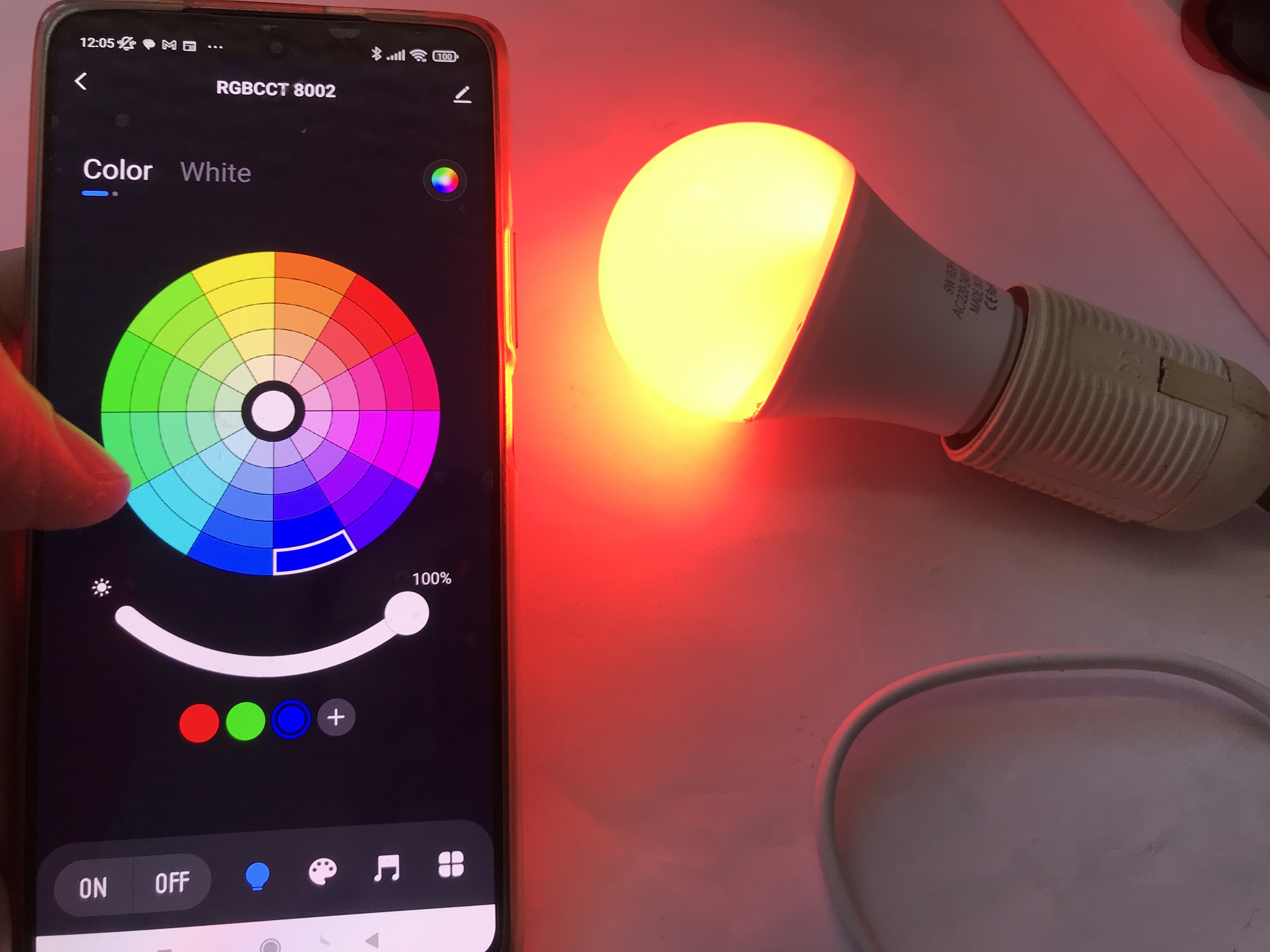

Just to be sure, I turned off Bluetooth:
Bluetooth settings on Xiaomi 11T Pro phone .
Time to test the controls:
Tuya app interface showing connected devices. .
App screen for controlling a color LED lamp. .
Sometimes the light does not respond immediately, but it is fine, it works:
Tuya Bluetooth LED color bulb controlled via mobile app. .
Smartphone with Tuya app controlling a Tuya Bluetooth LED bulb. .
Colorful Tuya LED bulb controlled by a smartphone app. .
Tuya app on phone next to a glowing LED lamp .
Out of curiosity, I de-energised the gate while controlling the lamp:
Smartphone pairing a Bluetooth device with Tuya app next to a LED bulb. .
Close-up of a phone with the Tuya app showing a multimode gateway. .
The light has lost connection, the gateway appears as 'offline' and the phone asks for BT to be switched on.
