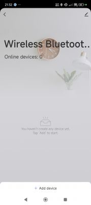

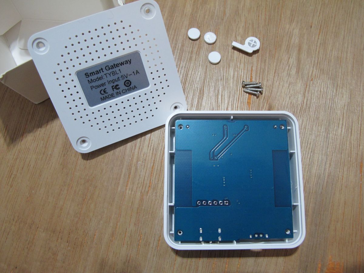

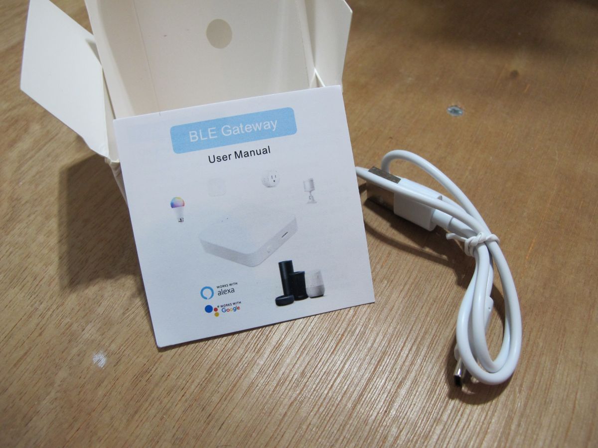

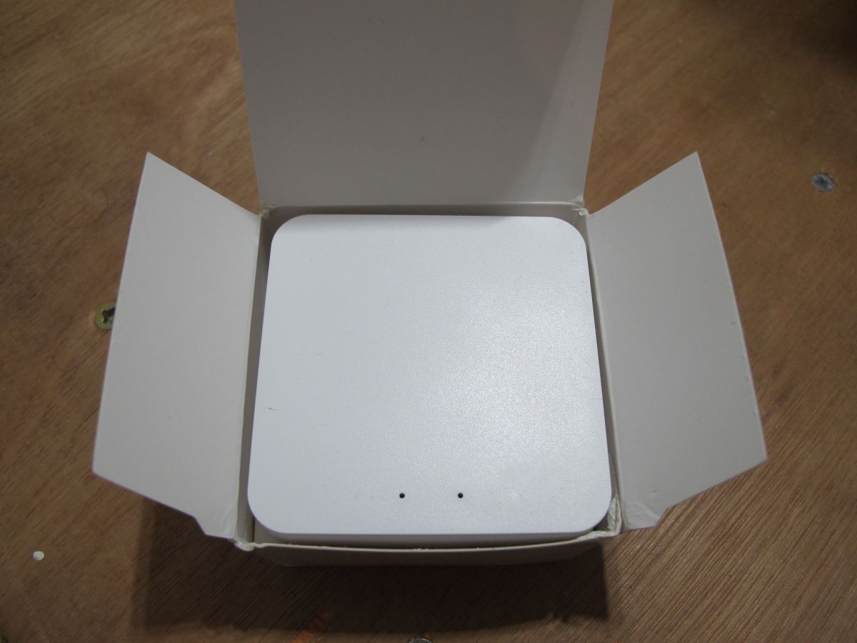

    Tuya TYBL1 Bluetooth Gateway bits:
    White Tuya TYBL1 Bluetooth module in a rectangular shape with two small holes on the front.White Tuya Smart Gateway hub with a promotion on the AliExpress page.
    https://www.aliexpress.us/item/1005005986939367.html

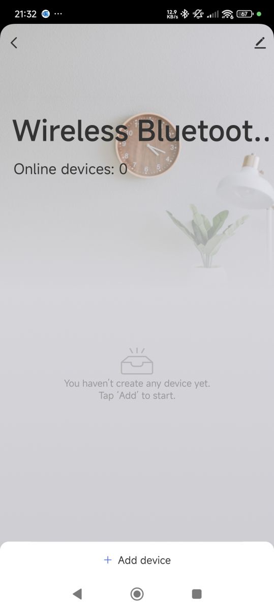

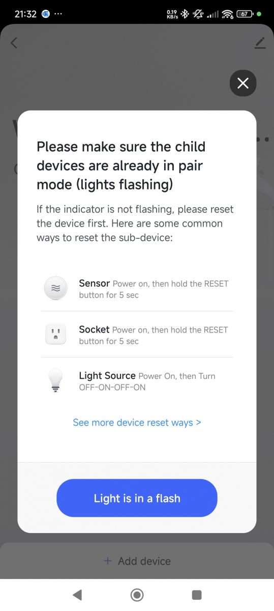

    Smart Gateway packaging with technical information. Box of Tuya Smart Gateway Hub Bluetooth ZigBee product. Label on a box with information about eVAtmasterConsulting GmbH, CE and recycling symbols. Tuya TYBL1 packaging with connection options and power outlets. White square router in an open cardboard box on a wooden table. Tuya BLE Gateway user manual with USB cable on a wooden surface. BLE Gateway user manual with Smart Life app instructions on wooden background. BLE Smart Gateway instruction and FAQ with cable. Opened case of Tuya TYBL1 Smart Gateway showing internal components and screws. Back of a blue circuit board with visible traces and mounting holes. Circuit board with CR3L module on a wooden background
    App interface showing no added devices. Screen showing instructions for pairing child devices, with icons for sensors, sockets, and light sources, and a confirmation button. Device update screen showing no updates available, version V1.17.5.

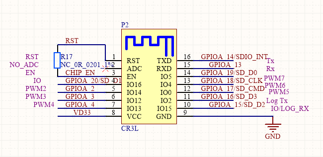

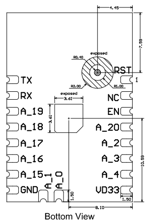

    https://developer.tuya.com/en/docs/iot/cr3l-module-datasheet?id=Ka3gl6ria8f1t
    Block diagram of Tuya CR3L module with pins and connections Bottom view pin layout of CR3L module

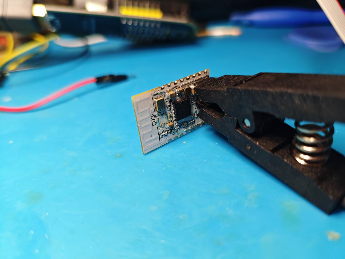

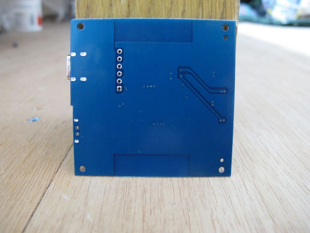

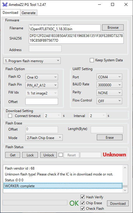

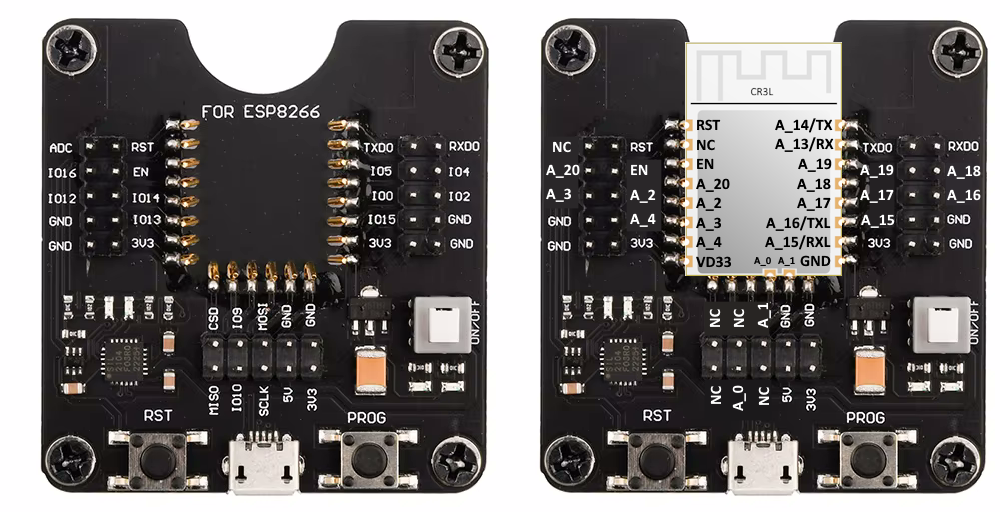

    A_13/RX and A_0 pull high to get into uart DL mode. Within ESP adaptor only A_0 needs pulling high it seems.
    de-soldered CR3L module mapping for my flavour of ESP adaptor
    Tuya TYBL1 adapter with CR3L module and visible pins.
    A_16_UART_TXLOG Tuya boot log:

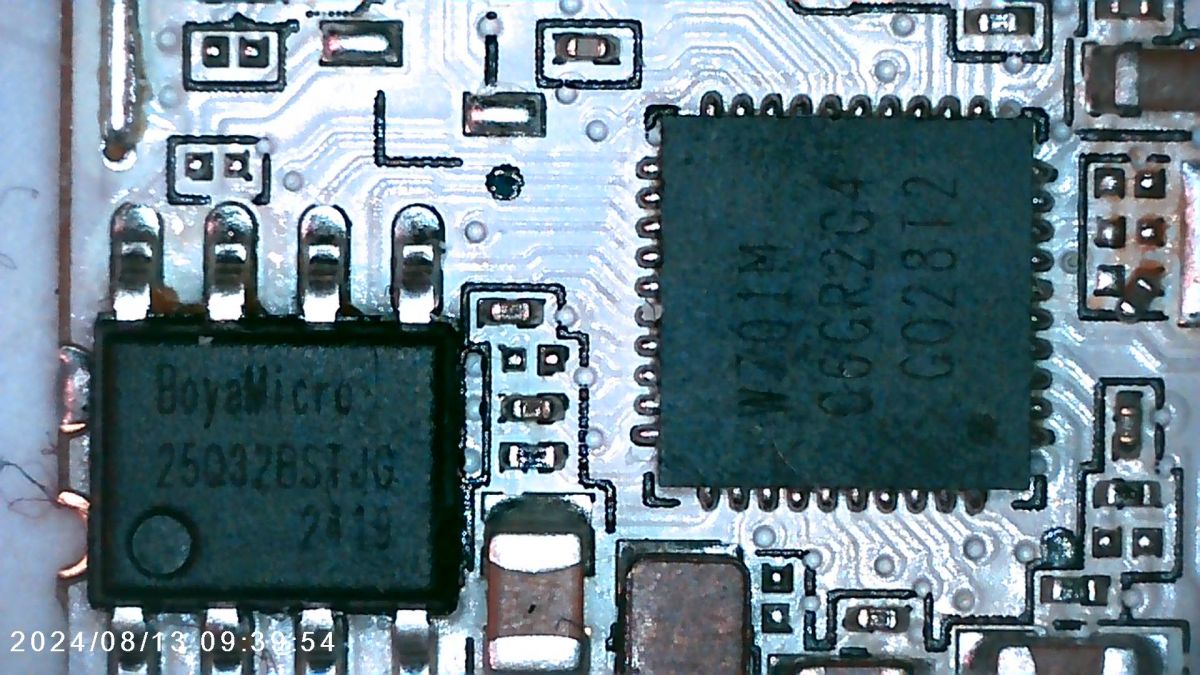

    NeoProgrammer detection and dump log
    CR3L electronic module with components clamped in a vise on a blue background.
    Close-up of a chip on a circuit board with visible markings W701M, 06GR2G4, G028T2. Close-up of a BoyaMicro 25Q32BSTIG chip on a circuit board. Close-up of a circuit board with BoyaMicro and Winbond chips.
    Tuya_TYBL1_key7mn9kc48xep73_xxx.bin dumps at https://github.com/openshwprojects/FlashDumps/tree/main/IoT/RTL8720CM

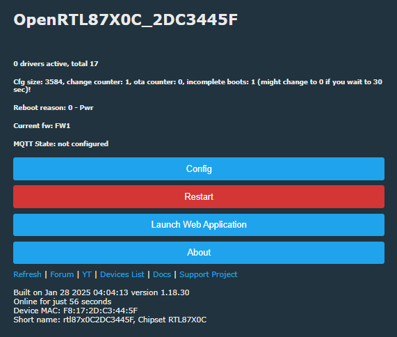

    All 3 dumps boot and pair when flashed back using AmebaZ2 PG Tool
    Added after 9 [hours] 53 [minutes]:
    User interface displaying information about the OpenRTL87X0C device.Screenshot of the AmebaZ2 PG Tool 1.2.47 with flashing settings.

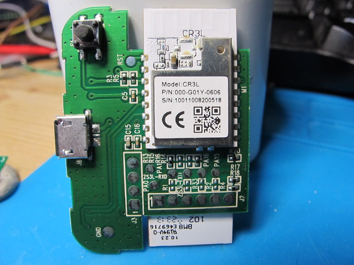

  • Micro-USB Tuya Zigbee hub identified as G01Y_V1.1
    #8 21439281
    Posts: 5220
    Help: 449
    Rate: 918

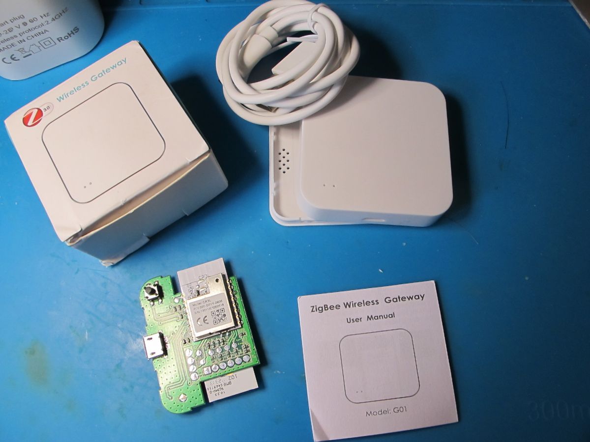

    another type. This one was advertised as Tuya Zigbee Wireless Hub Gateway For Smart Home Automation for Zigbee Devices Via Smart Life
    https://www.aliexpress.com/item/1005006837379685.html
    Advertisement of Tuya Zigbee wireless hub for home automation.
    ZigBee Wireless Gateway with packaging, circuit board, and manual on a blue surface. Close-up of a circuit board with a CR3L module and micro-USB port. Tuya Zigbee Wireless Hub circuit board with ZS3L chip and technical markings.
    Micro-USB.
    G01Y_V1.1 2023-05-27
    FLY-G01
    ShenZhen Forever Young Technology Co.,Ltd

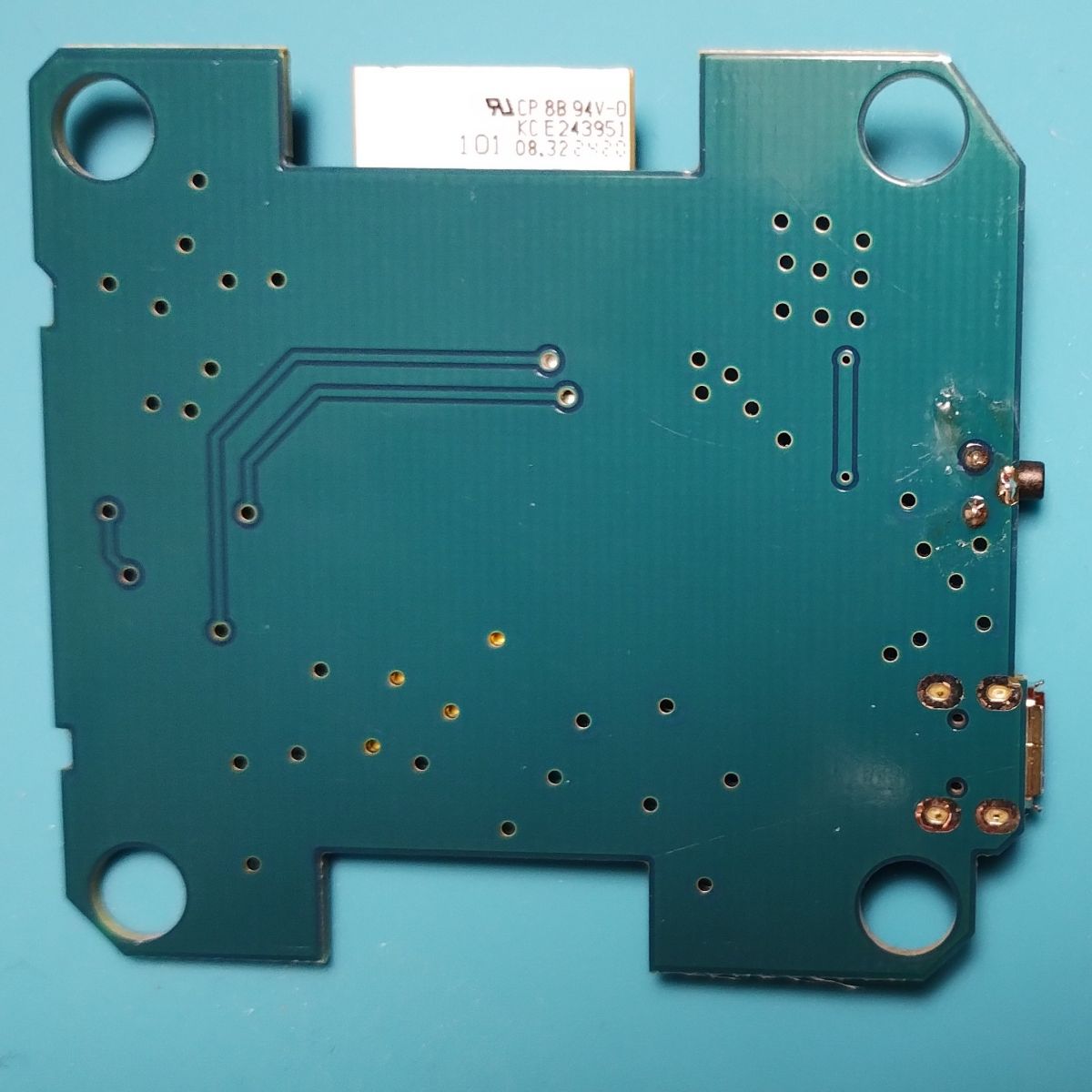

    >>21439281 Curious, a zigbee only gateway with bluetooth-capable module, and the same one as from bluetooth-only gateways at that.
    I too received a CR3L bt gateway today. Board is a little different, but overall they are like copy+paste with a little editing.
    Board is W-BG-CR3L V1.02
    I will later try to convert it to zigbee coordinator with TB-03F module.
    Added after 1 [hours] 11 [minutes]:
    Backup, made with modified ltchiptool.
    A LOT of free heap available with OBK. I thought at least some code modification would be needed to map sram, but it seems to work oob.
    Info:MAIN:Time 1, idle 0/s, free 4297224, MQTT 0(0), bWifi 0, secondsWithNoPing -1, socks 2/21

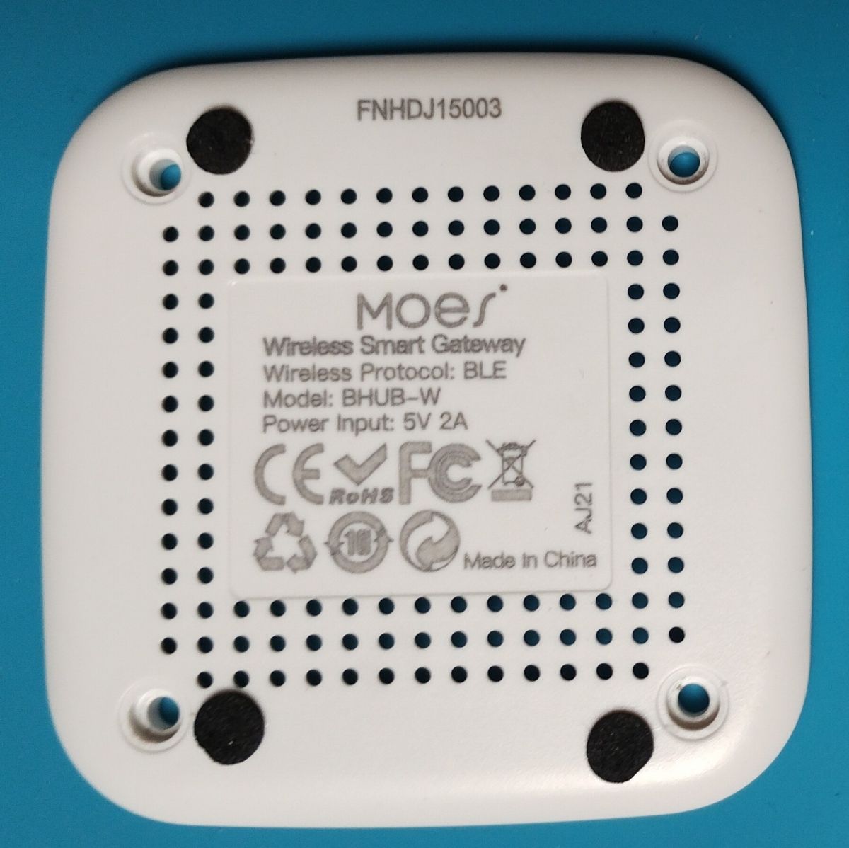

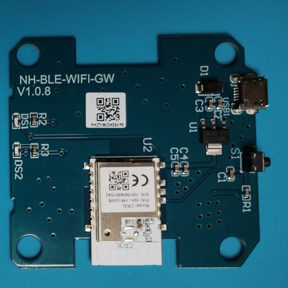

    Here is my device, layout is quite different, board is labelled "NH-BLE-WIFI-GW" "V1.0.8"
    Back of a white Moes Wireless Smart Gateway device with an informational label. Printed circuit board labeled NH-BLE-WIFI-GW V1.0.8 with various components and a USB connector on a blue background. Bottom of a printed circuit board marked NH-BLE-WIFI-GW with visible traces and mounting holes.
    Ali-Link: https://www.aliexpress.com/item/1005005637088709.html
    It took me (too) much time to dump the firmware with ltchiptool - only got I/O errors.
    Finally I switched from one CH340 to another CH340 adapter, and it worked. Very strange.

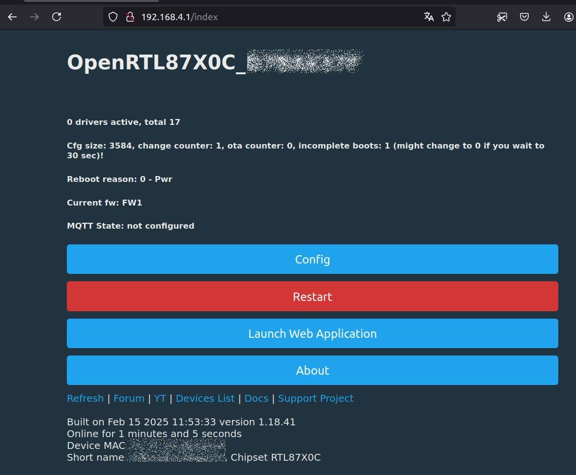

    OBK installed via
    "ltchiptool flash write -f realtek-ambz2 ~/Downloads/OpenRTL87X0C_1.18.41.bin"
    Web interface of OpenRTL87X0C software on a computer screen.

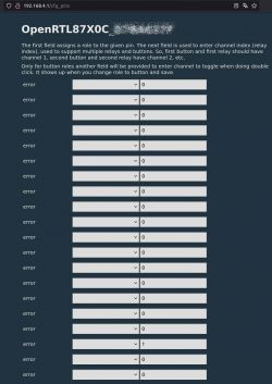

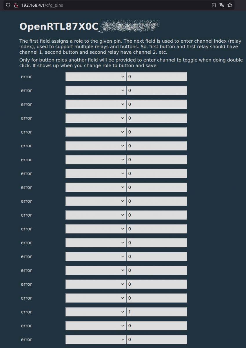

    Should pin cfg work? only getting "error" for all pins:
    Configuration page of OpenRTL87X0C interface with errors at pins.
    ... "error" should only be returned, if index is out of range.
    In "src/hal/realtek/hal_pins_realtek.c":
    const char* HAL_PIN_GetPinNameAlias(int index)
       if(index >= g_numPins)
          return "error";
       return g_pins[index].name;
    How can this happen here with "src/hal/realtek/rtl87x0c/hal_pins_rtl87x0c.c"

    Added after 1 [hours] 38 [minutes]:
    Must be some recent change - after looking at your screenshot I tried 1.18.31 and it works. Will try to find the version breaking it.
    Added after 14 [minutes]:
    It's broken from .32 to .33 will check further

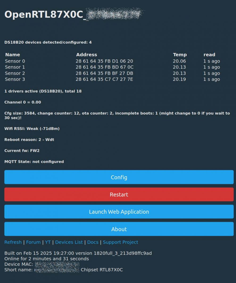

  • #15 21441050
    max4elektroda
    Posts: 758
    Help: 49
    Rate: 189
    Thanks, great!
    I wasn't that fast, but at least I was near ;-)
    Pins can be configured (to be exact, configuring a role worked before even with the missing description) and work again:
    Screenshot of the OpenRTL87XOC interface showing DS18B20 sensor information and configuration options.
    Thanks for your all your work!

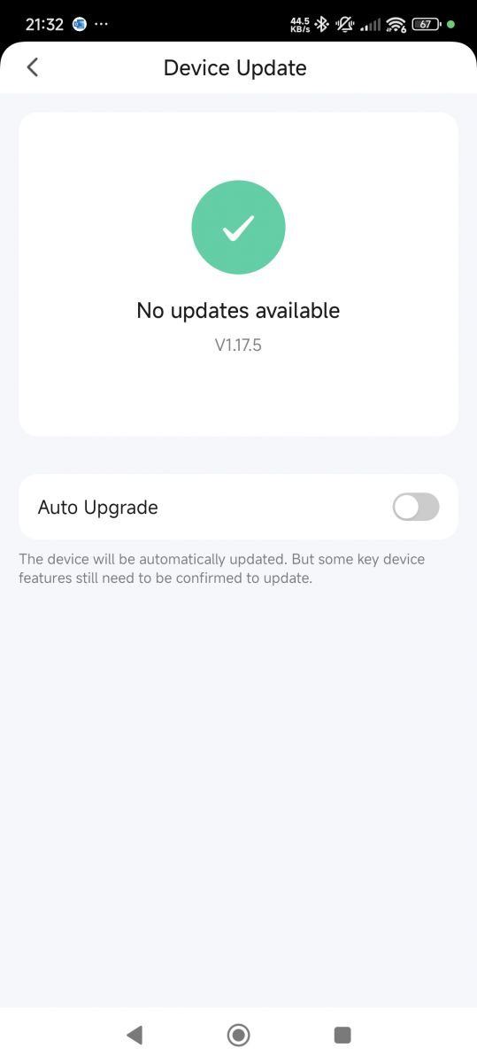

  • Firmware update and boot log for TYBL1 gateway
    #24 21790884
    Posts: 5220
    Help: 449
    Rate: 918
    >>21439662

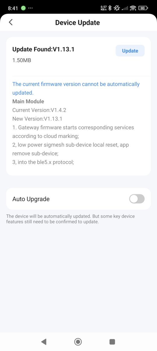

    this dump (v1.4.2) offers update to v1.13.1
    Device update screen showing firmware V1.13.1 with Update button and Auto Upgrade toggle
    https://images.tuyaeu.com/smart/firmware/upgr...689163405-oem_rtl8720cm_gw_plug_UG_1.13.1.bin

The CR3L is the Tuya radio module used in these gateways, and the thread ties it directly to Realtek RTL8720CM / AmebaZ2. "CR3L" is a Tuya Wi‑Fi/BLE module category that hosts the gateway firmware, exposes UART and GPIO pads, and in this thread runs builds tagged rtl8720cm_ameba. The boot log explicitly says gw_module is CR3L and the successful OBK flash used the realtek-ambz2 target. [#21413940]

The thread used a simple hardware-first workflow. 1. Connect a CH341 Black programmer to the flash, detected as BY25Q32 [3.3V] 32 Mbits, 4 Mbytes. 2. Read the full main memory in NeoProgrammer and record the CRC32, which was 0xE63F24B4. 3. Reflash the saved image with AmebaZ2 PG Tool and confirm the unit still boots and pairs. That final restore test is the strongest validation. [#21413940]
Why would ltchiptool give I/O errors with one CH340 adapter but work with another when dumping a CR3L gateway?
Because the UART adapter itself was the failure point in at least one test. One poster said it took too much time to dump with ltchiptool because they got only I/O errors, then switching from one CH340 adapter to another made it work immediately. That points to adapter quality, wiring tolerance, or USB-UART stability rather than a CR3L limitation. If ltchiptool fails repeatedly, swap the adapter before changing firmware settings. [#21440797]
How can I flash OpenBeken (OBK) onto a Tuya CR3L Bluetooth gateway, and what command line was used successfully in the thread?
Flash it over UART as a Realtek AmebaZ2 target. The exact command reported as successful was: ltchiptool flash write -f realtek-ambz2 ~/Downloads/OpenRTL87X0C_1.18.41.bin. "OBK" is open-source device firmware that replaces stock Tuya firmware, adds local control features, and in this thread was tested on RTL87x0C/RTL8720CM gateways. The poster showed it installed on an NH-BLE-WIFI-GW V1.0.8 board after changing CH340 adapters. [#21440797]
What does OBK mean in the context of Tuya gateway hacking, and how much free heap was reported on RTL8720CM after flashing it?
OBK means OpenBeken, the alternative firmware being tested on these Tuya gateways. After flashing it on a CR3L-based RTL8720CM device, one status line reported free 4297224 bytes of heap. That is unusually high headroom for embedded experiments and is why the poster said "A LOT of free heap available with OBK." The same post said the port appeared to work out of the box without extra SRAM mapping changes. [#21439662]
Why does the pin configuration page show only "error" on RTL87x0C builds, and what changed between OBK 1.18.31 and later versions?
It showed "error" because later RTL87x0C builds lost the pin-name mapping file from the build, even though pin roles could still work underneath. The tester verified that 1.18.31 worked, then narrowed the regression to .32 to .33. That means the breakage affected pin labels in the configuration page, not necessarily GPIO functionality itself. This is a classic UI-layer failure case: wrong metadata, working hardware. [#21440852]
How was the missing pin-name issue on Realtek RTL87x0C fixed in OpenBeken, and which source file or pull request addressed it?
It was fixed by restoring the missing Realtek pin file to the build. The thread identified the root cause as hal_pins_realtek.c not included in OpenBeken.mk, and the proposed fix was submitted as pull request #1536. After that, the tester confirmed the pins could be configured and shown correctly again. The issue affected naming and page display, not the underlying GPIO table in hal_pins_rtl87x0c.c. [#21441046]
What is UART DL mode on Tuya/Realtek modules, and how is it different from reading the normal boot log on TXLOG?
UART DL mode is the download/programming mode, while TXLOG is the normal serial debug output. In the thread, A_16_UART_TXLOG carried the Tuya boot log, including lines like == Boot Loader == and build dates. By contrast, entering UART DL mode required pulling boot pins high before power-up so tools could read or write firmware. One mode is passive observation; the other is active flashing access. [#21413940]
