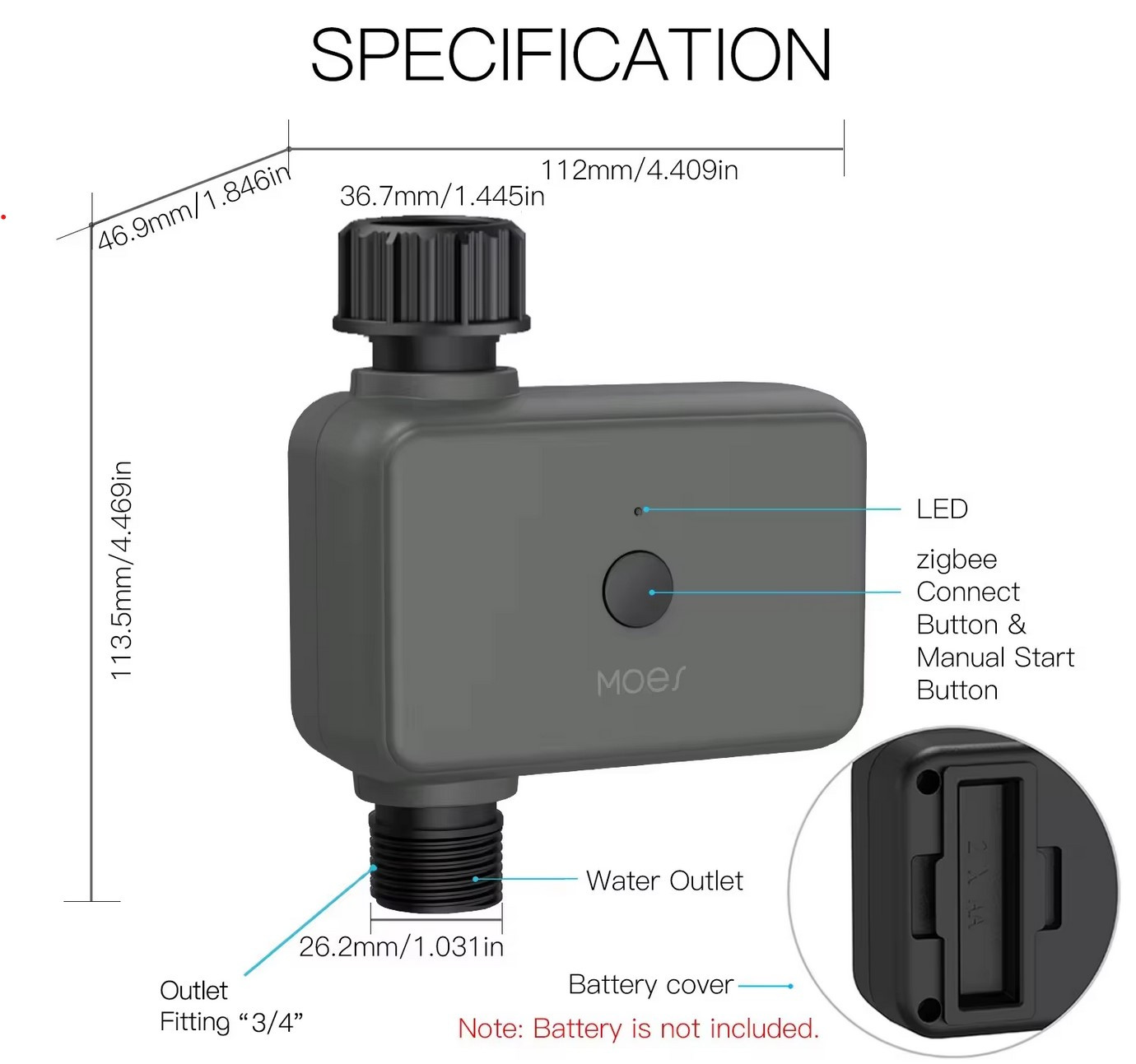

Test review and fix of the "MOES ZigBee Smart Sprinkler Water Timer with 1 Outlet"
Smart water valve by Moes with Zigbee connection options and labeled dimensions.
Technical specifications:
Model: ZWW-YC
Wireless Connection: Zigbee
Working Water Pressure: 2.9-116 Psi
Working Temperature: 40.1°F-113°F (4.5°C-45°C)
Waterproof: IP55
Battery: 2x1.5V AA alkaline batteries
I bought this thing in August 2024 so this is basically a 6 month review.
