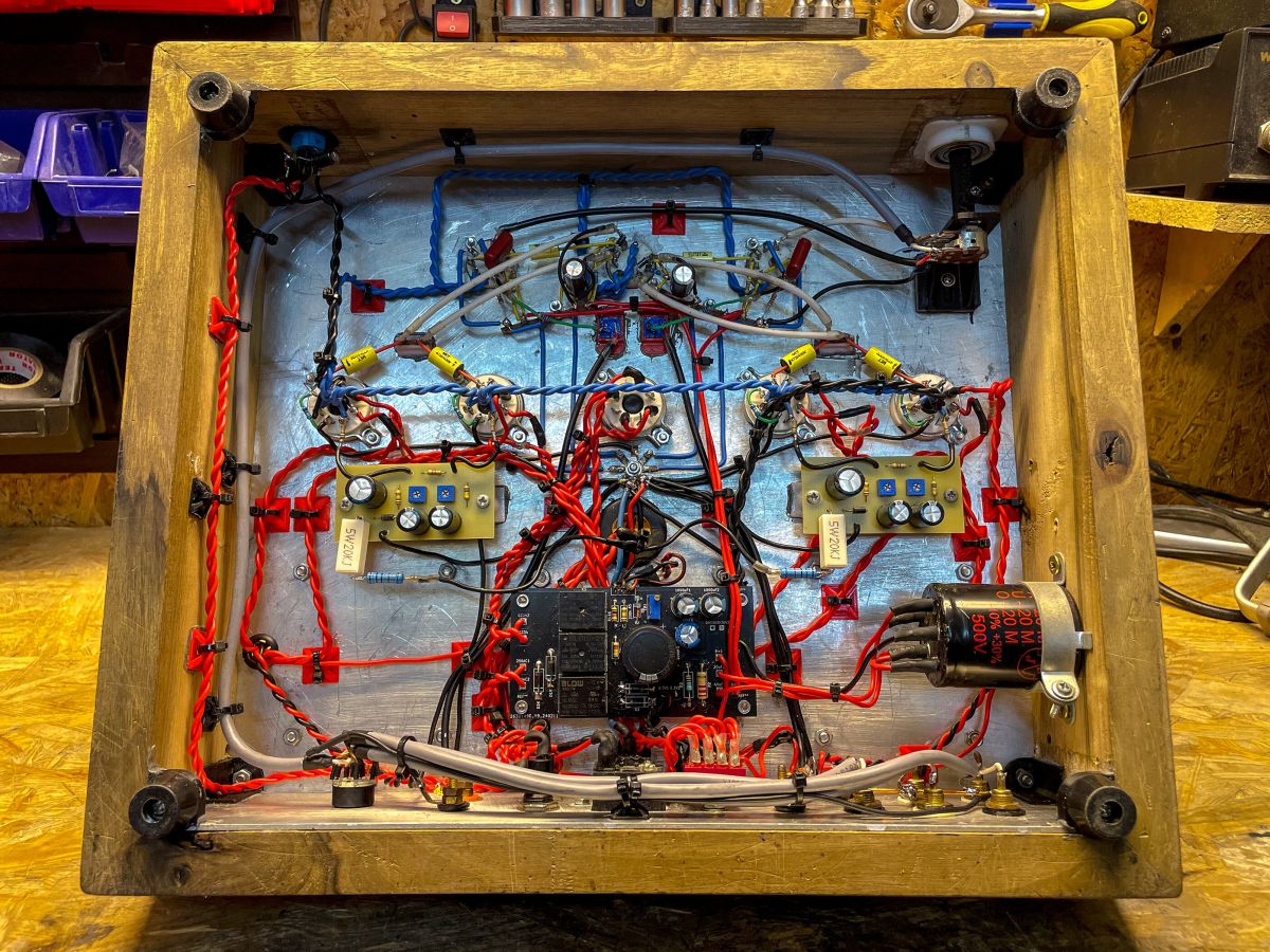

There was also hum and not much power per channel. I dealt with the former by:
- ground in a star topology, very carefully done,
- and using a capacitance multiplier instead of a heavy and expensive choke.
As for the power - the problem was trivial: a badly chosen resistance of the negative feedback loop. After correction - the power was back in place.

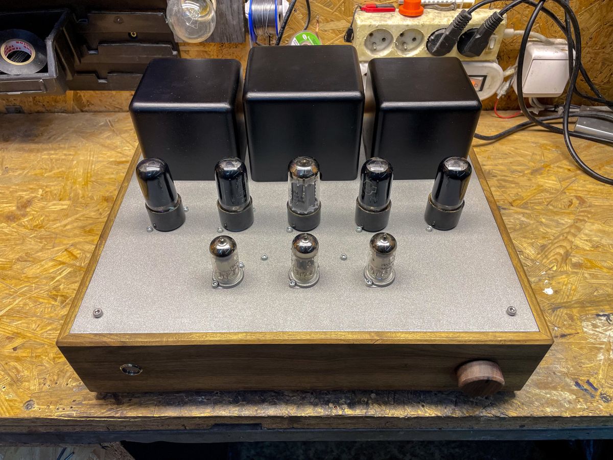

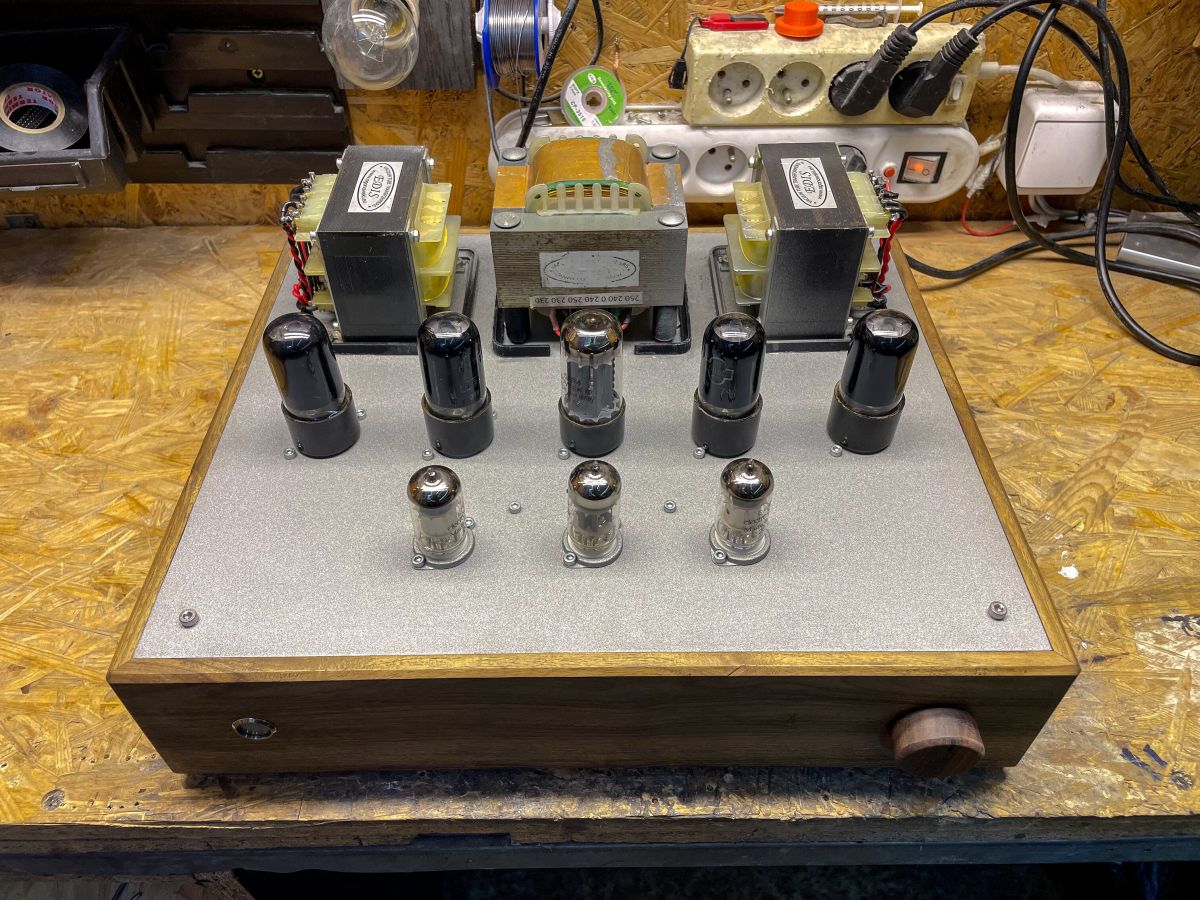

I also used quite a few parts from the 3D printer - the largest being the transformer covers.
I've tried to keep the interior aesthetically pleasing in a spatial style - I'm a big fan of spatial assembly and I think it looks and works great.

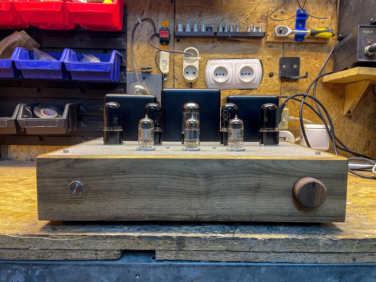

- Looks? In my opinion - excellent.
- Sound? Even better.
In my opinion, the pentode mode beats the UL by a whisker - it gives more power and a characteristic "tube hoarseness". The sound is further 'compressed' by voltage drops on the GZ34, which adds to the atmosphere, but only when listening in 'full tube' mode.

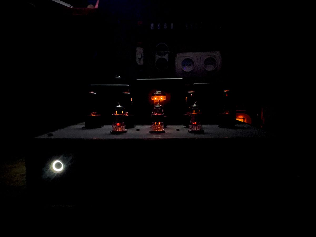

Dark photograph of a tube amplifier with glowing tubes visible. .
Tube amplifier with visible tubes and transformers on a workbench. .
Tube amplifier with various tubes and transformers on a wooden and metal enclosure. .

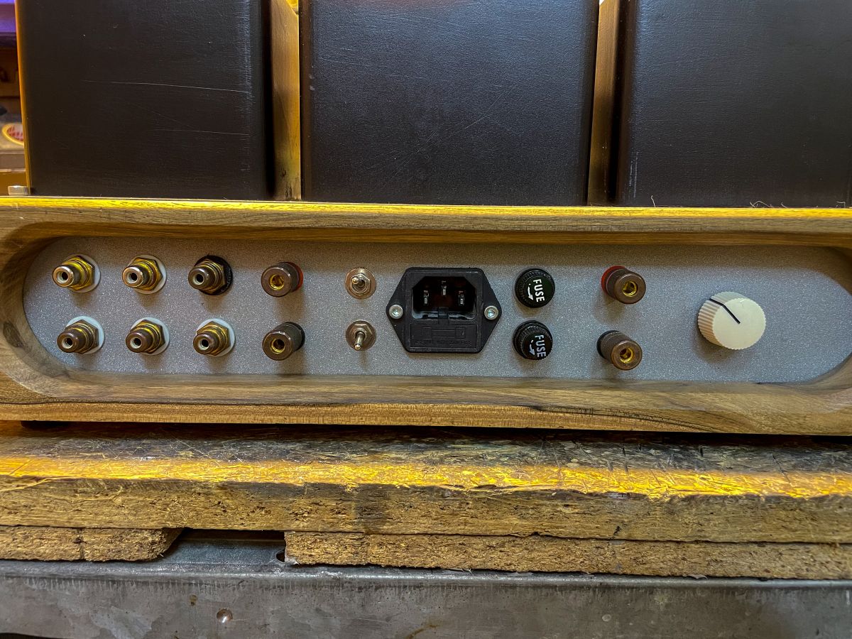

Rear panel of an amplifier with various connectors and a power socket. .
Interior of a tube amplifier in a wooden case with red and blue wires. .

yes it is, these are transformers from Mr Ogonowski [Read more]

Why the input selector on the back? Could you throw in a diagram of this amp as I can see quite a few differences from the original. [Read more]
Pltin74 13 Apr 2025 11:09
this is entirely my design, in the sense that it was originally going to be Ampex but however I redesigned it my way :p [Read more]

Strange this resting current control. The potentiometer sliders are connected in parallel. No matter how you spin them, the voltage on the first grids of both tubes - more or less - will still be the same.... [Read more]
kris8888 14 Apr 2025 09:58
In my opinion, the diagram probably contains errors. I don't know what the component values are, but according to this diagram, the V2A lamp of the phase inverter should not work at all. I also don't... [Read more]
Pltin74 14 Apr 2025 13:06
fact, I had forgotten about this capacitor, but it seems to me that the cause of the 50hz is different purely visual, I wanted the front to be minimalist ;) . Added after 6 [minutes]:3298872ee... [Read more]
