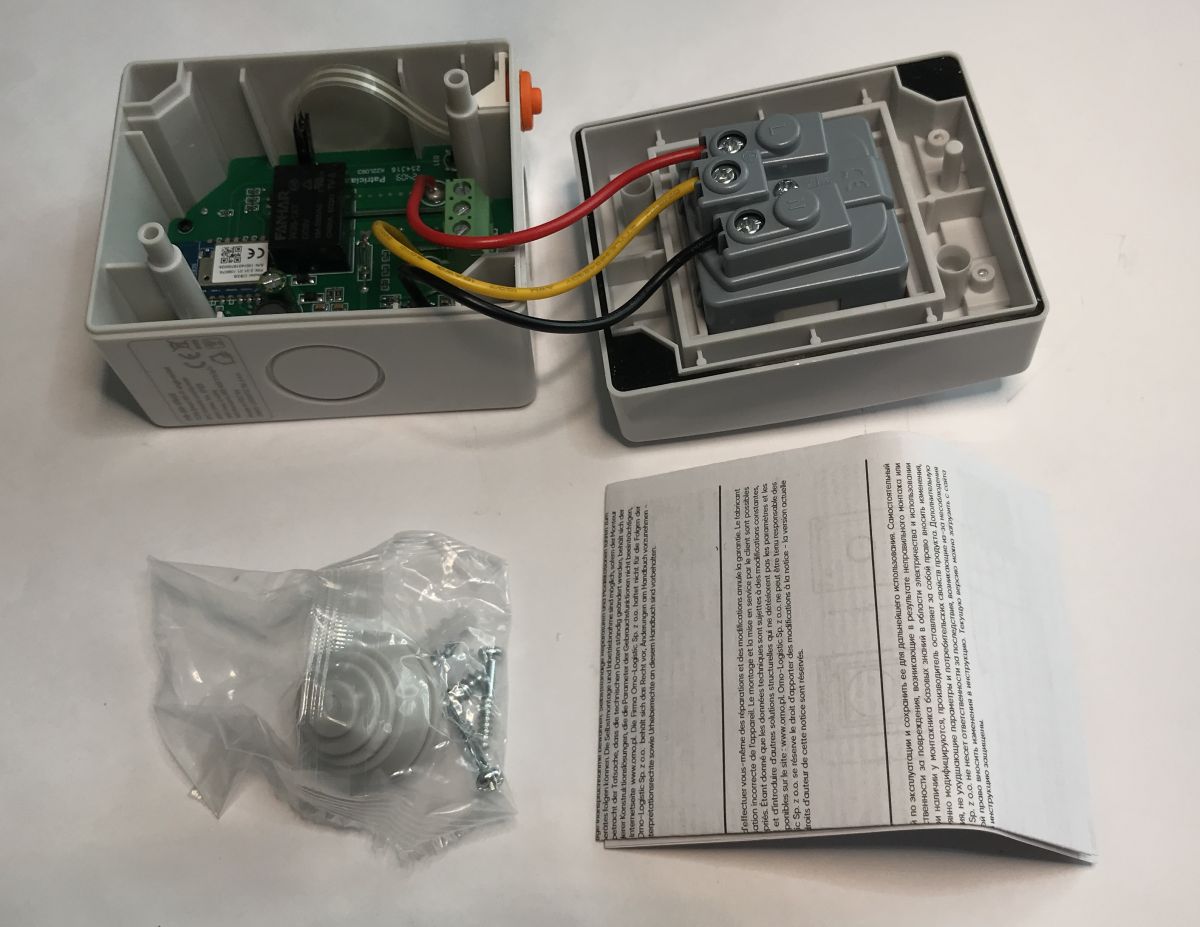

Here is a short presentation of the interior and the procedure for changing the firmware of an external WiFi-controlled socket, model OR-SH-17405. The product shown here additionally offers voltage, current and power measurement and normally works with Tuya, but after uploading the new software it will be possible to run it 100% locally and connect it to Home Assistant. The whole thing can be bought for around PLN80, although you could probably get it cheaper imported from overseas.

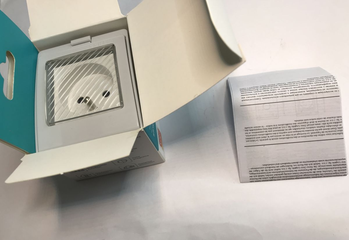

We get a box like this. The markings alone (WiFi + BT and Tuya) suggest the presence of the BK7231.
Multilingual manual:
Multilingual manual.
Screws and insulating collar included:
There is a seal between the two parts of the housing to protect against humidity.

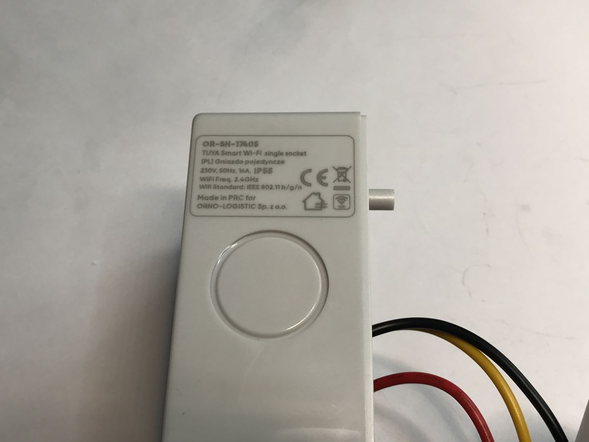

Markings, as in the title - OR-SH-17405:

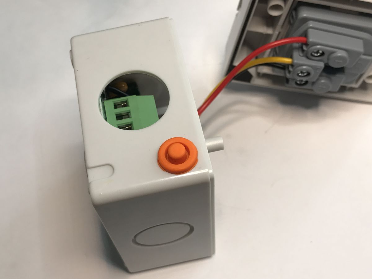

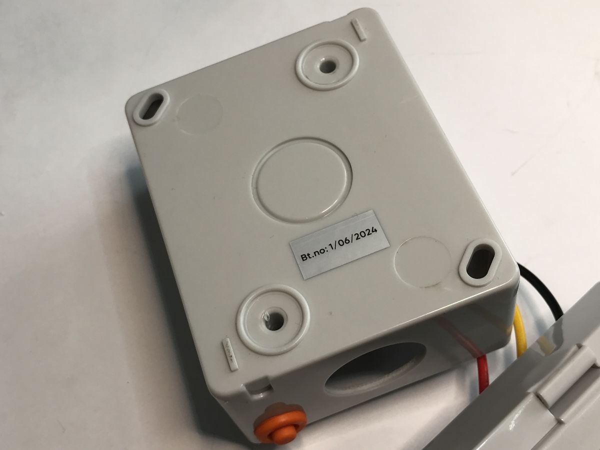

On the casing of the product there is a button with which the relay can also be switched in an emergency, even without access to WiFi.

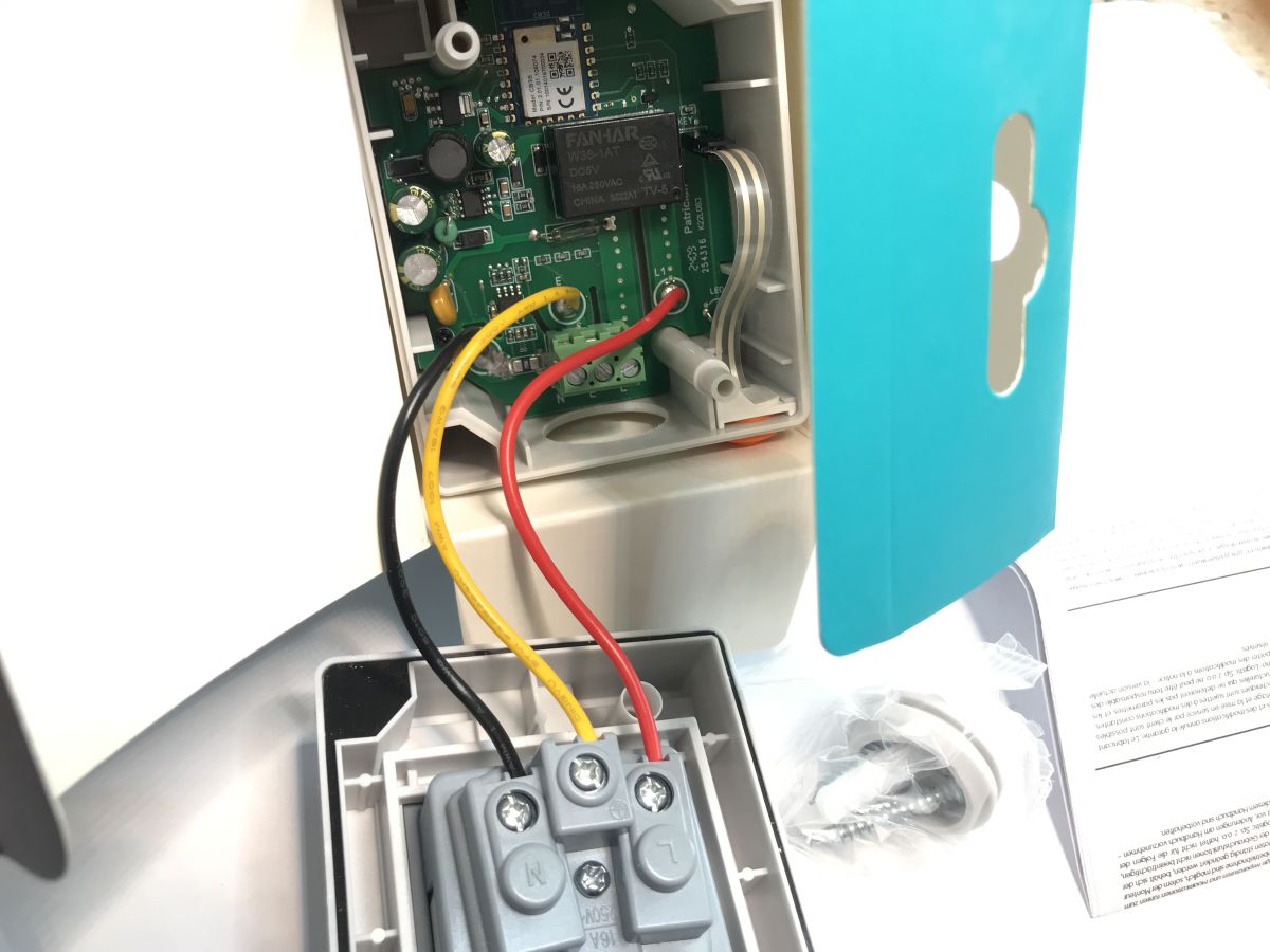

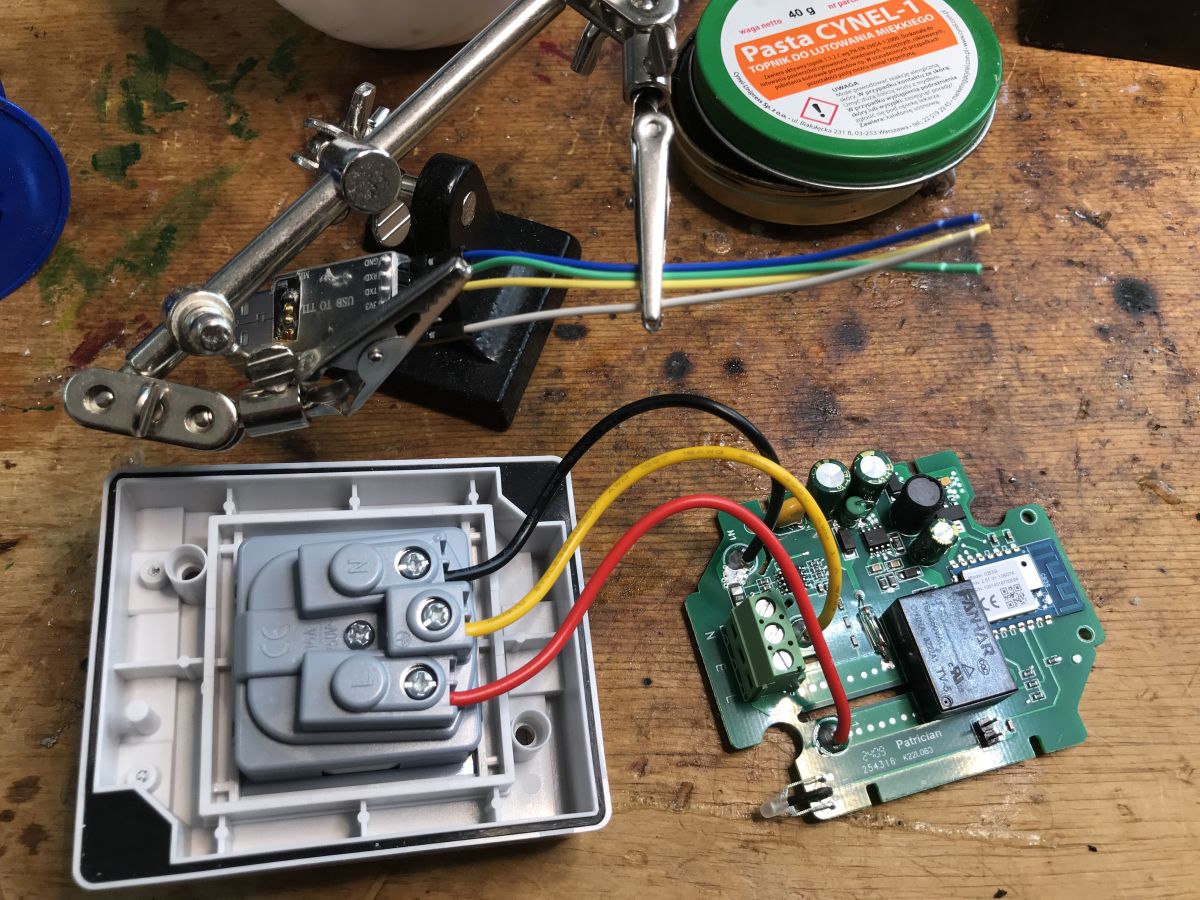

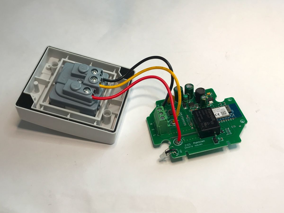

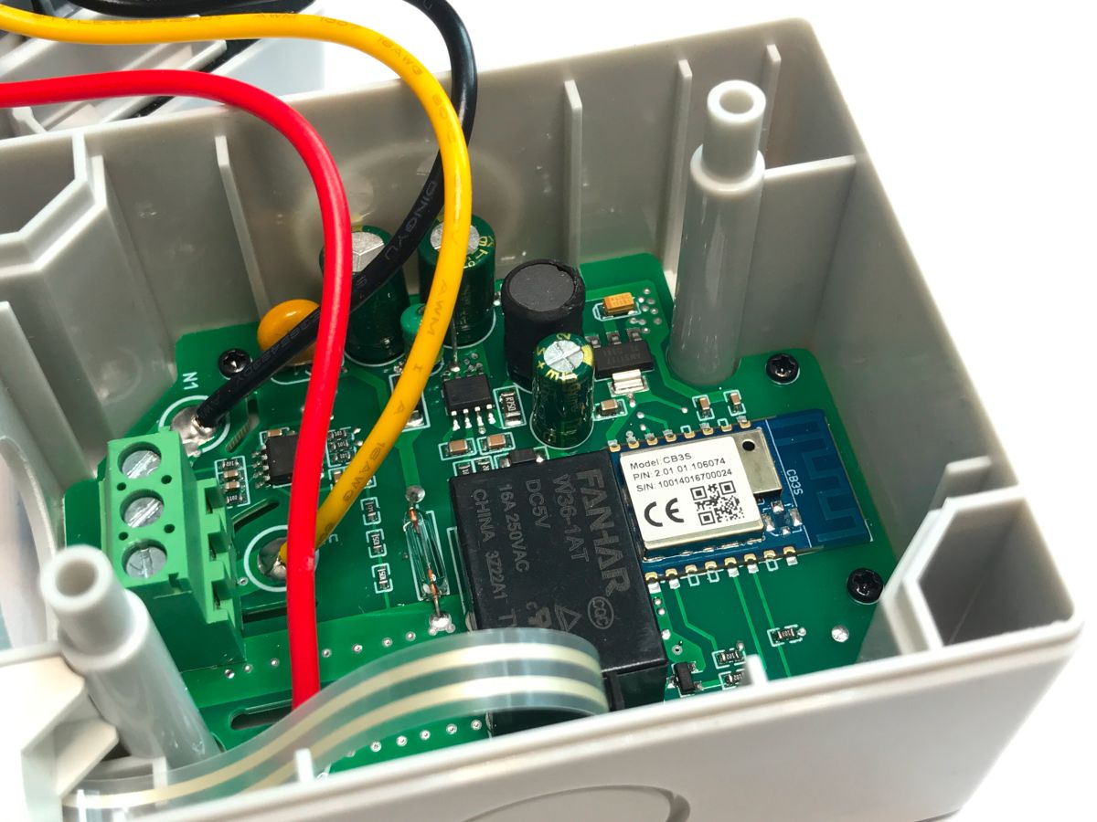

Let's take a look inside.

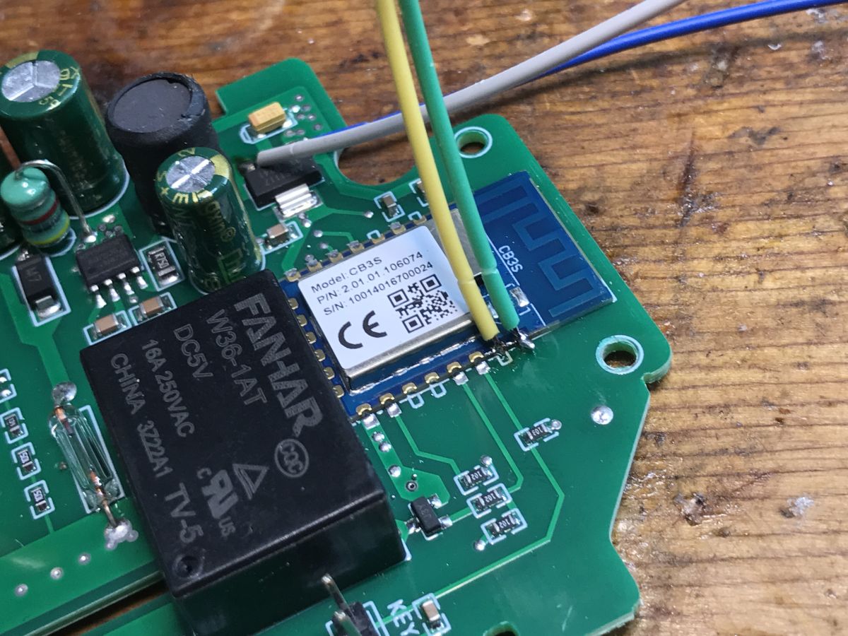

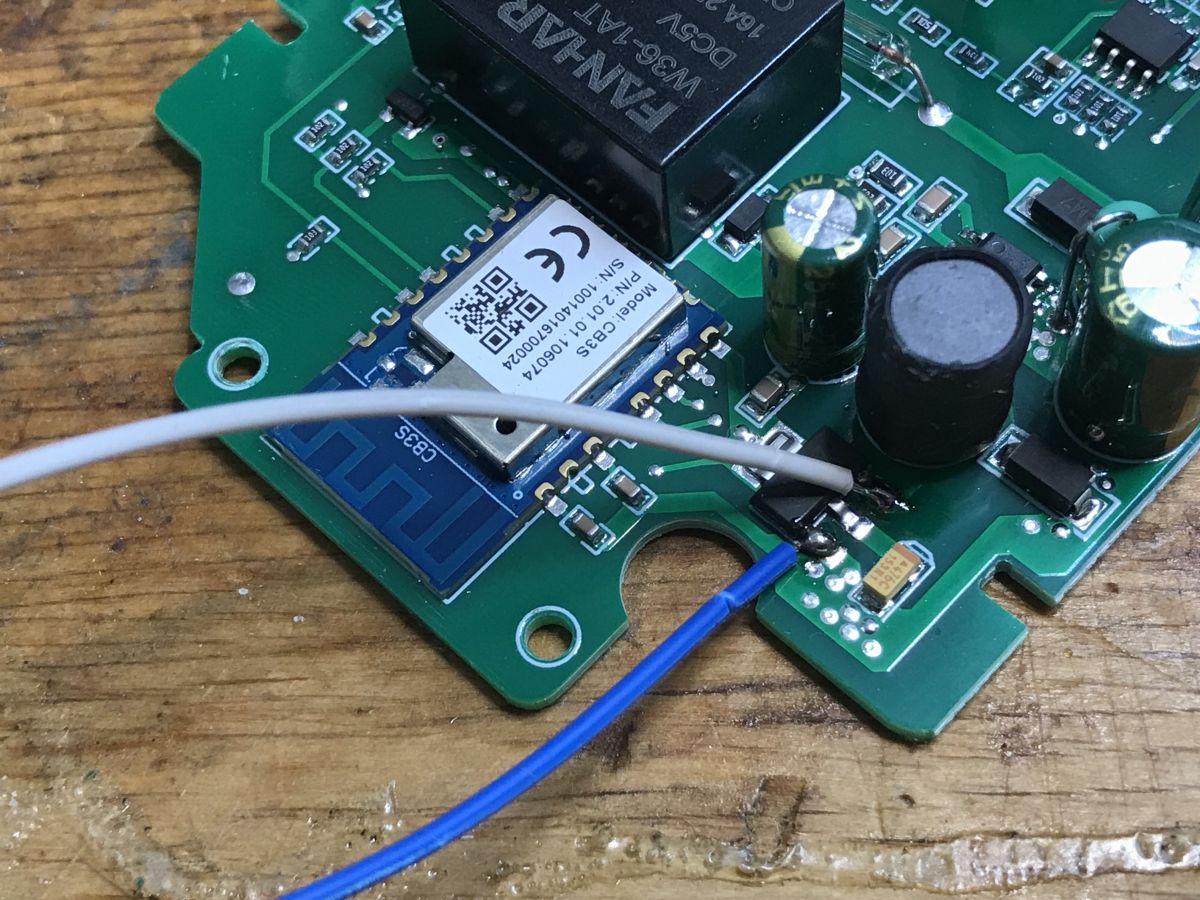

You can already see at this stage that the whole thing is based on the WiFi+BT CB3S module (BK7231N). I will soon show how to upload new software to it.

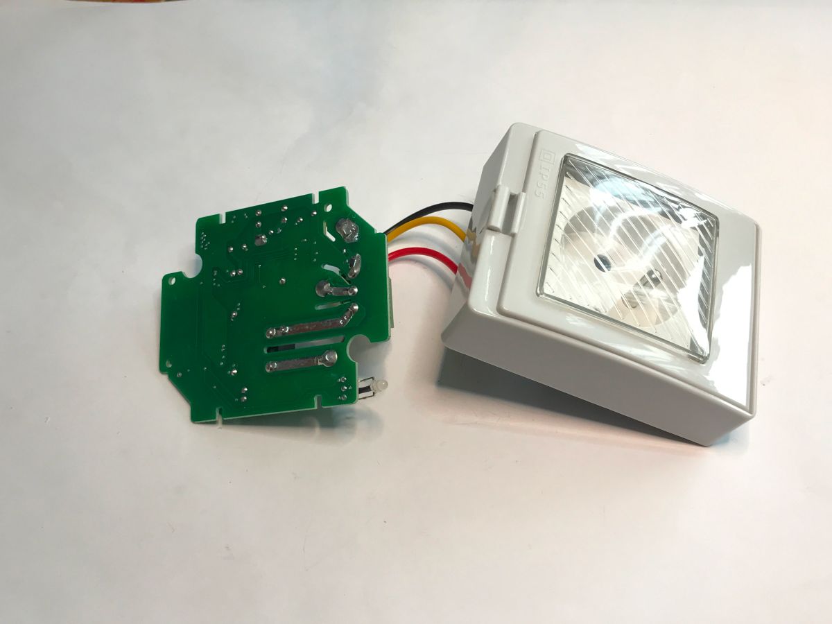

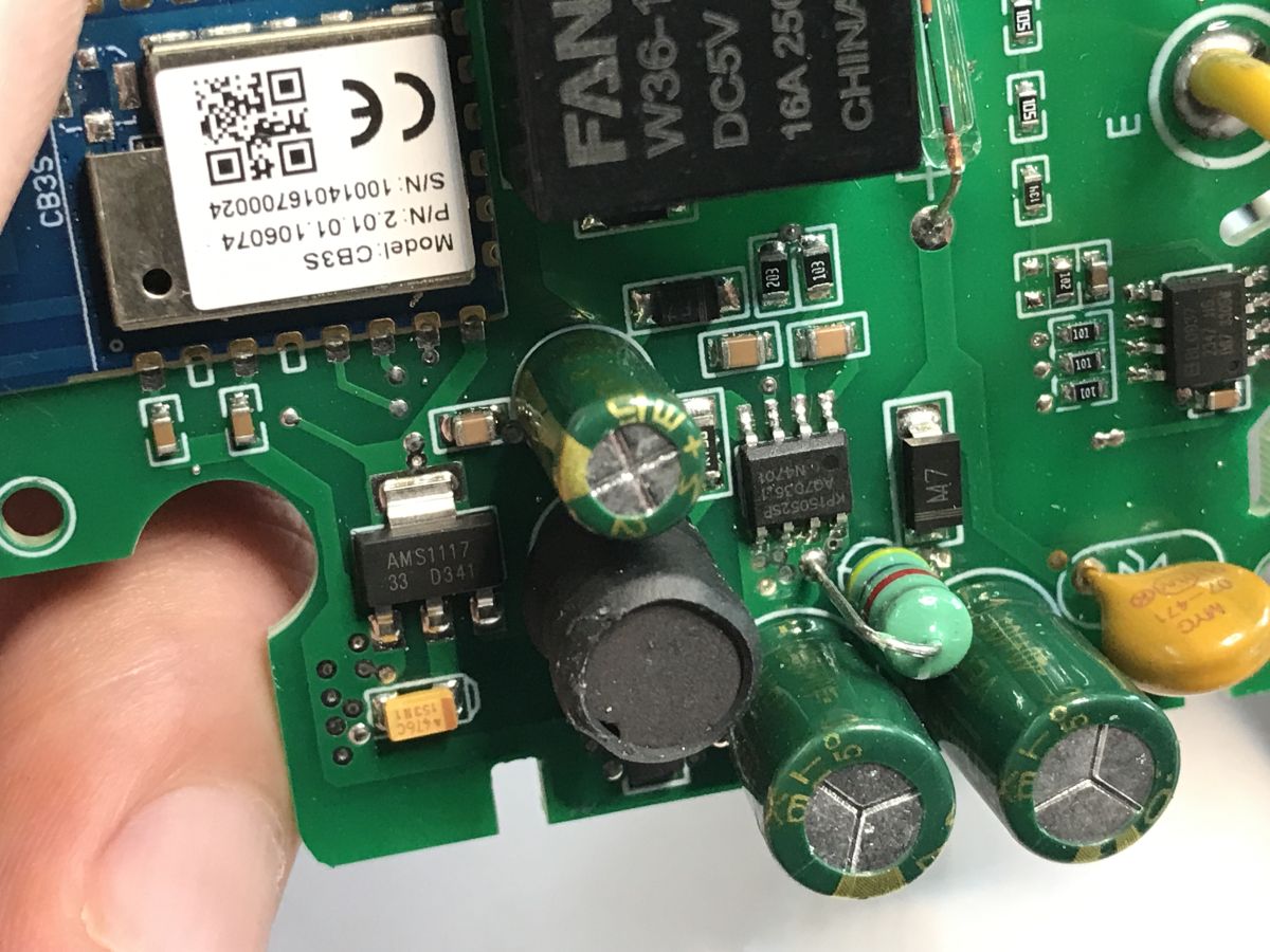

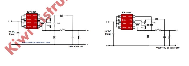

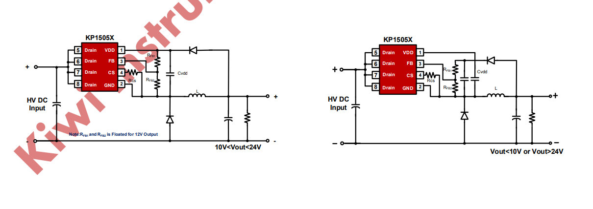

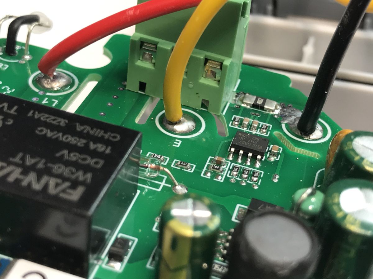

The power section has a non-isolated KP15052SP inverter and a 3.3V LDO powering the WiFi module:

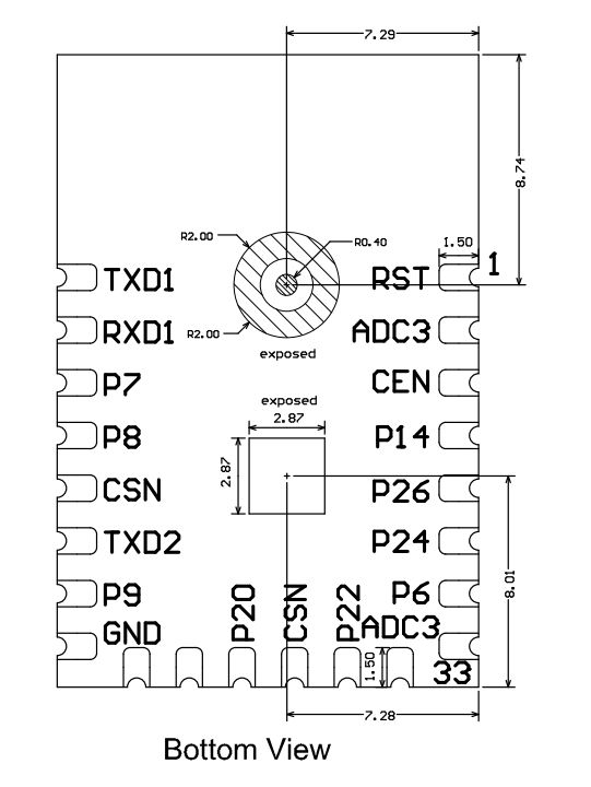

The WiFi module itself is a CB3S - or BK7231N. View from underneath:

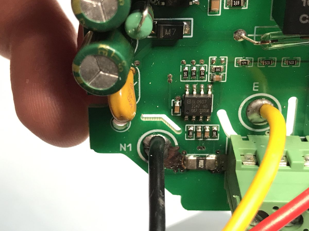

In addition, there is a circuit on the board from energy measurement:

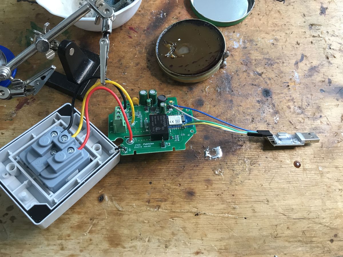

Now you can change the firmware. .
A USB to UART converter is useful:
The WiFi module requires a 3.3V supply, but there is already a 3.3V LDO on the board, so you can feed 5V into its input to get 3.3V. For this you need RX and TX:

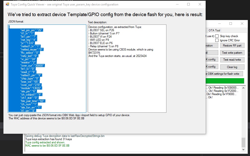

We program according to the flasher instructions:
Read the batch first - the flasher will recognise the GPIO configuration this way:
Tuya JSON detected:
Verbal description:
Device seems to be using CB3S module, which is BK7231N chip.
- Relay (channel 1) on P8
- WiFi LED on P9
- Button (channel 1) on P7
- BL0937 ELE on P6
- BL0937 VI on P24
- BL0937 SEL on P26
OBK template:
