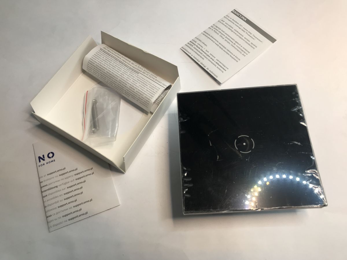

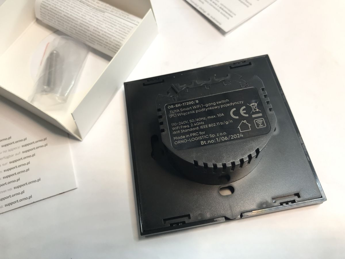

    The unit shown comes in various configurations and colours - we have a white and black option. You can also get it in double and triple versions. The kit comes with a switch (its dimensions are 86x86x35mm), two mounting screws for the box and instructions:
    Light switch compatible with Home Assistant? Firmware change OR-SH-17200 Tuya .
    The unit requires a neutral wire for operation.

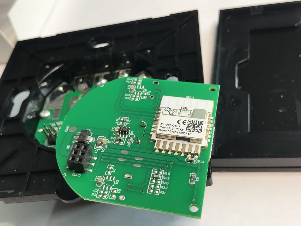

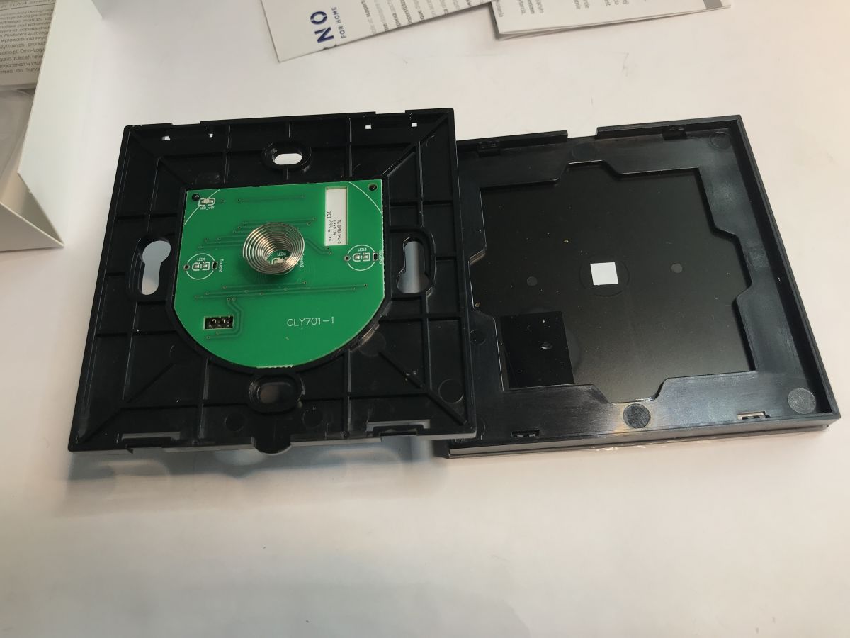

    Let's now move on to the presentation of the interior. We undermine the front panel.
    PCB designation: CLY701-1

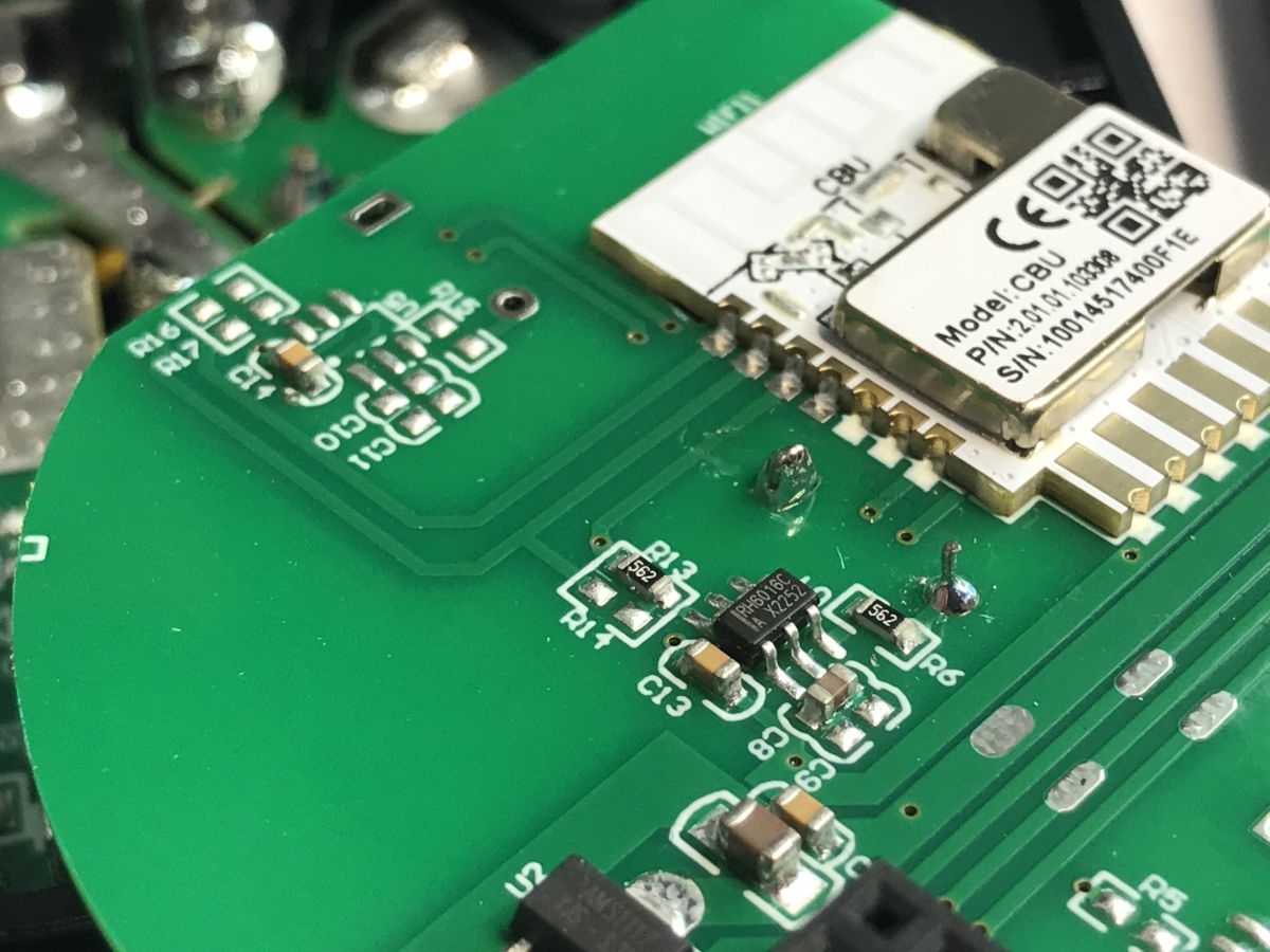

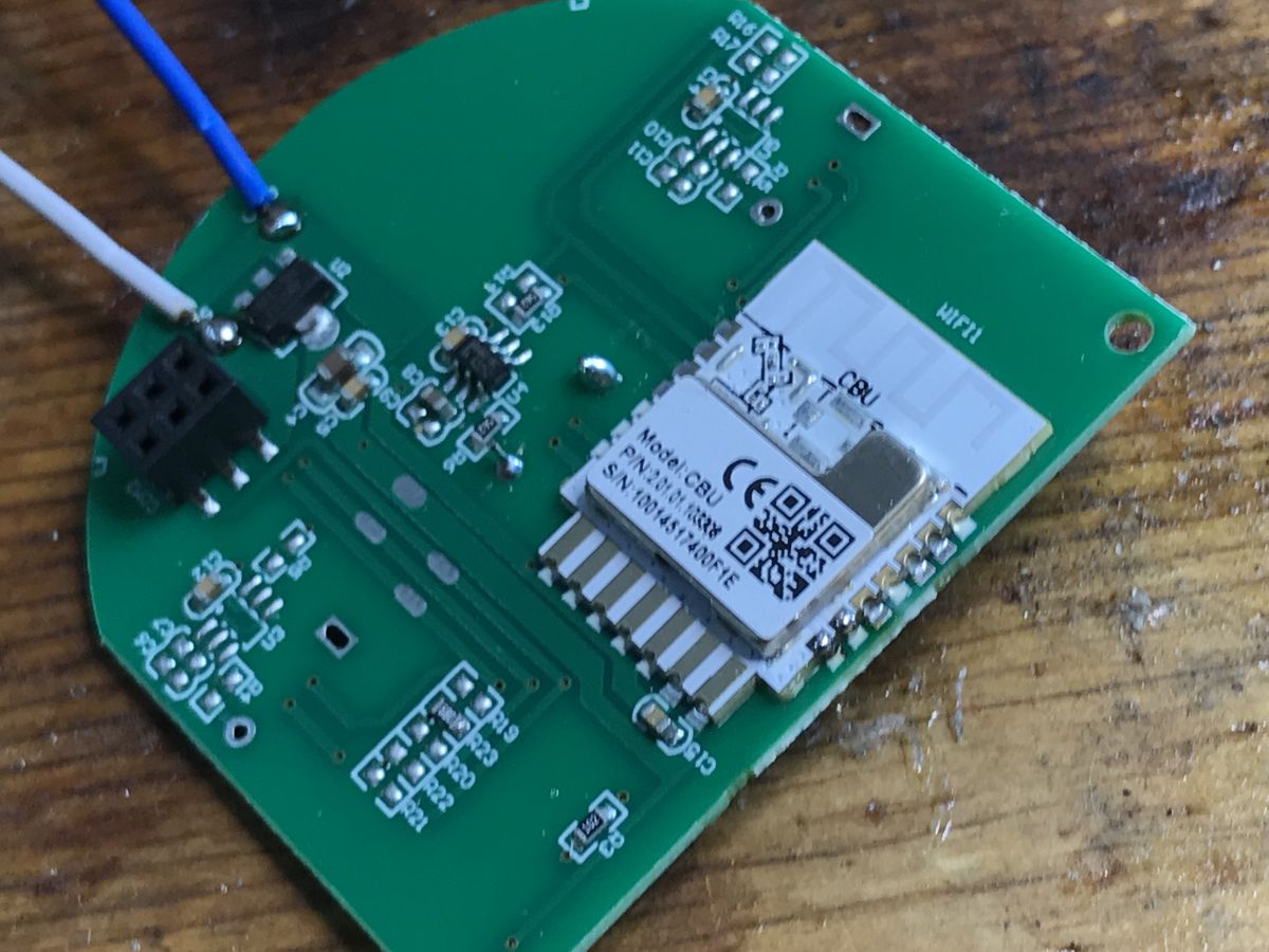

    We remove the board with the WiFi module:
    Inside you can see the WiFi CBU module, the LDO 3.3V AMS1117-3.3 regulator and the touch button controller (only one is soldered on - there are empty spaces for two more).
    Light switch compatible with Home Assistant? Firmware change OR-SH-17200 Tuya Light switch compatible with Home Assistant? Firmware change OR-SH-17200 Tuya Light switch compatible with Home Assistant? Firmware change OR-SH-17200 Tuya .

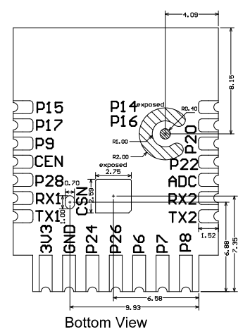

    CBU outputs (bottom view):
    Pin number Symbol I/O type Function
    1 P14 I/O Common GPIO, which can be reused as SPI_SCK (Correspond to Pin 11 of the IC)
    . 2 P16 I/O Common GPIO, which can be reused as SPI_MOSI (Correspond to Pin 12 of the IC)
    3 P20 I/O Common GPIO (Correspond to Pin 20 of the IC)
    4 P22 I/O Common GPIO (Correspond to Pin 18 of the IC)
    5 ADC I/O ADC, which corresponds to P23 on the internal IC (Correspond to Pin 17 of the IC)
    6 RX2 I/O UART_RX2, which corresponds to P1 on the internal IC. TX2 I/O UART_TX2, which is used for outputting logs and corresponds to P0 of the internal IC (Correspond to Pin 29 of the IC)
    8 P8 I/O Support hardware PWM (Correspond to Pin 24 of the IC)
    9 P7 I/O Support hardware PWM (Correspond to Pin 23 of the IC)
    10 P6 I/O Support hardware PWM (Correspond to Pin 22 of the IC)
    11 P26 I/O Support hardware PWM (Correspond to Pin 15 of the IC)
    12 P24 I/O Support hardware PWM (Correspond to Pin 16 of the IC)
    13 GND P Power supply reference ground
    14 3V3 P Power supply 3V3
    15 TX1 I/O UART_TX1, which is used for transmitting user data and corresponds to Pin 27 of the IC. For the MCU solution, please refer to CBx Module.
    16 RX1 I/O UART_RX1, which is used for receiving user data and corresponds to Pin 26 of the IC. For the MCU solution, please refer to CBx Module.
    17 . P28 I/O Common GPIO (Correspond to Pin 10 of the IC)
    18 CEN I/O Reset pin, low active (internally pulled high), compatible with other modules (Correspond to Pin 21 of the IC)
    19 P9 I/O Common GPIO (Correspond to Pin 25 of the IC)
    20 P17 I/O Common GPIO, which can be reused as SPI_MISO (Correspond to Pin 14 of the IC)
    21 P15 I/O Common GPIO, which can be reused as SPI_CS (Correspond to Pin 13 of the IC)
    Test point point CSN I/O Mode selection pin. If it is connected to the ground before being powered on, enter the firmware test mode. If it is not connected or connected to VCC before being powered on, enter the firmware application mode. Correspond to Pin 19 on the internal IC.

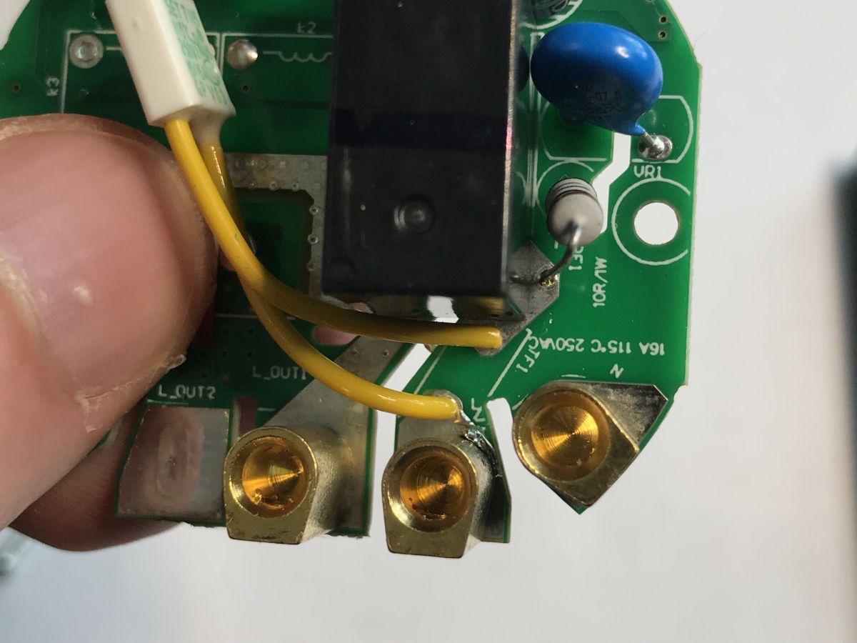

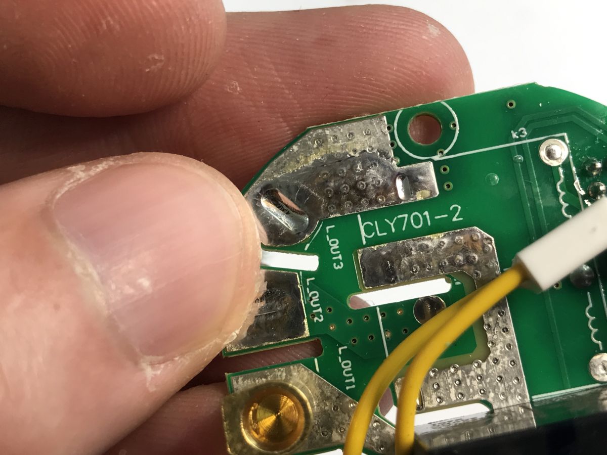

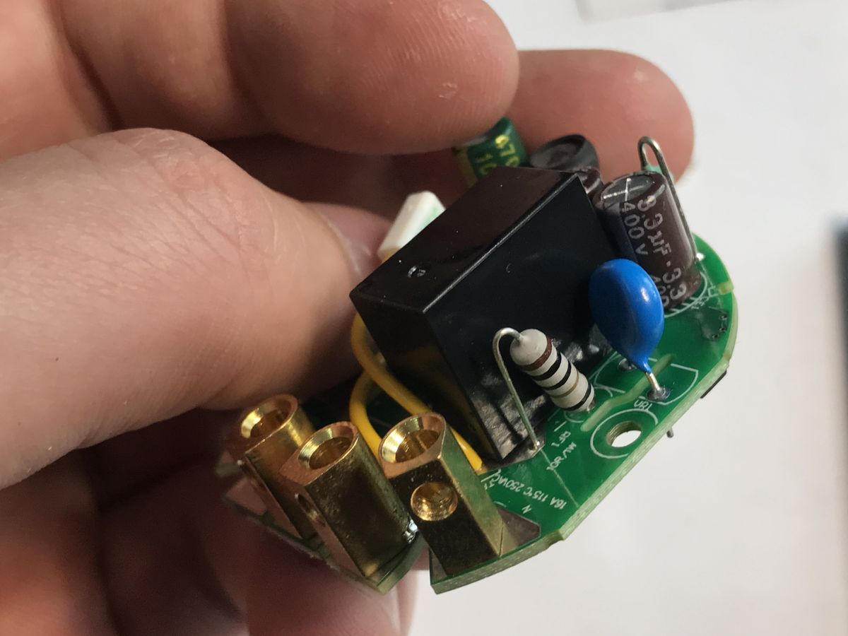

    The second board is essentially the power supply (a small non-isolated step-down inverter) and relays (one here) along with the transistors and surge protection diodes that control them.
    Interesting that there is a varistor inside - this fuse surprised me too. Why does it have such long legs?

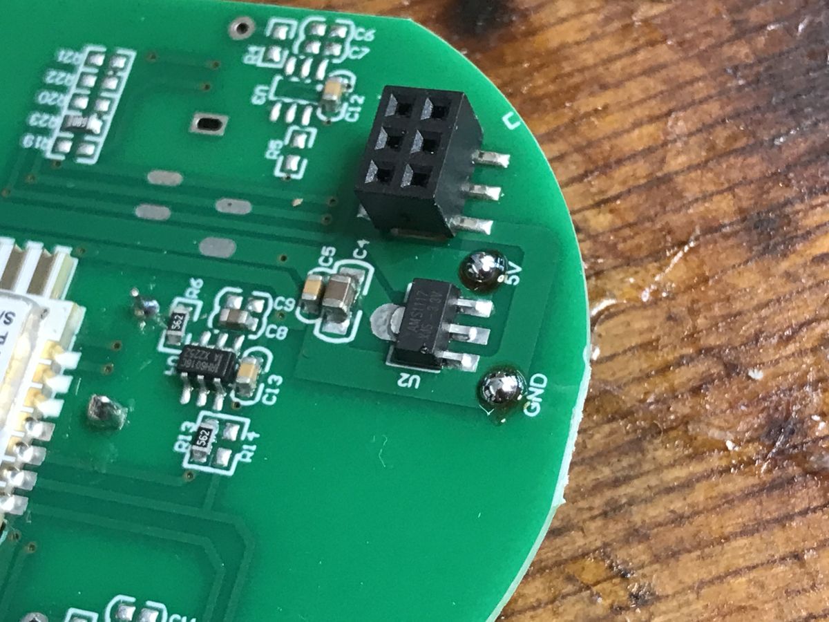

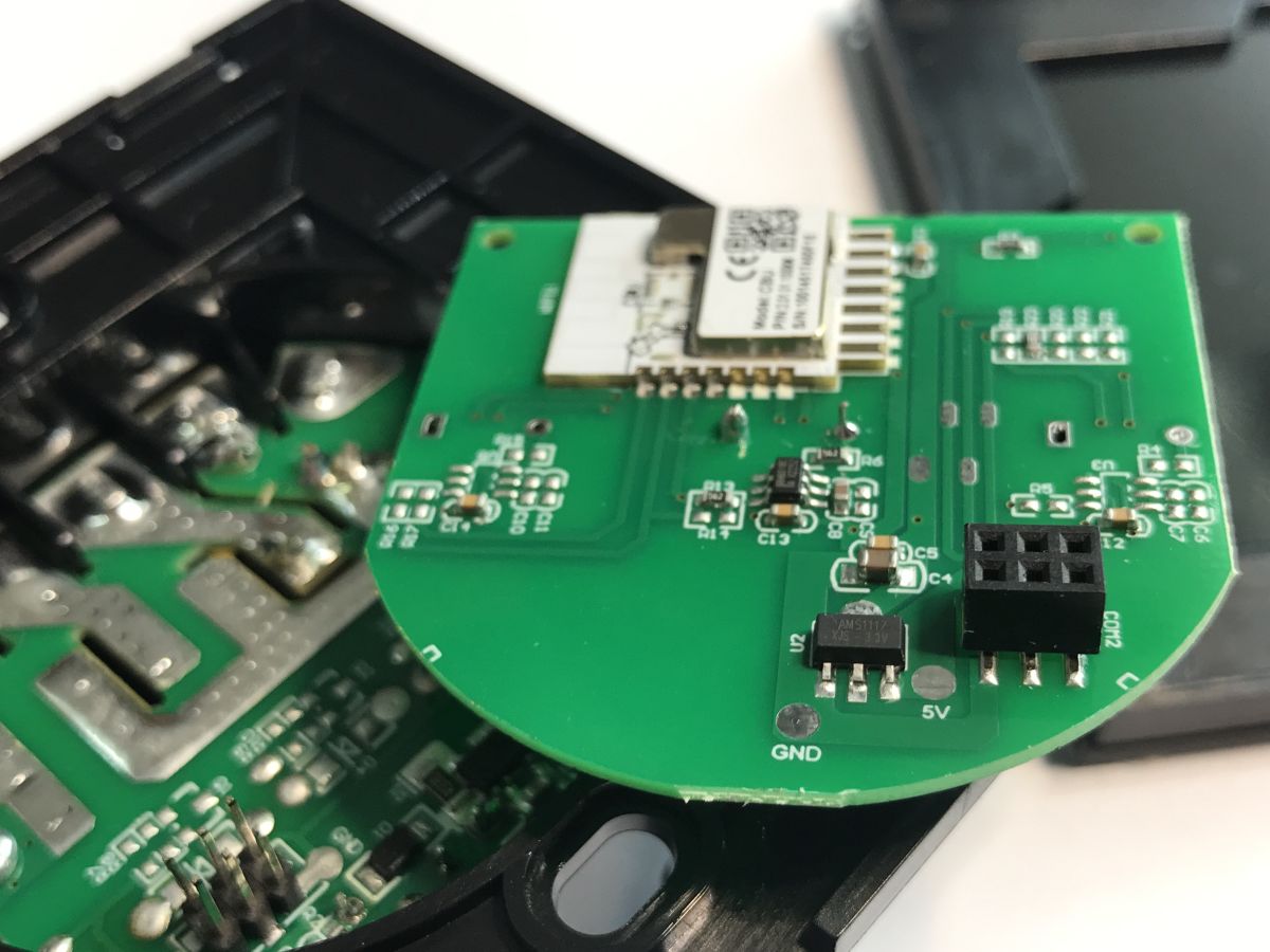

    Now it's time to change the firmware. You will need a USB to UART converter and a good 3.3V power supply, unless you solder 5V to the AMS1117-3.3V input from the board. It will come out the same. The programming tool is here: https://github.com/openshwprojects/BK7231GUIFlashTool
    Follow the readme there. There are 5V and GND pads on the board, so just whittle them down and you can solder the wires.
    Close-up of a PCB with GND and 5V markings and a 4-pin connector visible .
    Soldered:
    PCB with CBU BK7231N WiFi module and RX/TX wires soldered .

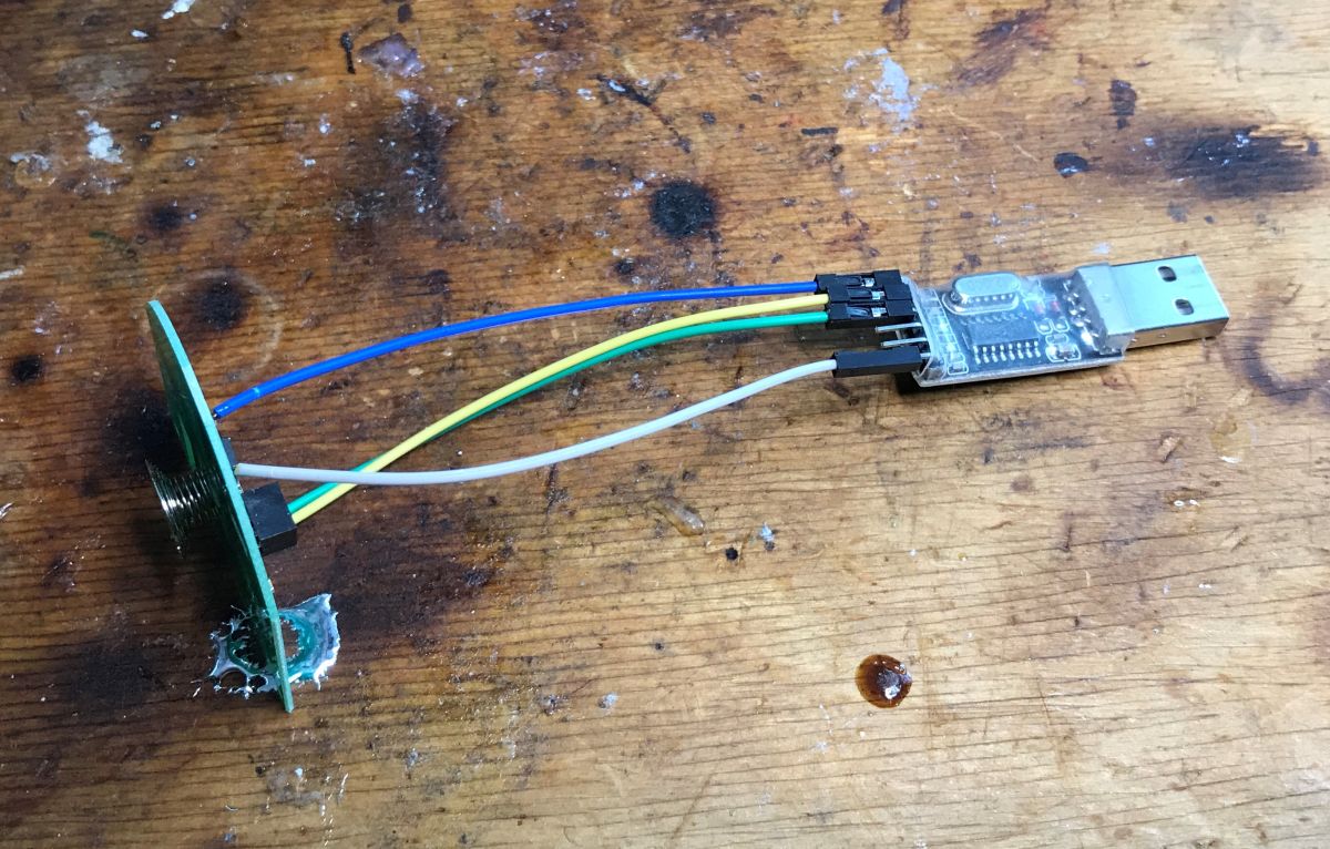

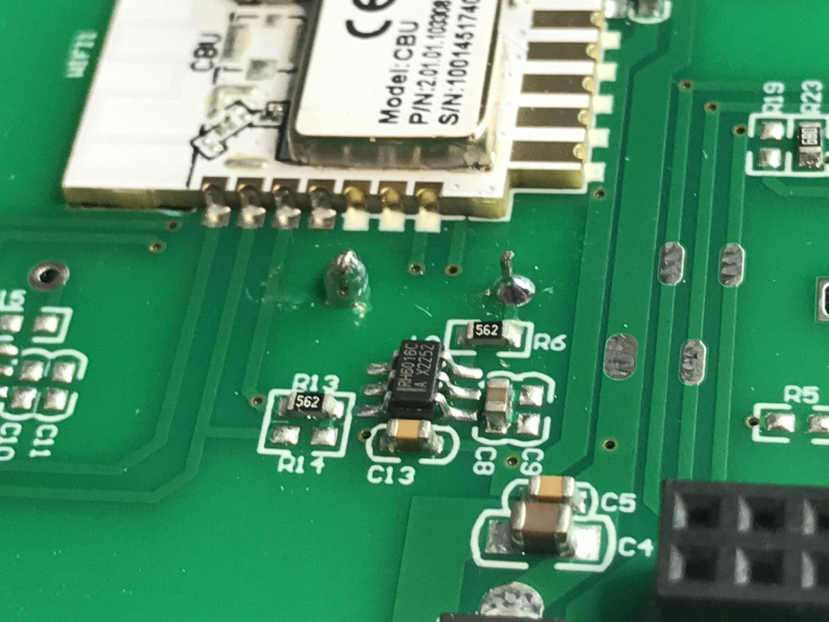

    Then we solder the wires to the CBU pads - RX1 and TX1. This is what the whole thing looks like:
    USB-UART converter connected to a CBU board with wires on a wooden table .
