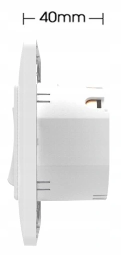

    Dimensions as in the picture above, depth shown below:
    Side view of a white wall-mounted electrical socket with a marked depth of 40 mm.

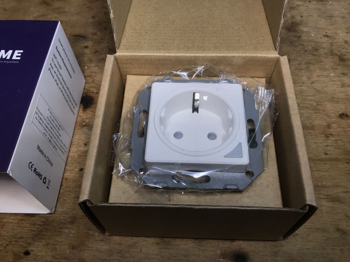

    Contents of the set, is something missing?
    White schuko-type SWP86-01OG electrical socket in a box, wrapped in protective foil.
    Nothing could be further from the truth, the front panel is simply loose:
    SWP86-01OG electrical socket in white protective foil inside an open cardboard box.

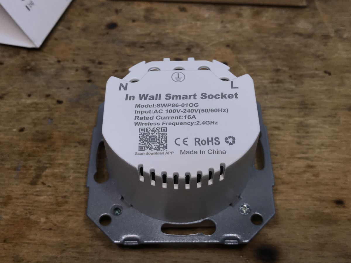

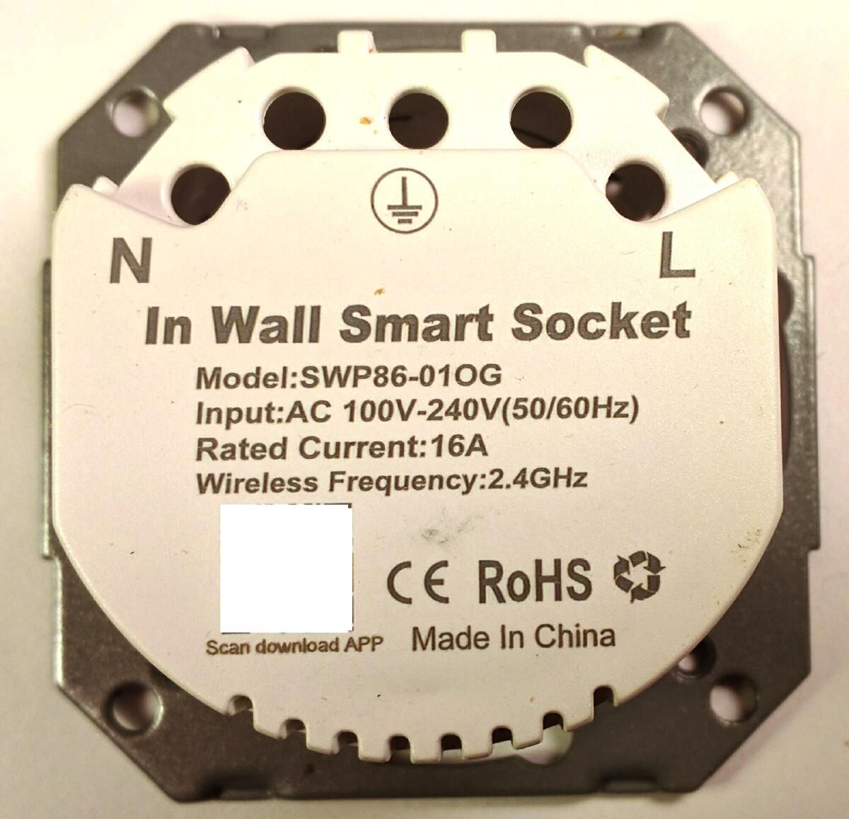

    The socket itself with markings:
    SWP86-01OG WiFi smart socket in packaging, wrapped in plastic, with visible mounting screws. “In Wall Smart Socket” SWP86-01OG wall-mounted smart socket on a wooden surface. White schuko-type electrical socket, ready for installation on a wooden surface.
    It is worth noting that the screws are also included in the set.

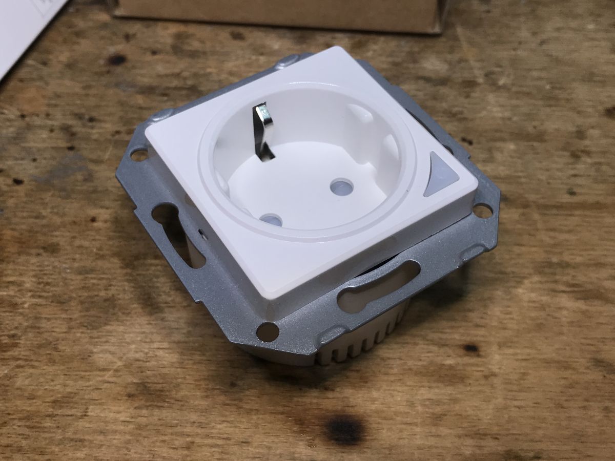

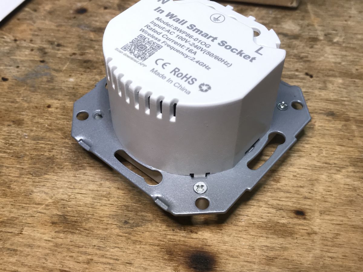

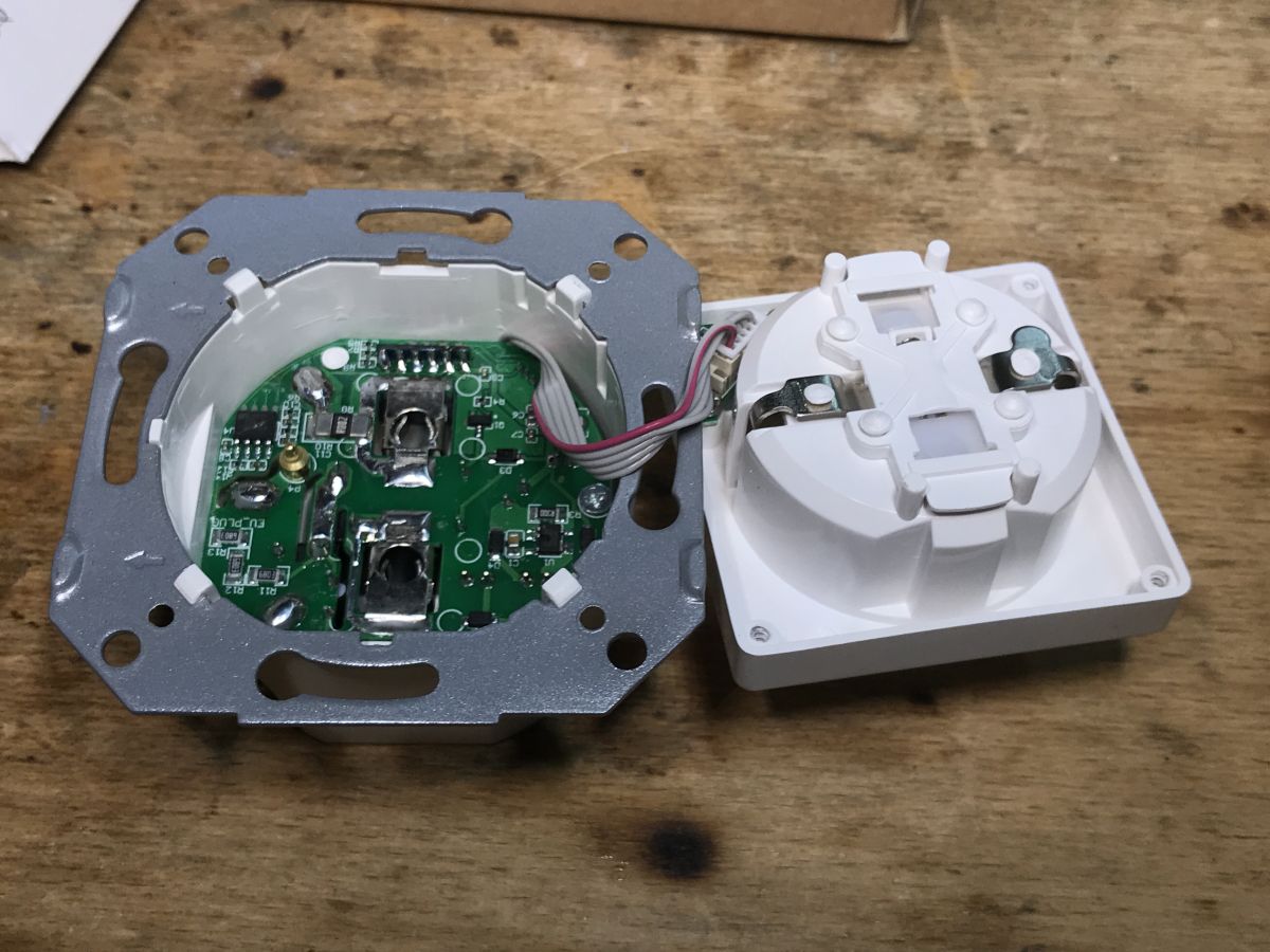

    Interior of SWP86-01OG
    First, unscrew all the small screws holding the front:
    White surface-mounted schuko electrical socket on a wooden surface. White in-wall smart socket SWP86-01OG on a wooden surface, with technical information and metal mounting frame visible.
    This allows you to free the front, we can see the cable on which the pairing/state change button and LED are connected:
    Disassembled smart electrical socket with exposed PCB and mechanical part on a wooden surface.

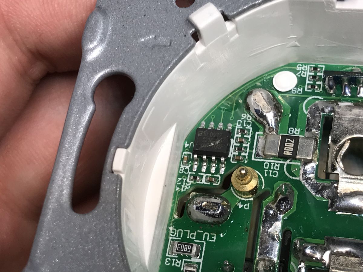

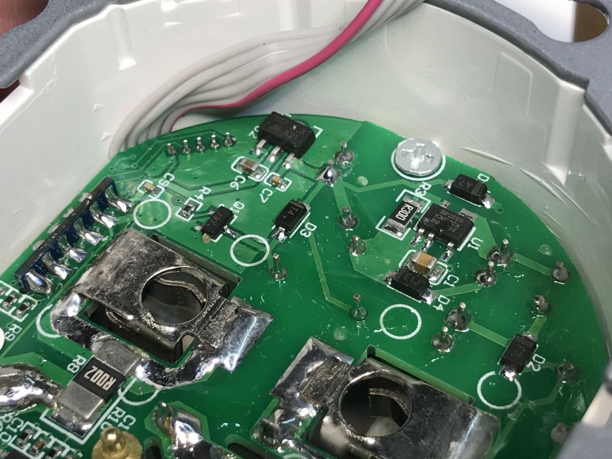

    We look inside:

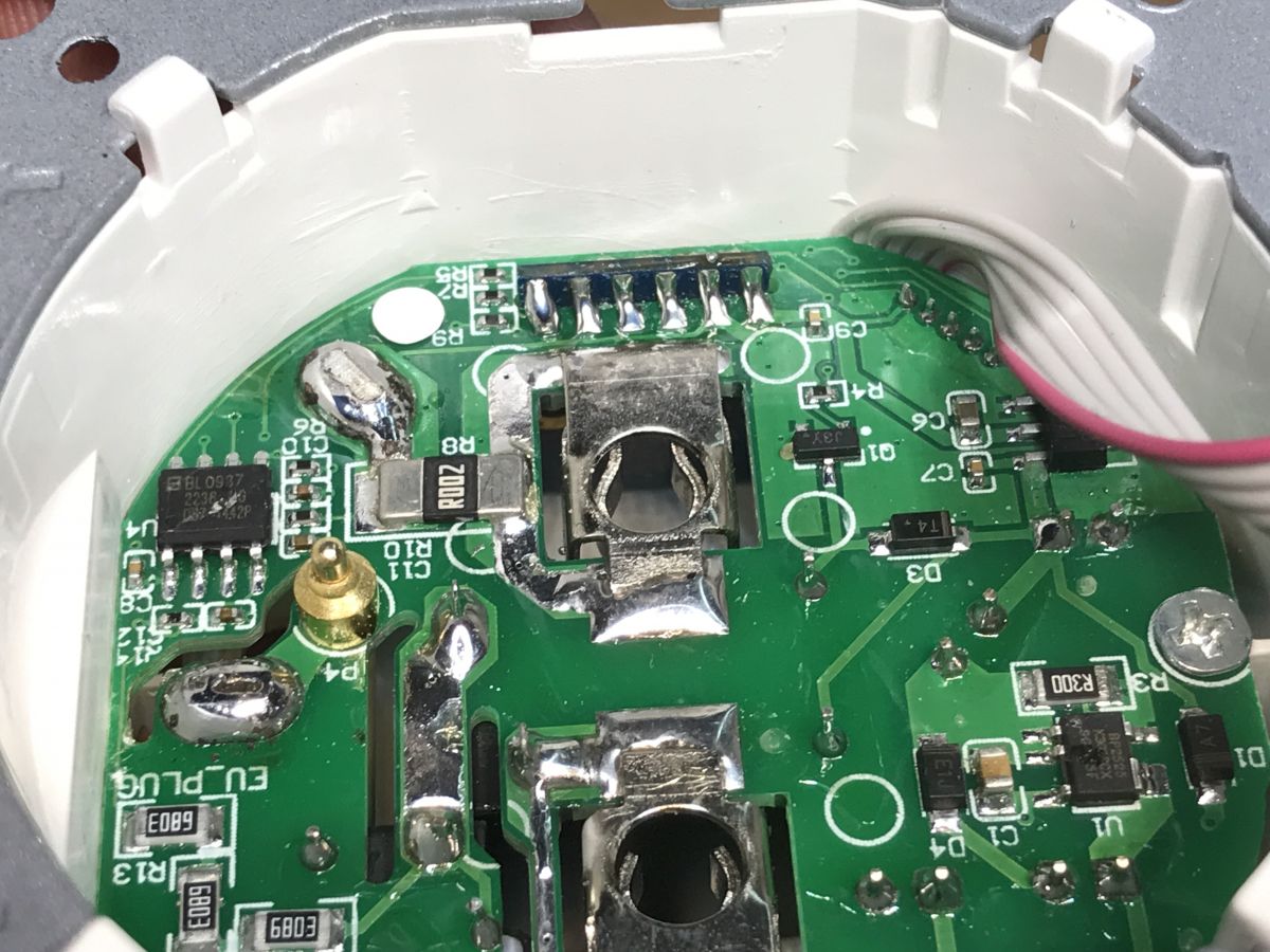

    Close-up of the inside of a WiFi power socket with the BL0937 chip and electronic components visible.
    You can immediately see BL0937 - the energy measurement system - along with a low-resistance resistor, a shunt on which the measurement is performed.
    Close-up of the inside of an SWP86-01OG power socket showing the BL0937 chip on a green PCB.
    You can also see the legs from the soldered WiFi module (CB2S or WB2S?), the transistor code J3Y, which reliably switches the relay, and the AMS1117-3.3V LDO regulator:
    Close-up of the inside of the SWP86-01OG electrical socket with visible PCB and electronic components.

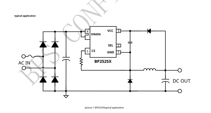

    Power is provided by BP2525:
    Typical application schematic of BP2525X showing AC input and DC output connections.
    It's just a simple step down, it's not even a flyback power supply, there is no galvanic separation... but no one is likely to push their fingers inside the socket.

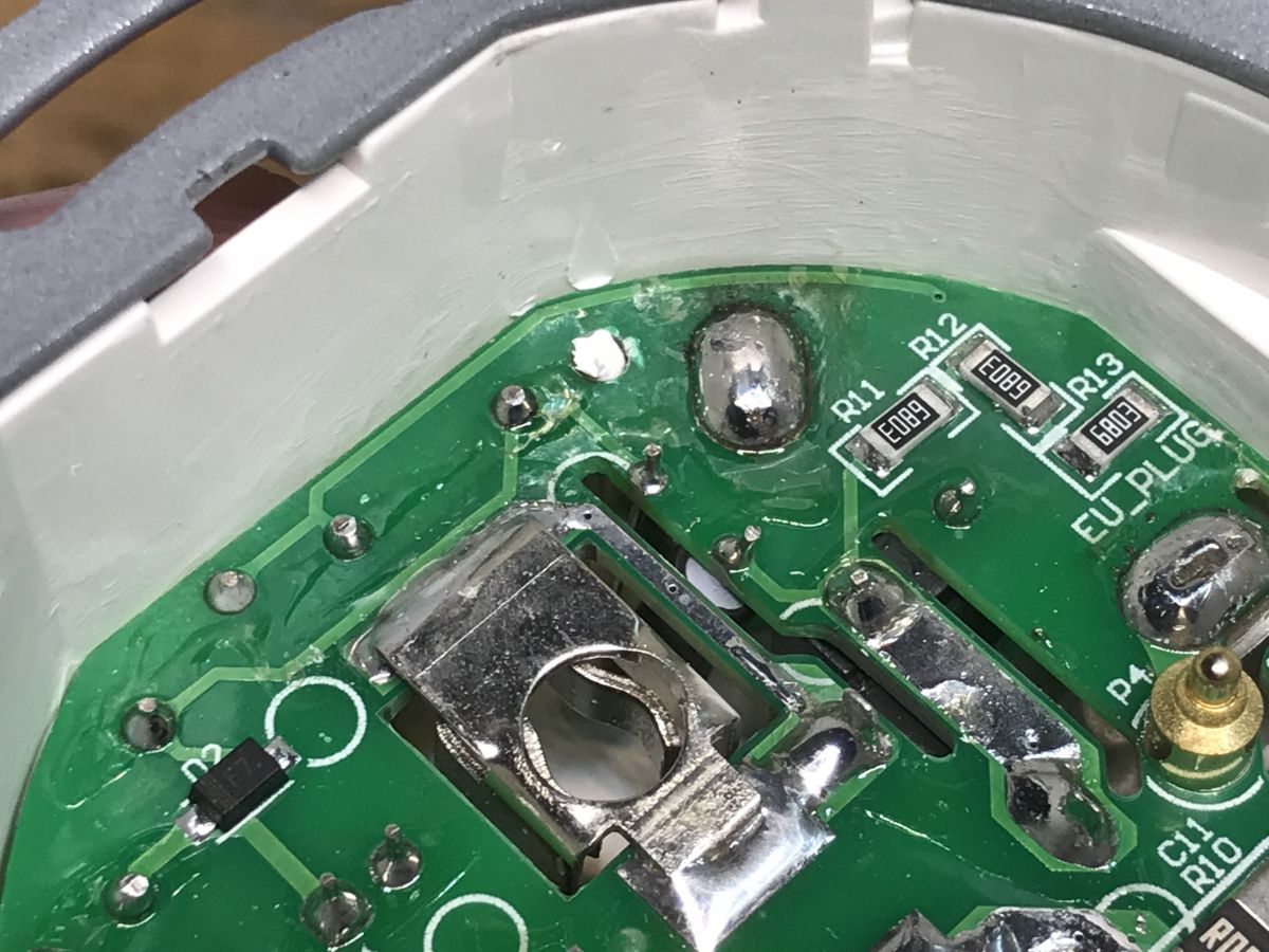

    Some additional photos:
    Close-up of a power socket PCB showing resistors R11, R12, R13 and metal terminals. Interior of an electrical socket showing PCB, wires, and electronic components.

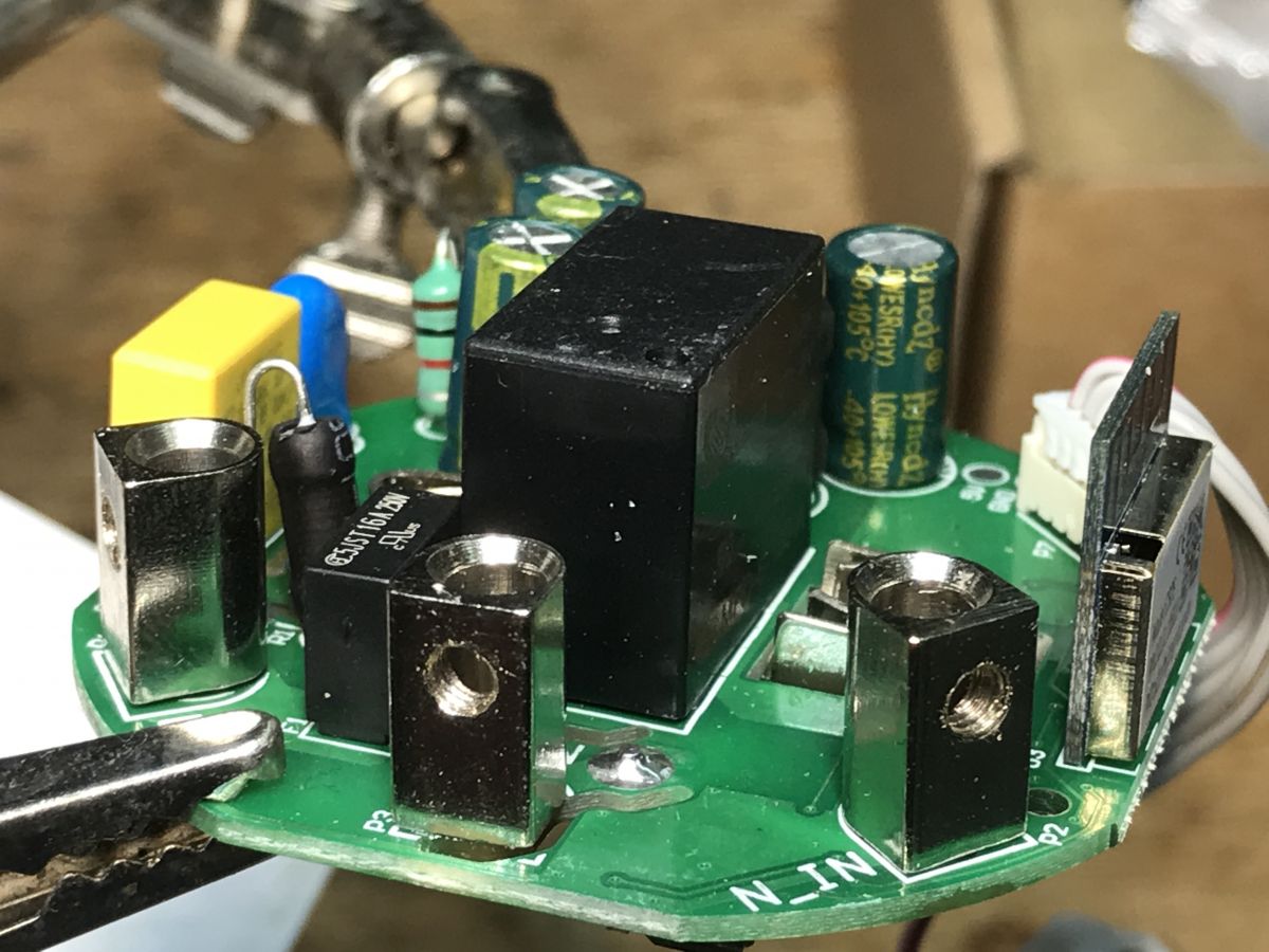

    Ok, unscrew the screws and take out the PCB:
    Close-up of the PCB inside a WiFi-controlled electrical socket, showing electronic modules and components. PCB of SWP86-01OG power socket with CB2S WiFi module, relay, and capacitors.

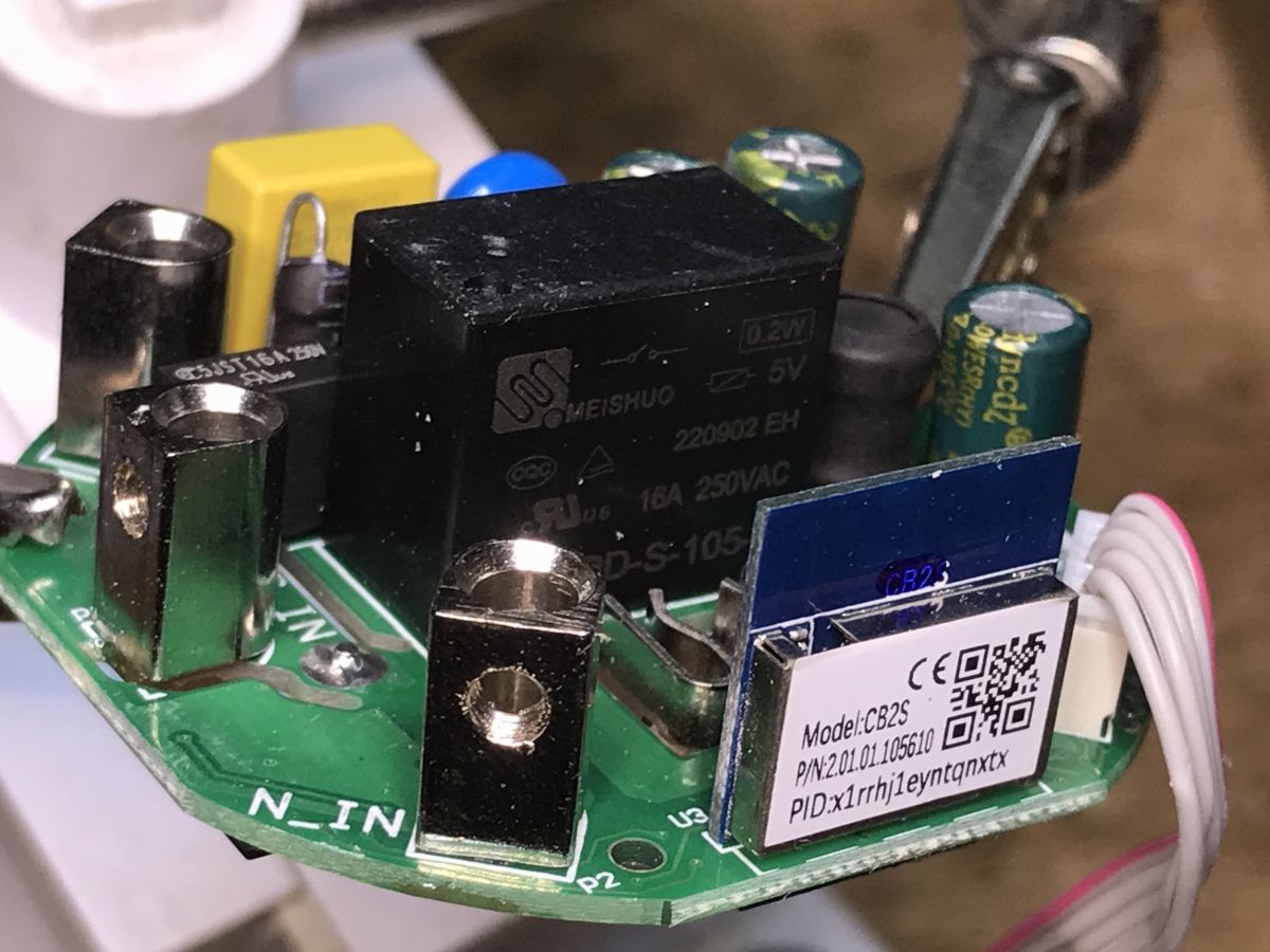

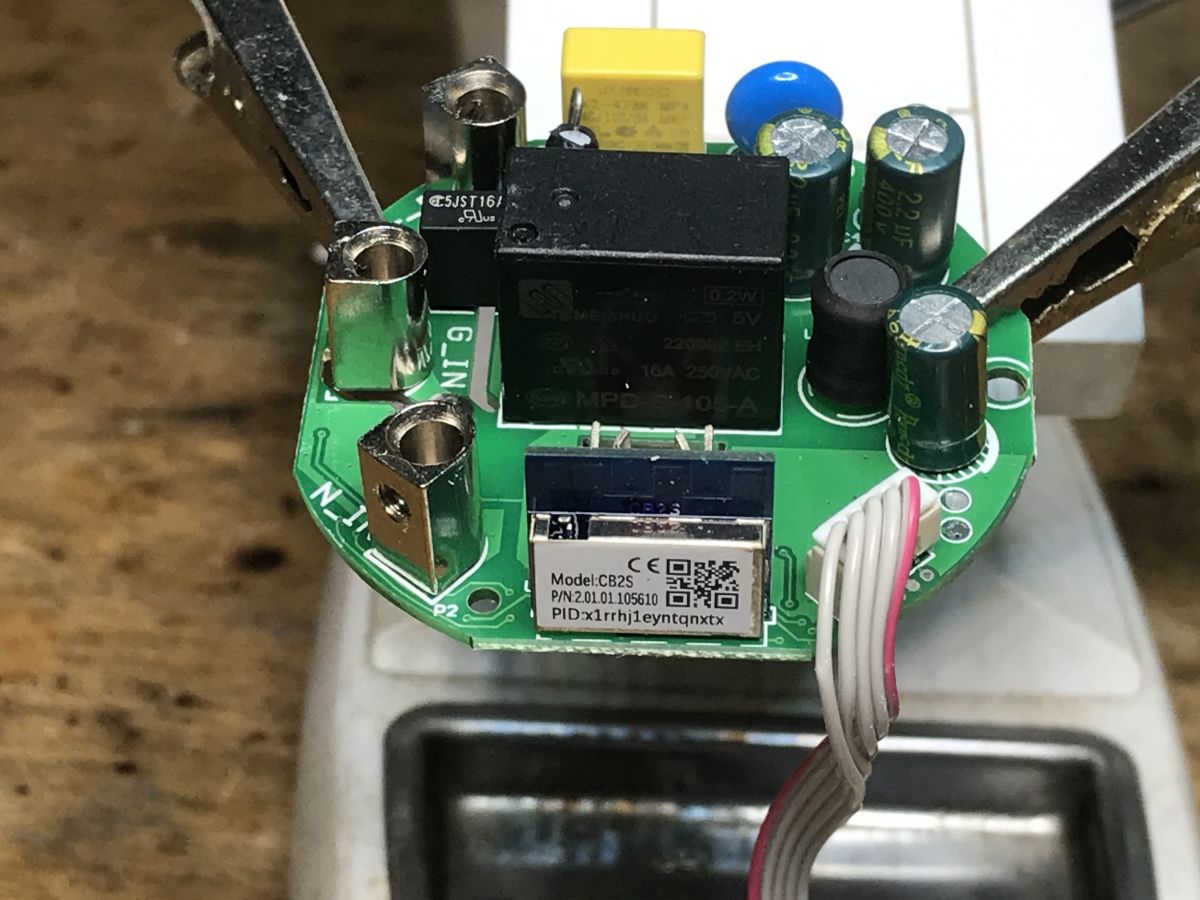

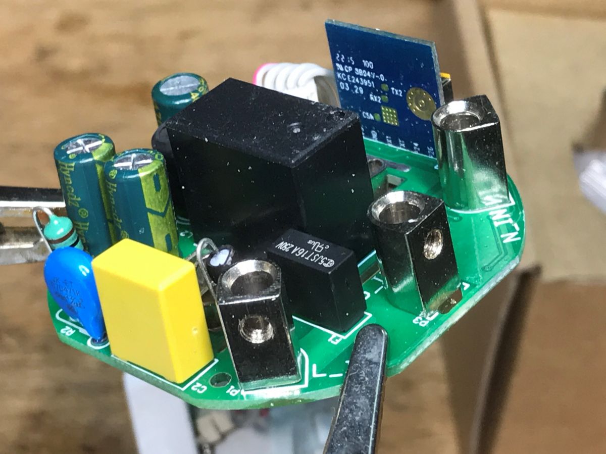

    There is a CB2S module, as I thought, BK7231N.

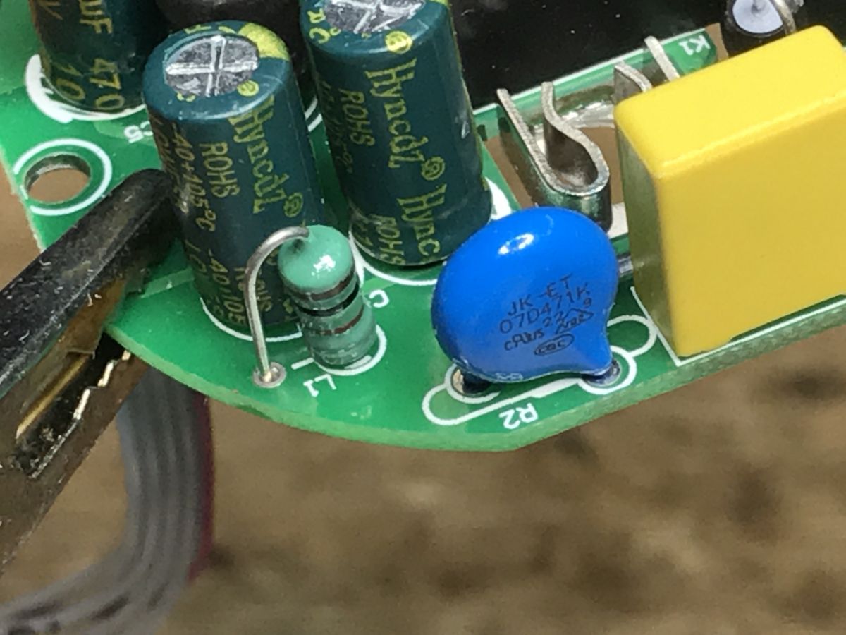

    You can also see some input protection, a fuse resistor, a varistor, an anti-interference capacitor:
    Close-up of a smart socket PCB with electronic components, relay, and WiFi module. Close-up of the SWP86-01OG smart socket PCB with visible electronic components, including the CB2S WiFi module and capacitors. Printed circuit board of the SWP86-01OG smart socket showing electronic components and a CB2S WiFi module. Close-up of electronic components on a PCB, including capacitors, a fuse resistor, and a blue varistor.

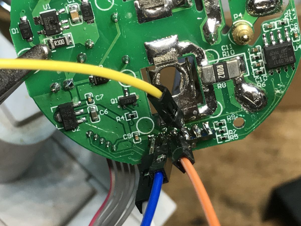

    PCB from the bottom:
    Close-up view of the PCB from the SWP86-01OG smart socket, showing electronic components and soldered contacts.

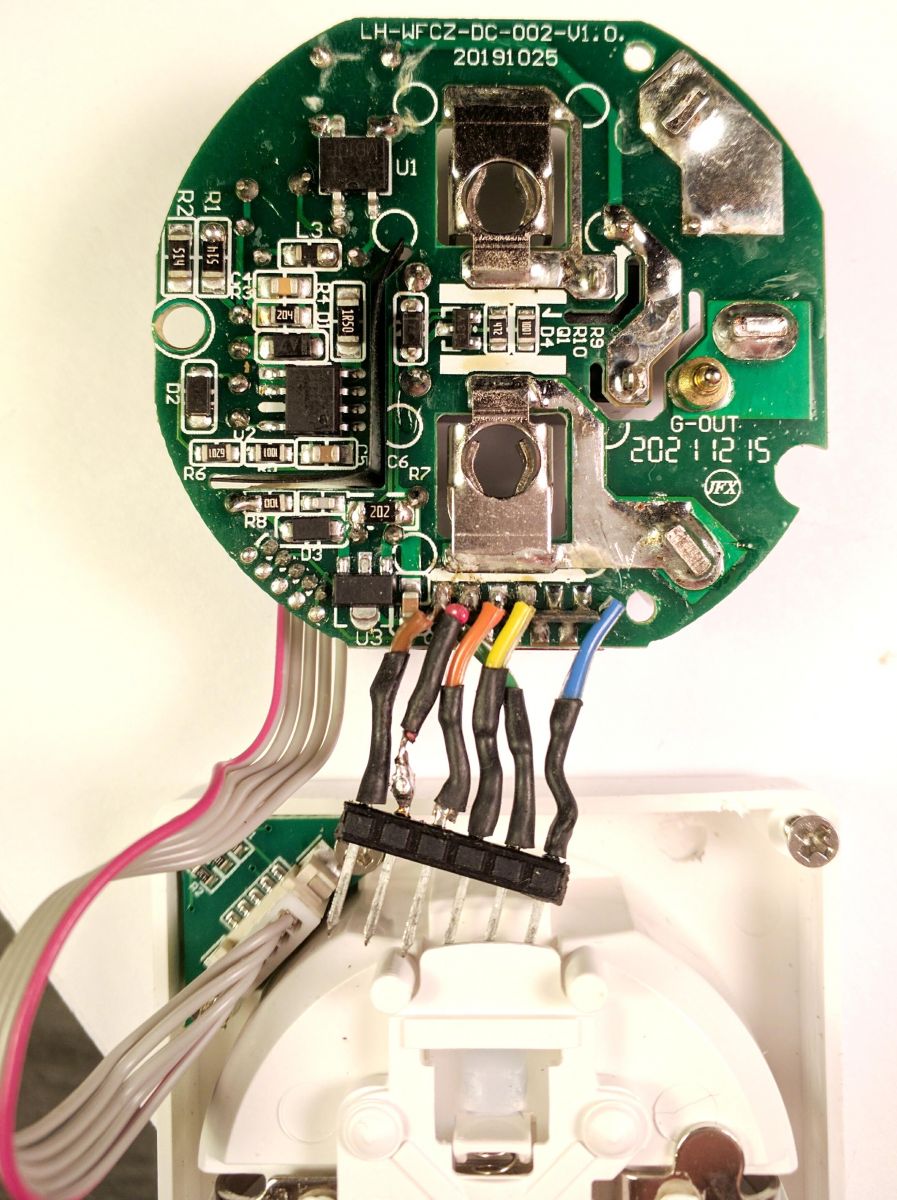

    Firmware change
    All you need to do is solder the CB2S (or WB2S) pins, the pins are in the network, everything in accordance with:
    Flux, plus a little lead binder would make soldering better and you can easily get to it through four wires:
    Close-up of a WiFi socket PCB with wires soldered for firmware flashing.

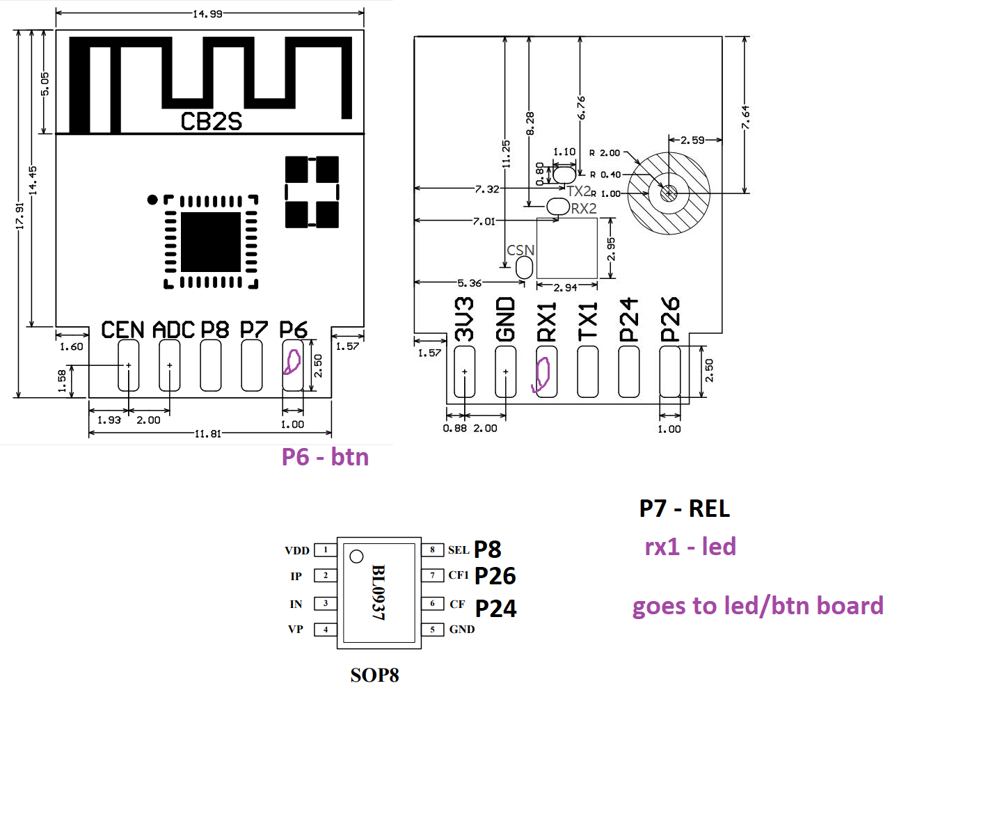

    There remains the issue of GPIO. Here is the schedule:
    Pinout diagram and dimensions for CB2S module and BL0937 IC with annotation of functions.
    And the template:
    Ready. You still need to calibrate the energy measurement using the VoltageSet/CurrentSet/PowerSet commands, as in Tasmota , and then you can use this device 100% locally, without potential manufacturer surveillance, and connect it conveniently with Home Assistant.

    Can I ask for the exact dimensions of the socket front, including the depth measured from the front to the mounting plate? I wonder if it will be possible to fit them into a standard frame from another manufacturer.

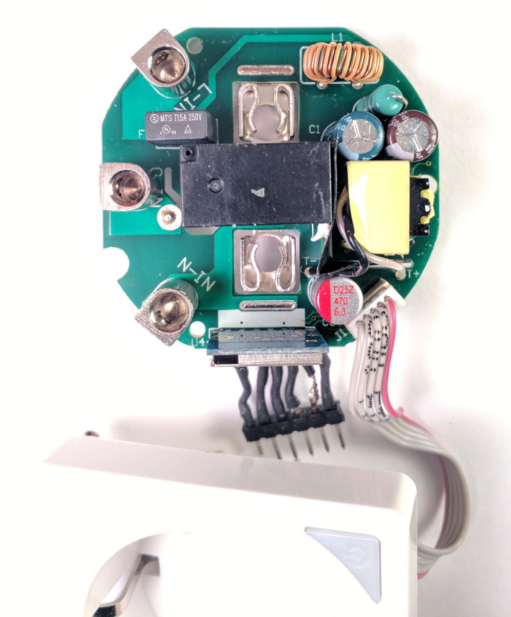

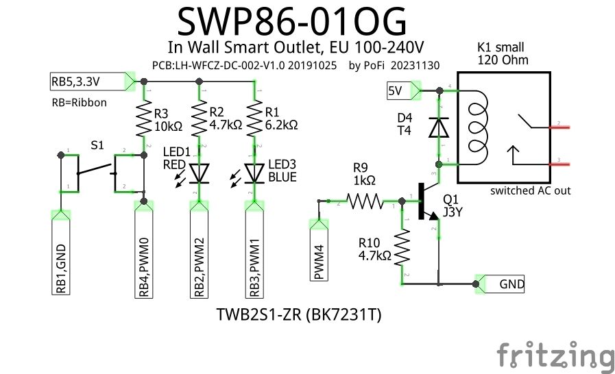

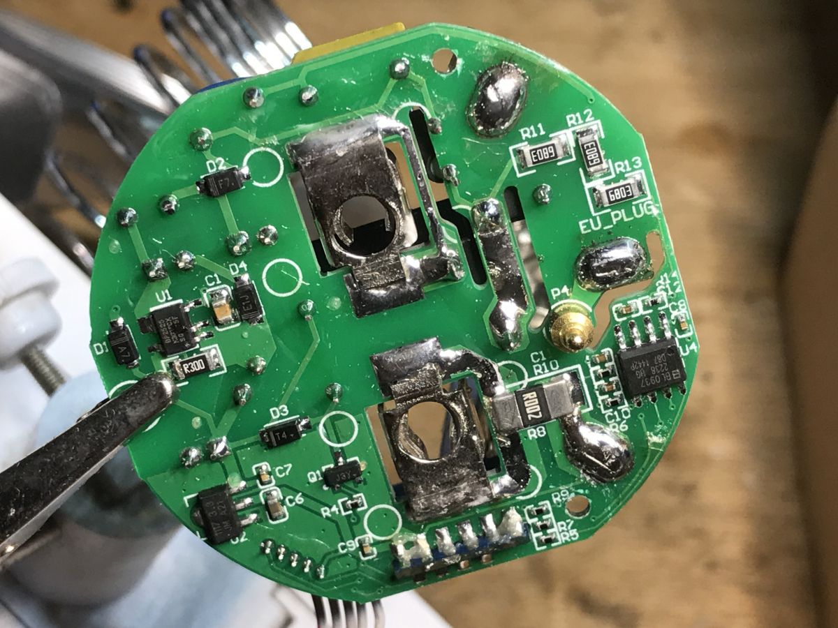

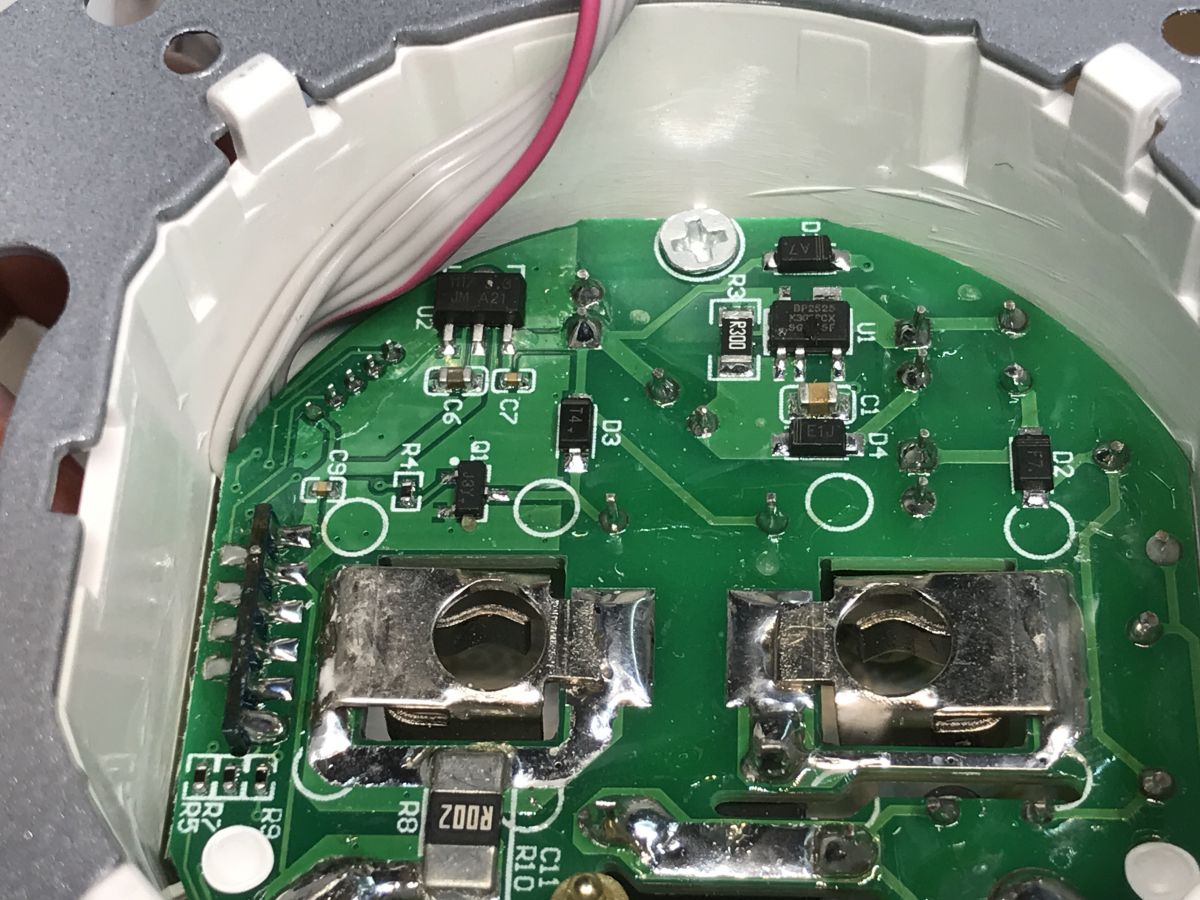

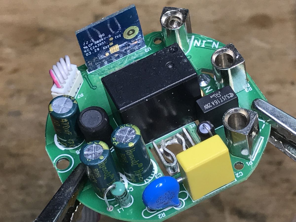

    omniron
    Posts: 114
    Yes, CB2S, but I simply cannot remove-solder these things, have to use OTA.
  • #12 20840579
    omniron
    Posts: 114
    It's actually a TWB2S1-ZR (BK7231T).
    It has no power meter, and instead of using a 3.3V relay, they use a 5V AC/DC converter (same SZ2525C) and then a linear DC/DC converter for the 3.3V!
    attached the logic part of my unit.
    [BK7231N/CB2S] SWP86-01OG energy measurement socket
    Can this be flashed OTA?
    Thanks!

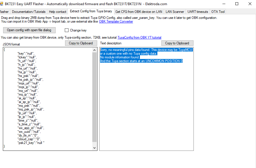

    #15 21754369
    mbk_med
    Posts: 9
    Hey, I recently bought a new socket using the CB2S chip, and after flashing it and setting up the pins, the physical button stopped working (it supposed to turn the relay on/off).
    I checked the “GPIO Doctor” page to find the correct pin, but I couldn’t detect it. Does anyone know how to remap or reprogram the button? Everything else works fine, and the relay switches normally through the software button (toggle 0).
    Thanks.
  • #16 21754450
    Posts: 14760
    Rate: 12887
    Have you tried Tuya Config Extraction?
  • #17 21754544
    mbk_med
    Posts: 9
    >>21754450
    Hello, yes, I tried it, but my file is not readable. I got an error when I opened it in BK7231Flasher.
    I tried with two files extracted from two sockets, and I got the same error.
    Error message “Failed to extract keys” in BK7231 Easy UART Flasher window
  • #18 21754555
    insmod
    Posts: 1432
    Help: 168
    Rate: 455
    Try with latest flasher
  • #19 21754620
    mbk_med
    Posts: 9
    Thanks. With the latest version, v154, I got this. It seems it doesn’t contain any configuration. Is there a solution?
